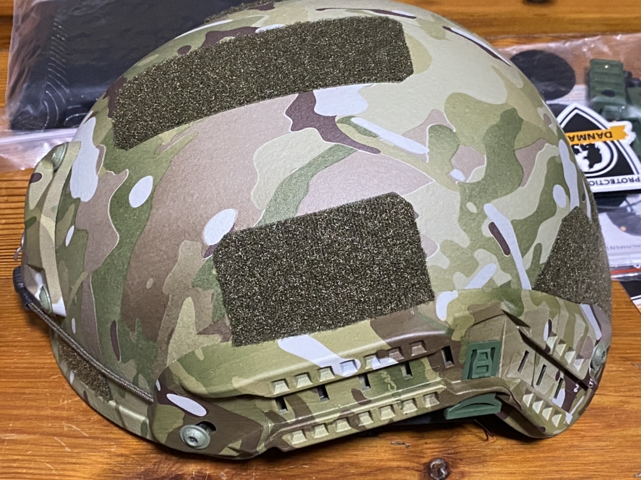

    I proudly present to you, dear fellow NODiots, fresh from the quirky country of Demark, from the aptly named company Protection Group Denmark, their spectacular new ARCH IIIa super high-cut ballistic helmet!
    Have a good look/read/watch here. It’s pretty impressive and should put any questions of quality or capability to bed:
    This damn thing took four (4) damn months to get here, but supposedly that was because I ordered right when PGD was redesigning their helmet line — and it was a worthwhile delay, if my unit is any indication.
    For the grand total of $373.50 (delivered) I received a helmet every bit the equal of my TW Ballistic and 90% as good any of my Crye, Ops Core, Revision and 85% as good as the Mtek Flux, and that’s high praise.

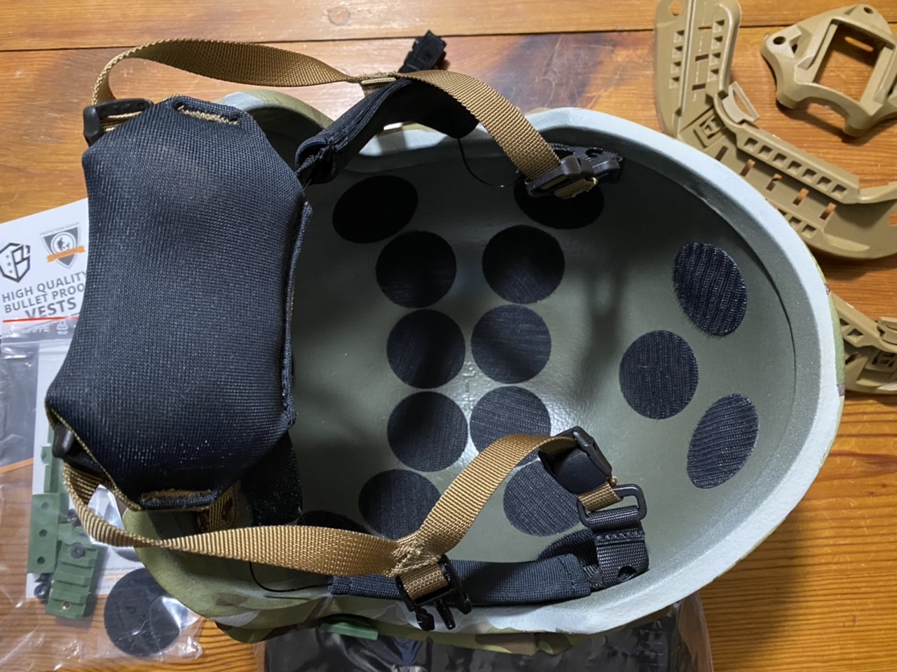

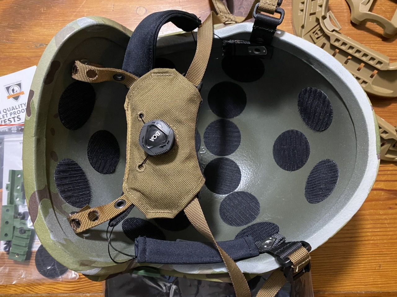

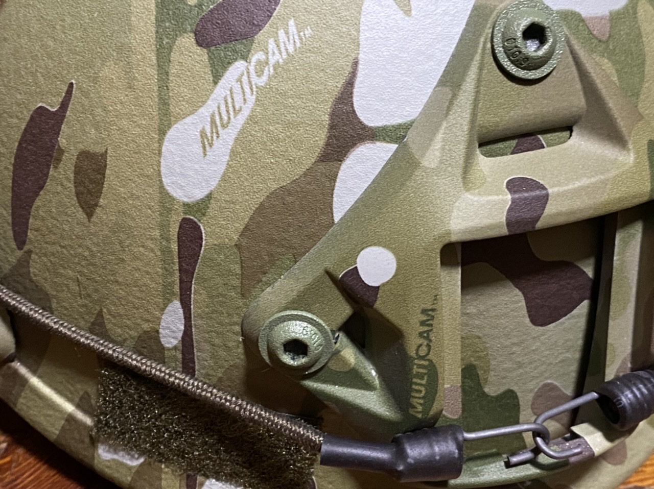

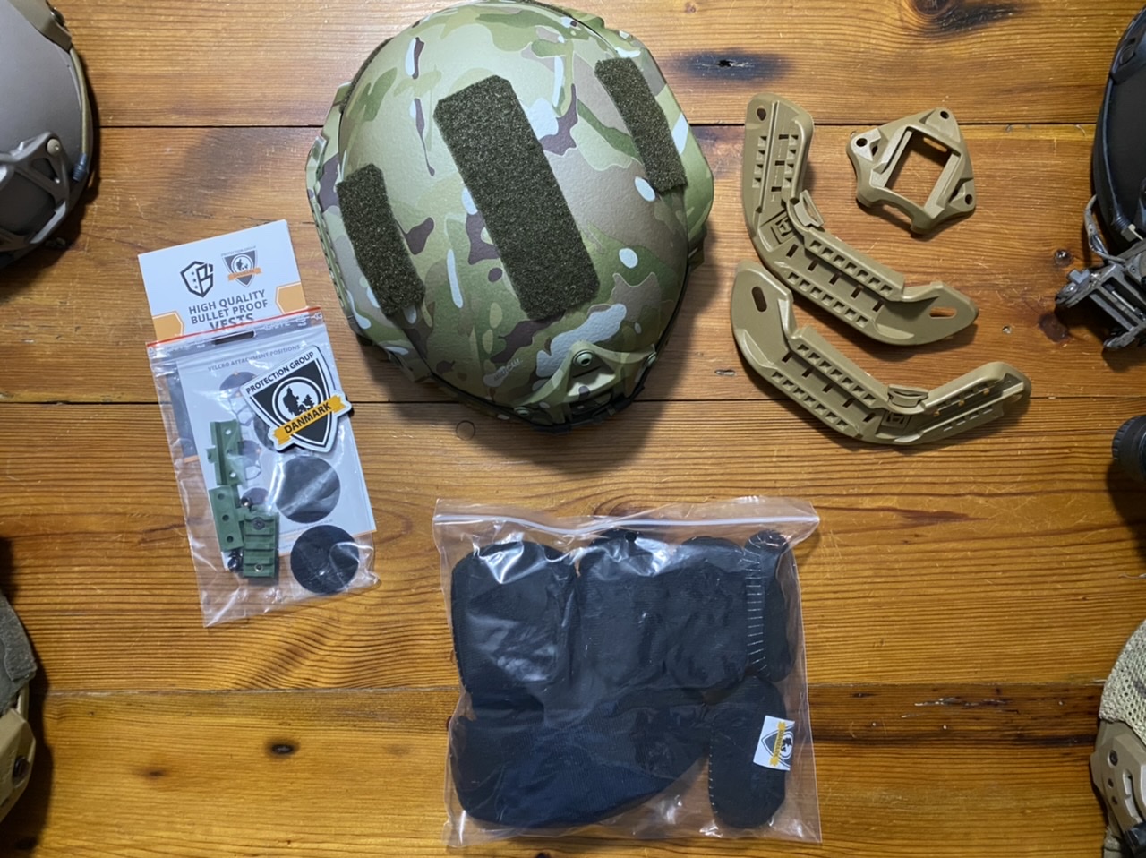

    First, a few faux toes:

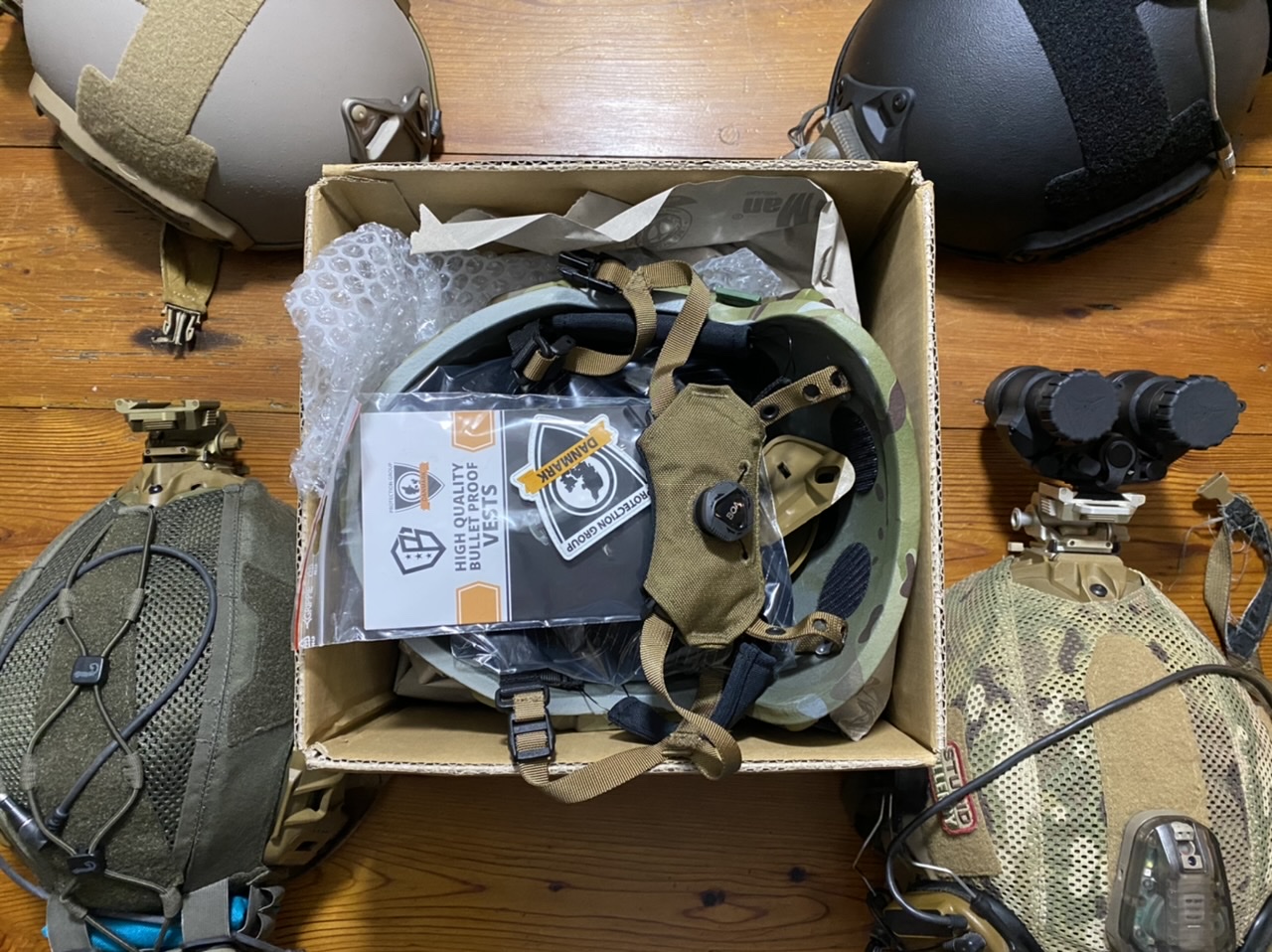

    First, it arrived straight from the factory in Denmark. Well packaged with an accessory kit that should be the standard for every helmet manufacturer... period. Not only did it come with a matching set of pre-installed Multicam ARC rails and shroud, but they include a full spare set of Desert Earth colored ones as well (pictured)! The BOA system is VERY well executed, and has the most comfortable retention system of any helmet I own. Then, the creme de la creme, is their included padding system. Basically, it’s a full Deluxe 4D Pad System. The PGD helmet is THE ABSOLUTE MOST COMFORTABLE helmet out-of-the-box of any manufacturer on the face of the planet. It is every bit as comfortable as my TW with 4D aftermarket pads, but its Boa retention system is even more comfortable. The helmet sits high and accommodates ear pro better than my TW or Ops Core and is about equal with the Mtek and Revision.
    So, ballistic protection that seems equal to any of the $2K model, more comfortable out-of-the-box than any helmet ever made, fits like it was custom molded to my head, and all for $373.50!

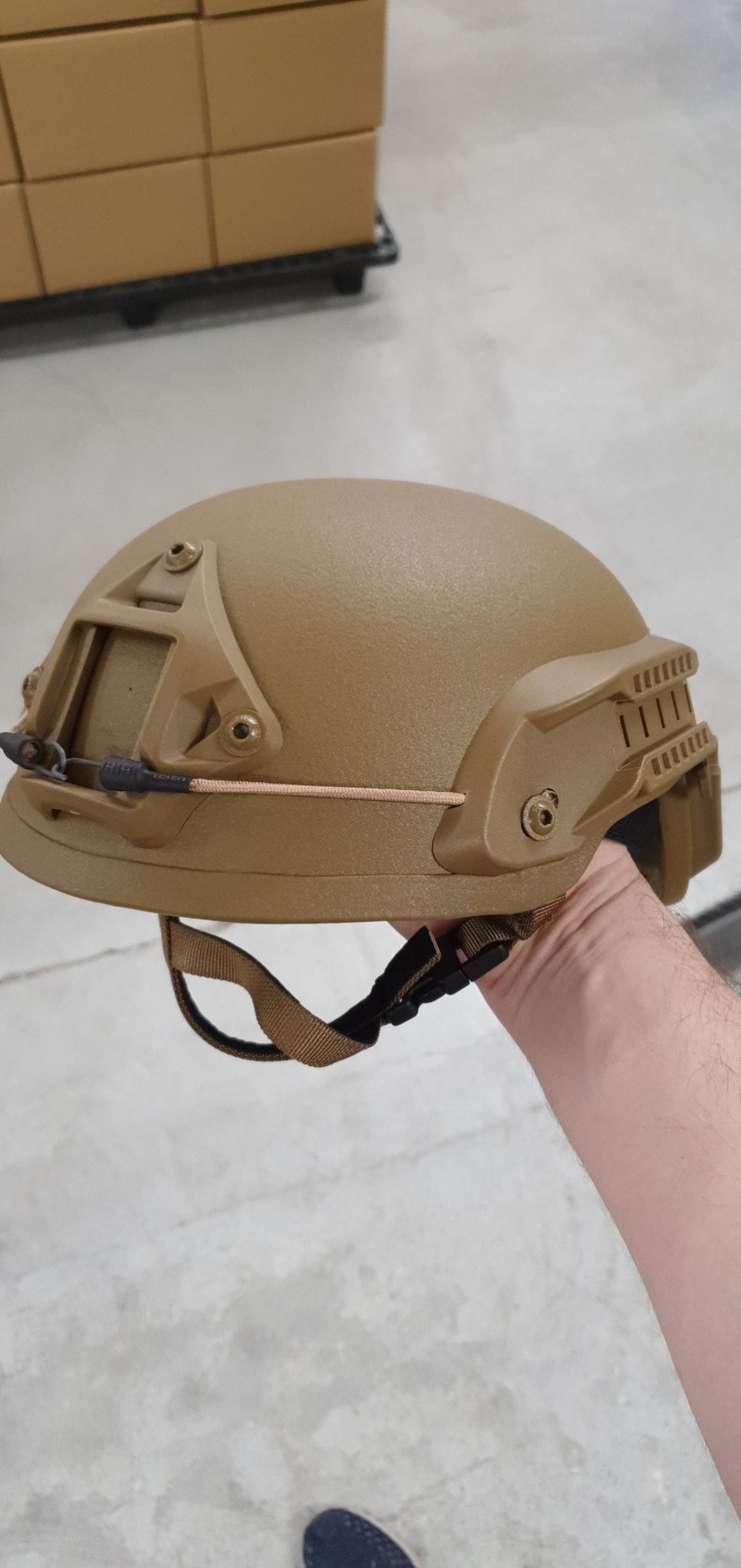

    I just realized that was your forearm in the pic...

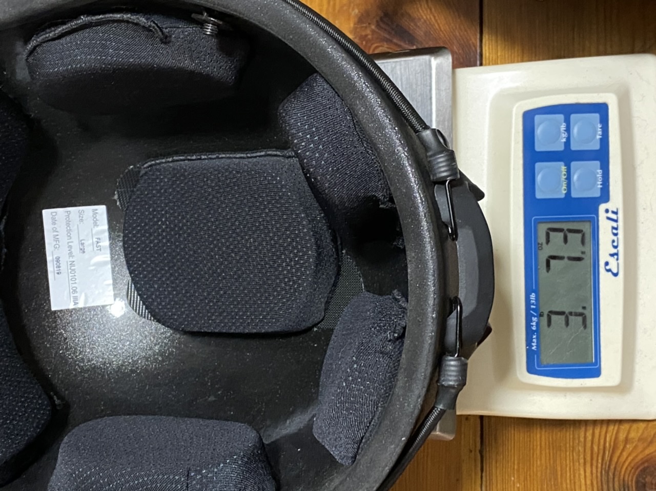

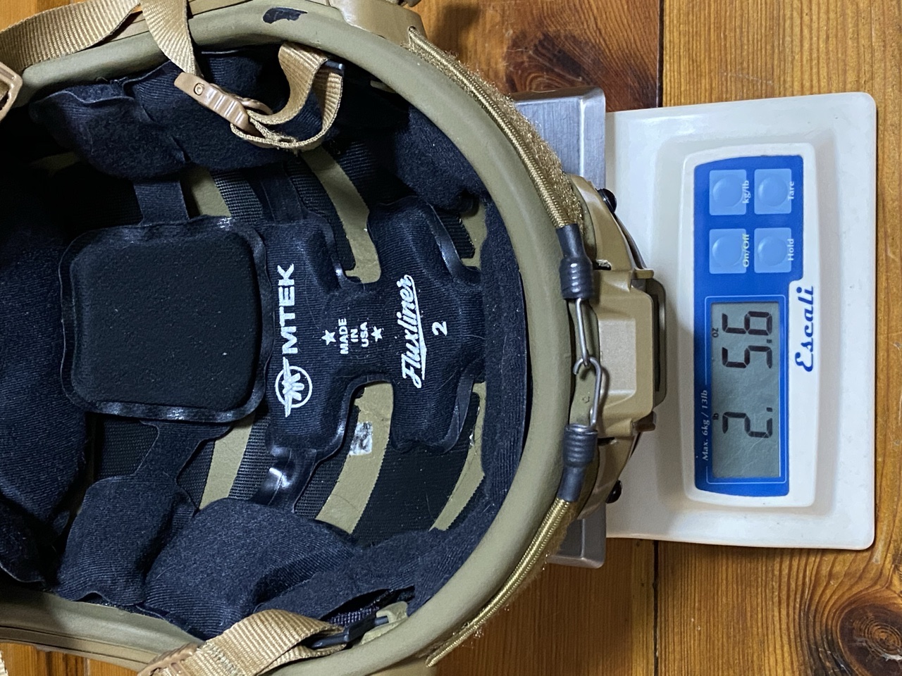

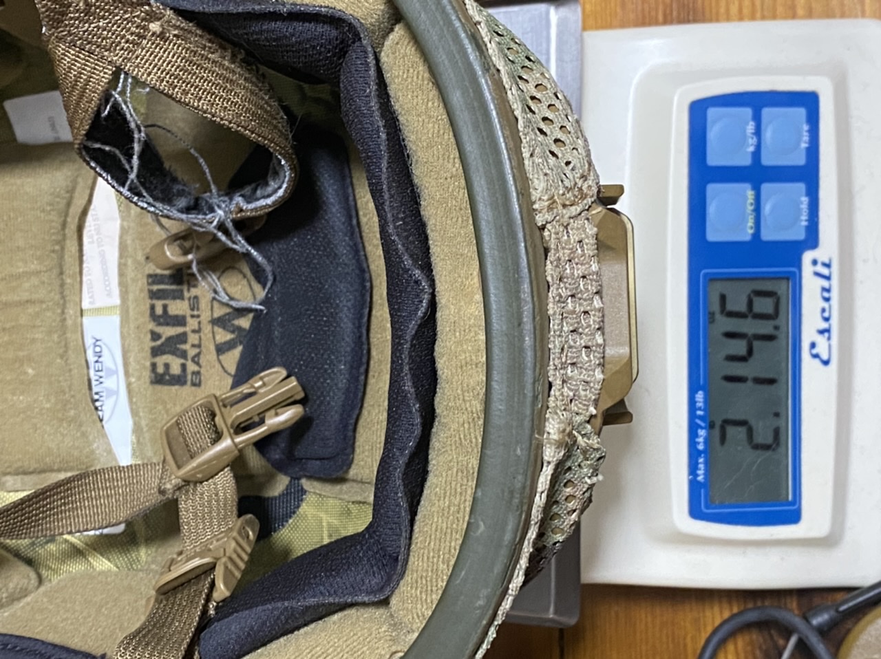

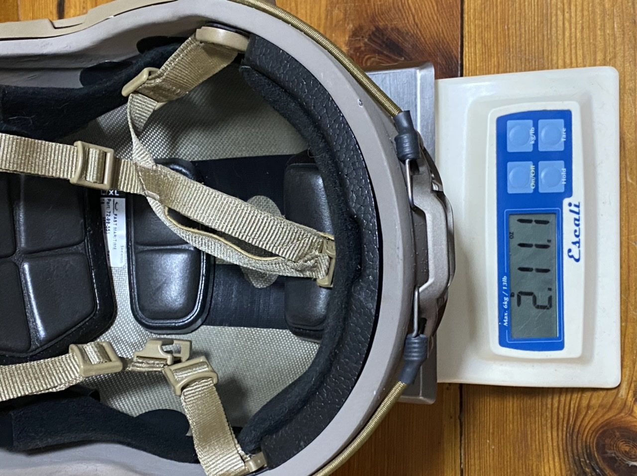

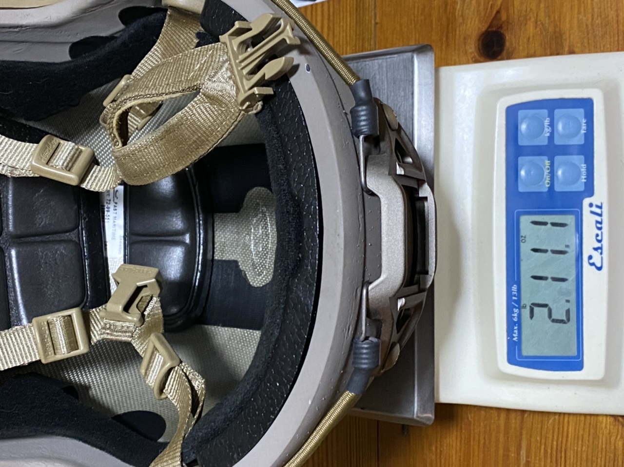

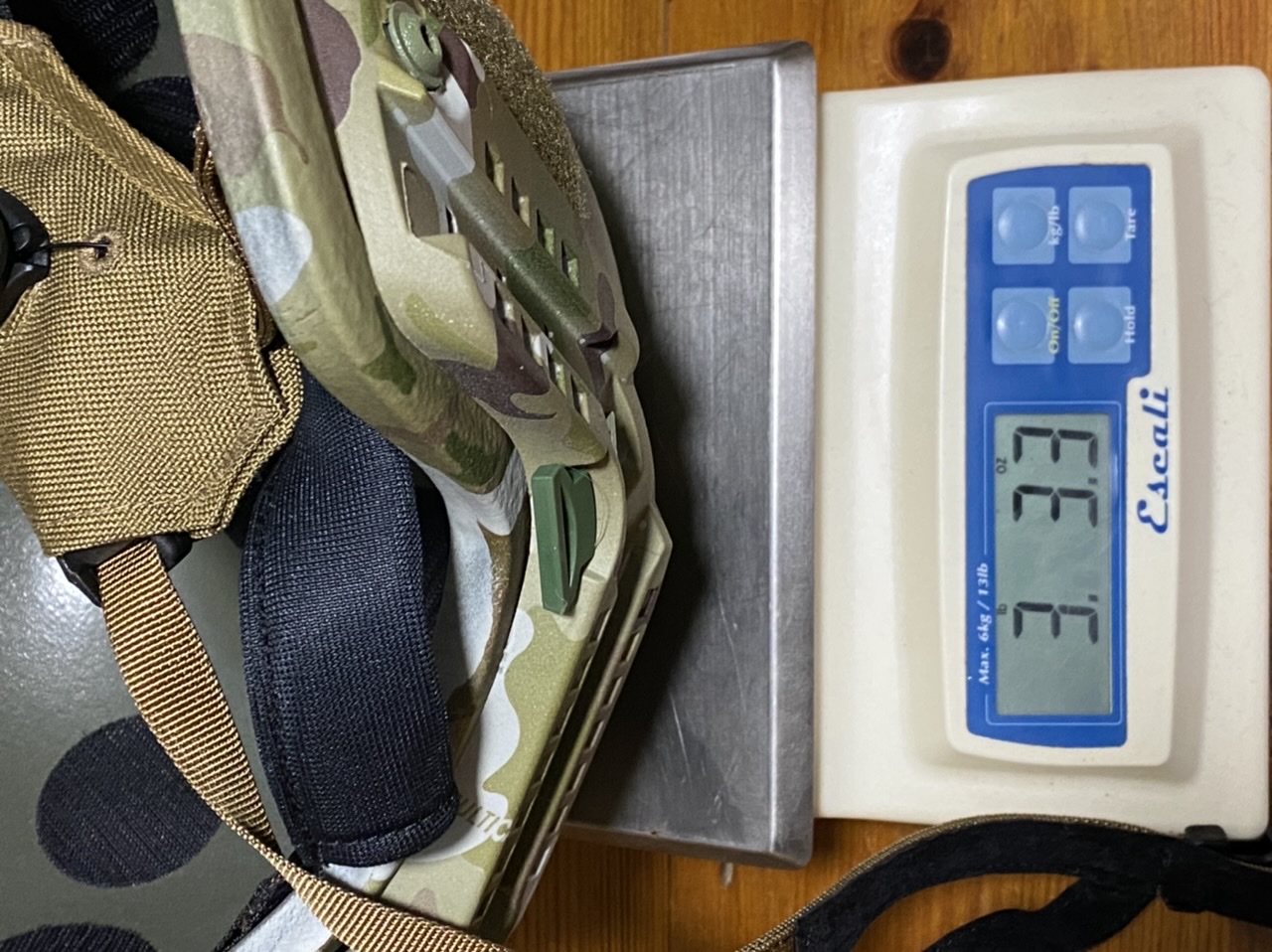

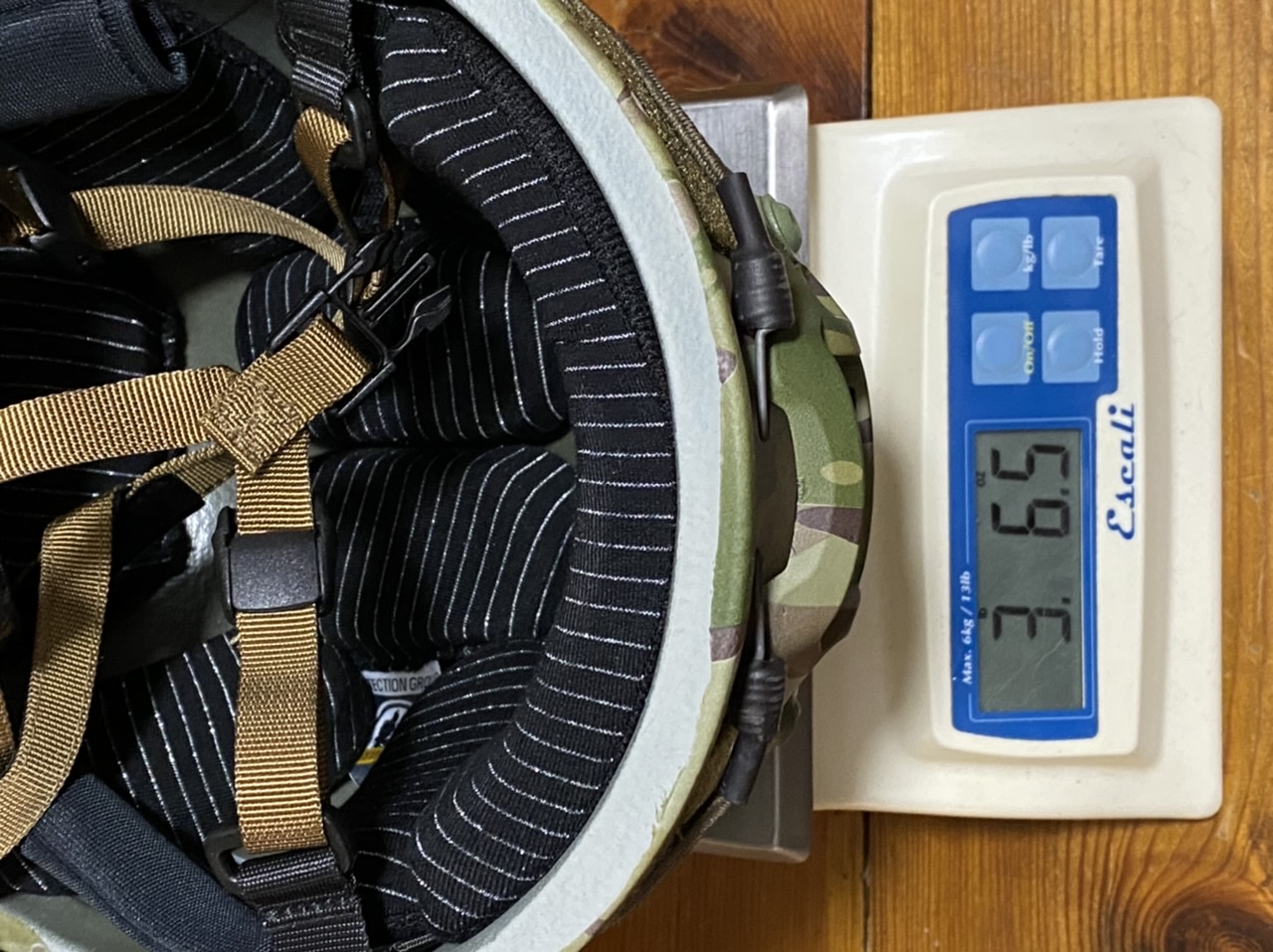

    I just weighed a bunch of helmets that were within arm’s length. A few others, including ACH and MICH are packed away at the moment or out on loan.
    Here are the preliminary results. Keep in mind each of these has the STANDARD “as-shipped” pad/retention system installed, to keep it “even.” Out of every one of these helmets, including the TW and MTek Flux, the PGD helmet is LIGHT YEARS more comfortable. It’s not even close.
    Each helmet is full configured with padding/retention system, rails, and shroud installed, just waiting to be accessorized and ready for NODs
    First-up: The Contender from PGD!
    Next is the greatest achievement in ballistic helmet development to date — the MTek Flux:
    Next, we have the Ops Core FAST Maritime. Perhaps the most UNCOMFORTABLE helmet — out of the box — known to man:
    Next, the favorite helmet of Communist Regimes and Freedom Haters — the Team Wendy Ballistic. The PGD is “only” ~7 ounces more than the TW and is vastly more comfortable, which is saying a lot when the Challenger beats the reigning “Comfort Queen” by TW.
    Last is the OC FAST Maritime clone that was sold by Kota Outfitters. I was told that it’s the same shell HHV uses. I haven’t installed the retention system, so figure another ~1-2 ounces more once installed.

    If I said that, I misstated. The PGD helmet is the absolute most comfortable helmet “out-of-the-box” of any helmet on the planet — including OC/Mtek/Revision/TW.
    That said, adding 4D pads to any of those brings them close to even. I like the shape of the PGD helmet. It is very snug and stable without using the retention system. The BOA system on the PGD is the most comfortable one I’ve used.
    If you can stand the extra POUND above the Mtek, it’s great. It’s “only” 8 ounces heavier than the TW, and in actual use I can’t feel the difference between them.
