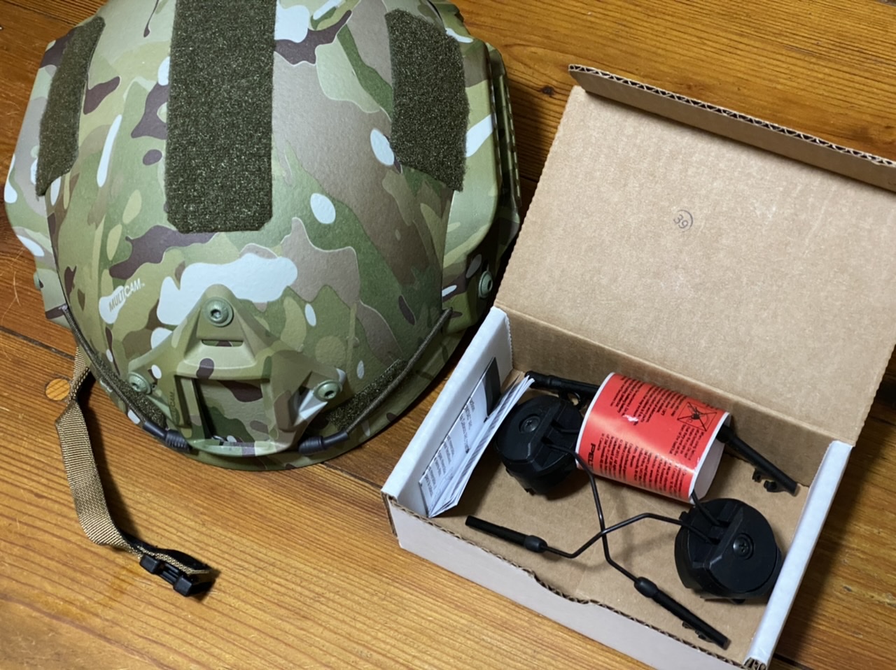

    I just ordered one from bulletproofzone.com in multi-cam. There was a code on their site "BFCM12" for 12% off so it was $369.35 shipped.
    If anyone is looking for Peltor ARC rail mounts they are on sale here. Spend $100 and get free shipping and no tax.

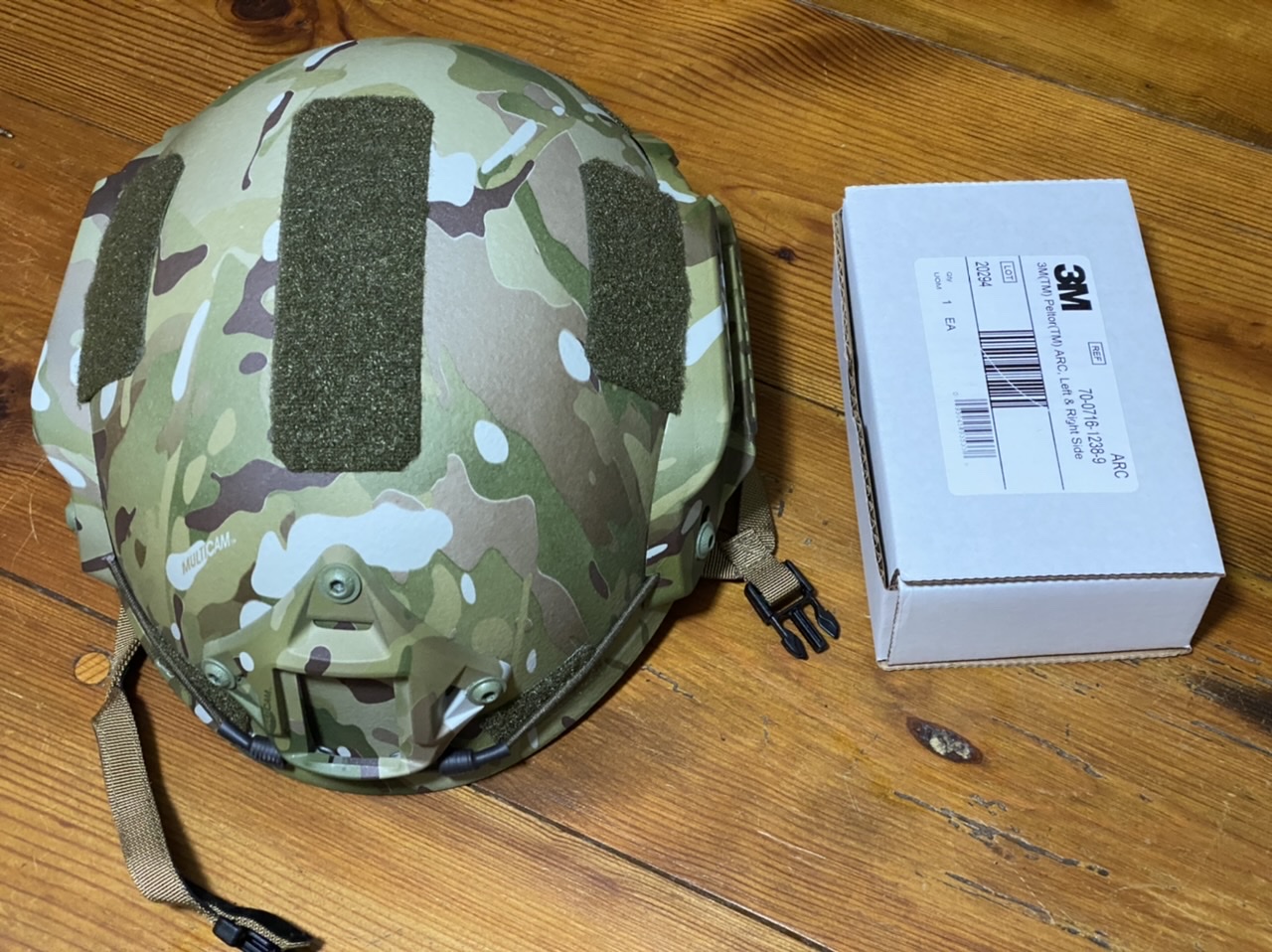

    I just got two sets of these delivered today. 3M factory boxed. Legit deal.

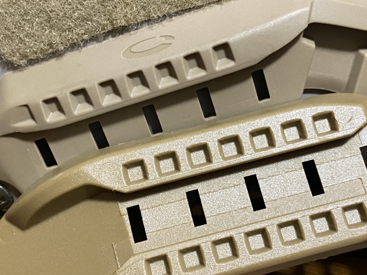

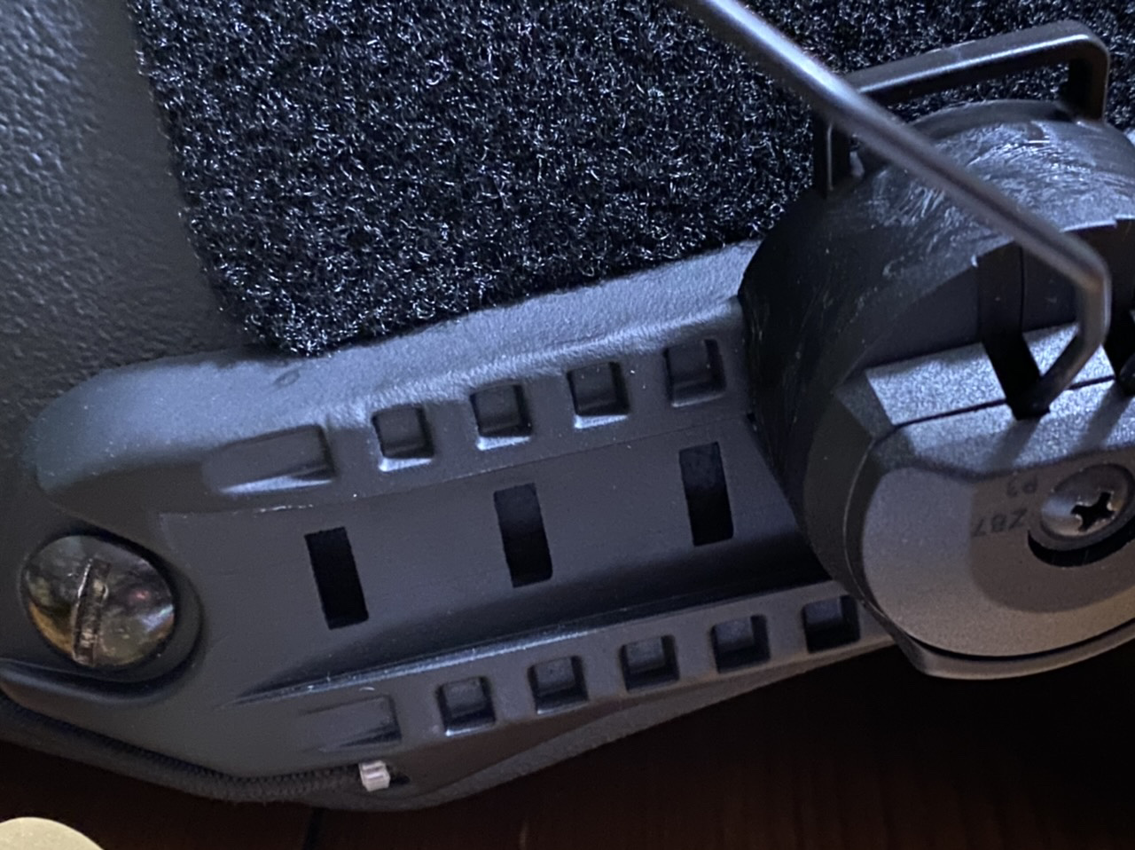

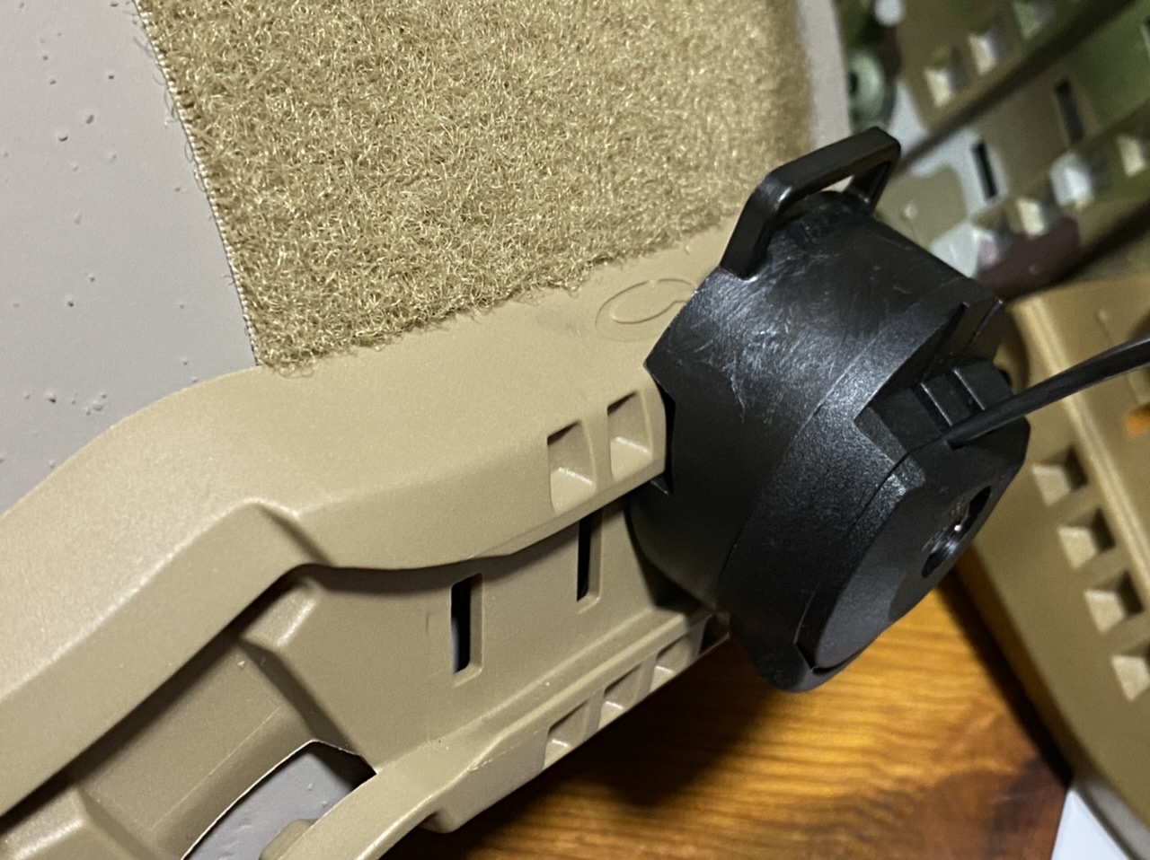

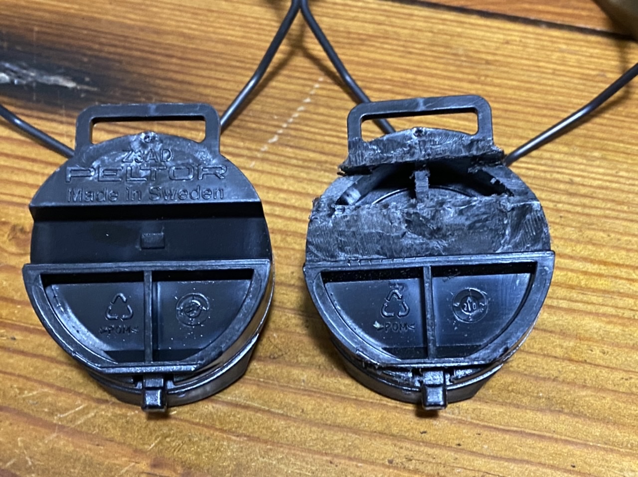

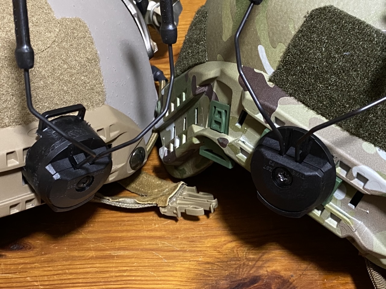

    UPDATE!!! See two posts below for info!
    Houston, we have a problem!
    First, it’s a solvable problem (photos below), but out of the box, the “ARC” rails on the new PGD helmet are **NOT** 100% compliant with the 3M Peltor ARC Rail Adapters — without physical modification!
    I don’t know why PGD would do this. They’re close, and probably work fine with certain other accessories, but they will NOT work with the adapters pictured below (the ones in the AU $50 special) without a decent amount of physical modification (i.e. cutting away material on the 3M adapters).
    DISCLAIMER: I’m no M.E., and I used very blunt instruments to hack-away and make my modifications — a big bench vise and a Milwaukee M18 Multi-Tool (the best tool ever invented). Since the PGD helmet comes with a second set of rails, I may also hack away at those, but my 30 minute hatchet job works perfectly. I have zero doubt that the MANY more mechanically inclined guys on this forum will come up with a far more elegant solution. As it sits, it works just about perfectly and all of the cosmetic massacre is hidden from view, so win-win.
    First, the problem seems to be that there is about 1/8” too much “ridge” at the top of the rail. That prevents the 3M adapter from being able to align with the rail channel. As such, either the rail itself has to be modified or the adapter does.
    NOTE: The 3M Peltor adapter fit PERFECTLY out of the box on both the Ops Core FAST Maritime AND the Kota Outfitters FAST Maritime Chicom knockoff that is supposedly the same shell HHV uses. So it’s definitely a PGD issue.
    PROTECTION GROUP DENMARK SHOULD ***IMMEDIATELY*** REDESIGN THEIR ARC RAILS TO BE FULLY COMPLIANT!!! Or they should order Chicom rails that work as well as the ones on the Kota/HHV lid.
    Here are a series of photos showing the problem, followed by my “fix.”
    NOTICE: How the 3M Peltor ARC adapter goes right onto both the OC FAST and Kota/HHV rails with nothing more than a little elbow grease.
    NOTICE: How there is virtually no material or “ridge” at the top of both of the above pictured rails. Now notice below how there is a clear “ridge” on the PGD rails. This prohibits installation of the Peltor adapters without significant physical modification, pictured farther below.
    NOTICE: I also had to shave a very small amount of material off the bottom to get the Peltor adapter to fit. It took more brute force, after the modifications were complete, to get the adapter into the rail channel, but it locked in very tightly with zero play after all was said and done.
    So... now off to mangle Peltor adapter #2! 😁

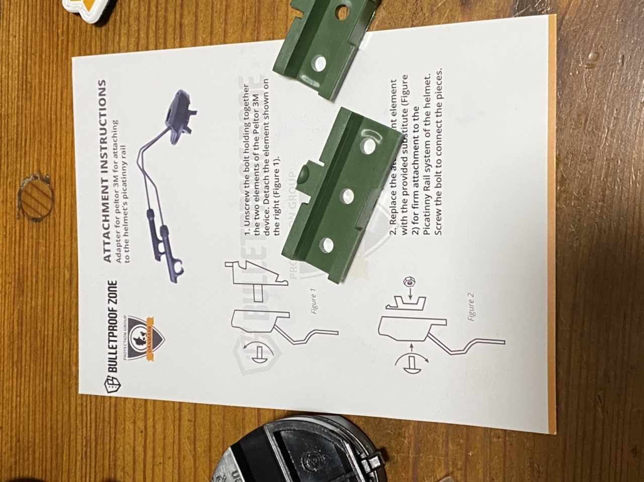

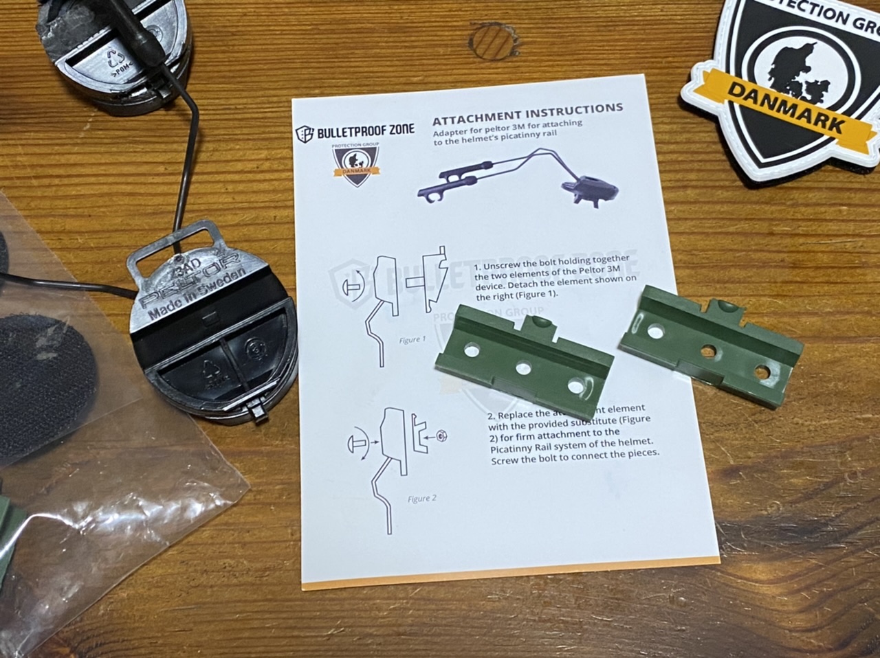

    EDIT: After speaking with the manufacturer it turns out that they have adapters for the Peltor ARC adapters. Adapters for adapters heh. Apparently the helmet was supposed to come with them but mine didn't for some reason. They are shipping me a replacement set which should be here any day now. I will edit this review again once I have them.
    EDIT2: The adapters have arrived. They replace the backs of the Peltor arms. Install just requires a phillips head screwdriver. I had them on in minutes.

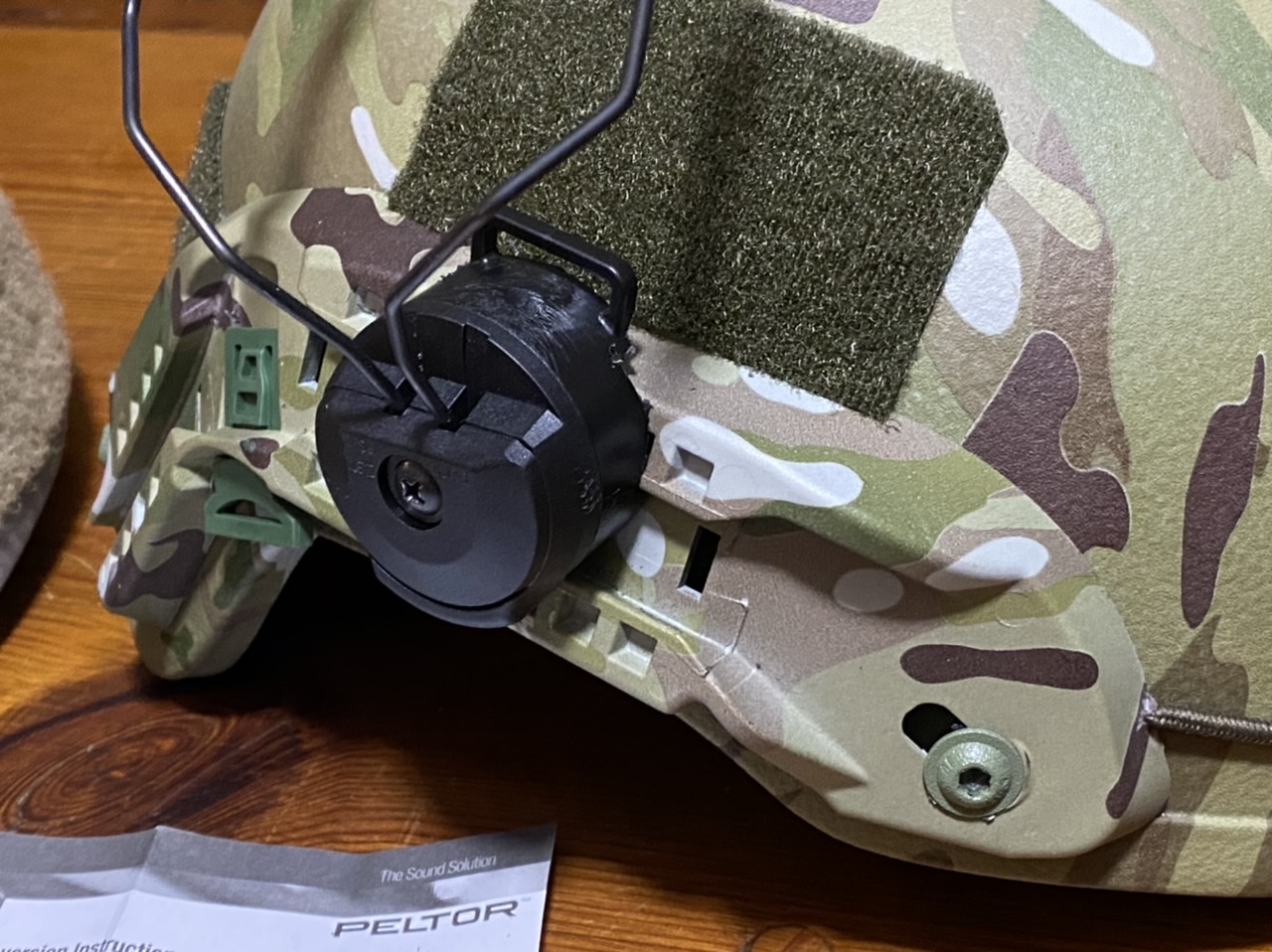

    Welp... it’s official. It never occurred to me to check the bag of accessories and look for something that might help. I just assumed the guys at PGD dropped the ball.
    As it turns out, I **did** get the adapters. If I’m honest, I like how flush to the helmet the adapters make the Peltor adapter sit. See photos below. Simple solution that works VERY well and is much quicker than ravaging a perfectly good set of Peltor mounts.
    I’m a moron!

    Dude get a proper fitting screw driver to avoid all the marring.
    This mans wet dream of night vision and head gear yet he uses the fucked up Phillips head from the kitchen drawer......tsk, tsk, tsk.
    Me and tools don’t jive, bro. I have a tool room to die for, but it’s all for my farm guys. I may touch a tool 3-4 times a year. 😋
    I’m way better at breaking shit.

    Hopefully the ears are still as tight against your noggin with the removal of the stock adapter wedge thing. Pretty sure it gave it a bit of inward cant in its factory config.
    That's what I was thinking as well, may have to bend the wires if attaching that adapter messed up the geometry of how it presses the ears firm against your head.
    Horta, sorry to sound like a broken record, but do you have any other arc rail accessories you could test fit? It sounds like only the top ridge is that is blocking that specific arc rail accessory, is the channel the same width/depth you think?
    That peltor adapter thing looks like it grooves into the channel so it makes me think the entire "arc" rail is not compatible with any actual arc accessory.

    I’ll see what I can dig up. You may very well be right.
    As far as the ARC Peltor adapter adapter, it doesn’t seem to change the angle or pressure of the earpro holders at all. It moves them about 1/2” closer.

    It's definitely NOT a true ARC rail. I've had to modify everything I put on it, at least a little. I've been able to do it fairly easily, so I'm not crying too much, and I'm all thumbs when it comes to engineering anything.

    I believe one reviewer on bulletproofzone's site stated a bit of sanding on the rail took care of fitting ARC accessories.
    Very comfy helmet with good ballistic protection for not a lot of money. The rails are the LEAST important part of the helmet so just throw on a $20 set of airsoft rails if it is that big of a deal.
