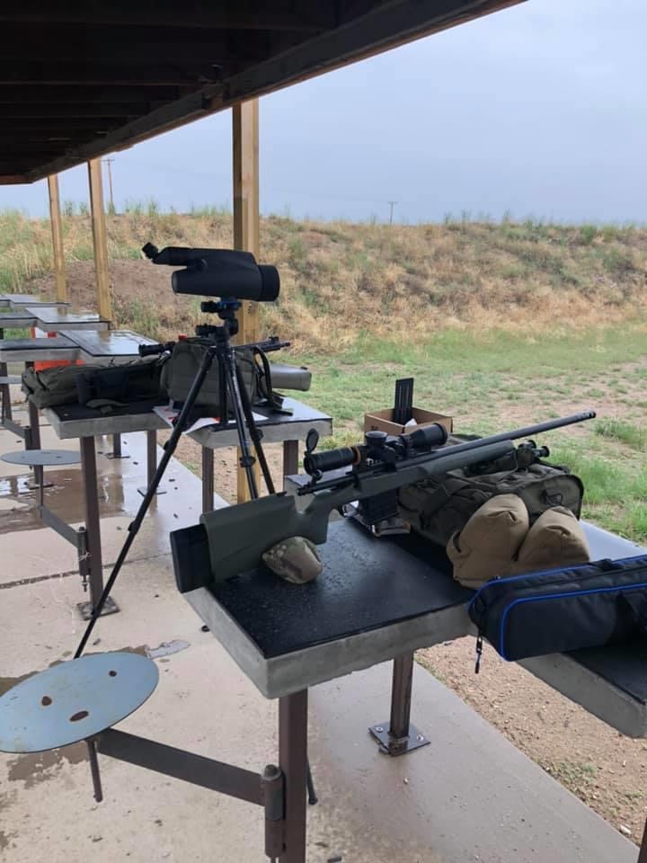

I have a Busnell Elite Tactical DMR 3.5-21X with a 20 MOA Seekins mount on my 5R Mil Spec. Gun is consistently sub .5 MOA and usually well below that if I do my part. Added a Timney trigger and a little work to resolve a timing problem, but other than that, it's a great combination.

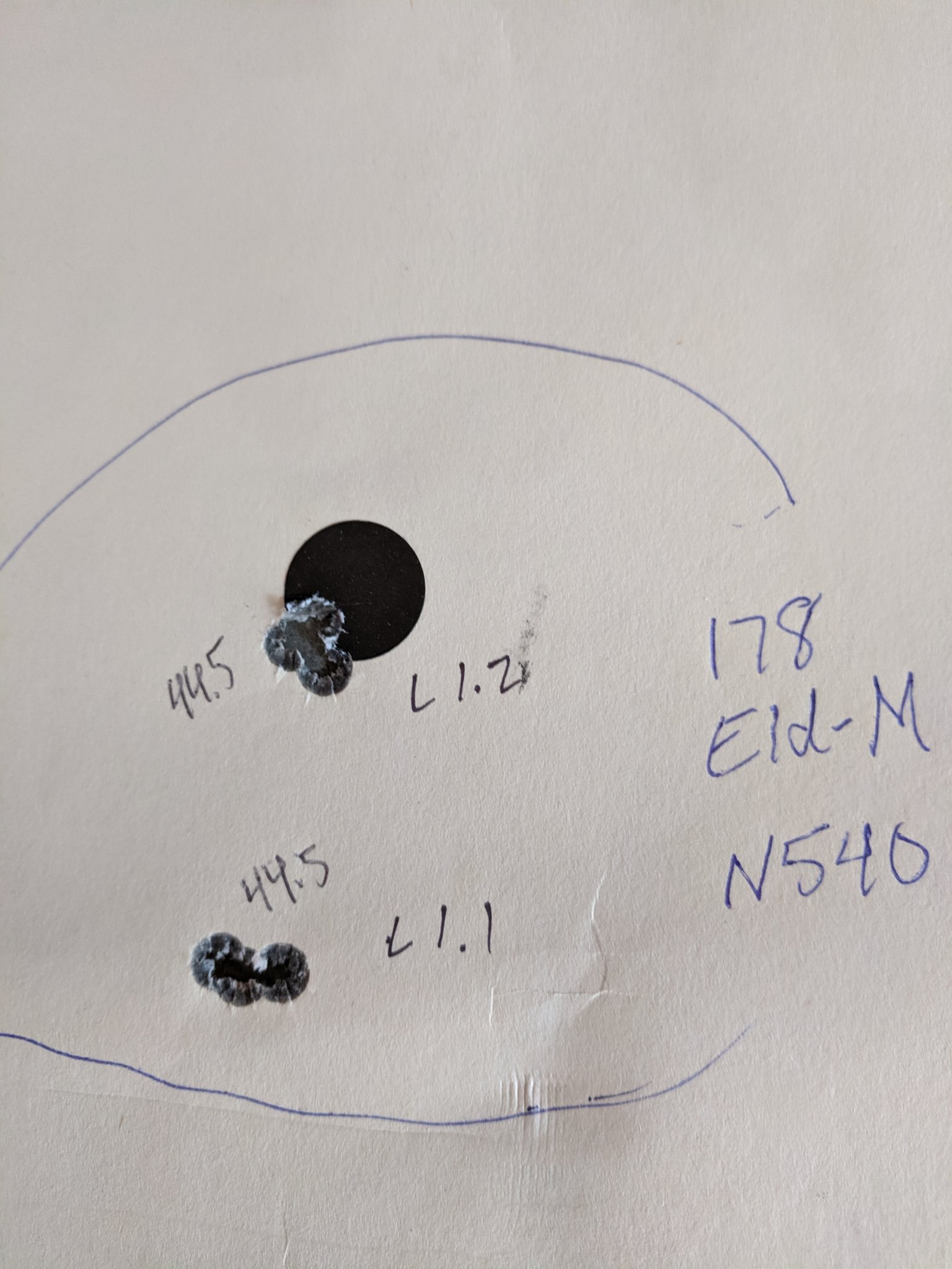

Timely thread- I picked up 2 Rem 5R's on an end of year deal through my FFL buddy. Plus got a $75 rebate on each from Remington. I picked up the 20" .308 and a 6.5CM. Right now I have a 10x SWFA on the 6.5cm and a used Leupold vx3i 4.5-14x40 on the .308 (that scope normally sits on my .257AI). I'm looking right in the 5-25 variable range for both of these rifles as well. I'm considering a Tract Toric, a used SWFA 5-20 HD, or possibly pick up a Mark4 off of Midway (runs $999 for the higher power).
I've only got 30 rounds down the tube on the .308. Broke it in with some Fed Gold Match then started load development with Peterson brass. My second 5 round shots (handloads) produced some really nice groups at my buddies 120yd backyard range.

I've never felt the need for more than 14x on the top end with my R5 Milspec. Plenty of magnification for typical 7-800 yard shots, and occasional 1k shots. As already stated, plenty of good optics at around a grand to choose from. I run an old Leupold Mark 4 4.5x14x50 with a homemade zero stop. Never felt the need to upgrade.

I'm sure when I tune in a good hand load with some ELD-M and ELD-X I can square that one up. Of course that's only 120yds- but do you see a big difference at range by tossing the factory stock?
I'd like to upgrade the scope before the stock- but I keep reading a lot of guys immediately toss the stock.
Mine was always a shooter - even in the original HS Precision stock. I found however that a stock upgrade help me be MUCH more comfortable and consistent.
Try the 178 ELD-x with 43.3gr of Varget with a COAL of just over SAAMI at 2.805".

Aye I can do that. I assume your 5R is also long in the throat? I can park my Chevy 2500 with an 8' bed in there with a round, lol.
With a skim-bed on the HS-stock, I took a tenth out of my groups at 100. The 170-180 class of projectiles with N540 give me groups in the 1's and 2's when I'm on. Amazingly, sorting Fed GMM 175's for proper case length shoot just as well.
Factory, whatever that is. I found that both the SMK 175 and the 178 ELDx like close to 2.800 best in my old, original version circa 2007 (I think). I'll stick with my 1982 K5 with the 6.2 diesel thank you. Leaks and all!
