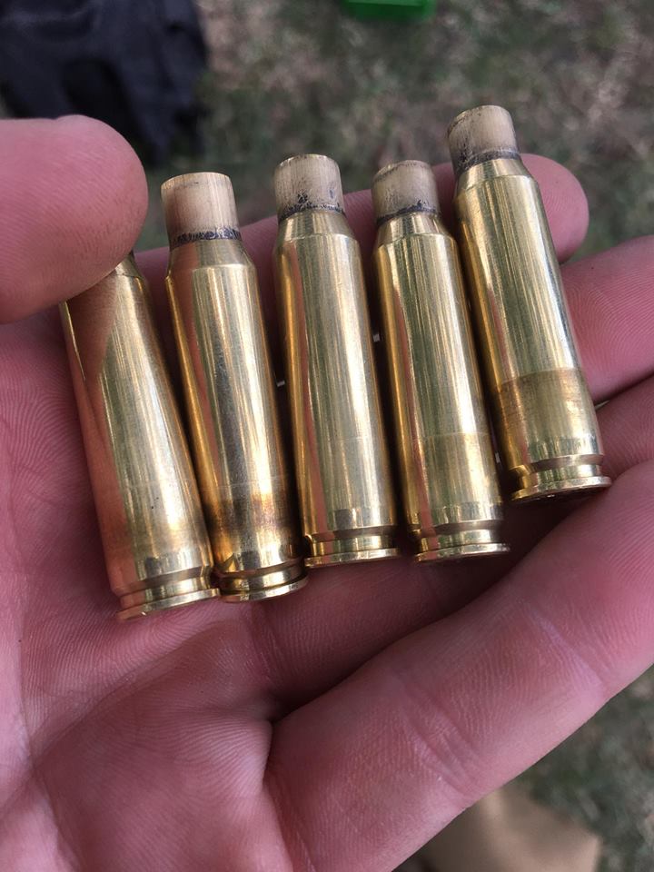

This weekend I kept getting brass stuck in the chamber ruining my stages. I wasnt getting a heavy bolt lift, and it cycled completely normally, other than not pulling the brass out of the chamber and having to knock it out with a cleaning rod.
Every other piece looks perfect, only the stuck ones get this 1/2”ish ring around the base (pic #1 attached)
Cleaned the barrel before the match, put 12 through it to foul it in morning, no issues.
Brushed the chamber out after the first time it happened.
Gun temp doesn't seem to have any effect on it happening or not.
Probably have 2000rounds on this barrel now and this is the first time its happened.

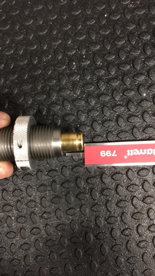

(Pic #2 Attached to show the measurements below)
After doing some measuring...with no forcing, just dropping them into my sizing die..
The stuck brass from base to the opening of my sizing die has .5155 sticking out.
The ones that ejected are .480
A freshly sized one is .397 bumping into the neck bushing and sliding free in and out.
At the same .5155 depth each measure .4685, .468, 466 (respectively)
Testing in the chamber...
The stuck pieces take force to push back in, the extracted ones will drop in all the way but remove easily with the bolt, the sized ones drop in and out no issue.
So what causes/allows the brass to expand at that “height” inside your chamber and not allow it to be removed?
Is it a weak section of the brass there allowing it to expand too much and puts too much tension on the brass and chamber walls?
Junk brass and I should just buy a few hundred pieces of Lapua and start load development over?
Sorry for the long post, I'm stumped on the issue. Thanks in advance for any help!

Have you checked to see if there is a difference in case head expansion between the problem cases if you have a blade Mic?

Yup, at the “problem” spot on the stuck cases, they are .0005 thicker than the fired extracted cases.
I figure its a problem with the brass, but I’m no reloading pro so I thought before I throw a shitload of brass out I would look for some better informed opinions.

I'm at work but just off of memory I recall anything over .0003 is excessive in relation to your other fired brass.

46 is max under a 168, and that’s in a Win case that is 13grs lighter. 45 is max under a 175 in a Win case. 44 is max in the case you’re using. You need to improve your attention to detail. Reloading is about detail. Details will make or break your load and equipment, like brass.
Brass is elastic but it also has limits. When you overcharge you exceed these limits and your sizing die can no longer change the direction of springback. In a normal reload, brass expands to seal the chamber then springs back a little toward its original size so you can easily extract it.
In an over pressure case, the sizing die is unable to size the case sufficiently to ensure the direction of springback is toward the bore center. The case springs back toward the chamber wall, away from the bore center and your cases stick to the chamber.
One way to treat this is through the use of a small base die, but that only gives you an additional .001” of sizing and may not be enough. I suggest you trash the lot and start over and don’t exceed your current load.

Because book max is 45grs in a Win commercial case that weighs 157 grains and he loaded 47grs in a 168gr case. He’s at max pressure with his 44gr load and he went 3grs over. He put a .30-06 load into a 308 case. There is no 308 chamber on this planet where his load is not excessive.
I’m not saying his load is dangerous to humans, but it definitely is dangerous to his brass and explains his current predicament.
