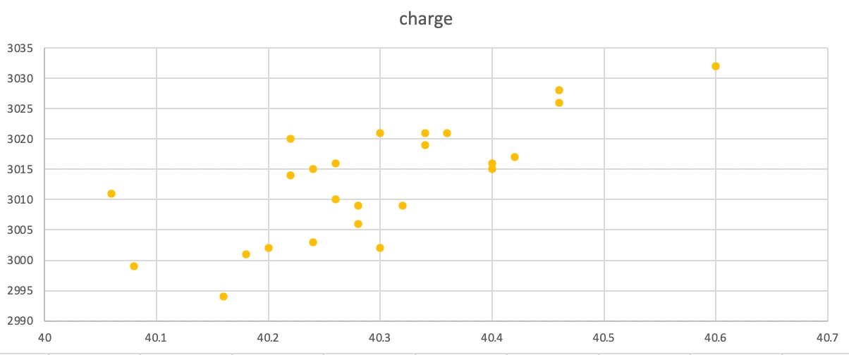

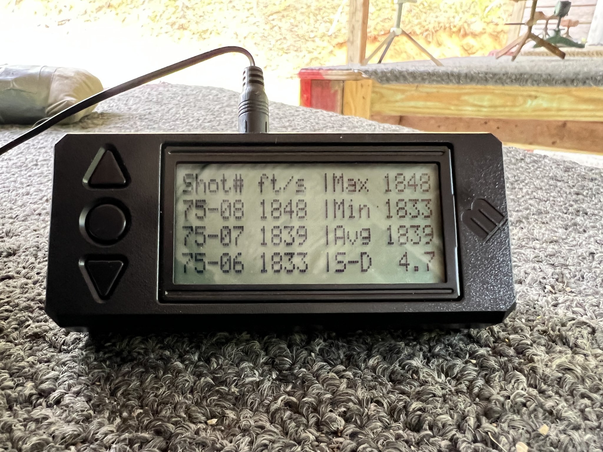

Just an update, my Hornady with A1680 is very consistently measured on an Fx120i tonight. 0.04 difference after 50 rds of 300 Blk getting loaded. Most of the time 0.02 or on the money. From an 8” barrel It doesn’t seem to make a difference. I didn’t have exact numbers when I posted previously but wanted to state it accurately. 🍻
Edit: Here’s the SD Seekins SP8

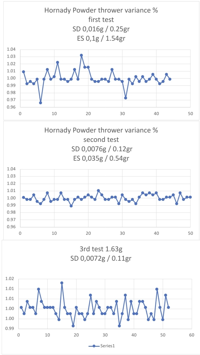

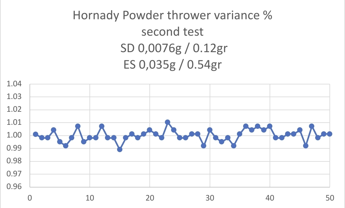

I bought the Hornady kit and have recorded quite many lots of ammo I have throwed.
Here is N540 or N140, N540 meters slightly better.
Charge at "100%" was 25.36gr.
Edit:
Here are all 3 of my tests that I have now graphed. The first test was one of my first runs with it and I had not yet formed a technique to using it. (One the reasons I started documenting)
Looks like .1gr is the SD that is to be expected when using it properly (no yanking the lever, avoiding shaking the table). I do use it swiftly.

This is a graph of charge weight vs velocity for the 25 thrown charges of H4350. You can see there is a relationship, as we know, but also that there is a ton of noise.
The key thing to understand is that noise does not add linearly. Many assume that is true and therefore even reducing a smaller source of error will result in a noticeable improvement in the system. But noise generally sums as the the root mean squared (so the combined effect of A and B is not A+B, it is sqrt(A^2 + B^2)). This means that the largest source of error tends to dominate, as it does here.
I’m not saying weighing charges never can make a difference. But it won’t always, and given the enormous time penalty it would be wise to test this in your system.

I think the other question would be what is the SD at the target with weighed charges.
A lot of people are going to jump on this and say an SD of 35 is horrible, not understanding this is measured at the target and not the muzzle, and therefore incorporates the effects of differing BC and wind as well.
You bring up a good point. There is a certain amount of BC variability in each of the rounds themselves that affect velocity in flight. It's entirely possible that the SD at the muzzle could have been lower, which makes an argument that a .1gr variation may even be less important. The Shotmarker is not "calibrated" and velocities may be completely inaccurate. As stated, this is a small sample and there could be other variables that put these results in a better light.
