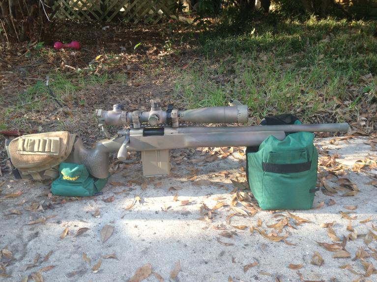

Are you trying to stay under a certain weight? Certain barrel length?
This one came in right at 10lbs as pictured. It was short and handy, but I also shot it on steel out to 1,100 yards without issue.
.243 shooting 115 Dtacs
