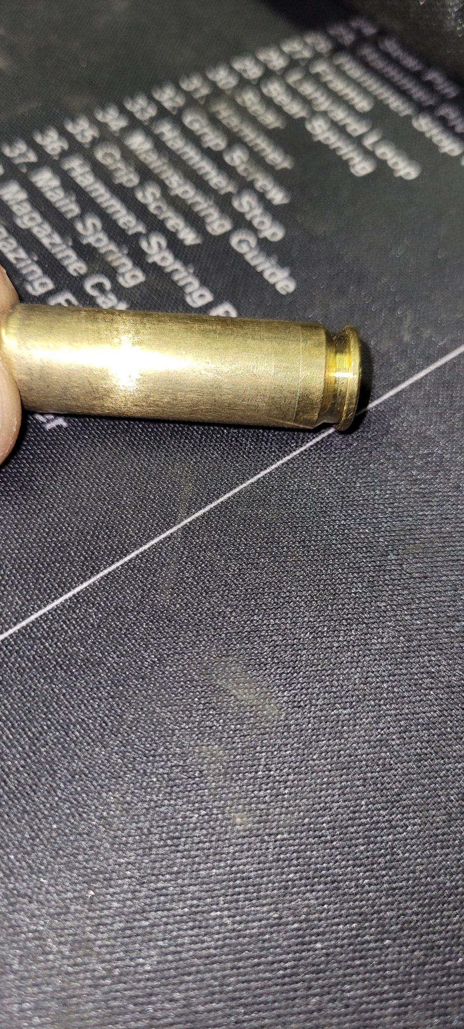

Help me figure this out. Bulged case head.

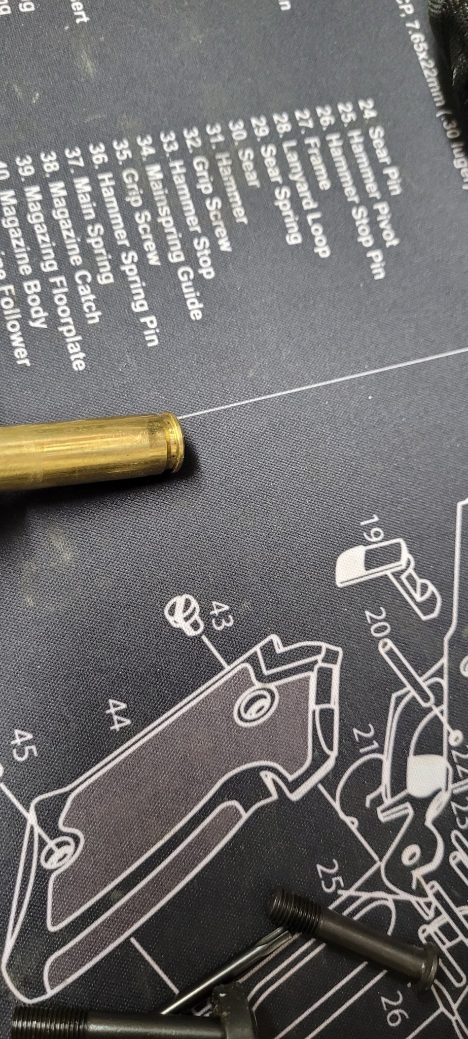

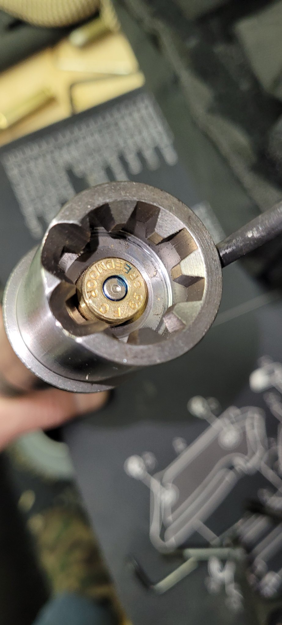

Update. Shot factory federal 123gr American eagle and did a full work up from a minimum load in the Hornady manual with 6.5 staball. Federal showed a less pronounced ring around the brass and mild book load started showing a more pronounced ring starting at 39.7 gr of 6.5 staball with 143 eldx at 2.800 with win LR primer.
One year later, talk about "back burner". It's probably just the angle of the pic, but that feed cone looks eccentric to the bore.

Well, that looks like insipient case head separation ... blown and lost primers are generally good sighs of over pressure.
Those are what is known as "clues."
Your loads are over-pressure in that barrel. The "ring" that you're seeing is the brass flowing into the recess of the barrel extension.

The hottest load I checked had a.010 bulge around the back of the case ( belted magnum ) and one of those lost a primer and it jammed it's self in the bolt cam pin bore and locked the gun up.. needless to say I stopped there.
Shot some factory 123 grain federal stuff and brass looked fine, shot some of these same loads with the same brass out of the factory barrel and they looked fine. I did not run a set of headspace gages through this rifle after the barrel change. What are you guys thoughts? Thanks in advance.
Loads were 39-43 grains of rl17 with 143 eldx set at 2.825 coal. Win primers

I'm not sure I'd blame the guy who cut your chamber and bevel. Your factory rounds didn't show any brass flow but your handloads seem to show you're really pushing the boundaries of the limits of physics, chemistry - thermodynamics, and metallurgy.

Factory federal IS showing the same thing
OK, I see your post in #64 now. I see a ring, but not the raised belted magnum ring.
Yes, the bevel at the bottom of your chamber is excessive for your Reloder 17 loads.
You are being saved from a rifle kaboom only because the brass at the bottom of the case hasn't ruptured while it was being forced to the limit of its elastic strength, forming that raised belted magnum style ring.
If the case isn't supported the brass will simply flow until it ruptures at the web. Example (excessive headspace in a bolt rifle in this particular instance):
