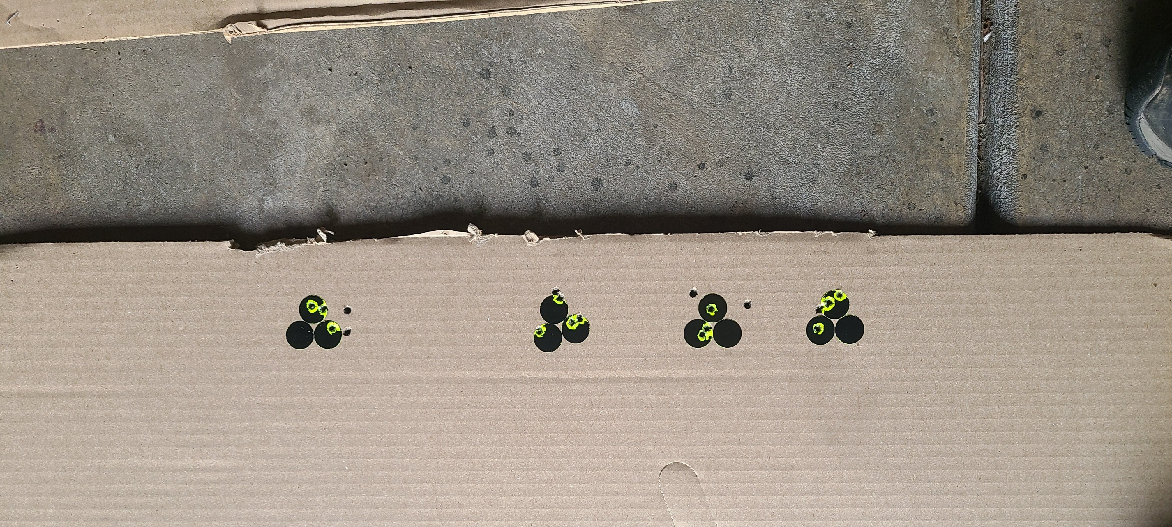

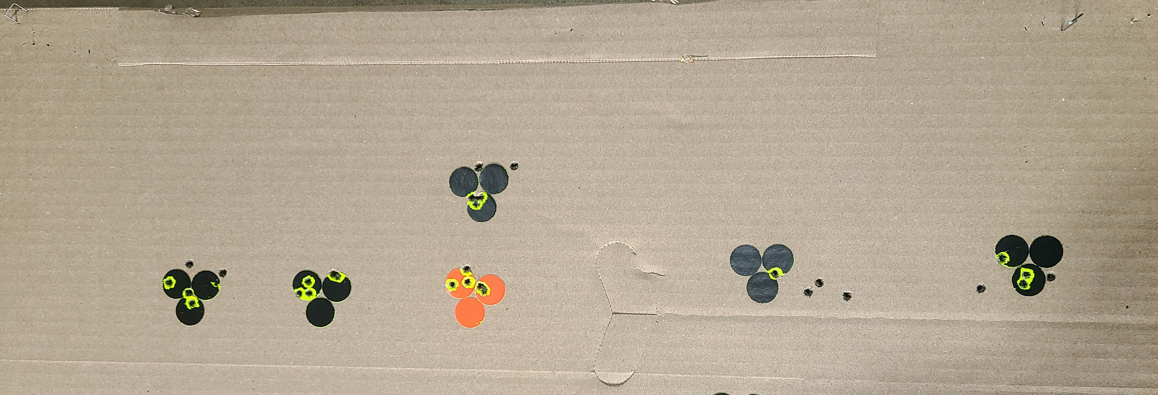

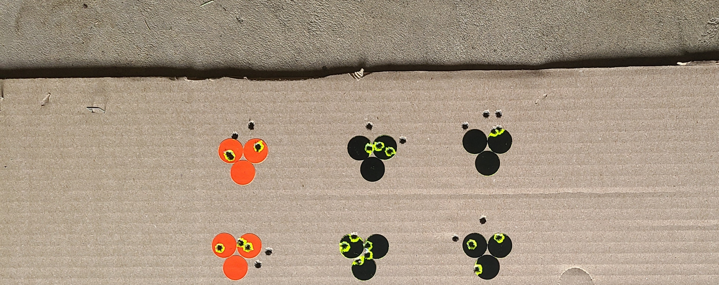

At least it feels the same kind of witchcraft as reading tea leaves. Unsure the degree to which it's possible but I'm looking for help reading the targets and determining most likely points of error in my shooting. I'm struggling to shoot consistent groups and to rein in the flyers.
I seem be able to put 2-3 on or near one another, then the remainder are usually either high but about on horizontally, or high and right. From time to time get one or two a bit left.

The targets:
All shot at 100 yards
Dots are IIRC 5/8", pasters from a Shoot N See
5 shots
Prone off a mat
Each group I completely reset position.
Pictures ordered first to last

What are you using for aiming point? Do you have all 3 circles the entire time you're shooting? I use half inch circles. The idea is aim small, shoot small.
Center, bottom dot(s), top edge, just about where the void begins.
I used to shoot single dots but thought I'd try a different pattern because I was getting target anxiety with the single small dot, and rushing to break the shot. So just trying something different.
Your target is too big when using 3 dots. Use just one. If you consistently aimed at the same dot we could have a better chance at interpreting it but the dots aren't aligned the same for the whole target so it would be almost impossible to extrapolate any data resembling results from these groups.
ETA: You posted above while I was typing. If the center was the goal then it appears you are looking at finding your cone of fire for the combo you have. Different ammo will likely produce different results. I used to get target panic on small dots as well. I fixed this by decreasing zoom a bit.
These are pretty acceptable groups for a factory rifle shooting factory ammo.
I see most shooters learning to shoot using way too much input from their trigger hand on the gun. You want zero input into the gun from firing hand other than a trigger squeeze.
I can't speak to the ammo, but most all of my factory 223s shot better than that with 26.6 and varget and a decent 55g bullet. Unless there was something wrong with them. Granted this one could just not particularly like the ammo. Are you sure it's you not the rifle? A video of you shooting woukd probably help on the cheap. Some professional instruction might help not on the cheap. Probably best not to start out learning to do everything wrong like a lot of us. 🤣🤣🤣

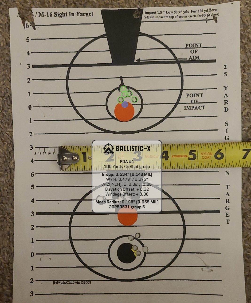

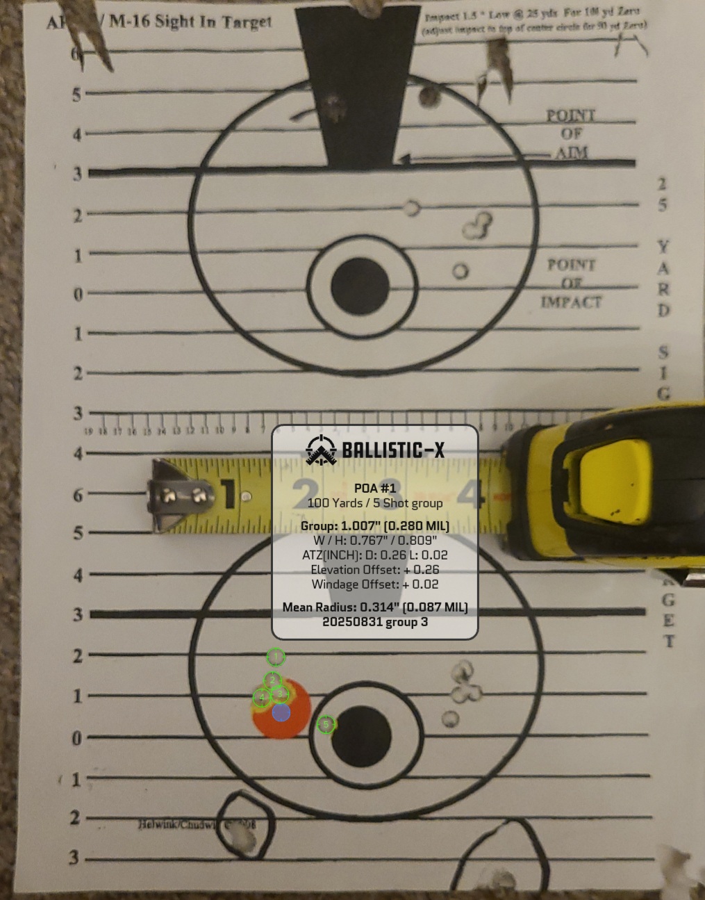

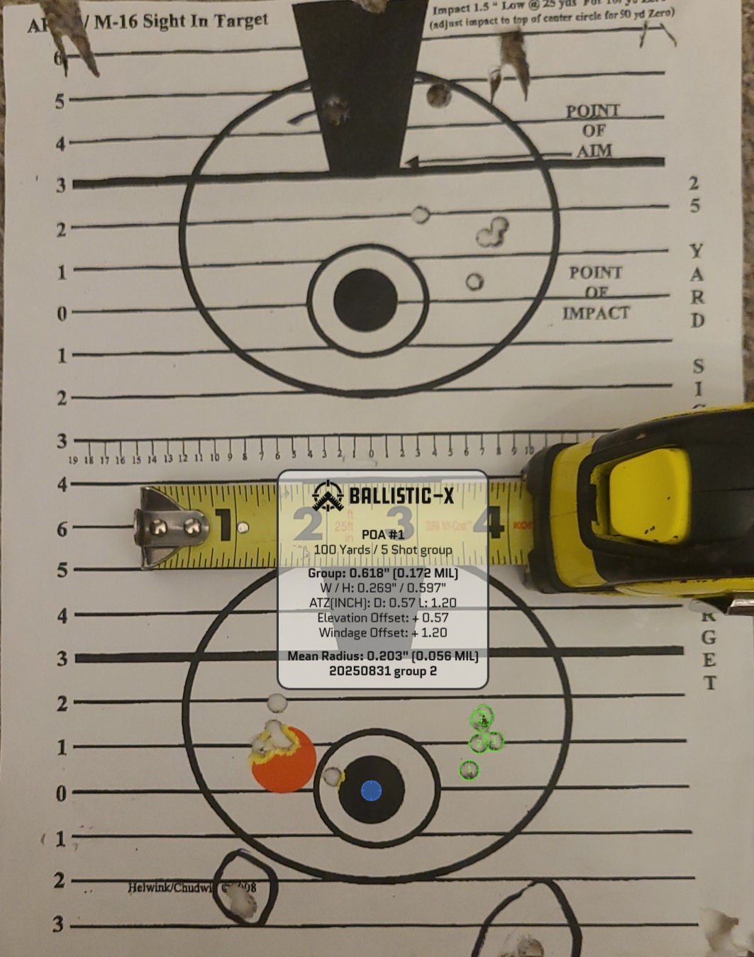

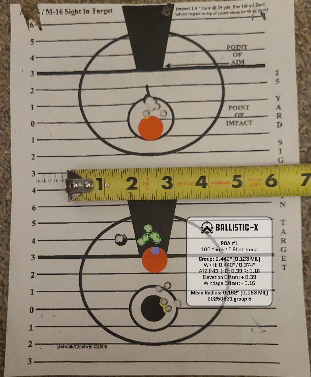

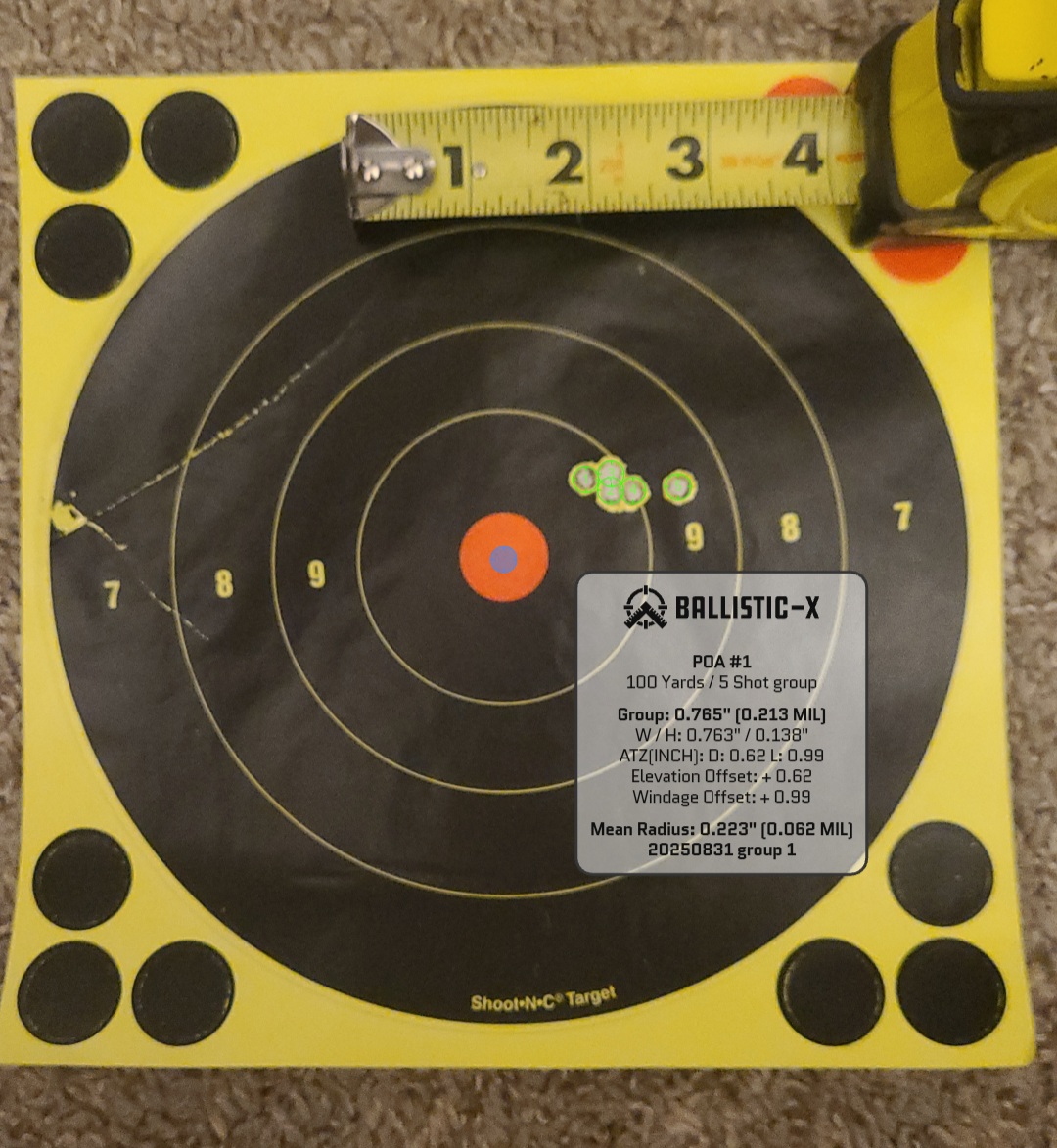

Thread update: I'll be attending a class with Frank and Marc and it kicked me into gear to upgrade my setup. Enter: KRG Whiskey 3 in Sako Green, T3x CTR inlet. I had it modified for a left-hand action, and dropped the action in yesterday. Torqued the action screws and adjusted the foreend to tune magazine insertion and removal. Today I hit the range to give it a shake down run.
I think I need to move the optic a slot or two forward to get a more appropriate eye relief. LOP seemed fine to me. Adjusted windage 3 clicks left. I know I had issues maintaining consistent firing hand pressure group to group. I fidget too much in the position between shots.
Tikka T3x CTR left hand
.223 1/8 24"
KRG W3
ARC M-Brace 20 MOA 1.5"
Burris XTR-iii 5.5-30 SCR2
Accu-Tac PC5G2
Norma Golden Target GTX 69gr
Best 5 shot group: 0.442"
Worst 5 shot group: 1.007"
Average of 6, 5 shot groups: 0.668"
Reactions: Jscb1b
Take off the bipod and use a front sand bag (a Bull's Bag and rear bag help with lateral stability and minimize left-right roll).
Try a benchrest target. You quarter the aiming square with your crosshairs and off-set your group so the aiming point is consistent. This is a 10-shot 308 group from a tuned and bedded Remington 700 Varmint:
