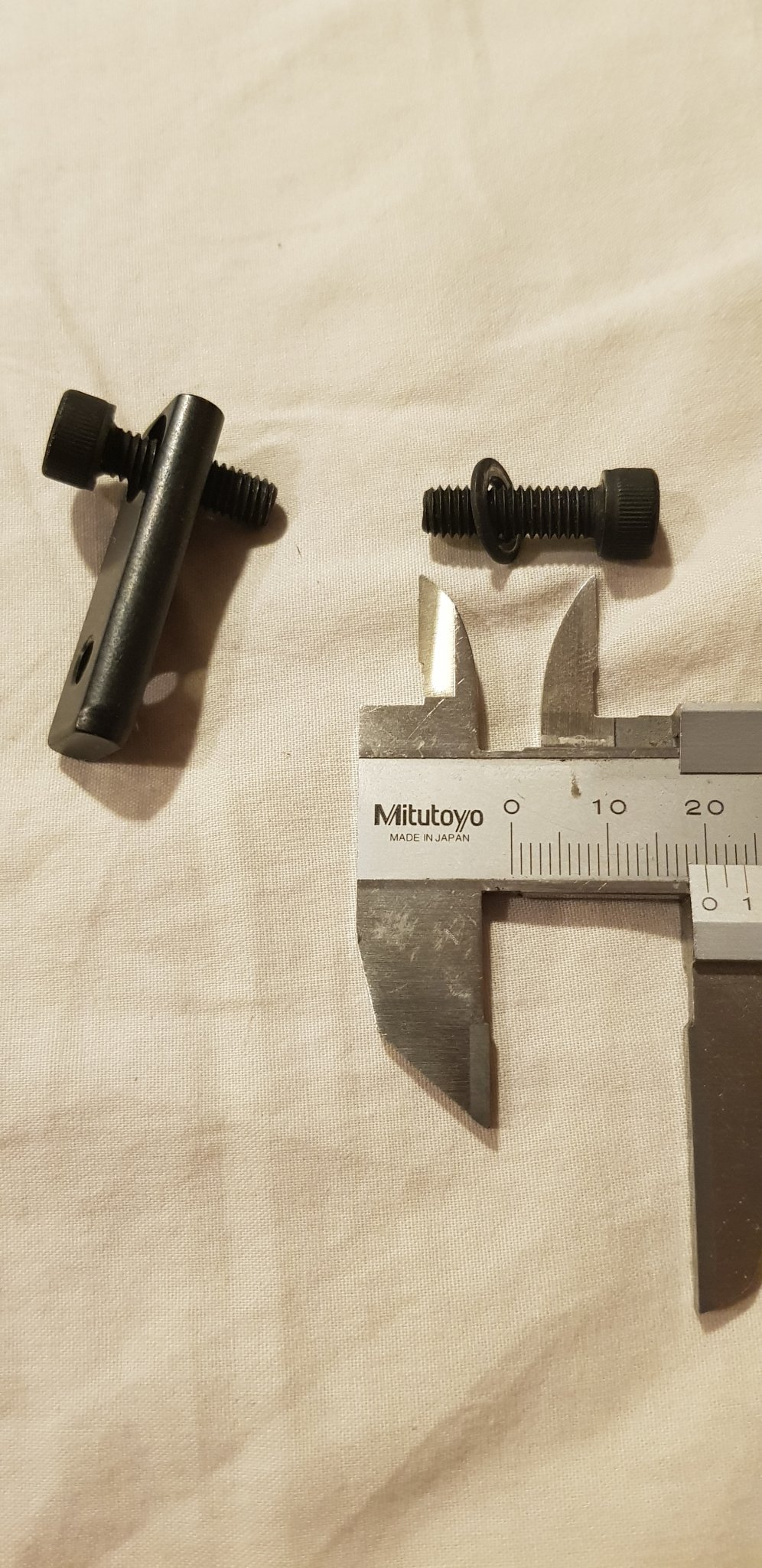

Its actually good that I saw this thread. I have a used TRG with both the KRG folder and stock rear, however I seem to be missing the part on the stock rear that the top action screw threads into. I am guessing it is that flat piece of metal shown on the left above?
I dont know about the KRG stock since I only have the KRG folder attached to my TRG, but that piece of metal is what is used to "pinch"/attach the rear stock to the rail.

M6 x WHAT THREAD ?
It would be listed as something like M6 x 1.0 x 25mm long
12.8 is the bolt strength
Could be M6 x 1.0 or M6 x 1.25....???
BTW, without seeing more of the pic it certainly looks like the bolt you have there is 20mm long, not 25
Unless specified, standard. M-thread, this size, std or fine. Fine is specified.
Yes.
No.
MC6S screws length are defined by free shank length. Typo? Pic should provide more than enough info...

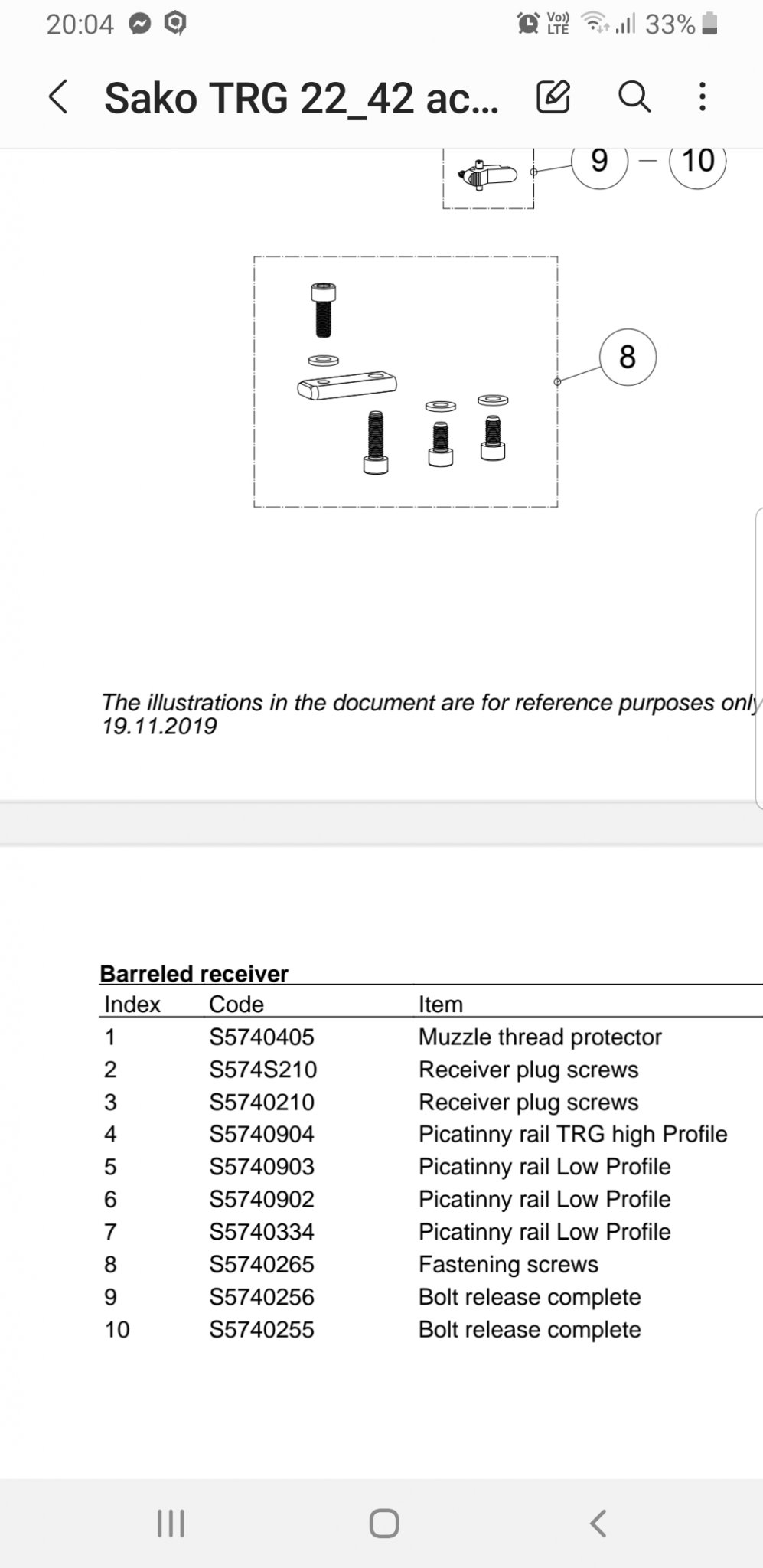

@CerebralDistortion - where is that part diagram from; telephone number to order the fasteners (SP# is S5740265)

Part diagram is from sako.fi support section. Spare part and accessories brochures are available for download (not always complete though).
If you want to call and order, contact your local Beretta dealer (possibly Beretta online but I doubt it).
