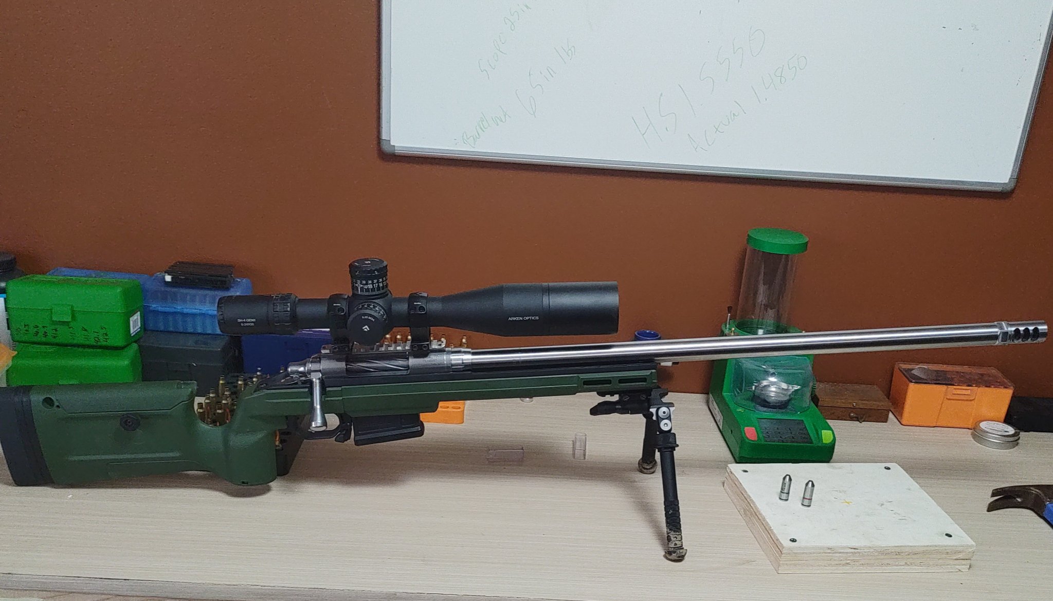

Went with a straight 6br bull barrel from NSS. Was a little worried about clearance in the chassis and couldn't find much on it. It's got plenty of room, so I'm happy. Nothing left to do, but hunt down some varget and start shooting. I have h4350 that I might give a try. But I can't find any published load data for that powder...or any for that matter.

H4350 is a step slow for a br really. A step faster into the varget/4895/rl15.5/n140 etc will be your happy spot.
Hodgdon and vihtavouri have some br data.

Sounds good! I only have 1 pound left of H4350. And about 100 Hornady 105 bthp that I got for $25 bucks. So maybe I'll use it to fireform the brass and not waste the good stuff, and still get some time behind the gun
