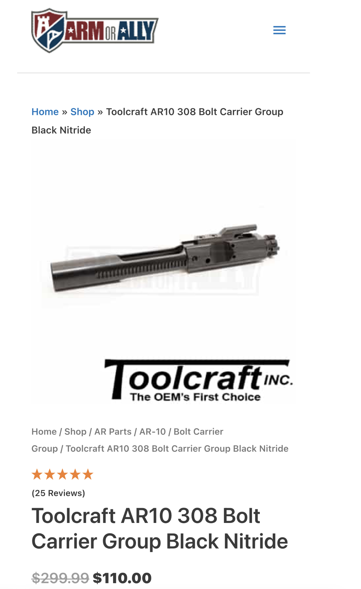

So I see a site has the Tool Craft BCG’s both single ejector and double ejector on sale for $110. Double ejector bcg has the small firing pin hole. Any issues with this and which to get? Precision and reliability in mind.

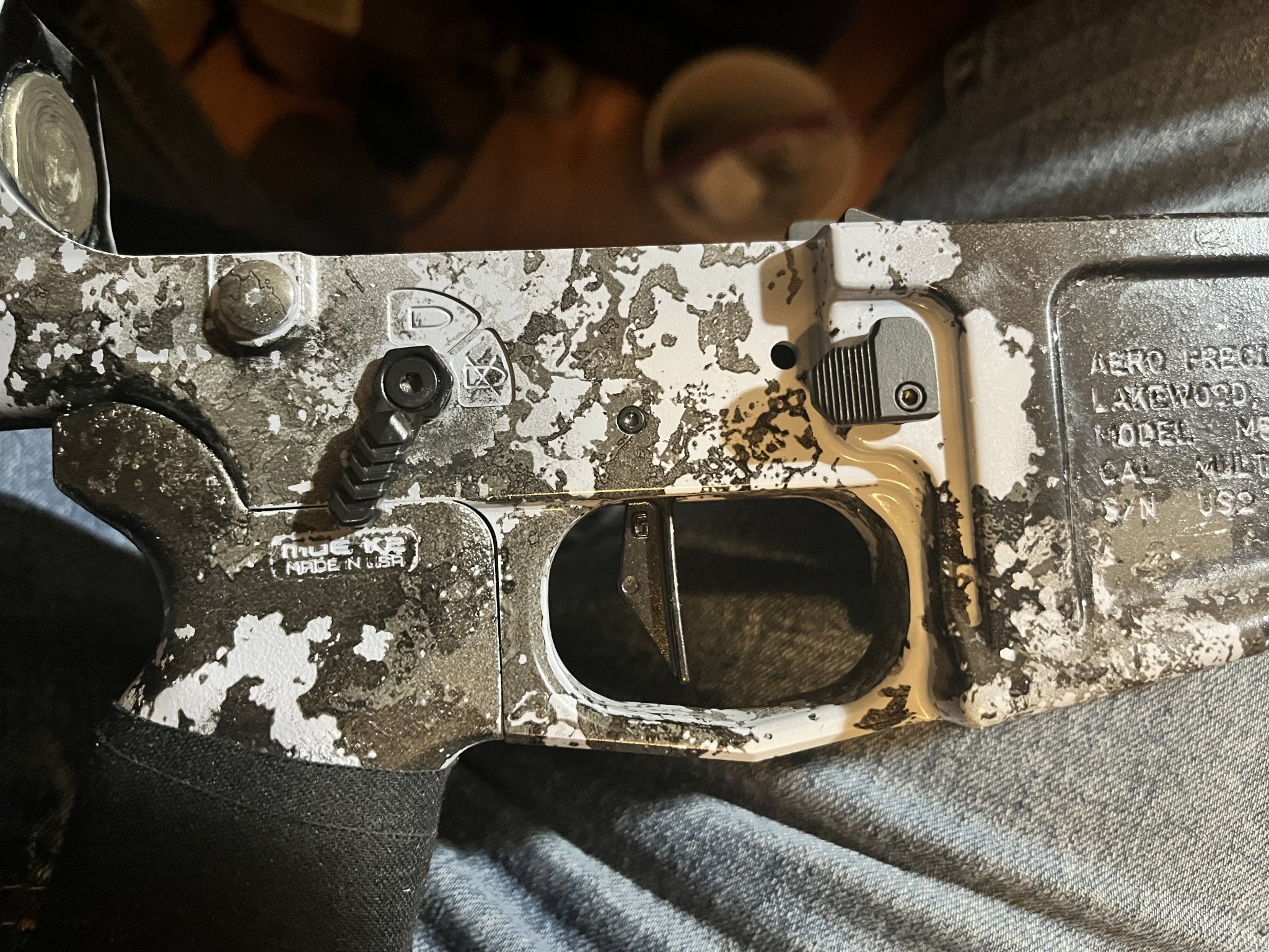

if the lower receiver you are using has these red-circled notches, then you should be fine with a squared fat-end 308 bolt carrier.
The aero lower doesn’t have those notches looking at them online. And the Toolcraft bcg looks like it has the squared notch not like the Aero bcg that is slanted…. So guess Aero it is…. That’s what Compass Lake uses anyhow is Aero bcg’s so I may just let him add a BCG with the barrel.

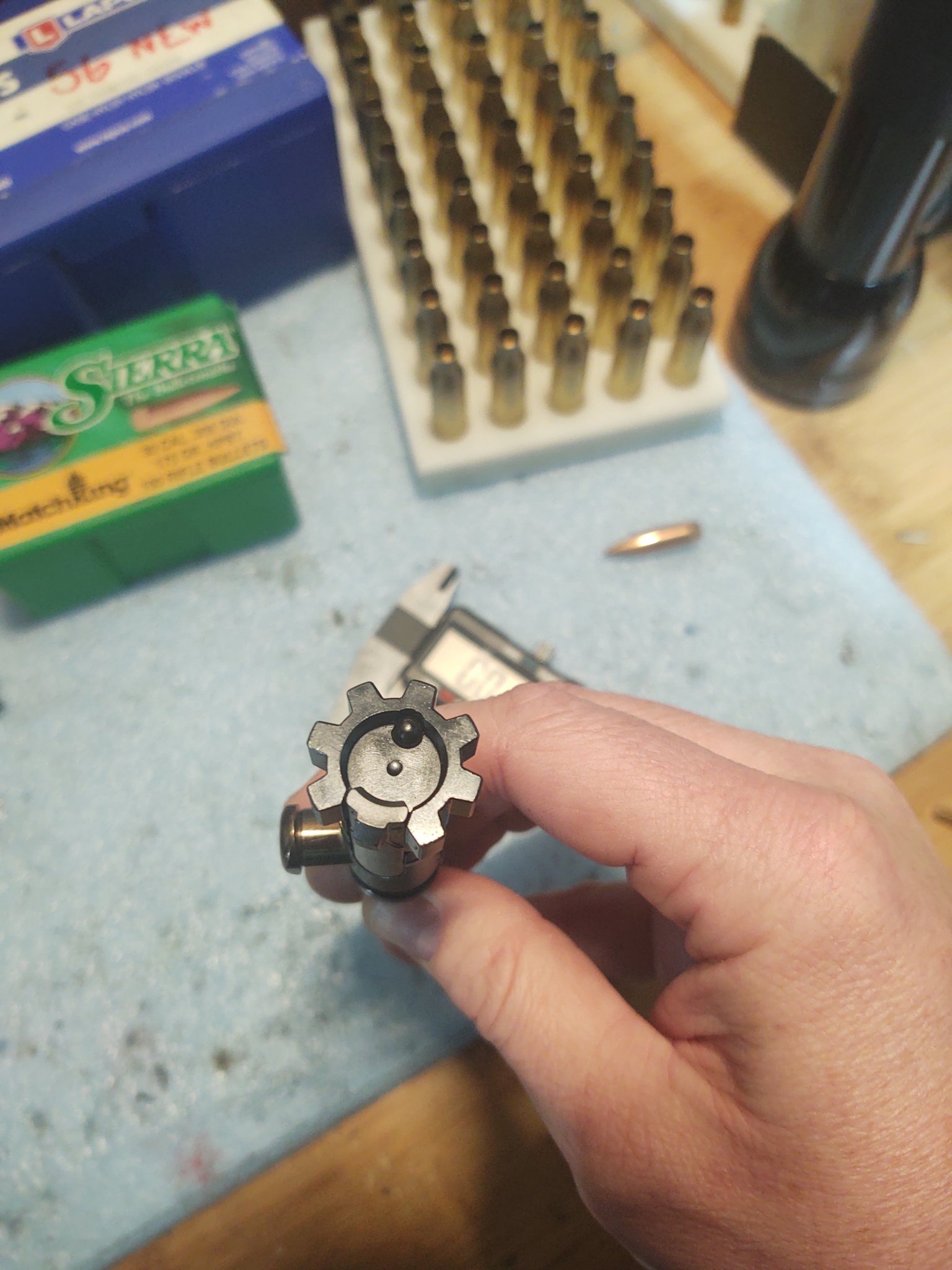

My Sharps Rifle Company BCG has the slanted bottom, and bolt has dual ejectors with smaller firing pin/hole.
About to swap out that bolt for a JP HP bolt that was matched to my new Criterion barrel that should be here any minute. I don't have headspace gauges, and have been fighting to get my 308 ar10 to shoot decent groups with 168/175s since I built it. 16" Satern Liberty barrel hasn't been able do better than 1.5-2 moa over multiple 5 shot groups...so I didn't want to take a chance. No issues with their bolt otherwise, I burned about 6lbs of powder with it, mostly on unsuccessful load development.

@FALex the lower one is a Brownells 308 HP nitride. The Aero is similar, except it has the engraved logo.
Sorry to burst your bubble, but my dremel skills aren't that good, and I certainly don't have a nitride furnace set up in my garage. But I'll take that as a compliment.

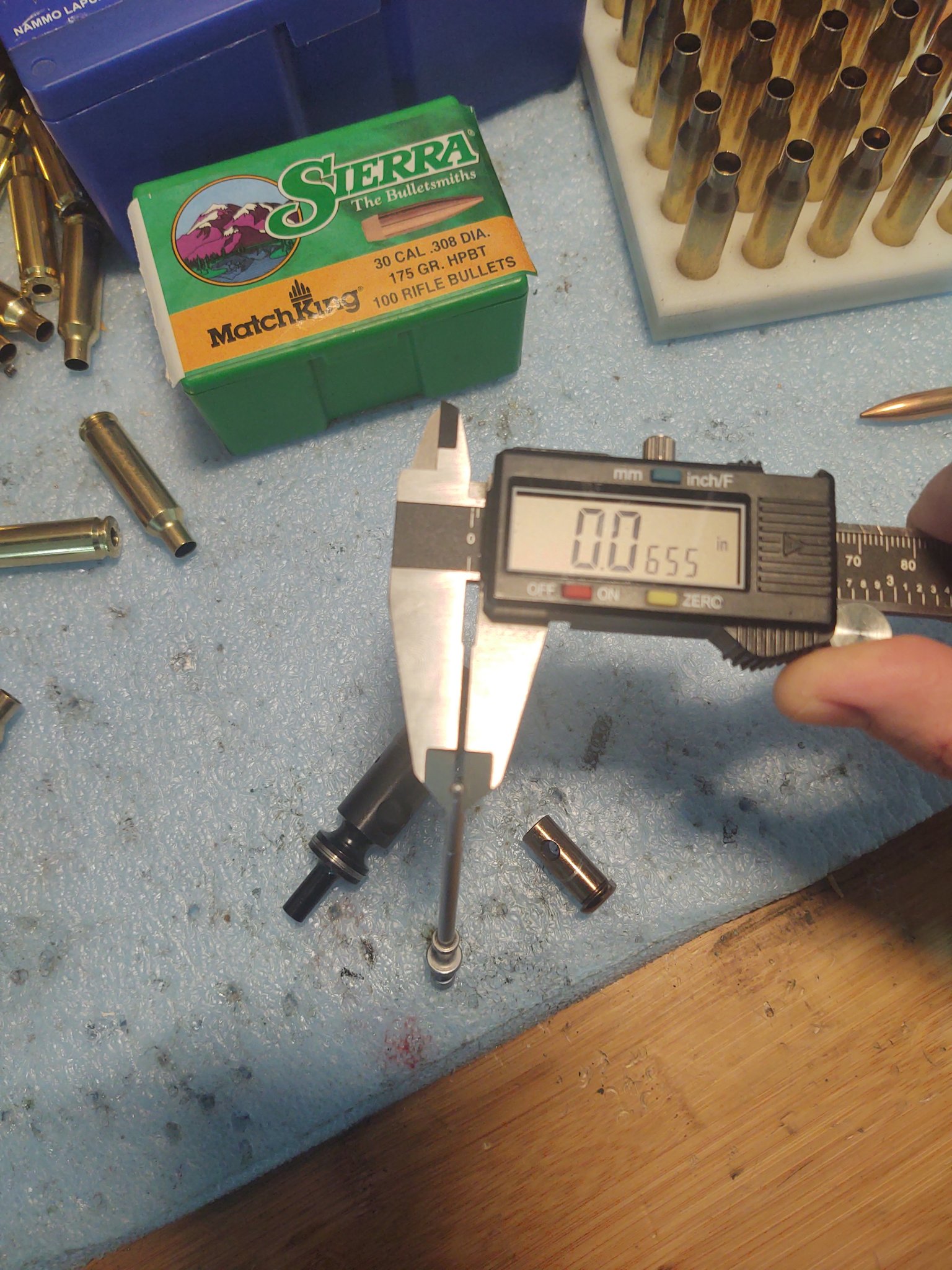

Do you know what the firing pin aperture diameter is on the Lantac? I'm wondering if it's 'HP' or not.
Reactions: FALex
I am gonna let @bigjake83 answer you for certain, because I can't remember. From the minimal amount of reading I have done on the topic, I would venture to guess that it is not an HP bolt.
It is in fact a HP Bolt, Firing pin diameter is .065
They're a quality bolt you won't have any issues.

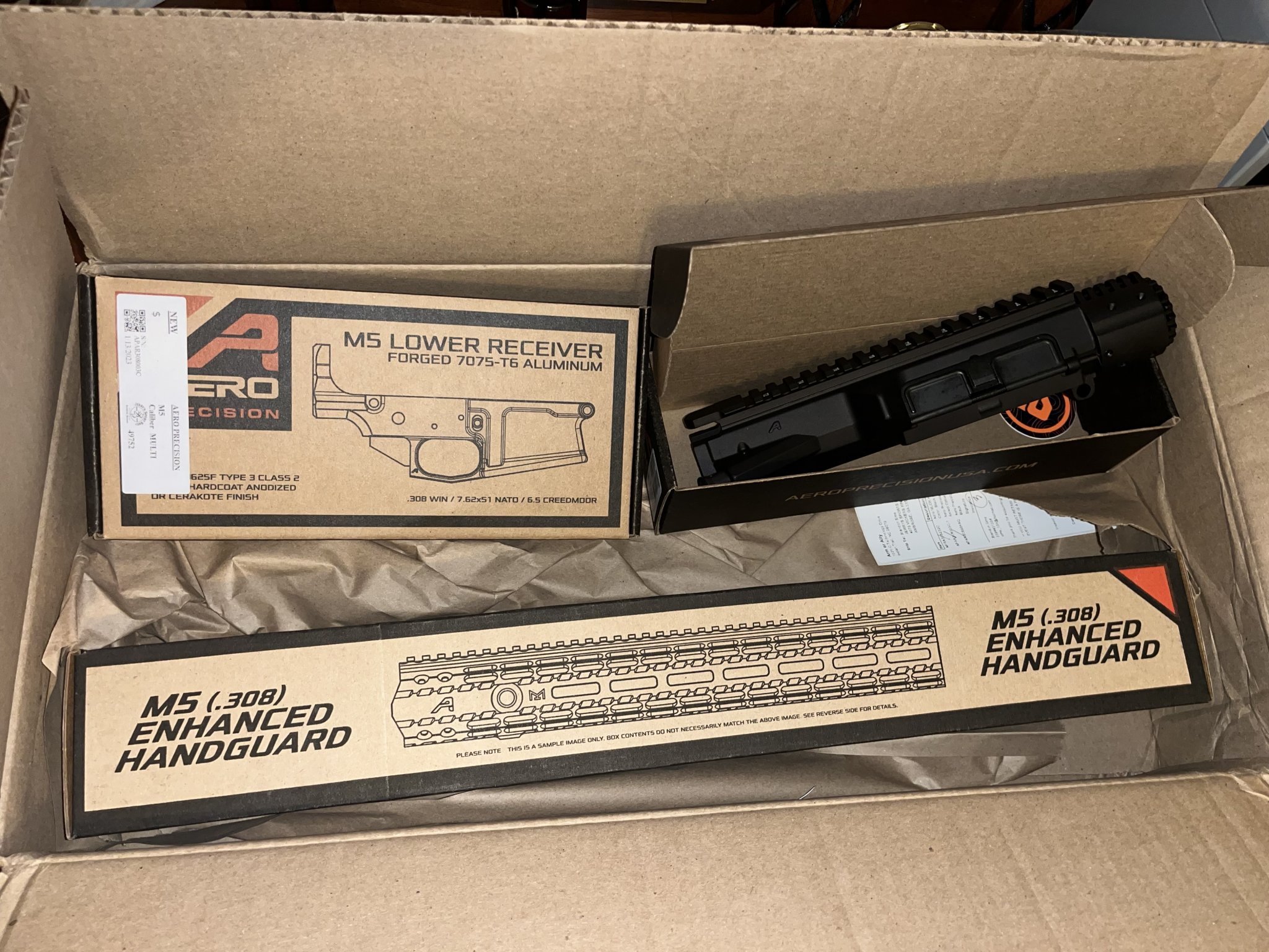

Just to update this I got sidetracked building an AR15 precision rifle ahead of this. Just something about having one to shoot when me and my wife shoot (she has one) just seemed more appropriate. Anyhow, I did order an Aero M5 enhanced set a few weeks ago. After a long talk with the gentleman at Compass Lake I figured if it’s good enough for him it’ll work for me on this purpose. I’ll load up the rest of it with premium parts to run and shoot right and depend on some of you very knowledgeable folks to help. First thing is I’m sending it and the stock off to turn it another color. In the mean time I have to figure out what caliber I want this…. The simple and faithful side of me wants it in 308win, but I have an AR in 308 so thinking possibly something different on this one. Thank y’all
you want 6.5CM for your Aero AR-10.

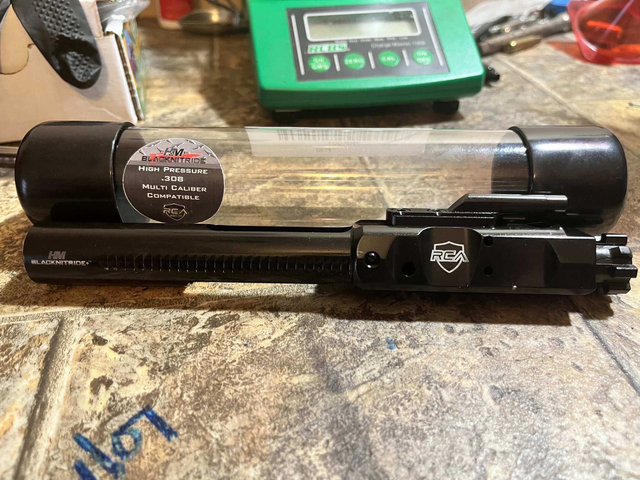

Bought the RCA bcg. Got a new non blem on sale for the price of the blems. Couldn’t not bite on that deal.

Well, it’s here. This has given me time to do some of thinking since this thread has started and discuss things with some good folks on here. I’ve decided I’ll be going with a CLE Bartlein barrel in 6.5 Creedmoor. This will be my first creed, just makes the most sense to get the most out of a precision AR this go around. None of my 308’s will be harmed or forgotten in this transition.
RCA makes great BCG, if you need any further help feel free to hit me up anytime.

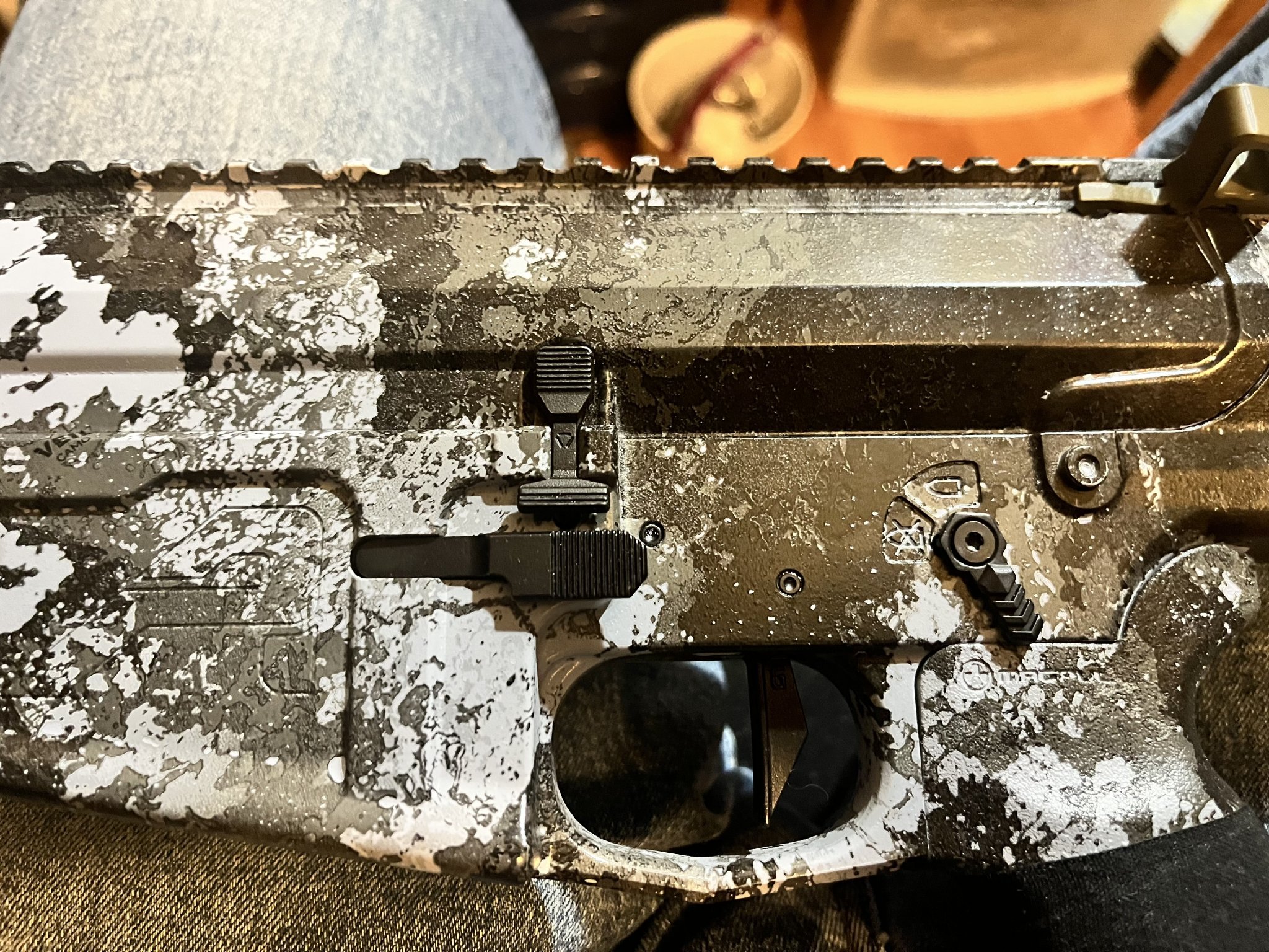

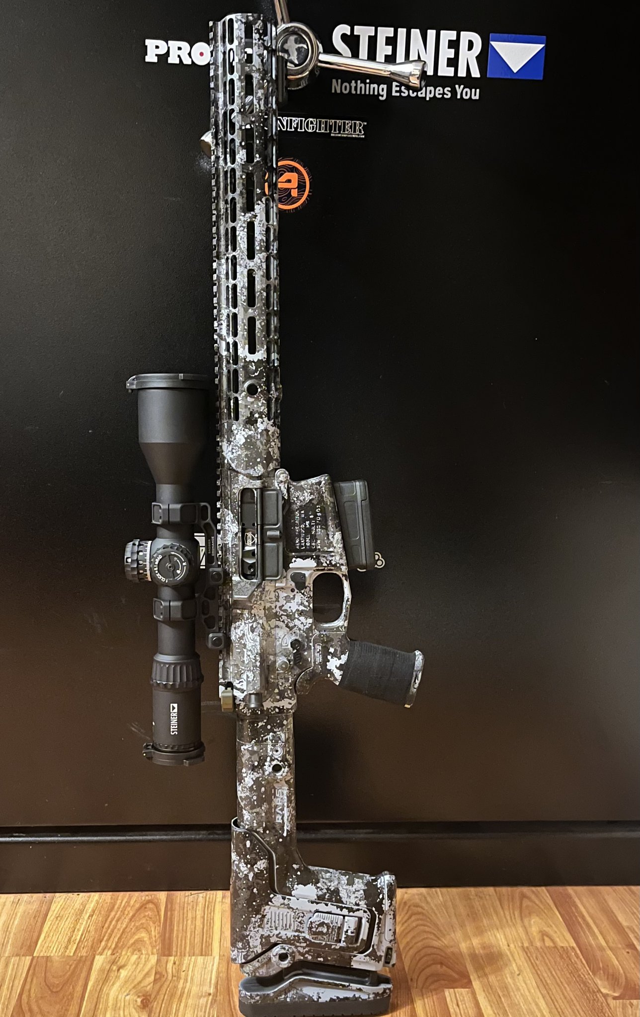

Just got my set back from being dipped and cerakoted clear. Did a fit test and assembled it to be sure everything was good to go for when the barrel gets here to install. I did learn next time I use this pattern I’ll have them modify from the called for gray base coat to desert tan to darken it up more. It’ll work though came out more kinda like Sitka’s elevated look.
I did want enhanced/Ambi controls on the left side being a lefty to I had to experiment a little being this large frame stuff doesn’t all work together much. I used a CMMG mk3 zeroed lpk. Everything worked great except the enhanced mag release wouldn’t work because the top paddle was too wide and would not fit inside the upper cut out slot to release the bolt. After some reading I tried a Strike Industry enhanced (wasn’t my preferred choice) and works great. Just updating where the build has went for the good folks who has helped.
Here is a build list on it

View attachment 8118633View attachment 8118634View attachment 8118635
It looks like a Huge Bird shit on your gun...JK..lol
Sounds like a solid build, especially your choice of barrel😁
