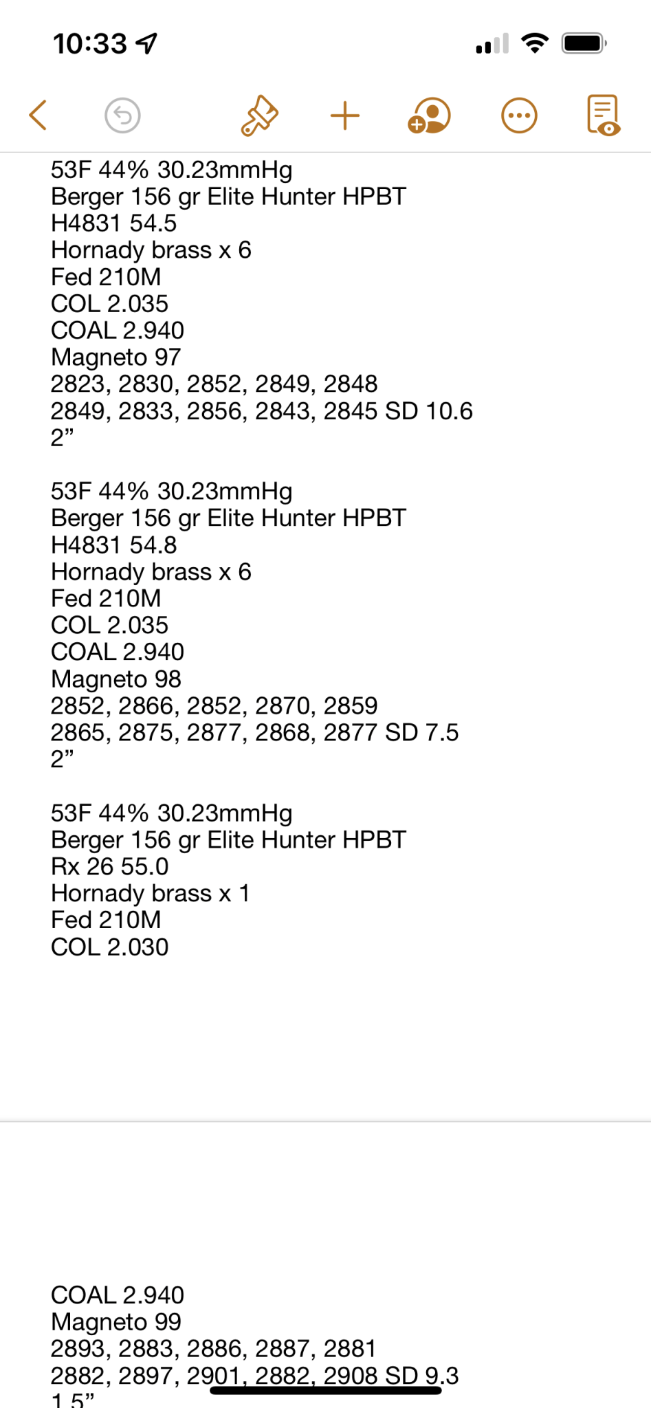

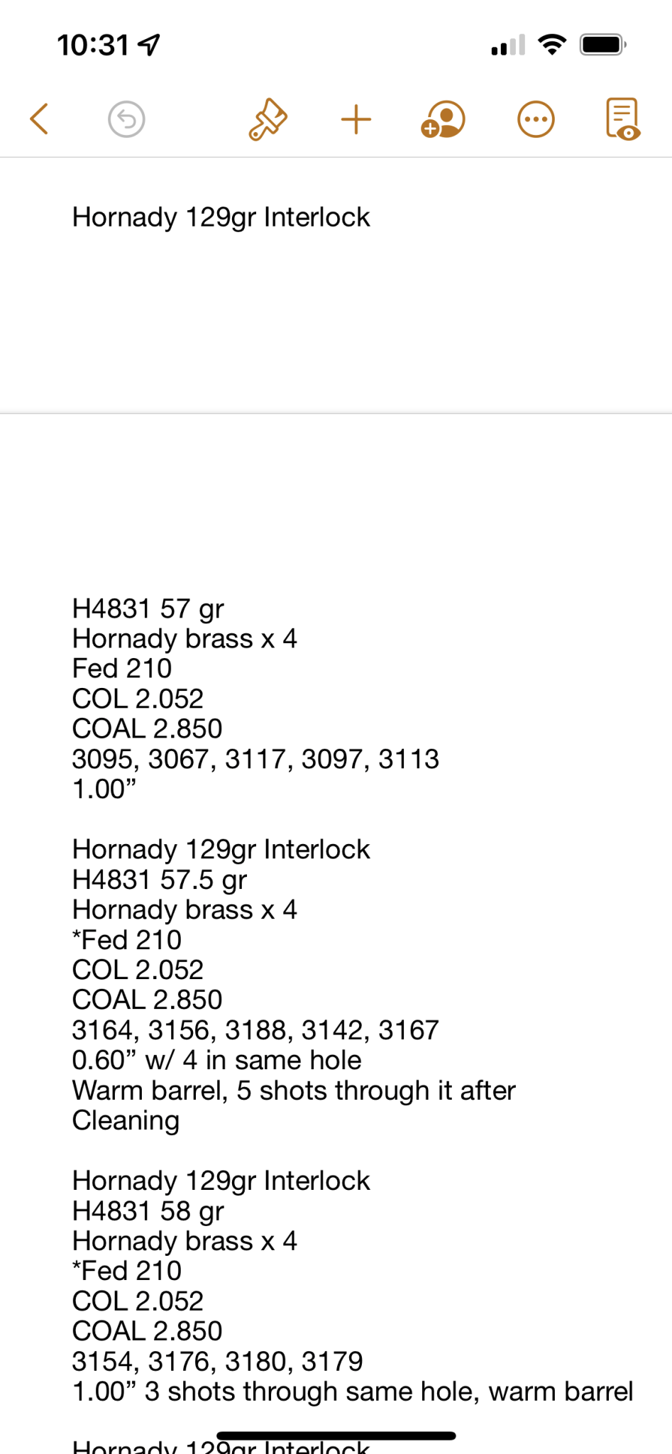

Here’s some data from Christensen MPR 24” CF barrel. Not exactly the same bullets but get you in the ballpark 🍻
Hornady 147 gr ELDM
H4831 54.0 gr
Hornady brass x 7
CCI 200
COL 2.058
COAL 2.945
0.75” x 10
Hornady 147 gr ELDM
H4831 54 gr
Hornady brass x 3
Fed 210M
COL 2.015
COAL 2.940
2936, 2942, 2935, 2934, 2936 SD 3.1
1”
H1000 and 140 class bullets are a good bet. Follow the above Hornady data and the data on Hodgdon's site and you should be in the right area. Nosler has 6.5 PRC data on their site as well.
