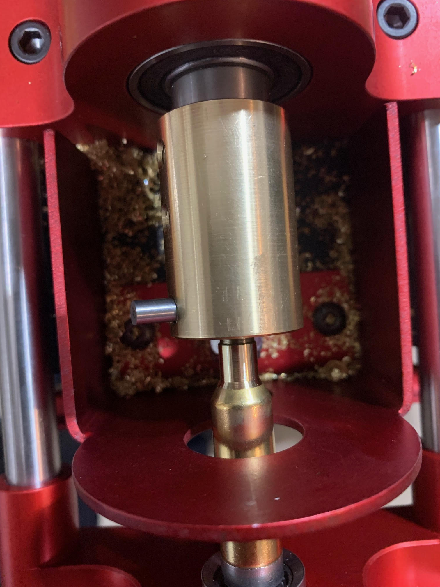

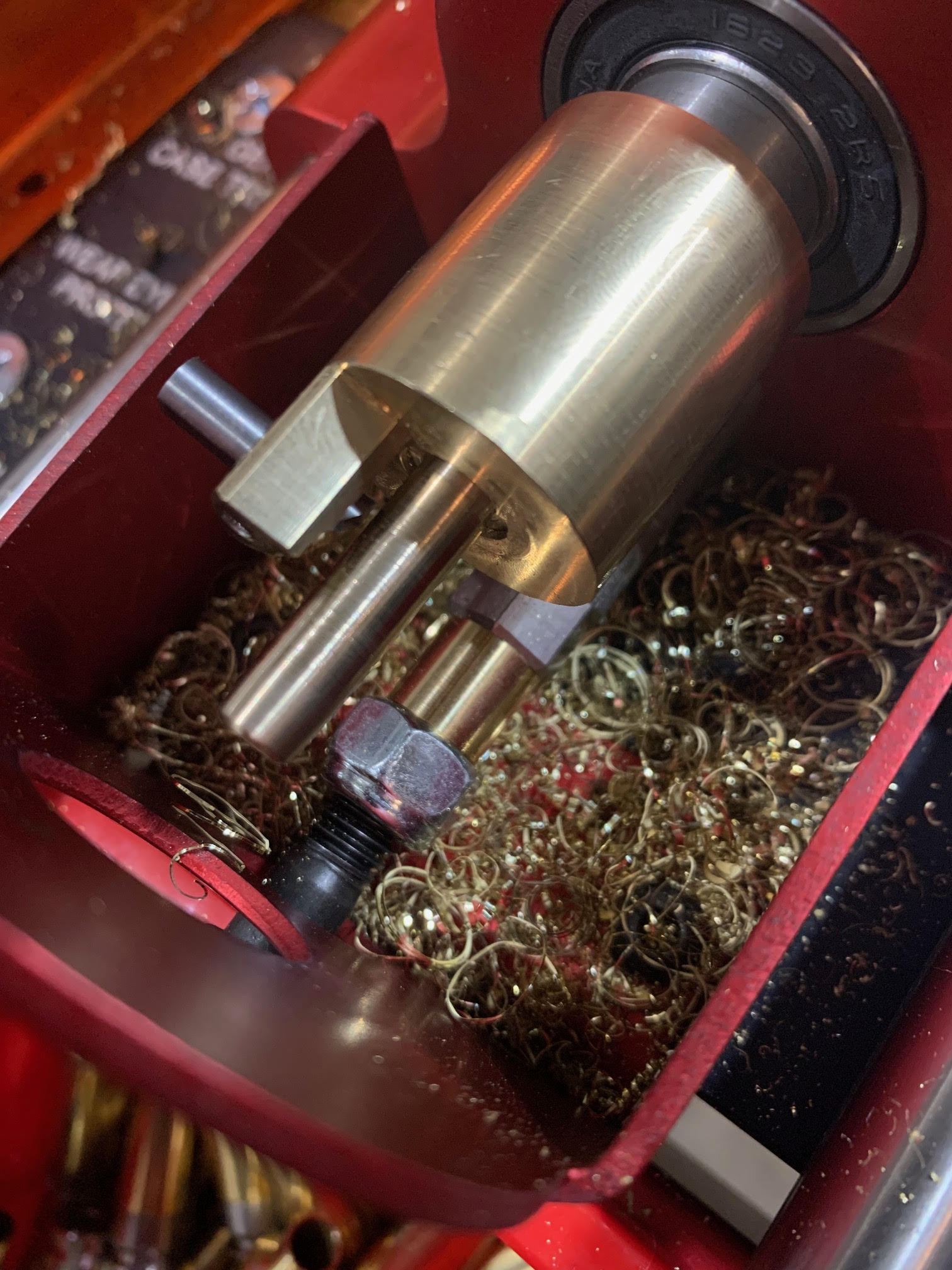

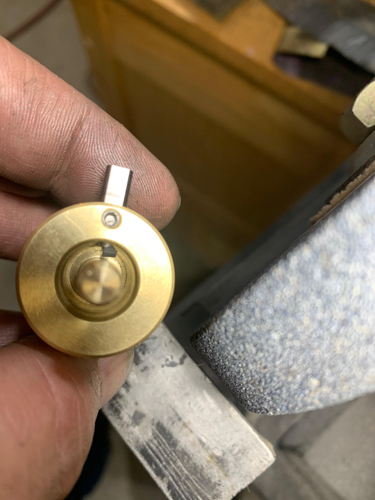

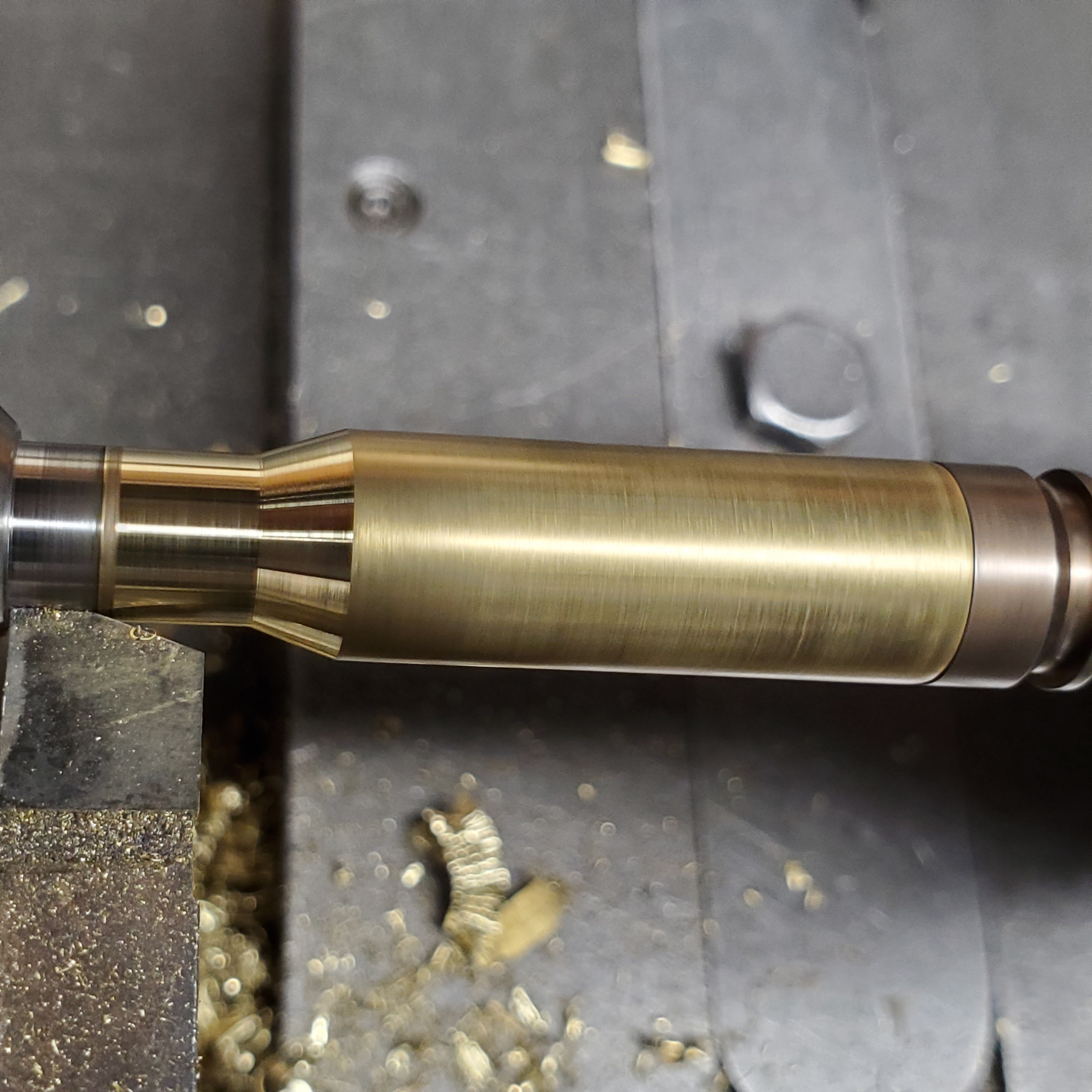

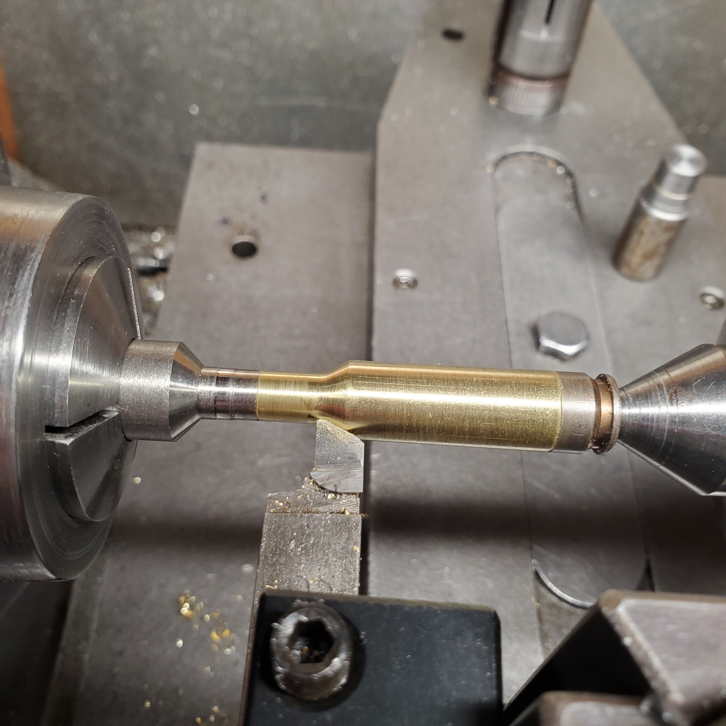

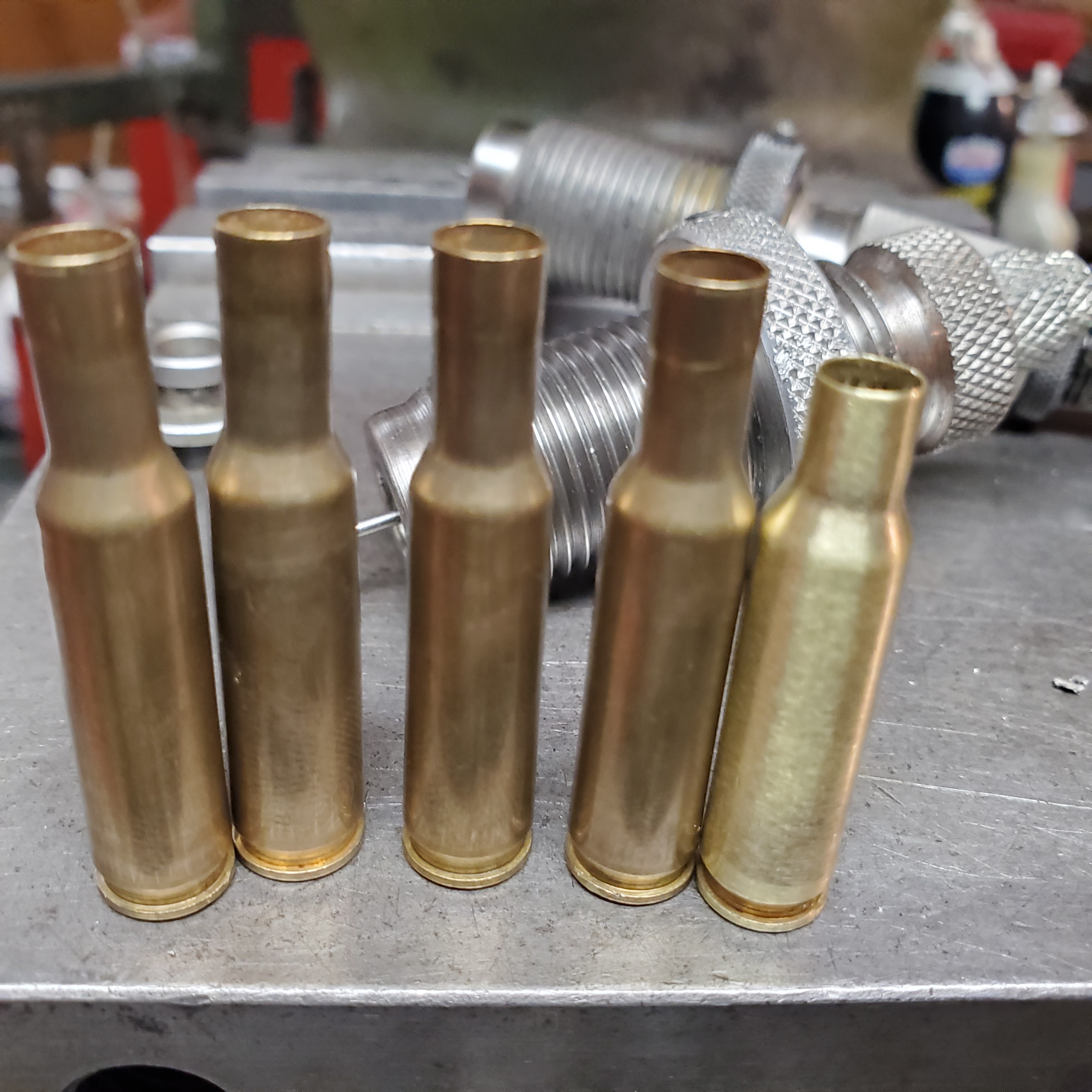

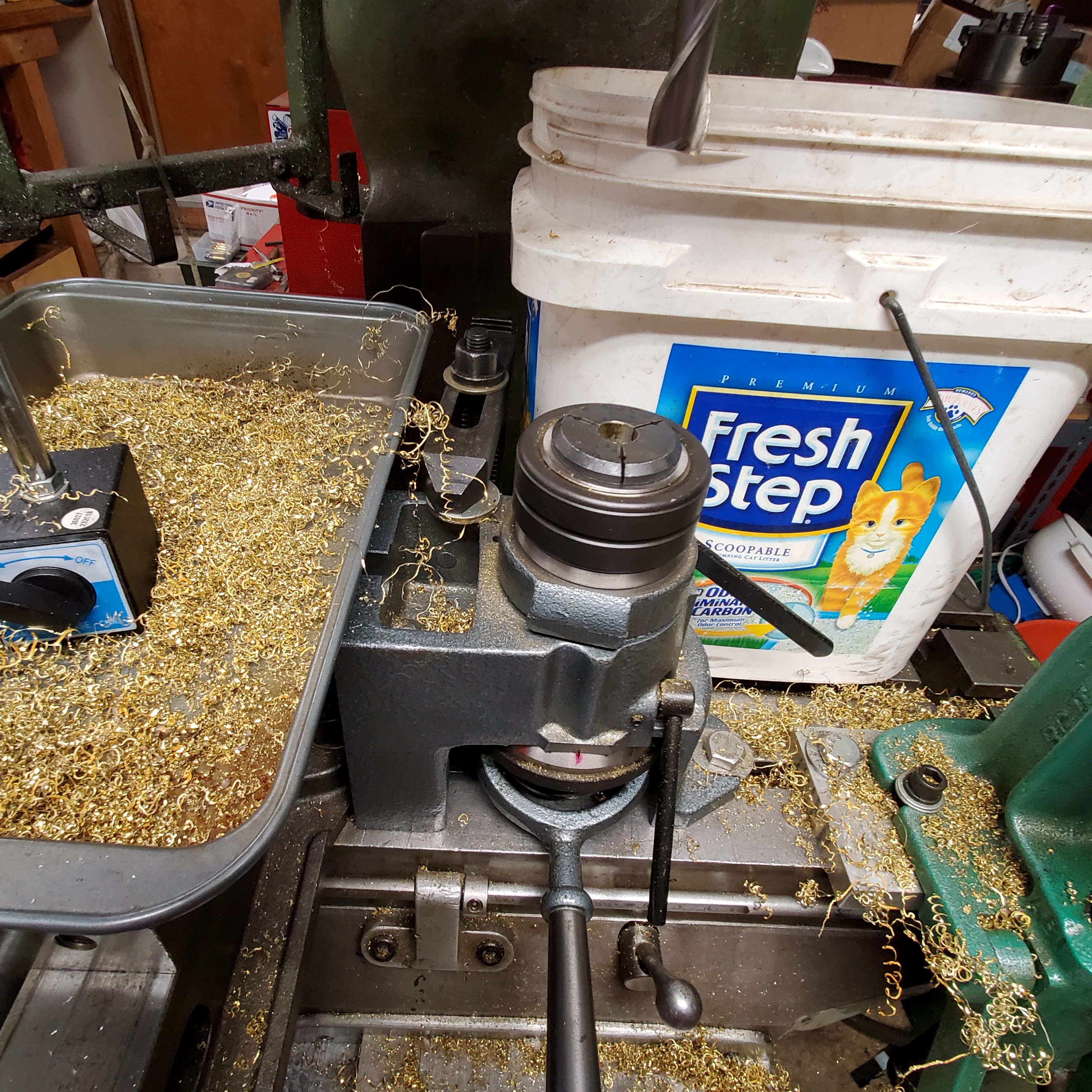

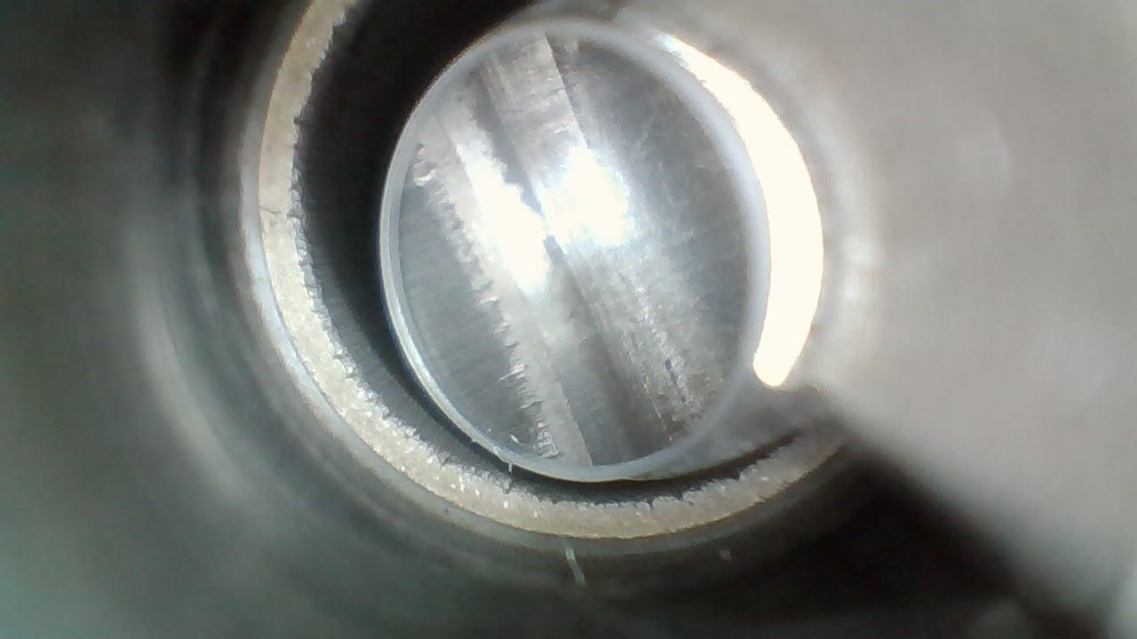

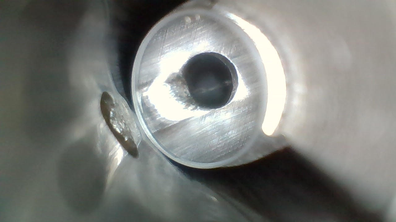

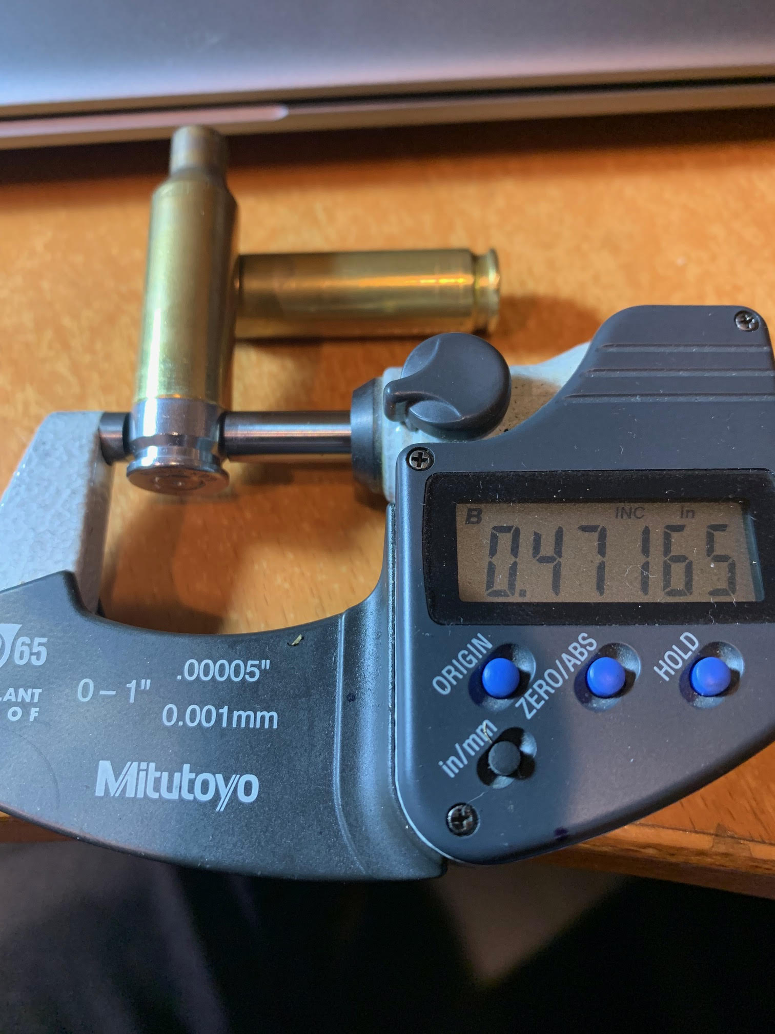

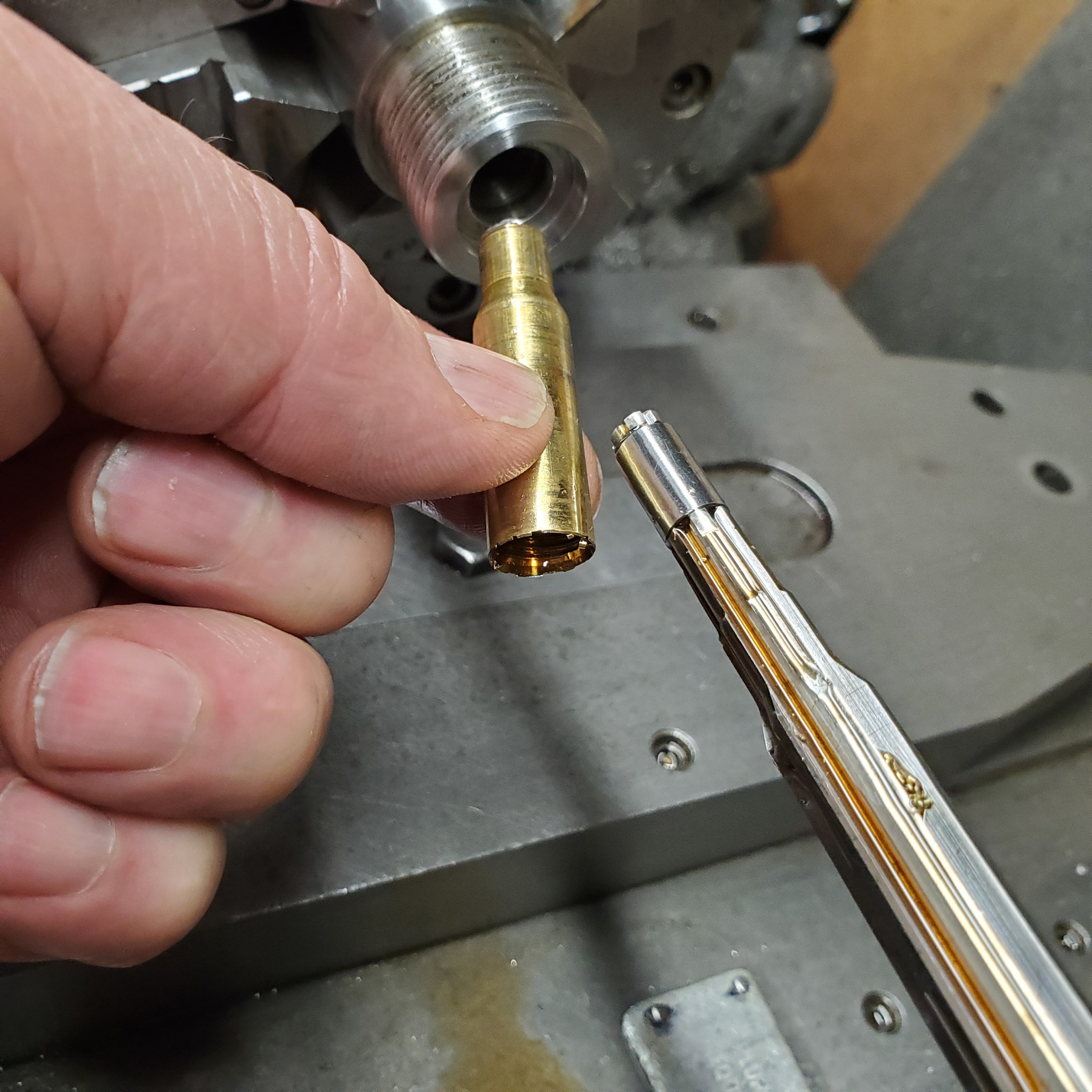

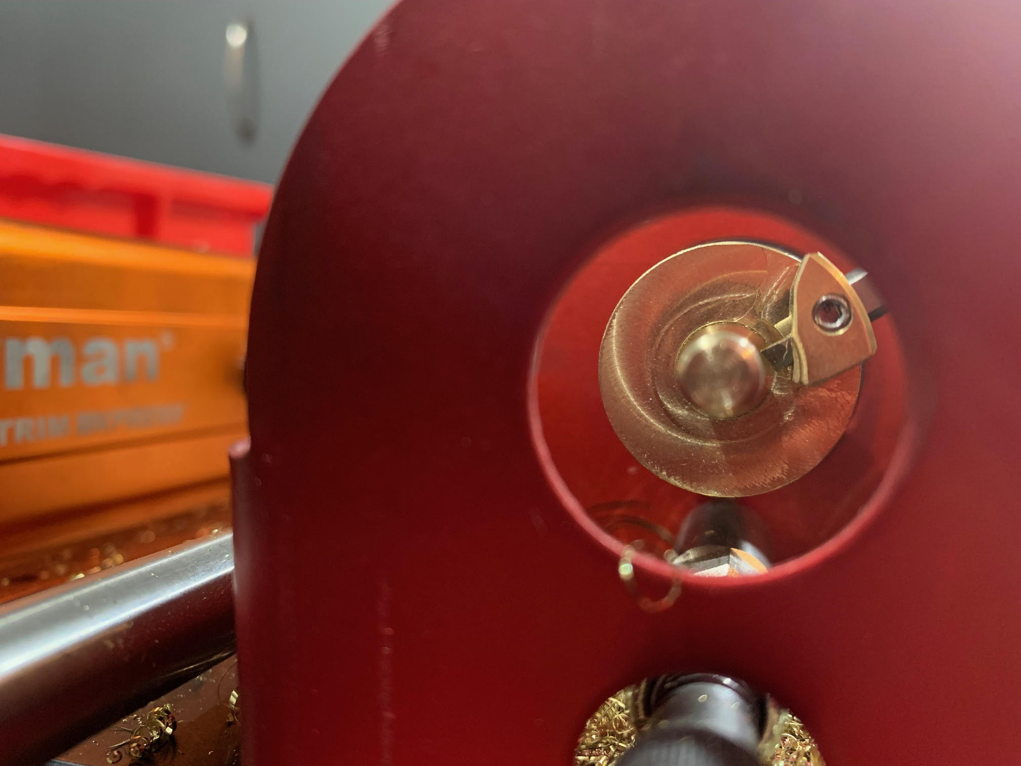

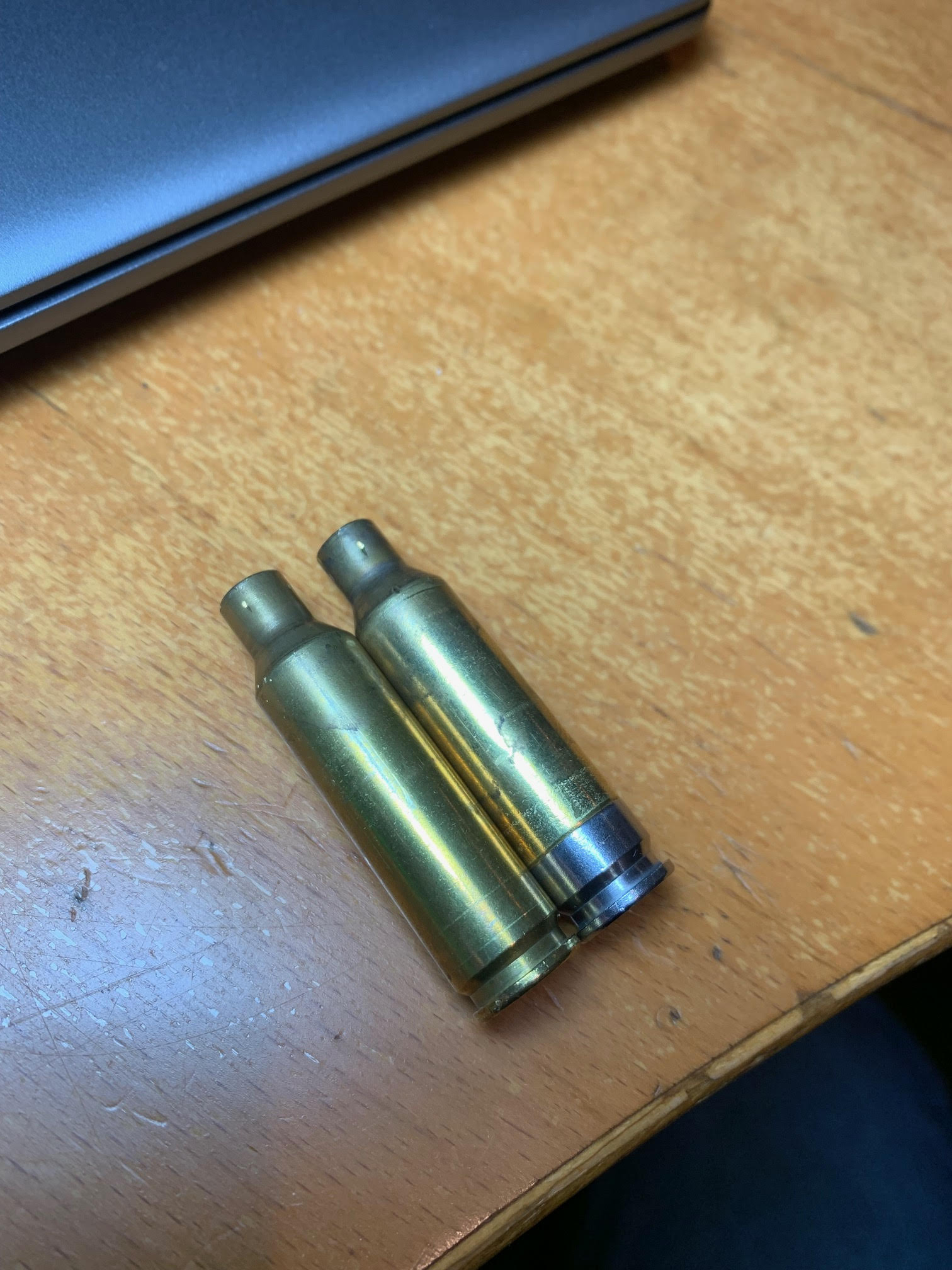

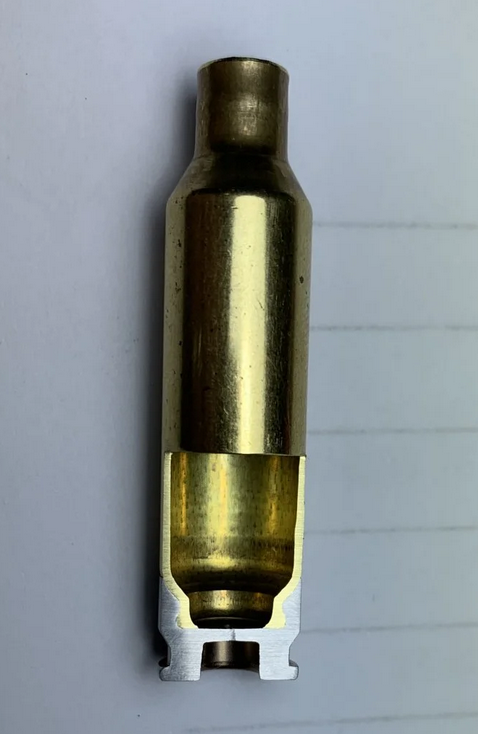

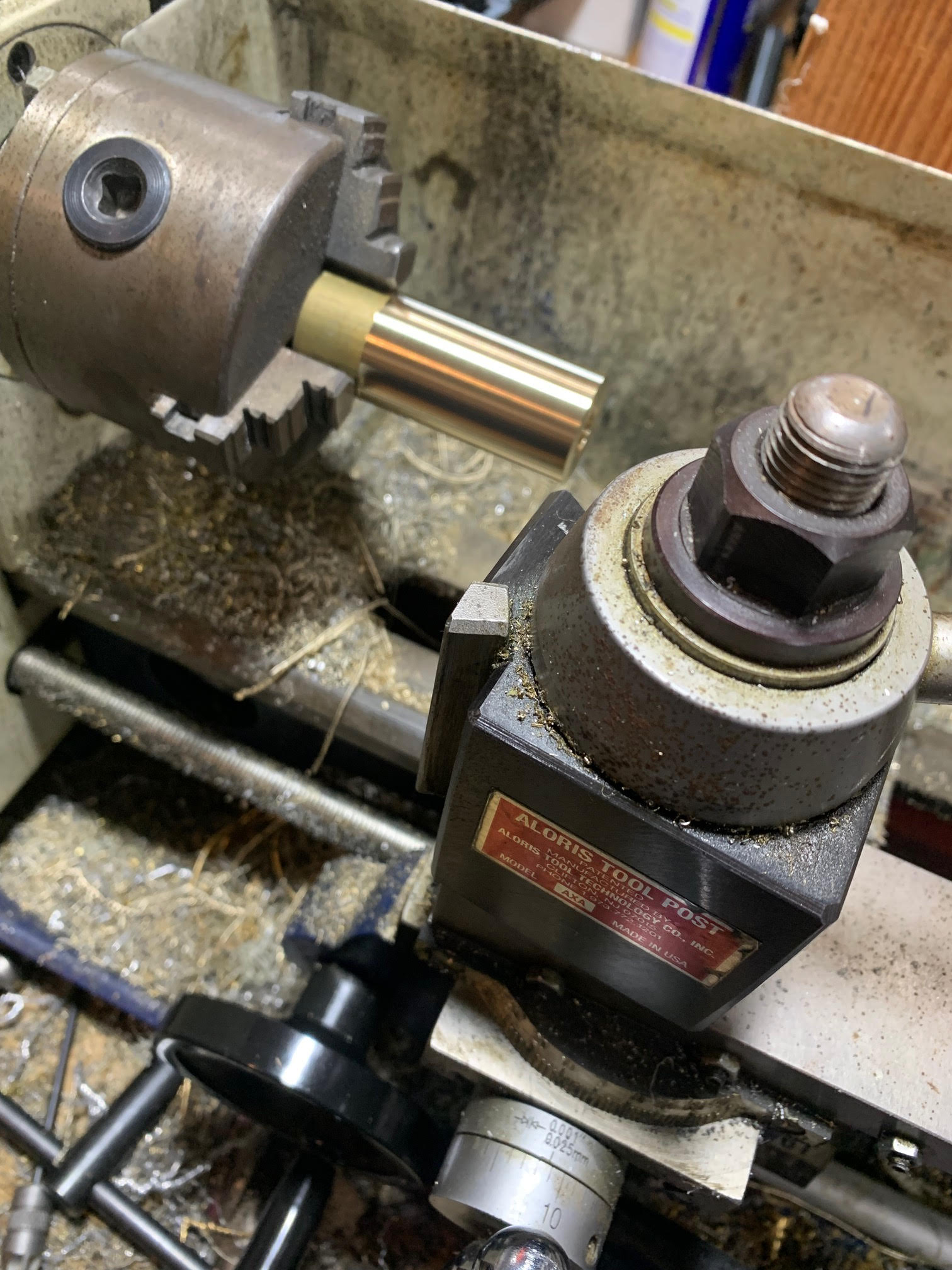

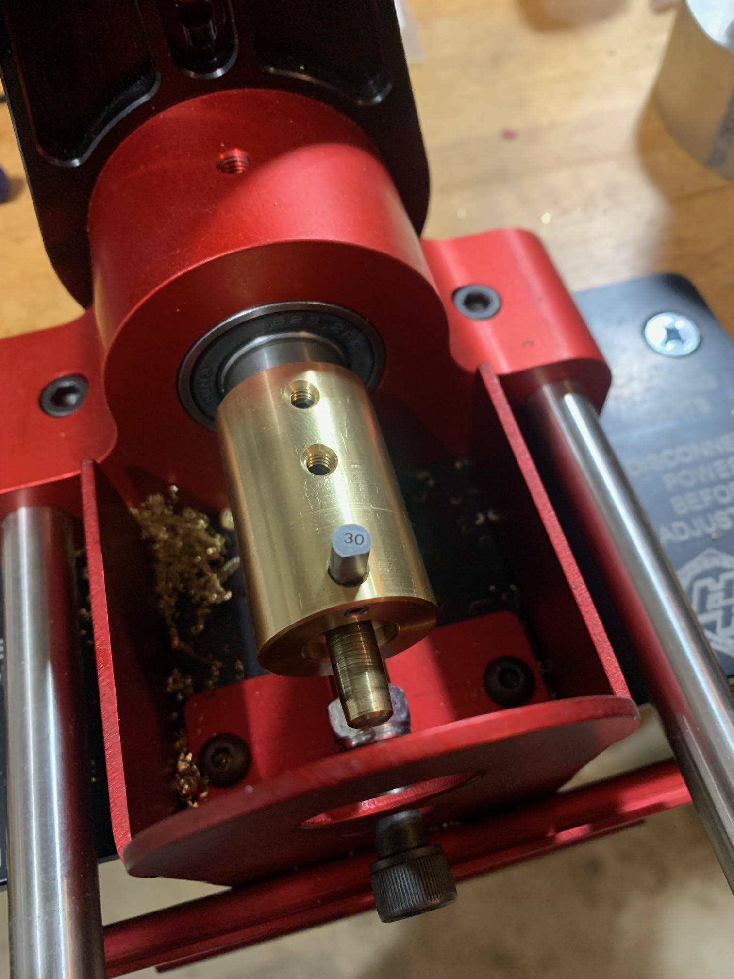

I made a thing & it works well. I used 1" bar stock cause that's what I had, but 1.25" may be a little better. I'm going to counter bore the case entrance a little bigger to help it clear chips better. Very accurate though. Trim first and easy change over to neck turn.

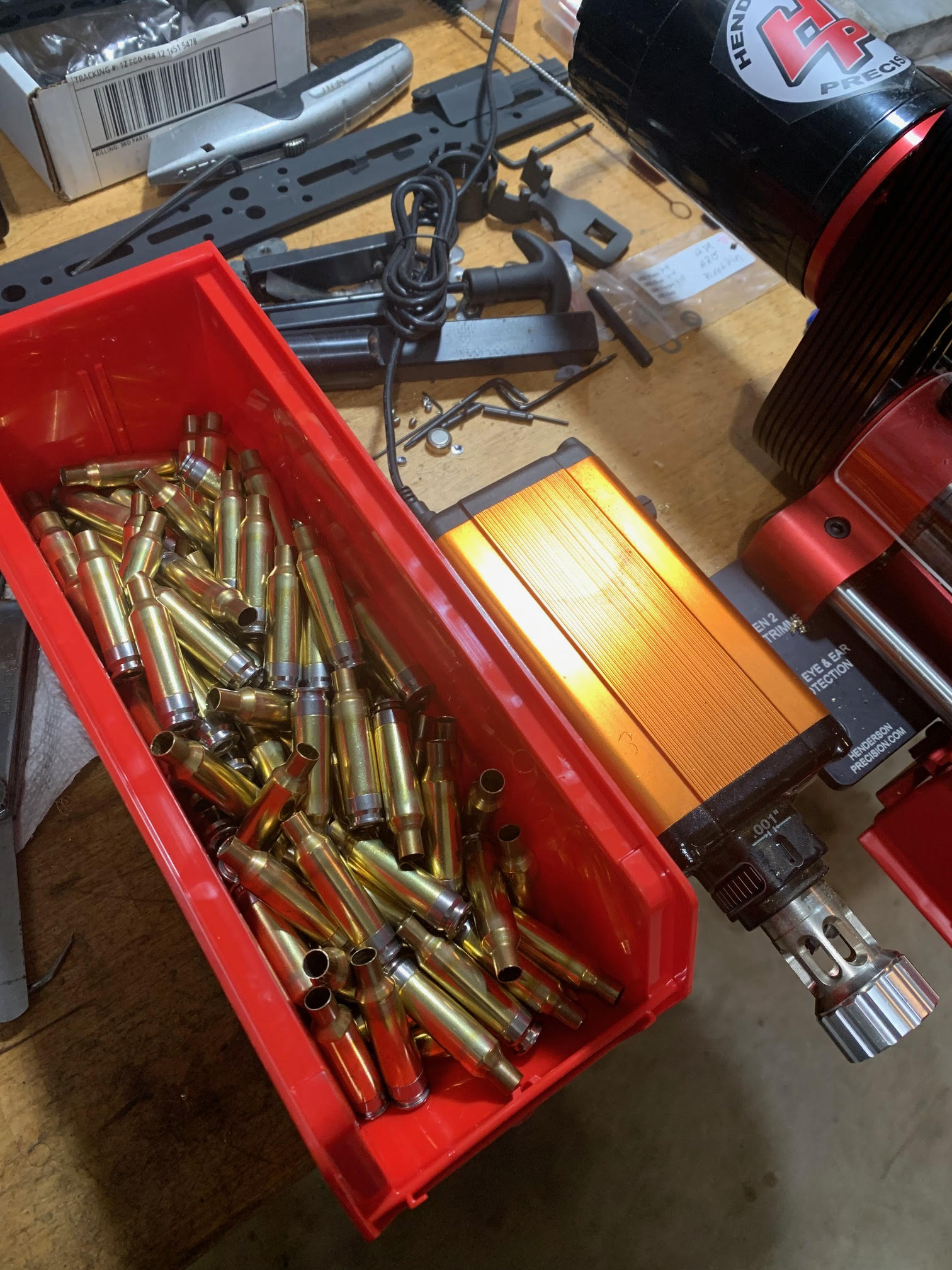

@flyer1a - Someone with CNC machines should make these. Forester carbide neck turning bits & could use century 21 or whoever mandrels.

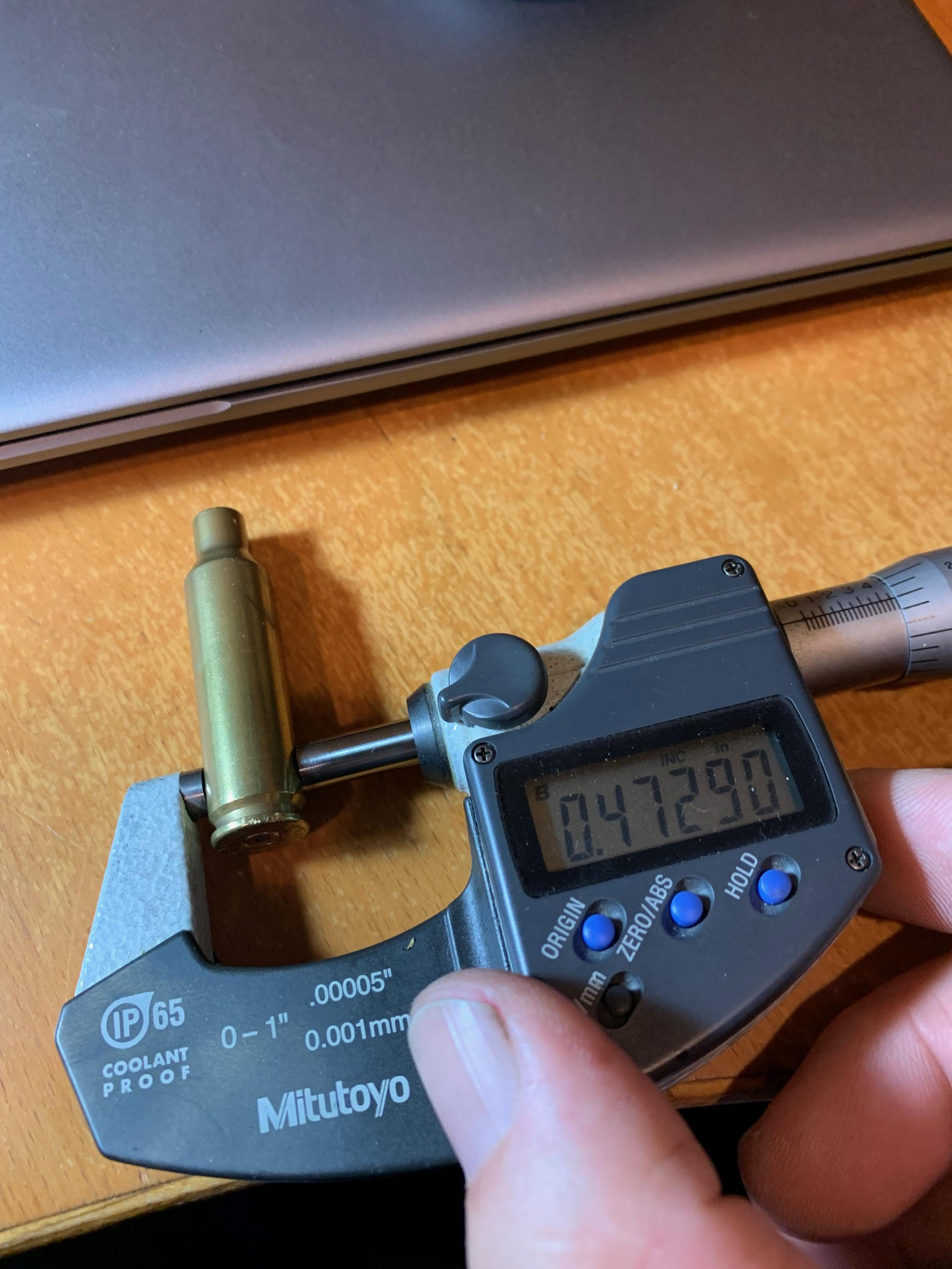

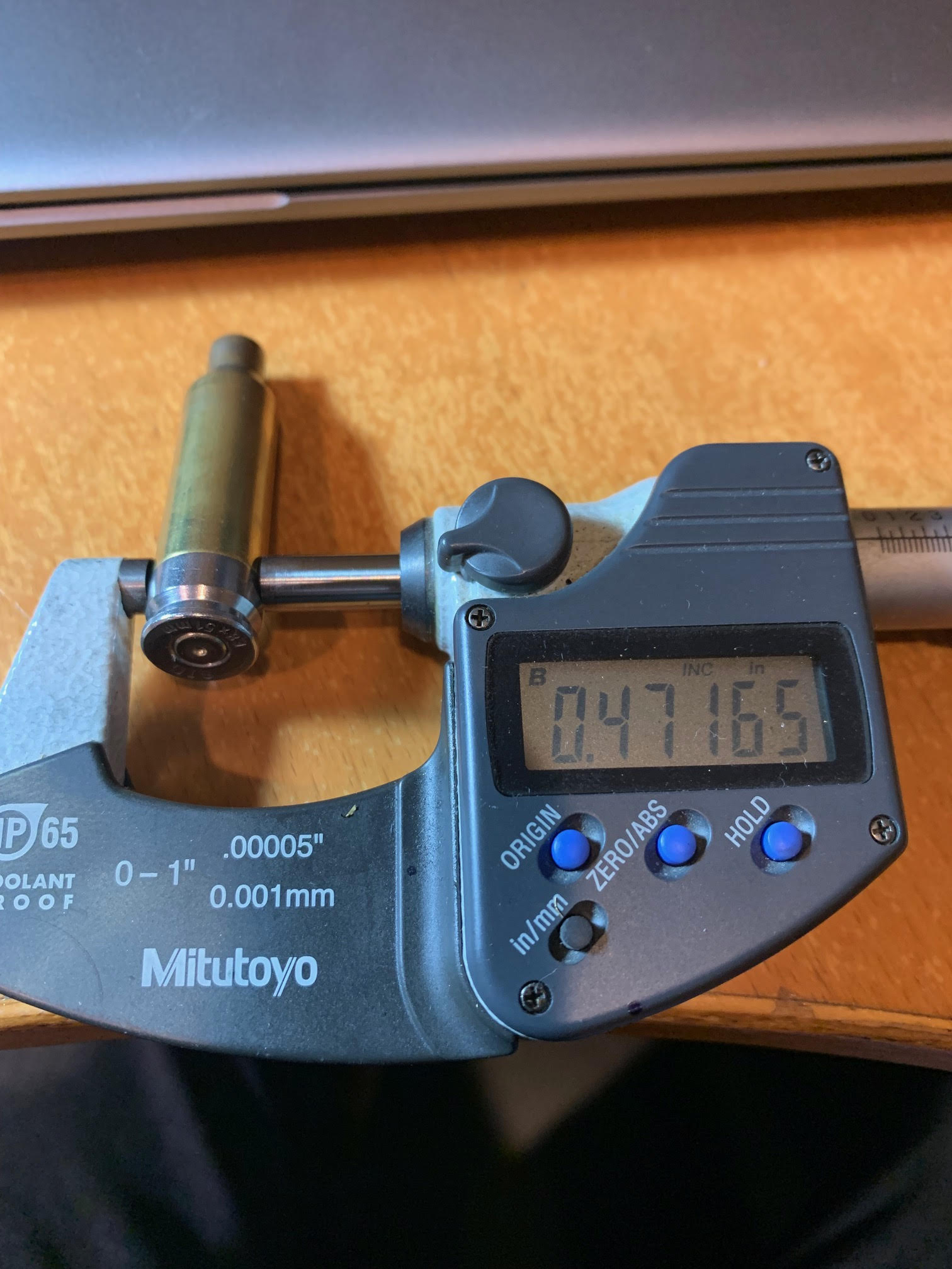

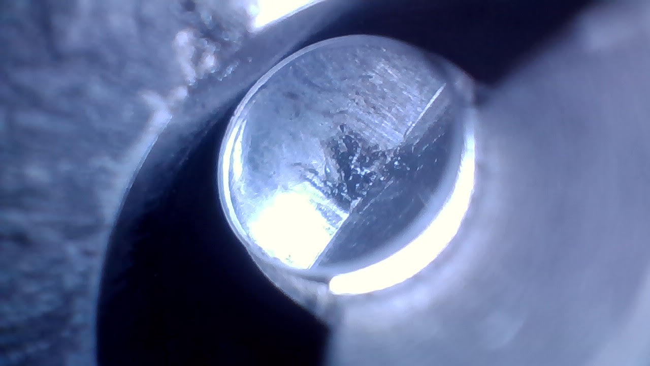

Just used a 1"-2" mic to set the cutter.
