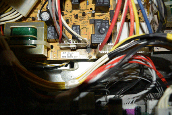

    Gentlemen, thank you all for the responses. Here's the deal, to go into further detail. I do have the board, it is in the oven. Specifically, it is a double-oven. The bottom one works perfectly fine, the top one does not.
    This is the fault of the resistor. I'm pretty sure it is a resistor, as the pictures on the innerwebz show a blue body.
    The resistor in question here, not only did it let out all the 'magic smoke', but it seems to have literally explodicated. The only thing showing is the two leads. I was simply going to solder another one onto the existing leads.
    I have a picture of the board, that I took, here.

    Here is a pic that I took, of our board:
    (still figuring out how to do multiple, descriptive pictures on one post, but anyways....)

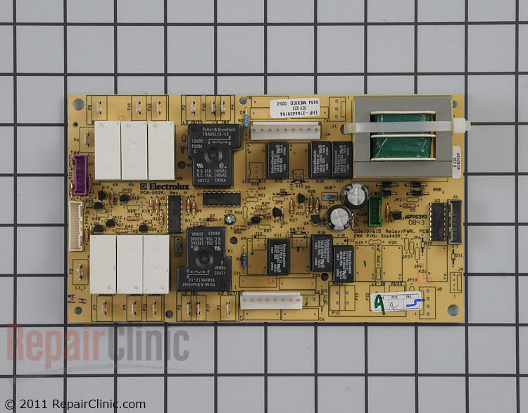

    Here is one from the innerwebz that I was trying to decypher, to no avail: (the picture is inverted, and the resistor in question is "top/center", whereas in my picture (1 post above) it is bottom center)
    [to make things interestinger, seeing as it is a double oven, one question I have is, is the resistor for the top oven THE SAME as the one for the bottom oven? Those large, black, odd-shaped do-hickey's are relays for each oven. Ergo, the blue resistor beside each are the ones in question. BUT ARE THEY THE SAME?????? I have no way of knowing, and I'm not about to just throw anything at this board. The front display touch-panel has already been replaced, and that was cubic-dollars in itself. But another story, so I'll shut up about it for now.]
    Lastly, blowing the heck out of the good picture that I have, of the OTHER R1 Resistor, the colors look to be:
    Red Red Brown Black - Brown --- Which then tells me that it is:
    2,200 Ohms with a 1% Tolerance.
    Does this not look like a 1/2 watt resistor to ya'll, size-wise?
    I can share these pics via email, if anyone else wants to see them 'better'.... or if you have access to schematics I can give you a model number from the Oven. Or the board has numbers on it, too. Wide open to options here.

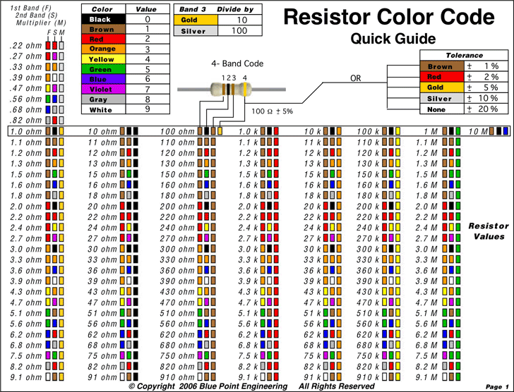

    Resister code values:
    Black, brown, red, orange yellow, green blue violet gray white = 0>9
    I was taught in high school to remember the sequence by this lymric:
    Bad boys rape our young girls, but Virginia goes willingly.
    It’s been 32 years and I still remember that…hmm…

    Fifth pic in this listing is as good as I could get.
    http://www.ebay.com/itm/316443919-Dual-Oven-Realy-Control-Board-Frigidaire-/141807358358
    That is either
    Red-Red-Brown-Black-Brown = 221ohm +\- 1%
    or
    Violete-Violete-Brown-Black-Brown = 771ohm +\- 1%
    Get a couple of each and start with the 771ohm, if oven doesn't function or seems under-powered, try the 221ohm.
    Or (if you have the skill) you could pull the board and determine the correct resistance value based on the circuit topology.
    That said, you may just want to buy a board for $100. Even the badly manufactured resistors don't often explode without a major current spike. I'd wager one of those relays is toast as well; and those can be a bitch to diagnose without depopulating the board.
    Based on the pic of the traces in the ebay ad, you should also check relay K2, the input side of the transformer, and whatever the white wire in your pic (in the 9 pin header) connects to for shorts.
    ETA:
    Trace runs: P2 (red wire/white strip)-->K2 (at rest)-->R2-->white wire/post 2 of the transformer (supply side).
    I can't get a good view of the transformer tag and have no idea what P2 or the white wire service (though I suspect P2 is mains power?) so that's as much help as I can give with the info I have.
    If the K1 side of the board feeds power to the lower oven (working) and K2 side of the board feeds the upper oven (broken) then R1 is probably equal to R2. The center of the board is just 12vdc logic to switch the relays. The R1 trace is exactly like the R2 trace: P1-->K1-->R1-->pin 1 of 9 pin header (pin closest to R1). Only difference is R1 doesn't feed a transformer, but the transformer only feeds the logic components 12vdc and transformers rarely fail. I'd start with the white wire and see what it feeds (perhaps the previously mentioned bad touch panel)?
