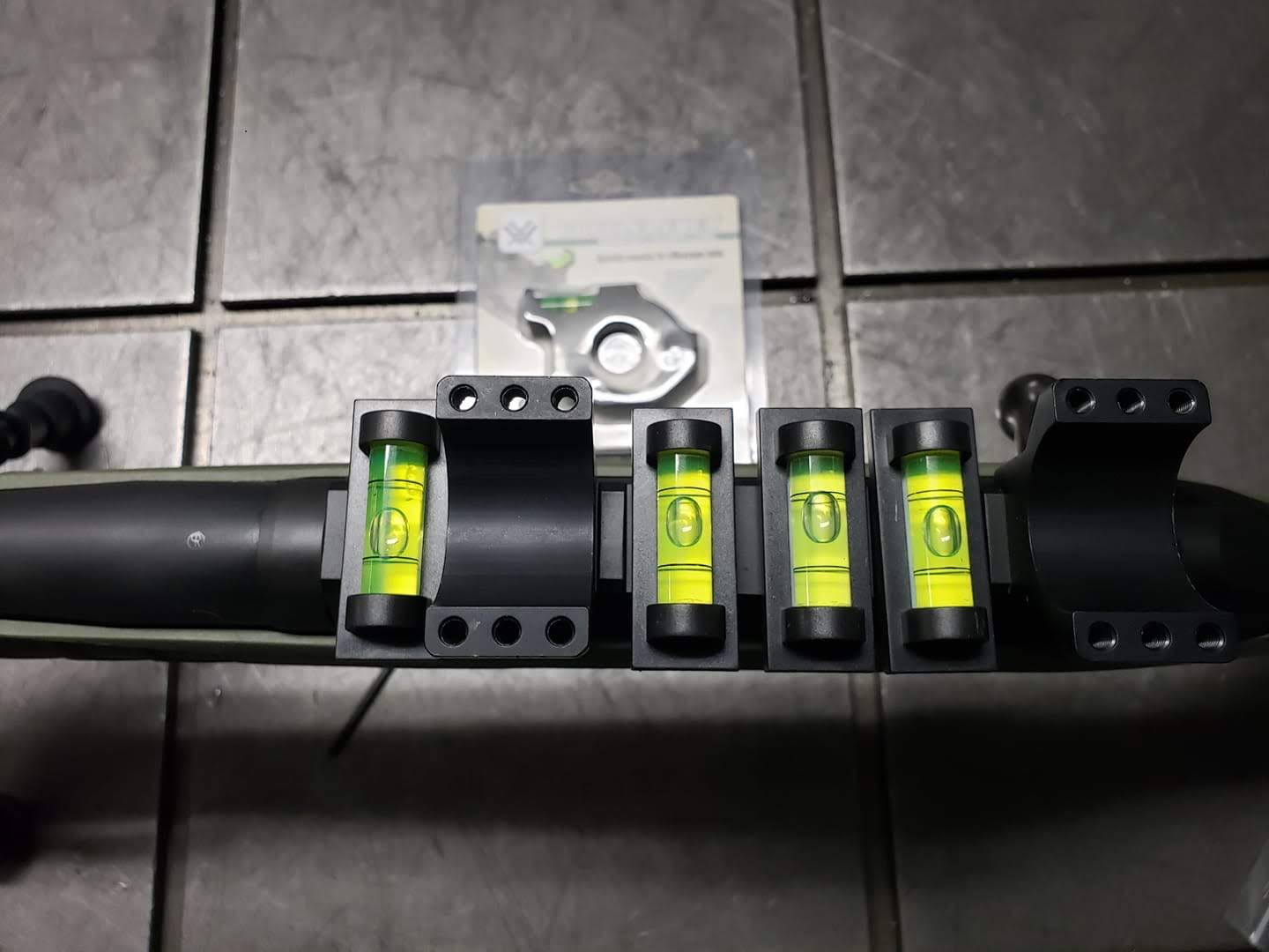

I don't care if anyone uses a level or not.... but I think some things are being missed here.
1) The pic of all the levels reading different-- Yes, cheap levels read different- but if you use a level that goes around the scope tube then it doesn't matter. Get the gun set up so it feels good (without worrying about leveling it), then level the scope with a plumb line. And now attach the scope mounted level while you are still verifying with the plumb line. You're done... it doesn't matter if they had tolerance issues in the manufacturing process.
2) People see shooters with levels shooting and they are still canted. Yeah- I have a speedometer in my car but I still get speeding tickets.... Only works if you use it. And it's not as if you remove it then you will suddenly be holding the rifle truer.... you just wont have a indicator that you are doing it wrong. Kind of like pulling the fuse because you are tired of seeing the "check engine" gauge..... problem didn't go away.
3) Those that had one break so they will never use it again. Shit breaks, I've had lots of stuff fail (rings, scopes, bipods, rangefinders) but it doesn't mean the concept it bad.
I think that they can be a band aid, and people going back and forth between the level and the scope is a problem. But they can train you.... When I go to a new spot I will glance at the level before my first shot- make sure I have the lay of the land correct- and then I don't have to use it again (unless something about the terrain was throwing me off and I wasn't holding true the first time I checked it)
**) I do not sell levels... and am not trying to justify a purchase. I've made enough bad purchases that a couple $30 to $40 levels aren't even on the radar.

What you’re missing is that a $30-$40 level isn’t reliable. It’s slow and they wander over time. It’s to be expected of a $40 piece of plastic. Tolerances aren’t going to do well. Even scope mounted.
I have verified them with electronic and more expensive spirit levels. They are dead on one day and then the next they don’t work. And you don’t know when they are going to fail.
Use a level all you want. But using a $2 level marked up to $40 isn’t the way to go.

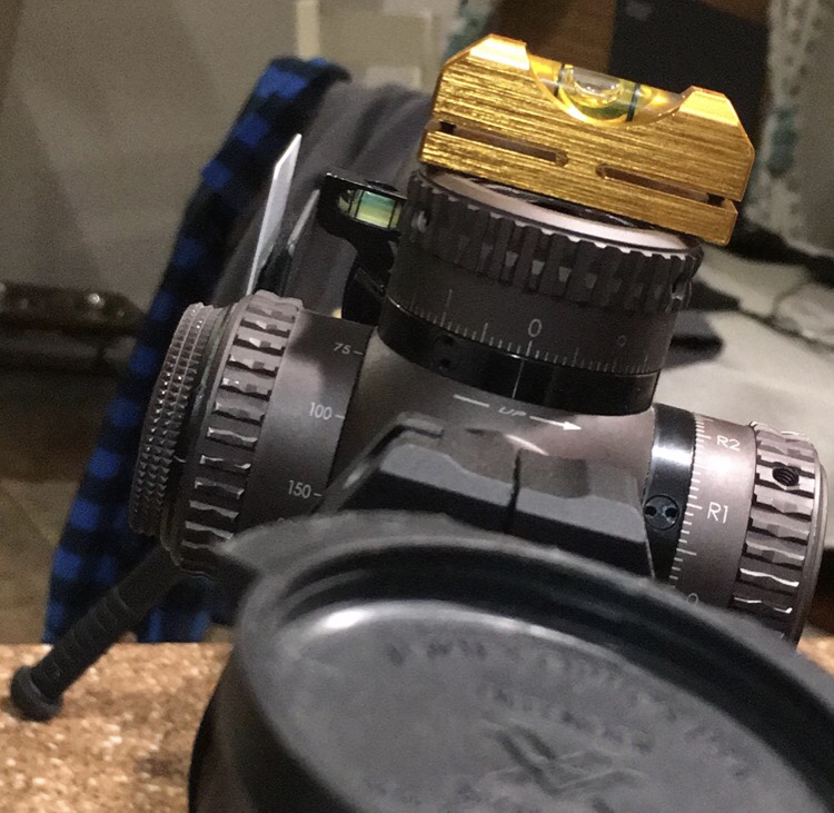

What I think happened is on 1 of the stages I hit the level hard on a barricade and it shifted quite a bit. On all the long range stages I referenced the crooked level and I even remember even thinking to myself, WTF my rifle seems canted - but my dumb ass kept shooting anyway. When I got home and got behind the rifle and it was immediately apparent that the bubble level was off. It's now in the trash. Lesson learned.

I took the level off, and re-mounted it correctly. Scope was leveled to a plumb line and then the bubble level was attached. The image below is when I got home after the match and found the level was off showing the offset prior to fixing it. Man, I was just pissed that I threw the match away for something so silly. It's all a learning experience so next time I'll know. Also... it's not like throwing a scope away. I wouldn't throw a $2,500 optic system away from the mount coming loose. You don't need a $40 level. I'm going to follow lowlights post above as my primary applications are PRS/NRL and hunting. As they say, you can't have a $10,000 rifle and be a $5 shooter. I'm probably a $25 shooter at this point :LOL: Gotta put more work in.
Did you verify that your turret cap is 100% square to the reticle? Did you adjust that piece of shit gold level to be 100% true to gravity? I think part of the problem is the assumptions you may be making, and the equipment you’re making them with.
Yes. I've confirmed it before. The scope reticle was leveled to a plumb line and tightened down and everything else was subsequently leveled and mounted according to gravity. It just got smacked on a barricade and moved. Earlier this year I walked the same rifle out to 1,500 yards and had 2nd round hit at 1,000 and first round hits at 1,200 and 1,300 and had no problem hitting sub-minute targets at 600 yards. Point being that something changed this particular match, the bubble level.
