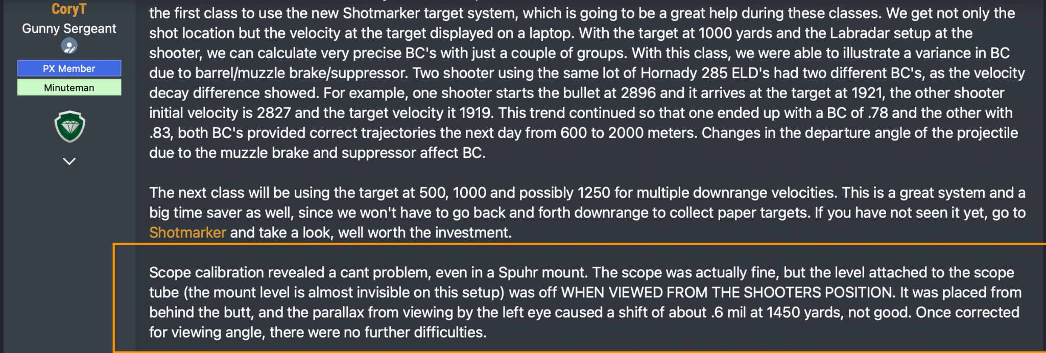

Funny I screenshot this yesterday from CoryT at the Gunsite class
This is what I am saying operator error that people are singing the praises of a level when they have no clue how to use a level and the context in which they claim the level helps them is crazy stupid, shorter rangers, off flat bottom rifles weighting 20+LBS and in a sand bag, how is a level helping at 400 off a prop on a 2 MOA PLATE
People mess up ballistic calculators every single day and miss a target because of it
You are using it wrong.
PS his post above was written in 2018, 2 years ago I have 10x more evidence on my side than any other in all of this
Wait, I thought Lowlight had come around and finally embraced levels based on the last podcast. I just bought one Accuracy 1st for every one of my scoped rifles. WTF...I am not getting a sense he has fully embraced.
