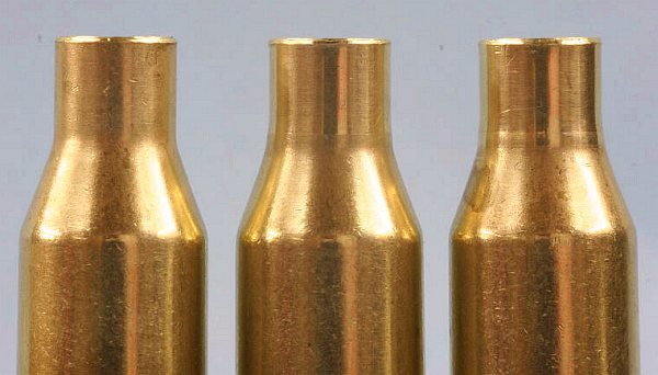

So you were not able to bump the shoulder with a neck die? This is a con? Neck dies are not meant to bump the shoulder.
The significance of a two step neck is less neck friction on the bullet shank. This can be a positive or negative depending on the type of gun. For example, people who jam their bullets into the lands can exploit the reduced bullet pull. Semi auto users, on the other hand, will struggle to get enough neck tension to prevent bullet setback.
I have always gotten worse runout with bushing dies than FL or collet. I use Redding body dies with Lee collet neck dies with better results.
Yeah I hear you; Caveat emptor. I should have read the fine print a bit closer before I purchased. I bought the Redding competition set after seeing the 6.5 guys' video on it -watching how they would measure headspace and adjust accordingly after measuring the ogive, headspace, etc. I guess I was under the impression (incorrectly) that the Redding type s neck bushing die would have the ability to bump the shoulder back a few thousandths especially since their competition sizing die has the micrometer adjustment markings. But in retrospect, this is why Redding sells their set in a trio with a body die that sizes the body and will bump the shoulder.
But I agree that not bumping the shoulder is not necessarily a con- so long as the headspace is proper, but in my Redding experience, I ended up having to FLS or use the body die nearly every other reload to maintain reliable chambering. Maybe this is more a function of crappy tolerances in an RPR, but regardless, I was overworking my brass.
The reason I list it as a con is that, given the options present, Forster sells that 'impossible' die you speak of - a bushing neck bumping die that will bump the shoulder back. Thus prolonging brass life so that I can shoot an entire season with the same lot of brass, which would have a lot of inherent benefit to me dropping coin moving to a new caliber instead, since I don't own a collet die and would be buy a new caliber regardless.
Why do you think you are seeing more runout with bushing dies? Proponents of them say that the floating bushing is supposed to allow the case to self center, thus improve concentricity? I have heard this from other folks too how a FLS/ collet/ honed die can result in less runout.
