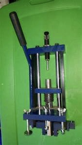

I’m curious if anyone has experience using some of the higher end swaging presses for reloading? Specifically the Walnut Hill or Corbin presses.
I also was looking at CH4D presses? Any thoughts on those?
purpose for high end swaging? Is it something you cant do on a Dillon or a single stage with a swaging set up?

He be referring to making jackets bullets using a swaging press. The press is usually custom built and exceptionally strong. In these days and times, I wish I had invested ten or more years ago when the MMIC was still Vice President and the TIIC was doing his absolute best to destroy 50 years of efforts to reduce hate between races (and his best to destroy the nation)

Below is a picture of the Walnut Hill swaging press. No longer in production but a very popular press
Yeah, was curious given you could spend $1000+ on a high end press. Wondered if people had experience with reloading on a Corbin. Plus you could use it to swag. But I am curious how it works as a reloading press. Reviews suggest that as a swaging press it works great.
