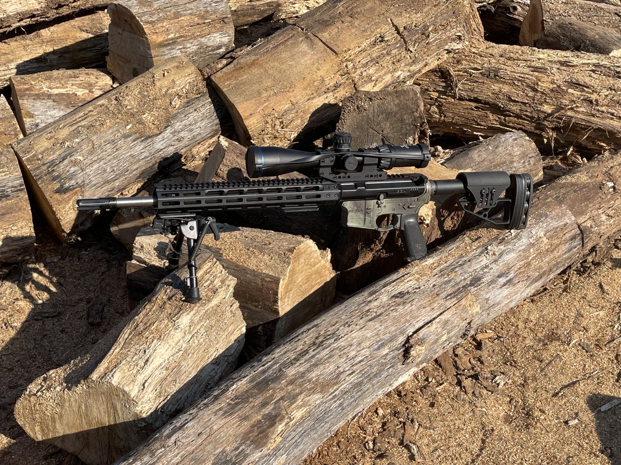

I have almost the build you talk about now minus a few small details. It shoots very well, all I have shot from it is 77g thus far. I think you’ll have good results with your build list. Build deets are below for mine
-Mega ambi upper and matched lower
-Bartlein 18in 1:7.7 custom contoured and built by a guy I know at GAP, WOA competition barrel extension, headspaced to a Seekins bolt and carrier. Wylde chamber, 5/8-24 muzzle threads
-SLR adjustable GB, rifle length gas
-TriggerTech trigger
-Magpul PRS Gen 3 stock, heavy weight wolf spring and standard buffer
-JP cantilever mount and an HDMRii pro 3.5-21 scope
-typically sits on GG&G bipods

Build is complete. Sometimes I get these groups but not always. I’m sure I am probably the issue but they are rarely over 3/4 moa. Still testing to see if the groups open up after fouling or if I’m just tired at the end of each session. Ammo is 75gr FGMM 2” dots
