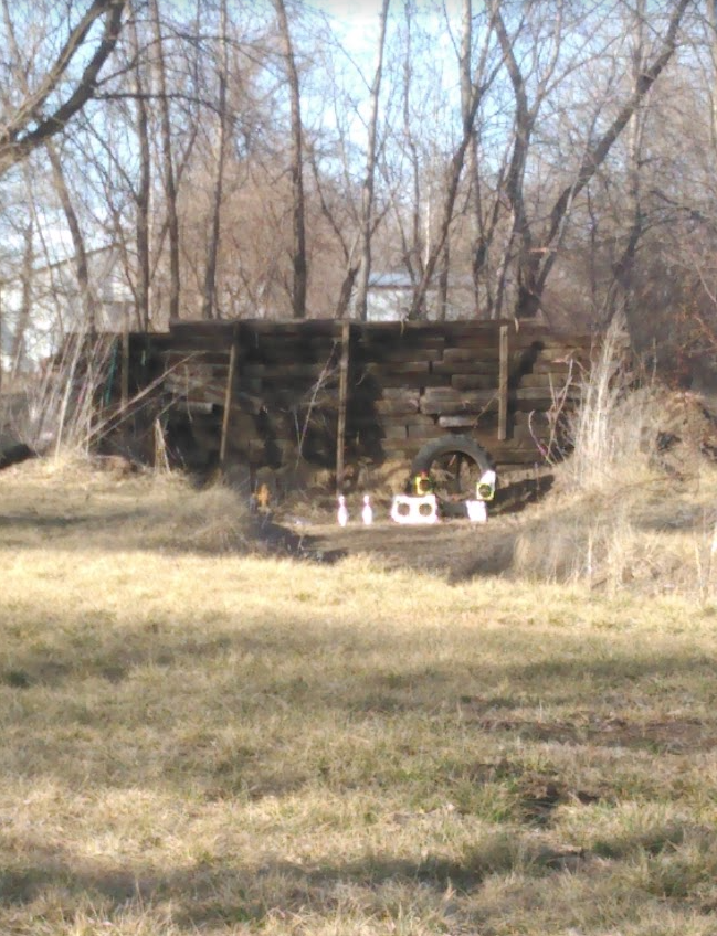

I technically have two ranges:
At my house, I have 175yds from my back porch to the base of my woods. There I have Railroad ties set in a wide V with dirt filling up to about 5ft. I'd like to move that set just into my woods and make the berm more like 7-10ft.
At my dads farm (1/4 mile down the road), set on the corner of his field I made a berm out of old tires with t-posts and fill and surrounded by dirt. This berm is about 5-6ft tall. Behind this berm is a 10 acre woods and 1.5miles before you hit any other home (google maps).
How big are you guys making your berms? I work at a tree service, so I also planning on bringing a big load of logs to help reinforce the back and cut down on the amount of dirt I need.

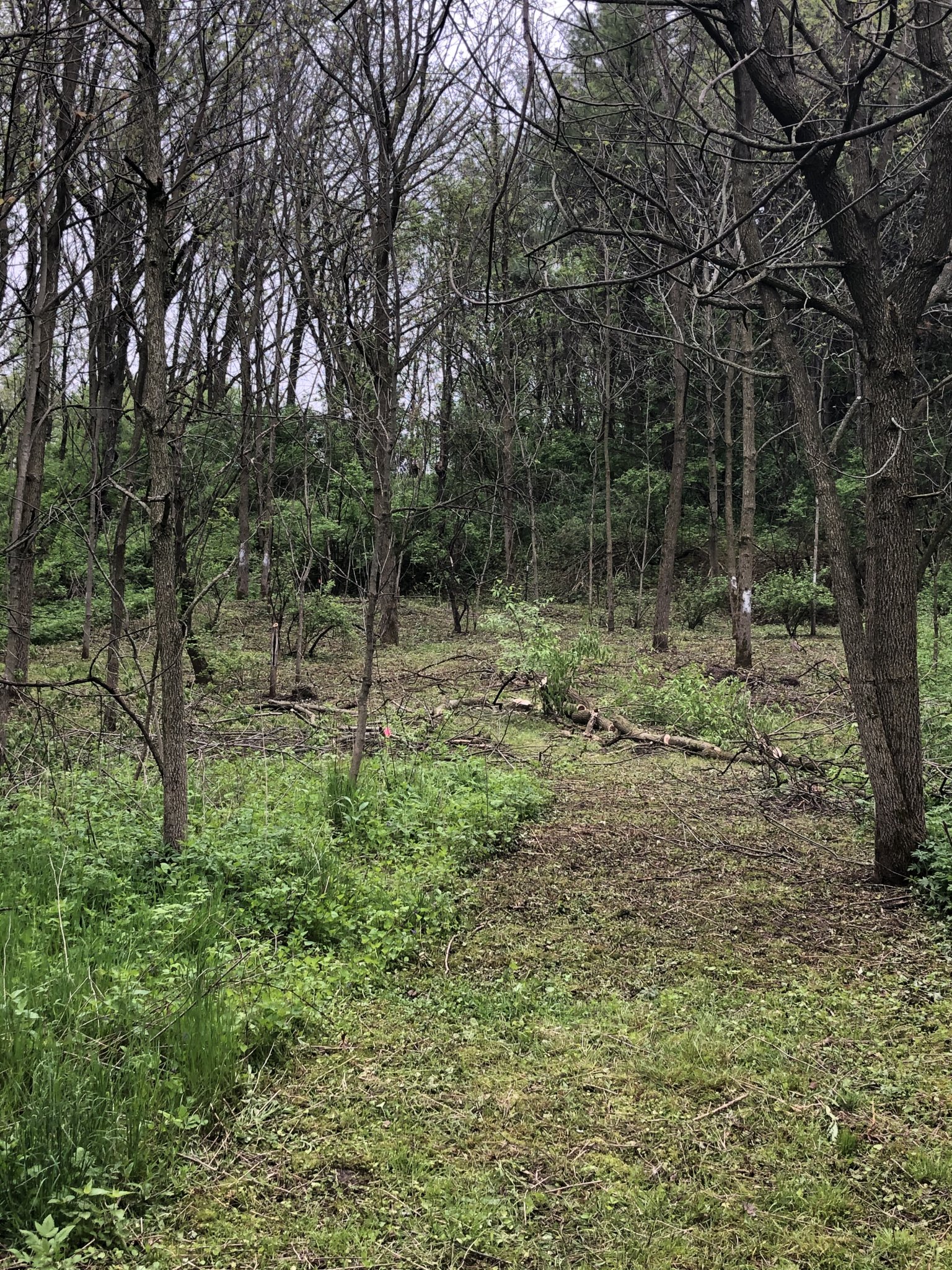

Getting started. Got the outline string-trimmed out, working on cutting all the shrubs and trees out of the interior of the square. Definitely going to be more dirt work than I initially thought (now that I can actually see the ground level with the undergrowth mostly gone). Lots of hills and valleys that need smoothing. I figure that just means more dirt to make a higher berm, so I’m staying optimistic and saying that’s a good thing.

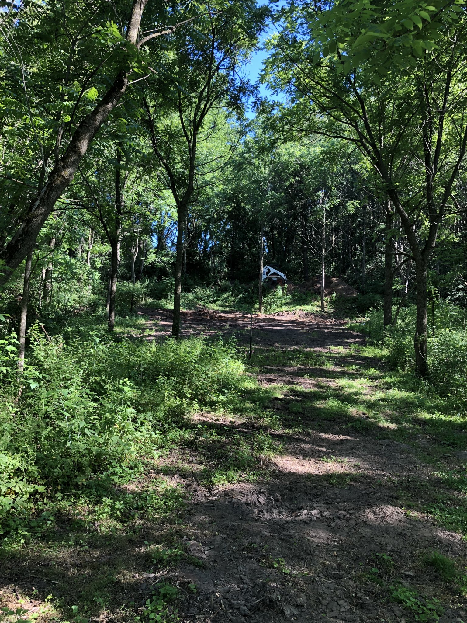

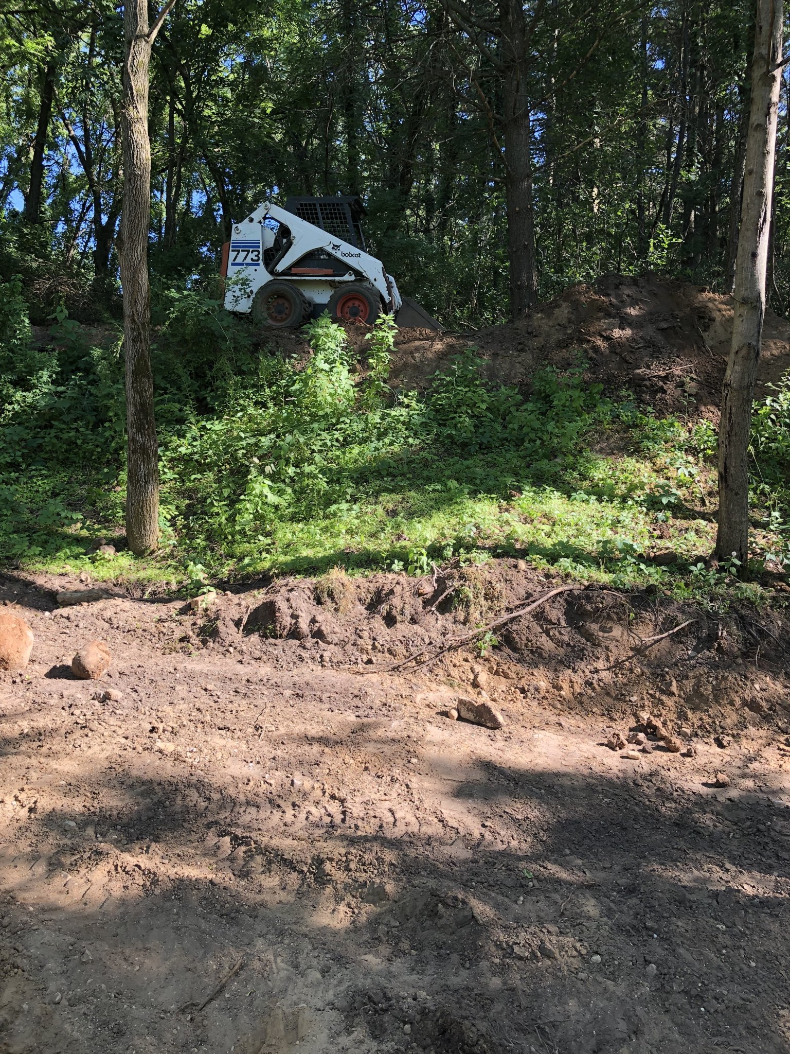

Forgot about this thread until today.
2021 brought lots of overtime and my twins, so my time for shooting range work was minimal.
My hiatus meant I was basically starting over for 2022, since overgrowth happened way faster than I thought it would. I finally got the rest of the trees cleared, and burned all the brush/small trees I cleared off to the sides during a warm snap in early spring.
I rented a stump grinder over Memorial Day weekend and split the cost 70/30 with my brother in law. I had a bunch of stumps I needed to get rid of in my actual yard, and a metric shit-ton here in the shooting range. Ended up looking like I have a demon-gopher infestation by the end. Didn’t save a photo unfortunately.
On Father’s Day I told my wife I didn’t need anything, but I wanted 5 hours of uninterrupted time in the skid steer before we fulfilled family obligations. I got a lot done, I figure about 1/3 of the necessary dirt work completed (which is a small blessing, with diesel prices where they are). Just gonna keep at it 1 hour at a time throughout the summer and I should be able to have it done before fall.
My planned skid steer path to the top of the berm along the left side worked out pretty well. Once I got my path cleared, I leveled the top off, cleared a few turn-arounds on top of the berm, and have added a few feet of elevation to the top so far. Probably about 14ft tall right now, plus the remaining hillside past that.
Still a lot of leveling to do, but it’s currently useable for occasional pistol work. If anyone in Northern IL has a run down garden shed they want to get rid of, I’m searching for a place to store steel, targets, spare t-posts, VTAC barricades, etc…

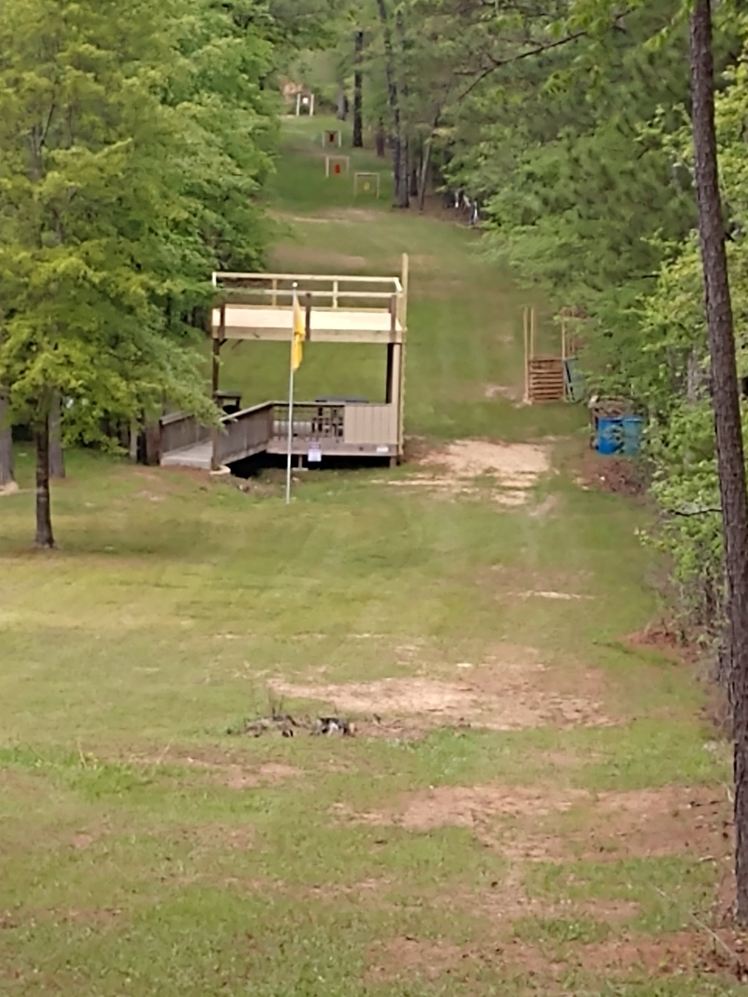

Complete dumb luck, about 12 years ago I was surfing the internet one night looking for property and daydreaming of my own rifle range and this property popped up. It was part of a group of 40 old tax auction purchases by a guys dad and he had to dispose of them.
Reactions: 338dude
Pics of this glorious estate?
Sorry to derail, op
GetAttachmentThumbnail

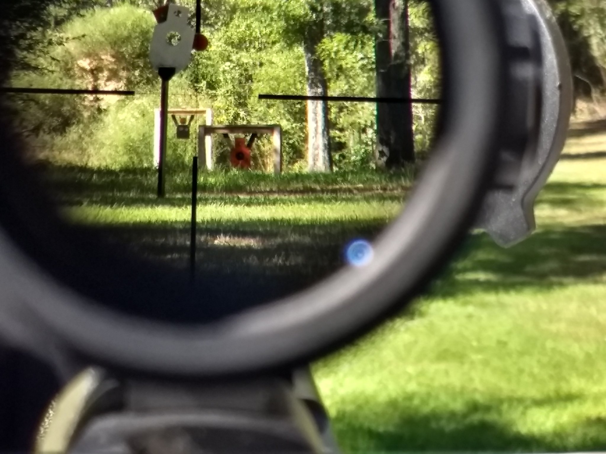

As you gaze off into the distance there are steel targets in the shape of tombstones creeping in from 725 yards, they are spread over a 1/4 mile of width so they cover the wind from different angles and their rusty hide makes them tough to spot. I paint them tan with an MOA circle in their chest when its time to practice for hunting season.
There is a fire pit and sometimes I drive out in the truck camper, set up a canopy and enjoy the peace and quiet for a couple of days.

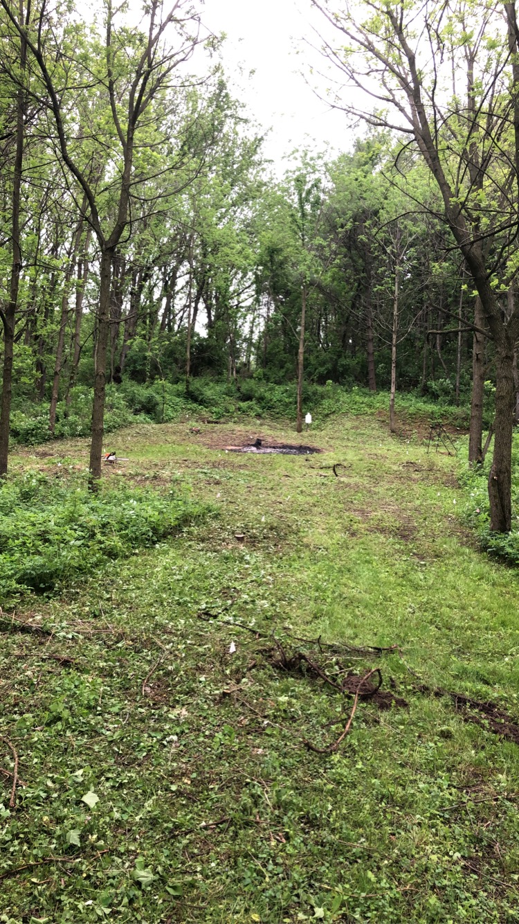

I spent about an hour leveling the southeast corner this afternoon (far left of the berm face). It’s not done, but it’s getting there. Quickly realized that the stump grinder did not dig down far enough for as high over grade as that area was. Ended up with a ~10” diameter stump that was a bitch to dig out with the skid steer, but it’s gone now. Roots were huge, and much deeper than I’d planned to have to dig to get it out, but it’s all backfilled and looks good now. Likely the last legitimate tree stump that remained in the leveling/excavation.
Make sure it’s mowable. One thing we did was screwed a piece PVC board perfectly level and plump at 100 yds it keeps you in check with rifle cant. 50 yds even better Also great when setting up your rifle, If you put your targets against it it keeps them plump and level as well. It’s quite the aid and so simple. I’ll post a pic next time I’m out shooting.
It will absolutely be mowable, even now. I’m still in the excavation process, but every time I’ve stopped dirtwork I’ve taken 5 minutes to back drag the entire thing and knock down any high spots. That way, if I don’t have time to work on it for a month I’ll still be able to mow down all the weeds and remaining grass, and it won’t start to get overgrown like it did last year.
I thought about adding a gravel layer for easier brass cleanup, but I’ve decided I’m going to rent a roller when I’m done to really level and compact the whole thing down. I’ll just drop the mower deck an inch to cut the grass shorter inside the range’s border than in my yard.
