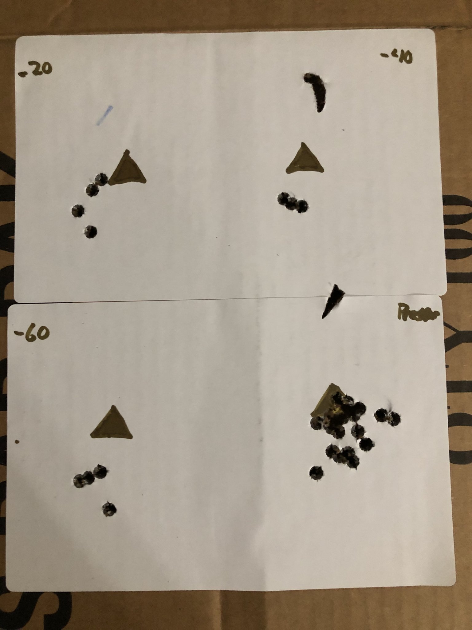

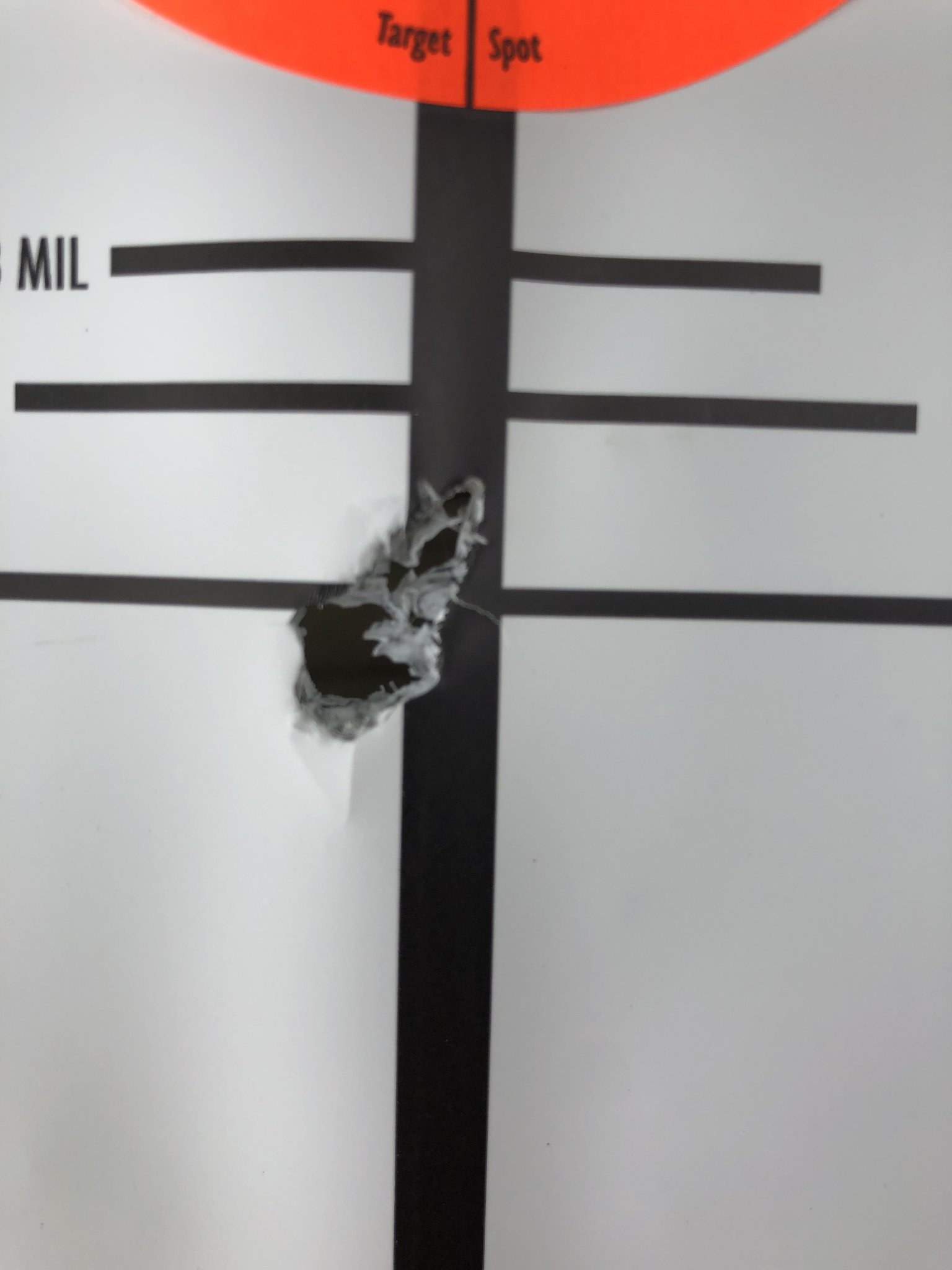

    I just had two 147’s go crazy on me today. This was not the first time. Shooting proof carbon barrel, 1:7.5 twist, 26”, 6.5 PRC. Only about 150 rounds through the barrel. I’m running them around 3050 FPS. Lot# 2190612. Attached are what the bullet impacts looked like.

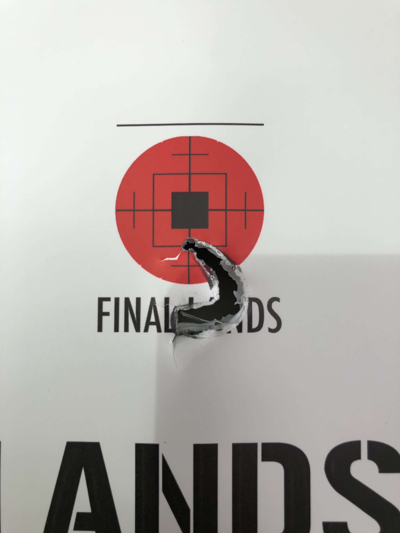

    Contact Hornady and send the pics to them. Glad it was the 219xxxxx lot.
    Reactions: Ranger1107
    Ranger1107
    Dec 31, 2018
    13
    4
    I will tomorrow. Thanks. I thought I was going crazy. Glad to hear I’m not the only one experiencing this issue.
    The left pic is amazing. To me it looks like the jacket made it but not the lead core. If on the right pic that is one bullet, 50 yards further and you most likely would have not got anything.
    Ranger1107
    Dec 31, 2018
    13
    4
    What is really interesting is a that each time this has happened, my magneto speed spiked about 100 FPS.

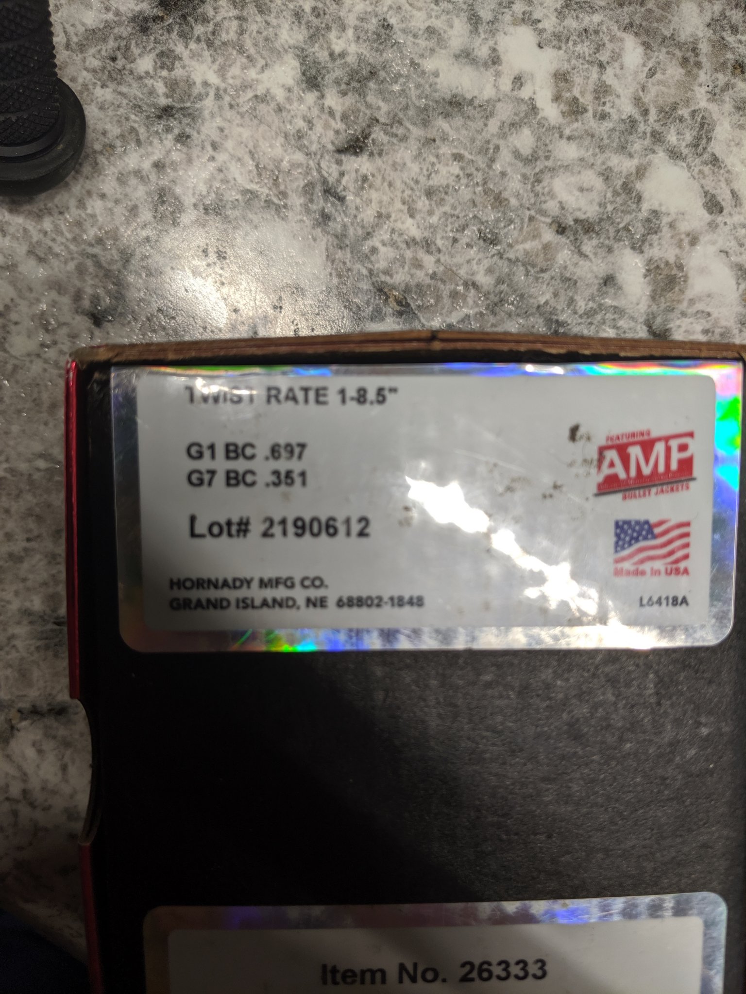

    I had the exact same thing happen to me also today with 147's on a 26" Proof 6.5 PRC.

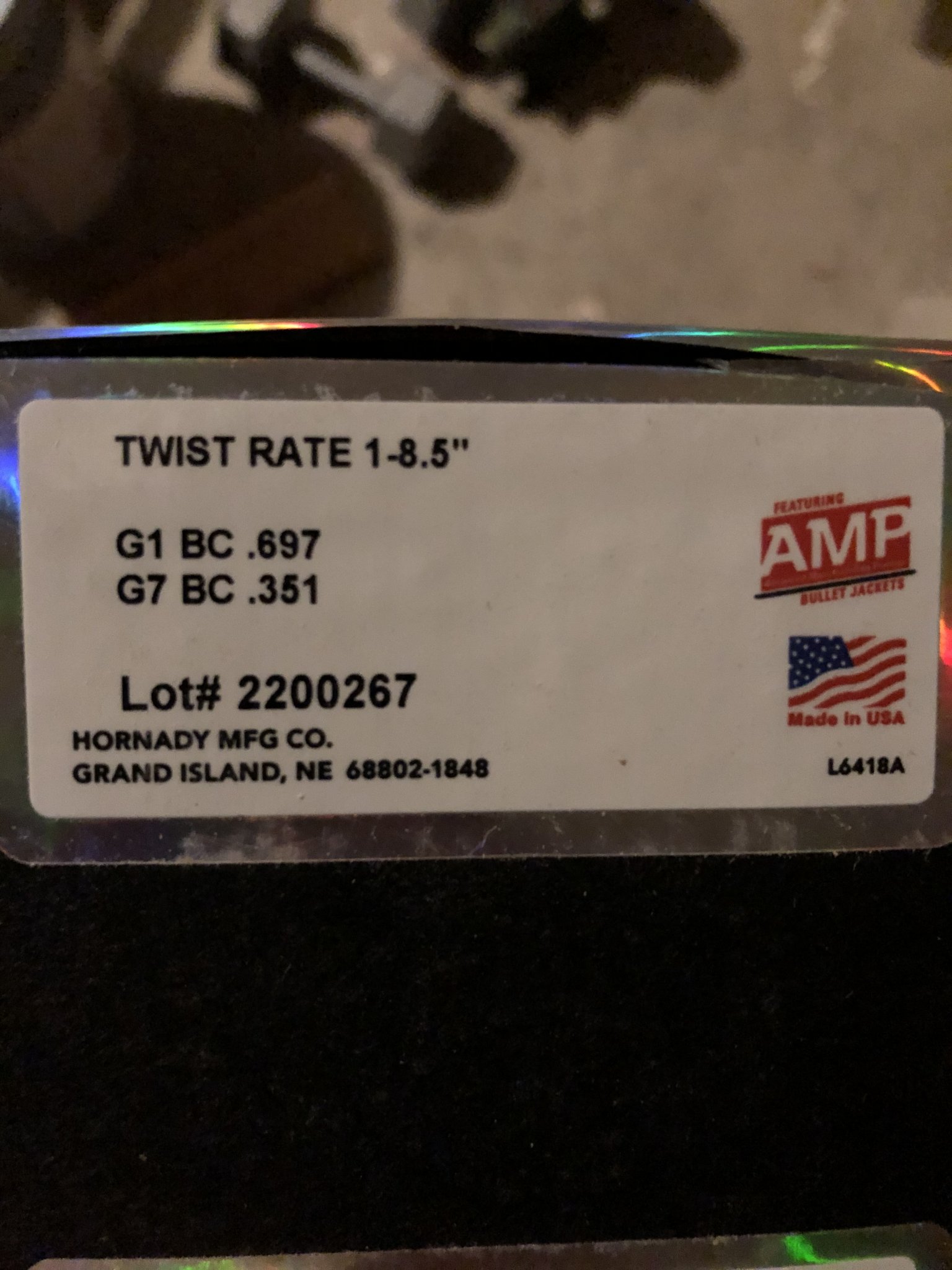

    So is that 8.5 twists a new addition to the box ?
    So basically the majority of the 6.5 shooting world uses an 8, and now they are saying you need 8.5 for a heavy vs going faster for a heavy, they want you to slow it down.
    Gotcha, that appears very "cover your ass after the fact" to have that twist rate printed on the box, so they get to claim operator error
    Steel head
    Feral kitten
  • Aug 3, 2014
    14,442
    38,729
    Washington
    exactly!
    ktmkaratechips
    So thaaaats how that works
    Jul 5, 2019
    9
    3
    Idaho
    I hadn’t noticed that but yes appears so. Bailing on the 147’s. I’ll finish out the barrel on 140’s and see what happens there.
    vh20
    Gunny Sergeant
    Dec 2, 2012
    2,912
    2,357
    56
    I wondered the same, but after thinking about it I'm going to guess they're recommending that's MINIMUM twist to stabilize that bullet. I believe the 50ct boxes of 300SMKs have 1:10 twist printed on them (my 500ct boxes do not - I checked). That is definitely a "minimum twist" recommendation they are referring to in that case.
