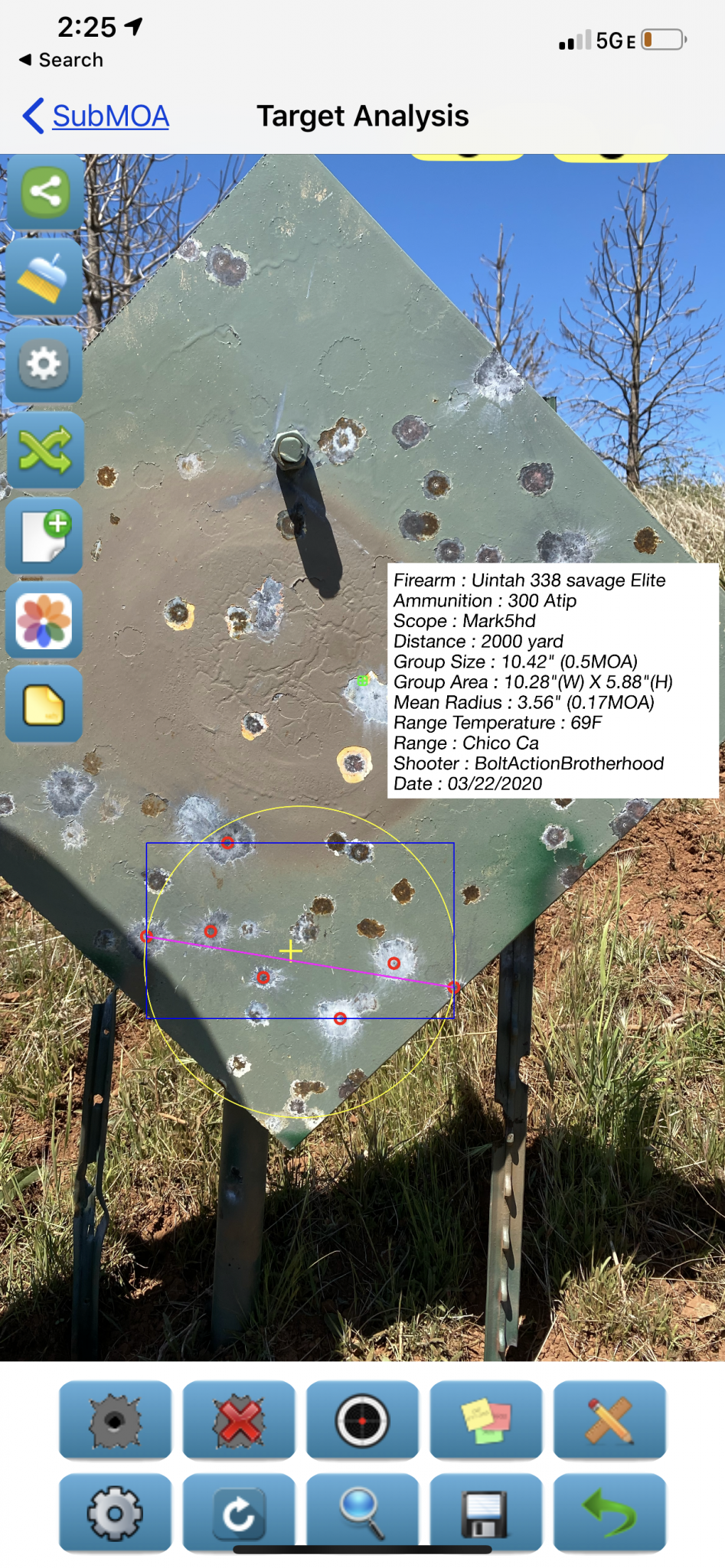

I was finally able to test them at distance a couple days ago. I came up with a G7 of 0.448 for the whole trip to 2300 yards. The bullet was almost down to 1100 fps. G7s for higher velocities/closer distances will likely be higher.
The BC isn't really the point, it's an added benefit. They held vertical better than anything I've seen except the 30 caliber 230 grain ATip, and they certainly weren't any worse than that.

I agree the do awesome. Here is a group at 2000 yards 7/10 impacts with the atips

Nice shooting! I've got a few groups in the low 5s with the 285 ELD-M but at 200, not 2,000.

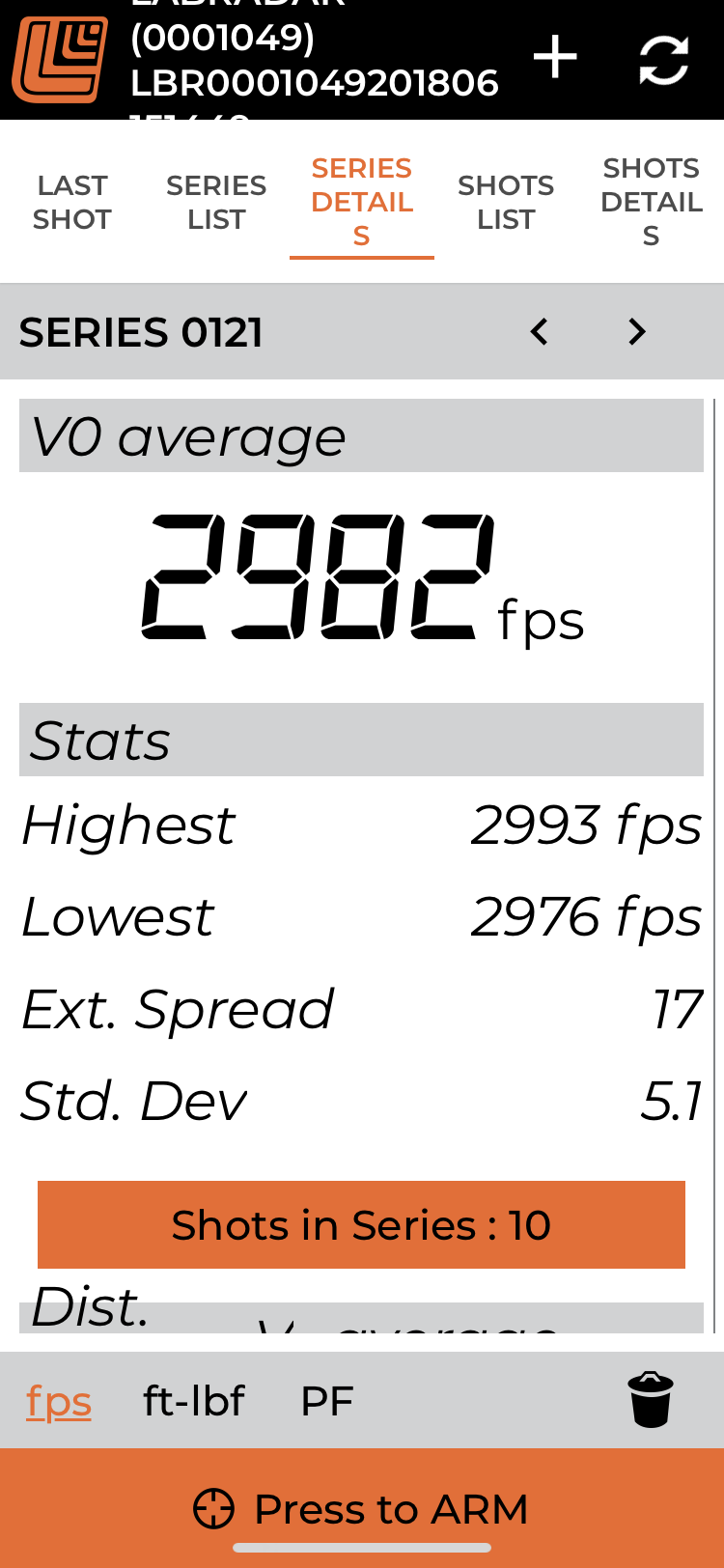

May I ask what cartridge, speed and barrel you shot the 300gr A-Tips with?
33xc using the solids reamer with the shorter freebore. The ATips are loaded 5 thou into the lands at 4.215. 30" Bartlein 1:9.3 MTU profile. 115 grains of 24N41, 215M primer, Tubb brass on its 6th firing. The brass will take another 75 fps, but this one bugholes and gives the best velocity spreads.

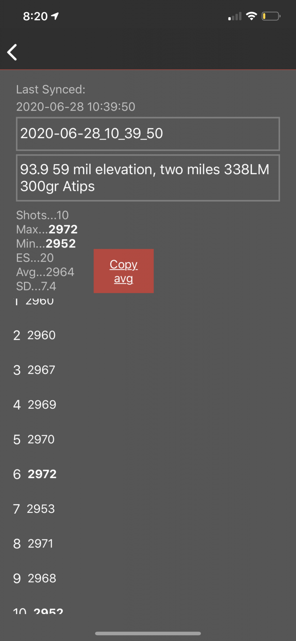

I shot it a few weeks ago to just past 1700 yards. It was impressive, but I was uncertain of my zero. It turned out that I had zeroed it, but didn't slip the turrets. I also wanted to see how they did deep into the transonic before I posted anything.

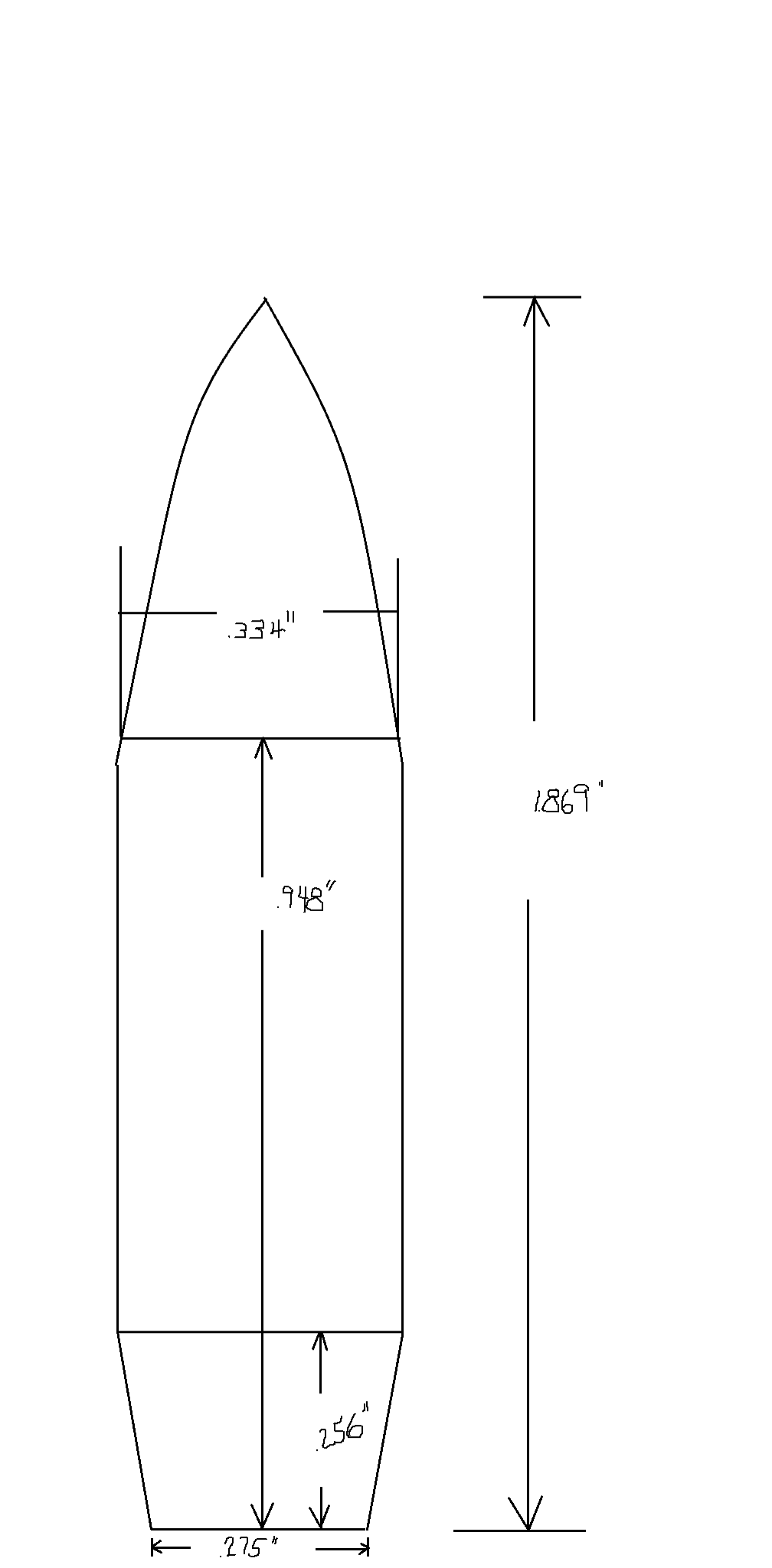

By the way, might you have measured the length and diameters of the boat tail?
Earlier you posted an OAL of 1.872" and BTO of 0.997". I was hoping you also have the boat tail dimensions so I can add it all to the bullet database of Gordon's Reloading Tool and use it for load development.

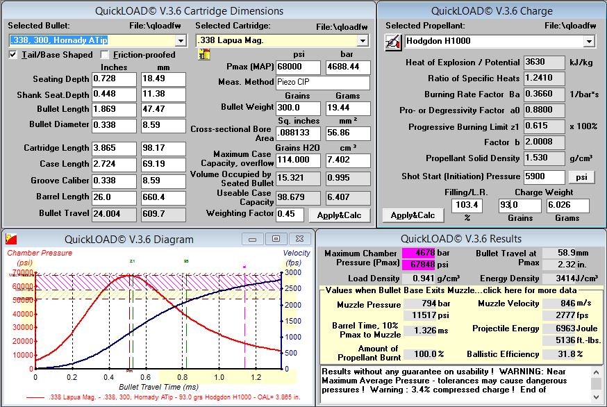

I heard the latest update for QuickLOAD should have the 300gr A-Tip included in the Hornady bullet file but I don't have that version available.

I measured the boattail beginning at 0.256" from the base and 0.275" diameter at the point where the radius begins.
I measured 1.869" length but only 0.948" BTO using the Giraud comparator with all the limitations that entails but it appears to be pretty darn close to the .334" that one would expect. The shoulder end is .476" as close as I can measure. Again, just where one would expect. Weight and dimensional uniformity of the A-Tips appears to be better by 1/3 compared to the 285 gr. ELD-M.

I still don't see the 300 gr. A-Tips in the ABS or Hornady 4DoF yet. I've had the A-Tips since early March but the seating stems are only just showing up at the distributors.
I'd be interested in the Gordon's prediction for this. I'm using H1000. Please share your output.

Would it be possible for you to mark your measurements on this image?
Just a marking/letter on specific location in the image and tell me what your measurement is.
I think I understand 90% of what you wrote, but I'd like to be sure. Thanks!
Hopefully I soon get a couple of 300gr A-Tips myself.

Artwork courtesy of Cro-Magnon Cave Scribblings. Not to scale.

Gordon's Reloading Tool file: Hornady A-Tip Match 300gr 33389.projectile
XML:
<?xml version="1.0" encoding="UTF-8" standalone="yes" ?>
<GordonsReloadingTool>
  <projectilefile>
    <var name="mname" value="Hornady" />
    <var name="pname" value="A-Tip%20Match%2033389" />
    <var name="lotid" value="2020" />
    <var name="caliber" value=".338" />
    <var name="gdia" value="8.59" />
    <var name="glen" value="47.55" />
    <var name="gmass" value="300.0" />
    <var name="gmaterial" value="0" />
    <var name="gpressure" value="250" />
    <var name="gtailDiaA" value="8.59" />
    <var name="gtailDiaB" value="6.99" />
    <var name="gtailh" value="6.50" />
    <var name="gtailType" value="2" />
    <var name="g1bc" value="0.863" />
    <var name="g7bc" value="0.435" />
    <var name="gUBCS" value="" />
    <var name="cdate" value="2020-05-29" />
    <var name="cby" value="Marty" />
    <var name="mdate" value="2020-05-29" />
    <var name="mby" value="Marty" />
    <var name="type" value="" />
    <var name="mode" value="userfile" />
    <var name="status" value="" />
    <var name="origin" value="" />
    <var name="descr" value="Created%20by%20M289%20with%20help%20from%20Howland%20and%20SIDS01%20from%20Sniper%27s%20Hide%20Forums." />
    <var name="imageUuid" value="" />
  </projectilefile>
</GordonsReloadingTool>
QuickLOAD file: Hornady-ATip-300gr-33389.bul
Code:
; M289 QuickLOAD Bullet File for 338cal Hornady A-Tip Match 300gr #33389 - 2020-05-29
; Created with help from Howland and SIDS01 from Sniper's Hide Forums
" 1 [bullet]"
".338, 300, Hornady A-Tip 33389          ","300","1.872","6.99","8.59","6.50","G1","2",".338",".863",".863","","","","","","","","","","25"
As always, use with caution when developing loads in theoretical models.
Also, these files have been created by me based on the data shared by @Howland and @SIDS01. The official Hornady Bullet file as it will be distributed by QuickLOAD might have different values.
That said, I'm confident that I didn't mess up the bullet definitions and I will verify and update this topic when I receive my own Hornady A-Tip 300gr bullets 👍🏻

I've had pretty good luck with the QL H1000 data. This is for the 300 ATip from a 338 Lapua RPR.
See one thing that throws me for a loop is its showing you are almost overpressure. Like for me, my load is is 94.0 gr and I am getting 2962 fps (30 inch barrel) which according to quick load is showing WAY over pressure. But I am not really getting any pressure signs. And I am a very experienced reloader and can read pressure very well. That being said if I go over 94.0 I start seeing mild signs. Quickload says I was at like 78k psi Or something lol
The only thing that produces velocity is pressure and peak pressure does it much better than mean pressure. Have you ever calibrated pressure signs to an actual pressure measurement? I haven't. I use a blade micrometer in the extractor groove during pressure ladders with new brass to get an idea of how many firings the brass will give at each velocity, but that's still not pressure. It's how well the brass is dealing with whatever pressure there is. Lapua brass will take much higher pressure than SAAMI. Try to get that velocity with Hornady brass and see what shows up for pressure signs.
I'm running 2980 fps with a 30" 33XC because the velocities are very consistent and it bugholes there. I can run it up to 3050 fps without the primers looking much flatter and still no ejector mark, but the brass starts becoming more difficult to size. That QL model has 3050 fps at 73.4 ksi. Bolt lift doesn't go up at all in a Savage action that's had the primary extraction adjusted. I have access to a 2300 yard range and do a lot of testing. I haven't had much luck with the 338s against my baseline rifles before the 300 ATip. I'm starting to suspect that jacketed bullet ELR performance starts getting sketchy beyond ~70ksi. The larger case allows the same velocity at a lower pressure, but it's a huge trade off.
Boatwright schooled me on using the start pressure to calibrate QL models in one of the 33XC threads and I've taken it to heart. With the 33XC model, it takes a 12 ksi start pressure with the same bullet to line up the observed velocity. Match chamber in a match barrel compared with a factory barrel.

I've got the first test loads ready and plan to hit the range Sunday. I'm also using H1000 in an RPR with Lapua brass and 215M but I didn't dare to venture beyond the 92 grains max load per Hodgdon. Nosler is even more conservative at 90 grains maximum.
Also can you discuss you changes to Weighing factor (.45 instead of the deafult .55) and shot start initiatedquickload
pressure of 5900 opposed to the standard?
I will tell you the Atips have done well for me at ELR ranges, Last weekend I took my 338 lapua with the atips (Savage elite precision rifile with stock 30 inch barrel) out to two miles, and ended up getting two back to back hits, and that was my first time shooting at this target.
Luckly our new range we build has targets set up from 100 yards all the way out to two miles.
I do need to adjust my load because h1000 was not as temp sensitive as I hoped, my load normally gives me 2962fps (70-80 degress) but it was 100 out and the speeds got all the way up to 3002 fps.

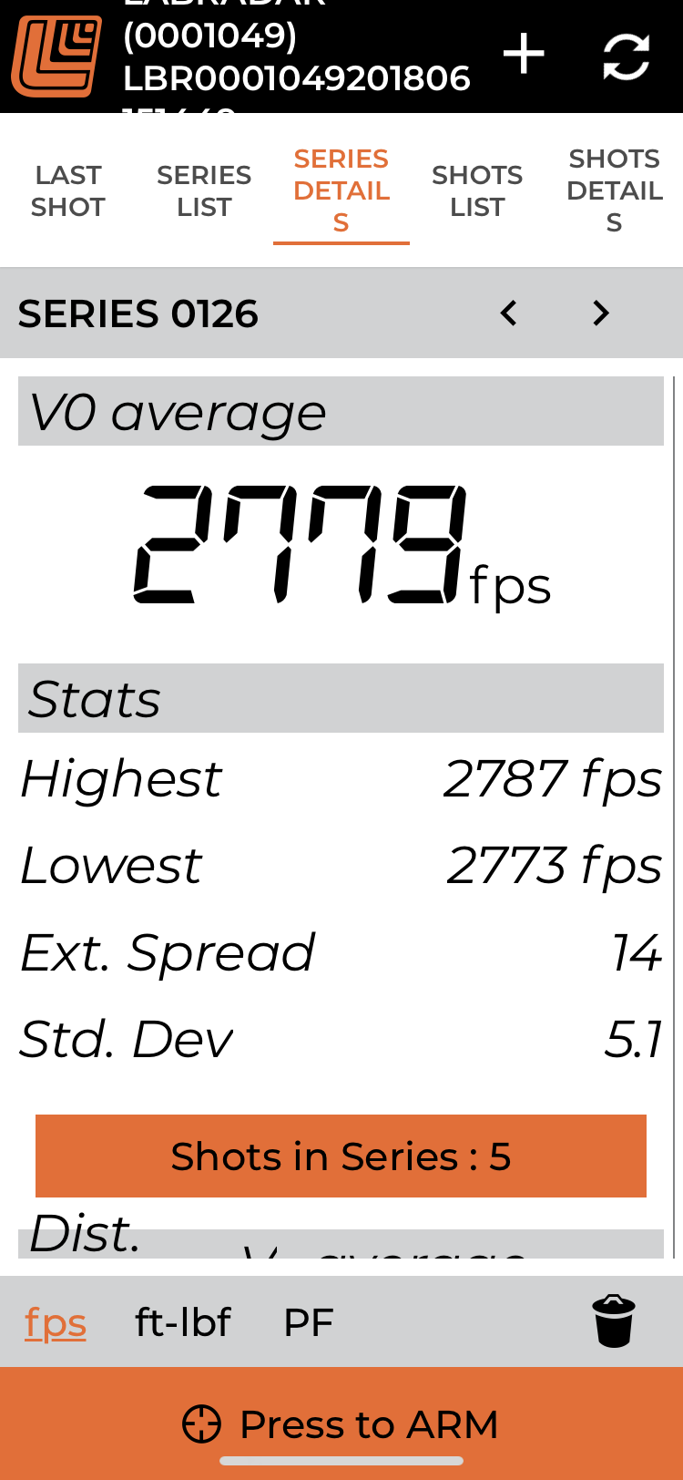

My first ladder started at 87.0 grains. It was based on the start pressures I'd seen for that bullet with the 33xc.
This ladder started at 91.0 grains which gave 2722 fps, with an ES of 10 and SD of 5.2.
92 grains gave 2756 fps with an ES of 16 and SD of 6.0 for 5 shots. It also gave the best accuracy. I was using the 215M primers and loaded to 3.865" which was .010 into the lands. The brass was neck turned to 0.0145".
The sample sizes are too small to take small differences in the SD or group sizes too seriously. The SDs are low enough for the whole pressure ladder to conclude the primer and powder pairing is solid.
2750 fps with a 300 grain bullet from a 26" 338 Lapua isn't a bad place to stop. The big RPR action and the brass will take more, but more won't necessarily get any more hits. At some point, the pressure starts working against you with jacketed bullets.

The Weighting Factor adjusts the relationship between velocity and peak pressure. If you leave it constant and model larger and larger case volumes, you'll find that it exaggerates the overbore effect. Pressures go up, but velocities don't. A couple years ago, I started testing the effect of overbore on performance and barrel life. I used the Lapua 338 Lapua case as the basis for a series of increasingly overbore cartridges. The overbore was adjusted by necking the case down to 7 or 30 caliber and improving it. A 7/338 Lapua Improved is very similar in overbore to a 338 Snipetac, but was a lot cheaper to build with parts on hand. I started with a straight 7/338 Lapua, which is similar in overbore to the 375 Lethal Mag. Yes, I've turned a few bullets inside out. I've also done a 30/338 Lapua Improved which is just past a 28 Nosler. My latest 338 Lapua RPR recently became a straight 300 Lapua. By using the same case for all of them and using the blade mic on the extractor groove to gauge pressure, it became apparent that something in the QL models needed to change to get the pressures and velocities to line up. What I came up with was 0.45 works pretty well for overbore ratios along the lines of 300wm and 338 Lapua. 0.40 is pretty close for a 300 Norma or 338 Lapua Improved, I'm using 0.35 for the 33xc. Another way to go about it is 0.45 for cases with enough capacity to use H1000, 0.40 for Retumbo, and 0.35 for H50bmg. It's not a characteristic of the powder, it's a characteristic of cases with enough capacity to use those powders well.

Track down the 33XC thread where Boatwright schools me on Shot Start Pressure. Basically, Shot Start Pressure is a catch all for several things. It's not just the engraving pressure. It's also where you model the effects of things like jump/jam, neck tension, bore size, leakage in the freebore before obturation,.....
https://www.snipershide.com/shootin...tridges-designed-by-david-tubb.6899366/page-5
He starts at post 221. At post 220, I'm at where you're at now.
You may find that load is less temperature sensitive at lower pressures. I test a lot of stuff back to back. Maybe load a box of 50 half with what you're doing and half 3 grains lower. Check your 100 yard zeros and add the offset and new velocity to your solver as a different bullet. Shoot 5 of one, then 5 of the other. On the next iteration, switch the shooting order. By the end of the box, you'll have a pretty good idea of what the differences are. The primary thing I grade on is vertical spread. I always shoot with Labradar to keep tabs on how the velocity spread is contributing to that.

this is a string from today when it was a bit cooler, and I took it down .1gr to get back in a node.

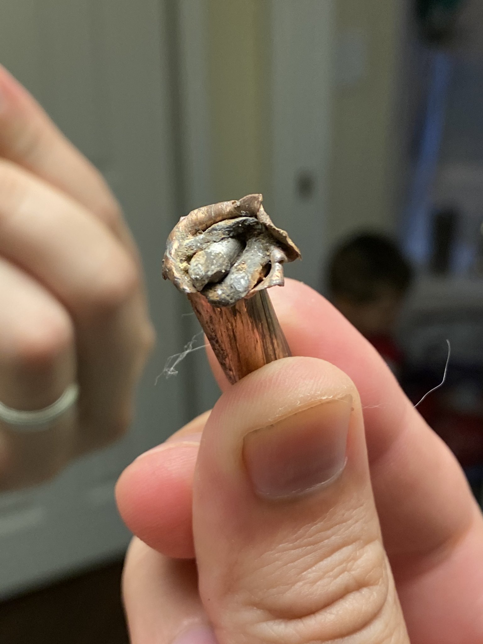

Ps here is an atip I recovered at two miles,you can see the aluminum tips in there with the lead, I assume this was an impacts.
