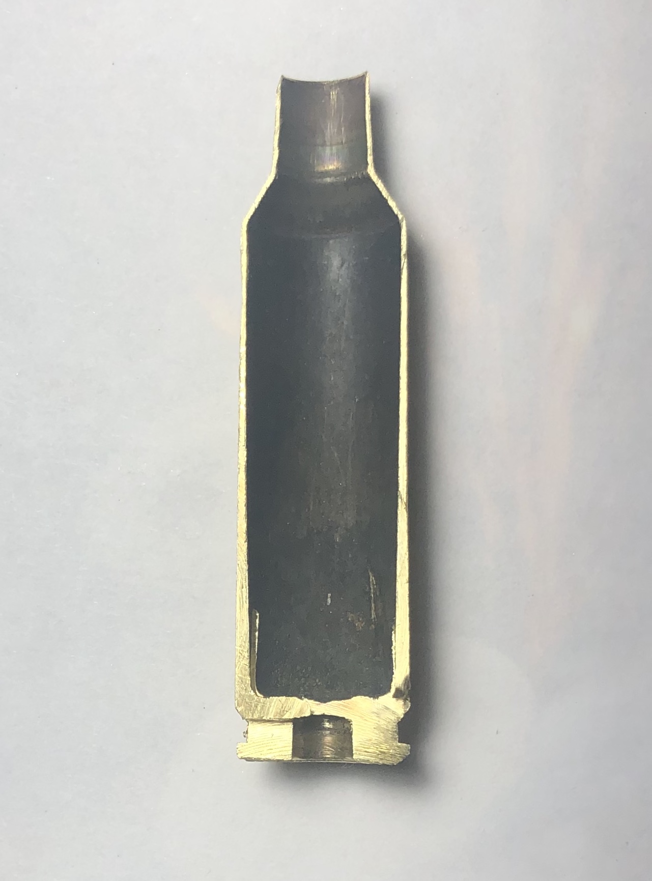

Hornady brass explosion
Presume you did not measure speed while firing these rounds?
I have a cheapo caldwell chrono, but in this particular day I did not have it out with me when the case separation happened.
I am going to remove the rifle from my chassis and have it inspected.
I am also going to scrub the carbon ring out.
I did finally buy some lapua brass to try out, but in the meantime I chucked about 140 pieces of brass that were the same lot as the cases that separated. (which I just processed last week, not amused at that lol)
I de cap, tumble in corncob, lube, resize, run mandrel down necks to set neck tension, re tumble in corncob, trim, then run across my case prep xpress chamfer deburr, uniform primer pocket and brush necks.
Soo all that work last week down the tube haha oh well I still have 50 pieces of once fired I will get prepped this week.

I cut three 24x fired Lapua cases open with a Dremel tool, and saw no stretching or thinning close to the web, retired them out of an abundance of caution. See pic below.
OP, you may want to do the same for 2 or 3 once fired (fire formed) Hornady cases.

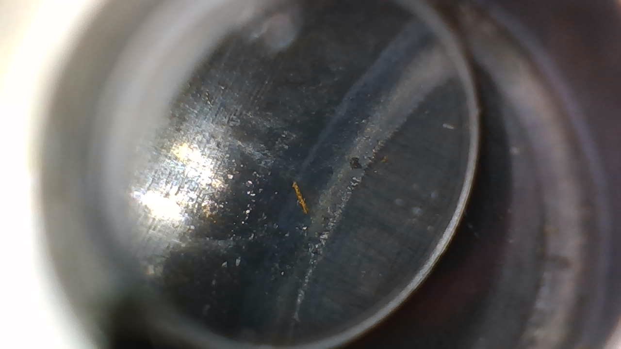

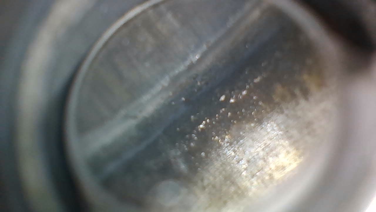

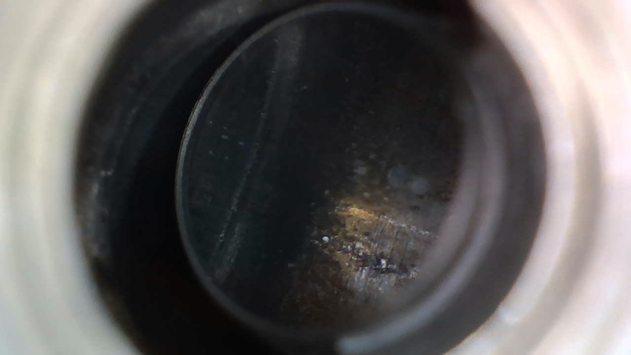

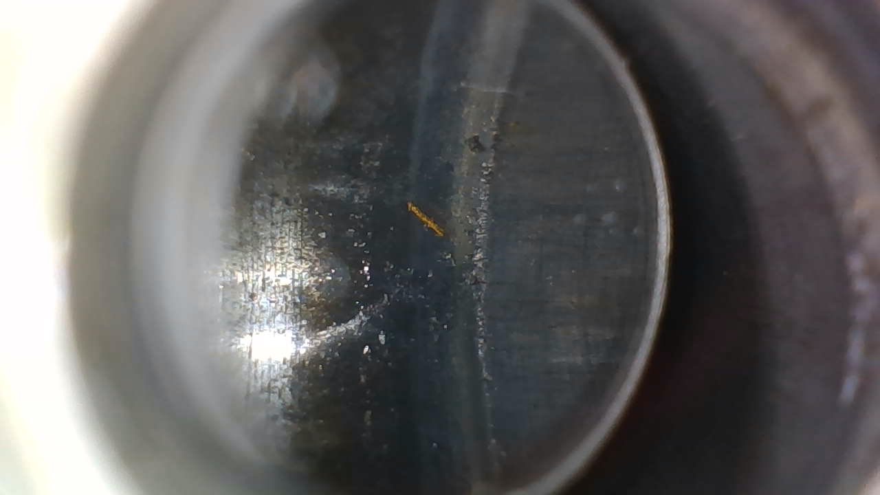

Another question guys, I just ran the bore scope down my chamber and it appears i have a carbon ring in their. It doesnt look like its out of control yet but there is defintely a ring forming inside. Could this have possibly casued the brass to fail? Weird thing is if the carbon ring did cause a huge pressure spike wouldnt it have blown the primer out or at least showed signs on the primer or pressure?
Here are some pics of the chamber i just scoped.View attachment 7185752View attachment 7185753View attachment 7185754View attachment 7185755
I would suggest that you keep your chamber clean. Cleaning the barrel does not necessarily clean the chamber. Use an appropriate chamber brush. There will always be some carbon leak around the neck to some extent.

OP: Once you have removed that (minor looking) carbon ring, perhaps bore scope it again, and then post a photo.
Will be educational for newbies who don’t know what to look for, or how to remove it.
Will do.
Im almost wondering if that ring did cause some pressure issues.
A few of the rounds that I fired, I could not drop a bullet in the neck. Most of them I could but there was a few that would not easily accept a bullet.
My boretech products should be arriving Friday and I will get that chamber scrubbed out and post some pics.
