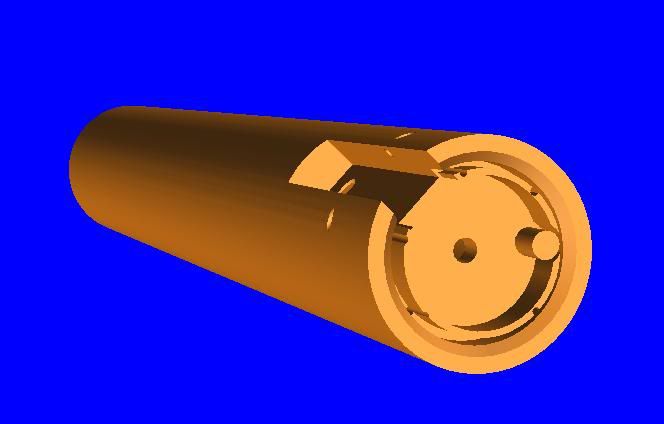

Lets say Jimmy has a rifle built on X rifle action, .473" bolt-face. Jimmy wants to shoot both .437" and .535" boltface catridges with his action. Manufacturer of action X doesnt sell .535" bolts.
Jimmy has his .473" bolt opened up to .535" and a 2-piece collet made that would pin into the face of the bolt to bring it back down to .473.
Outside of the collet mating snuggly with the inside of the bolt-face wall, sucured from rotation by 4 pins.
Here is what I drew for Jimmy.
Would drilling a few shallow, blind holes around the circumfrence of the bolt-face criticly weaken it? Would this be a reliable design at all?
(The collet would be of a closer fit than what is displayed, and pin holes not breaching the collet.)
Your 2 cents?

In "theory" this would work. Albeit not exceptionally well. You would need multiple extractors and feeding issues would arise immediately. Secondly in theory you would also be better off with a threaded "bushing" or "collet" that was interrupted for the extractor. The fewer holes in the bolt face the better. I would probably suggest selling and buying an action that different bolt sizes were available for. my .02$

Thanks for the input guys. I like the threaded collet idea, but I dont think it would work due to having to have a 2-pice collet for M16 style extractor and a plunger style ejector.
The action is an M2008, and I absolutely love it, but I want to run 7WSM in it, but only have a .473" bolt.

Now things are making more sense. Swapping the extractor isn't really appealing to me, but I don't know what the customer's overall goal is. I don't like the idea of a threaded insert, due to the fact this is being turned both ways quite regularly.
What about a snap-ring style insert like this? Align the gap with the extractor cut, the rim would fit in a groove cut next to the bolt-face.
-matt

There is an action maker who uses a bolt face collar system so you can go from a magnum rim diameter down to a .308 rim diameter. I want to say it is Barnard but it could be someone more obscure like RPA or Gilkes-Ross. I know I've seen it because I wondered if it was the best idea.
The bolt face is going to be fairly hard, over 40HRC I imagine, so drilling into it with small drills won't be super easy. I would talk to Marty about the whole deal.

If this were to scale, there would be some big shear force on the pins during extraction, and maybe some bending force if the tool did not have a shoulder butted up to the ring.
Notice how the more serviceable snap ring has big ratio of hole area to ring bending force.

I quickly drew that snap-ring to size, so yes the pins would be too small, was just a thought
If it were actually used it would need cuts for a small needle-nose plier or something to grab, I simply threw the holes on there to illustrate what I was picturing.
