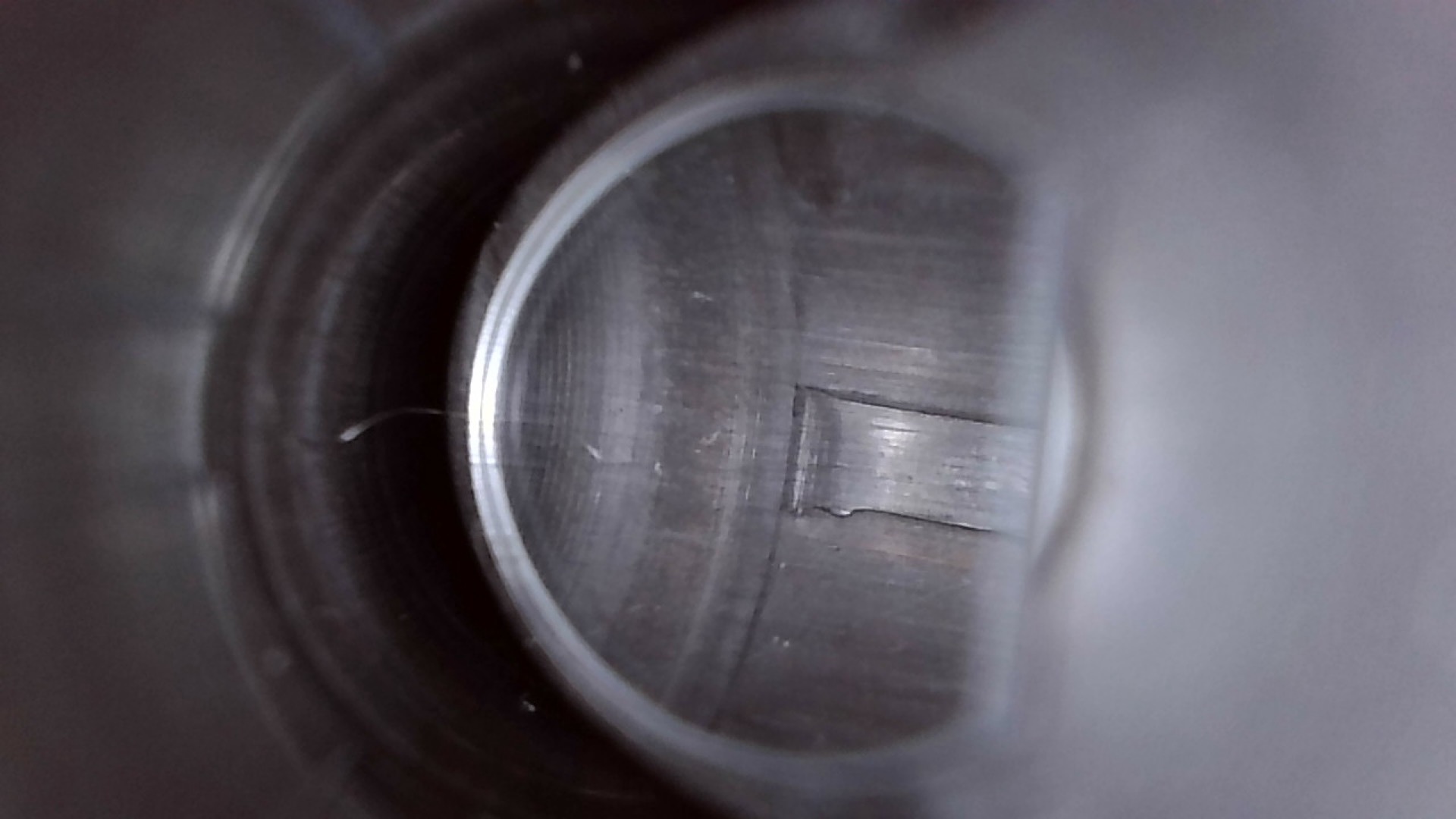

How do you all feel about this chamber job?

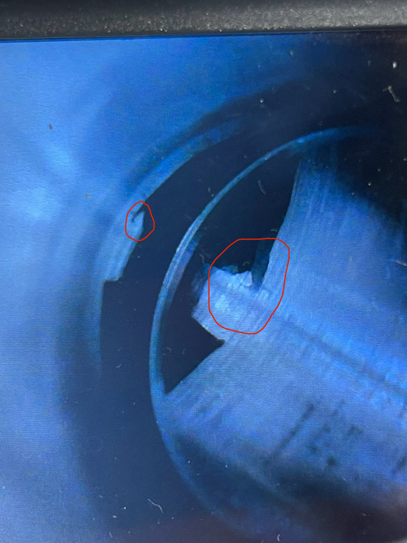

Just wanted to see what you all thought of the chamber job on my new bergara
I ran a borescope down a brand new 6.5 creedmoor and saw what appeared to be a burr down one of the rifling sections. This was a very expensive rifle. I sent a pic to a gunsmith buddy and he said - “how does it shoot?” It had not yet been fired, so I did the break in and tested 4-5 different ammo weights and manufacturers.

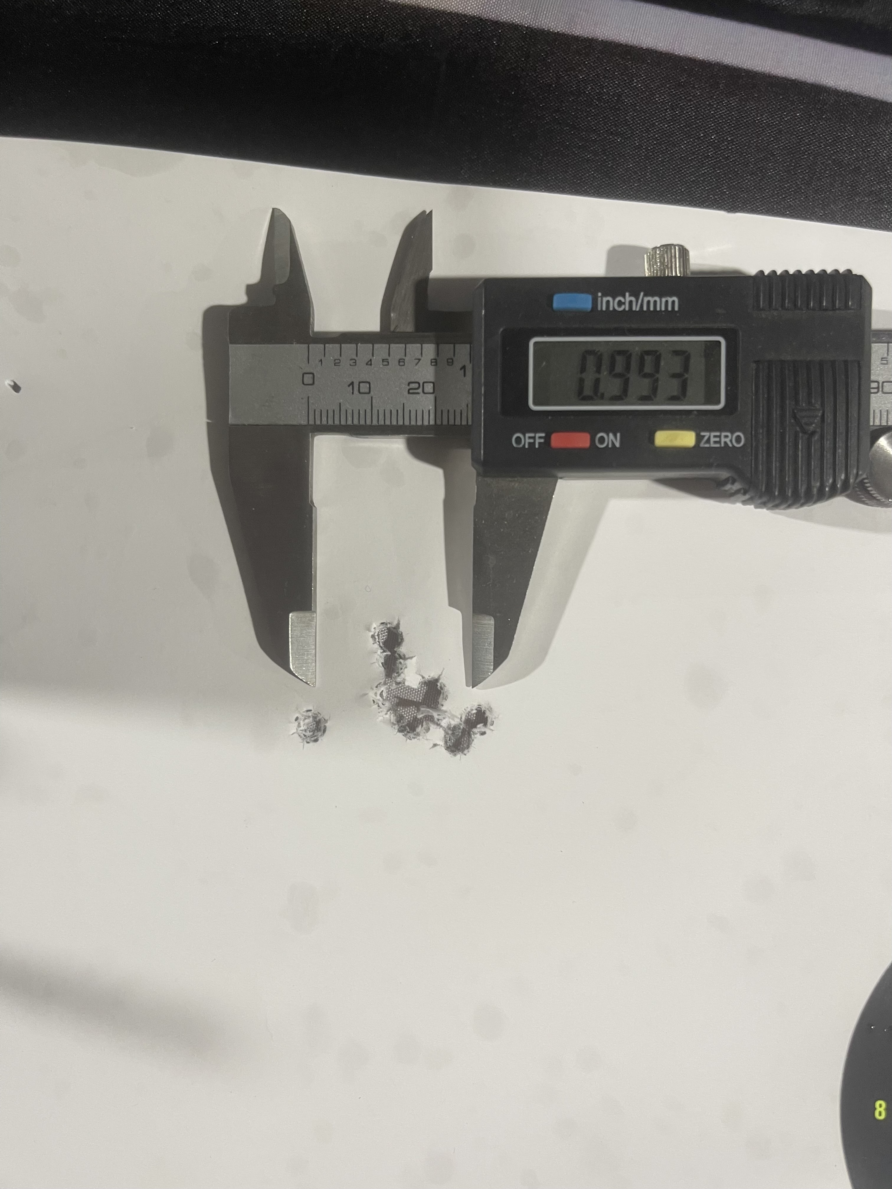

I’ve since shot half MOA at 500 yards, and a little smaller than MOA AT 1,000 with factory cheap ammo.
Shoot it, and test different ammo to see what it likes. Bore scopes are good to tell you if a chamber is clean, but less than good for predicting accuracy. My 2 cents at least.
How typical. OP shows photos of a crappy chamber job and he gets quizzed about “how does it shoot?”
No one answered his question.
OP, that chamber looks like crap. I don’t care how it shoots it’s shoddy.
One issue people tend to ignore is that even if poor workmanship shoots well it might not shoot well for long.

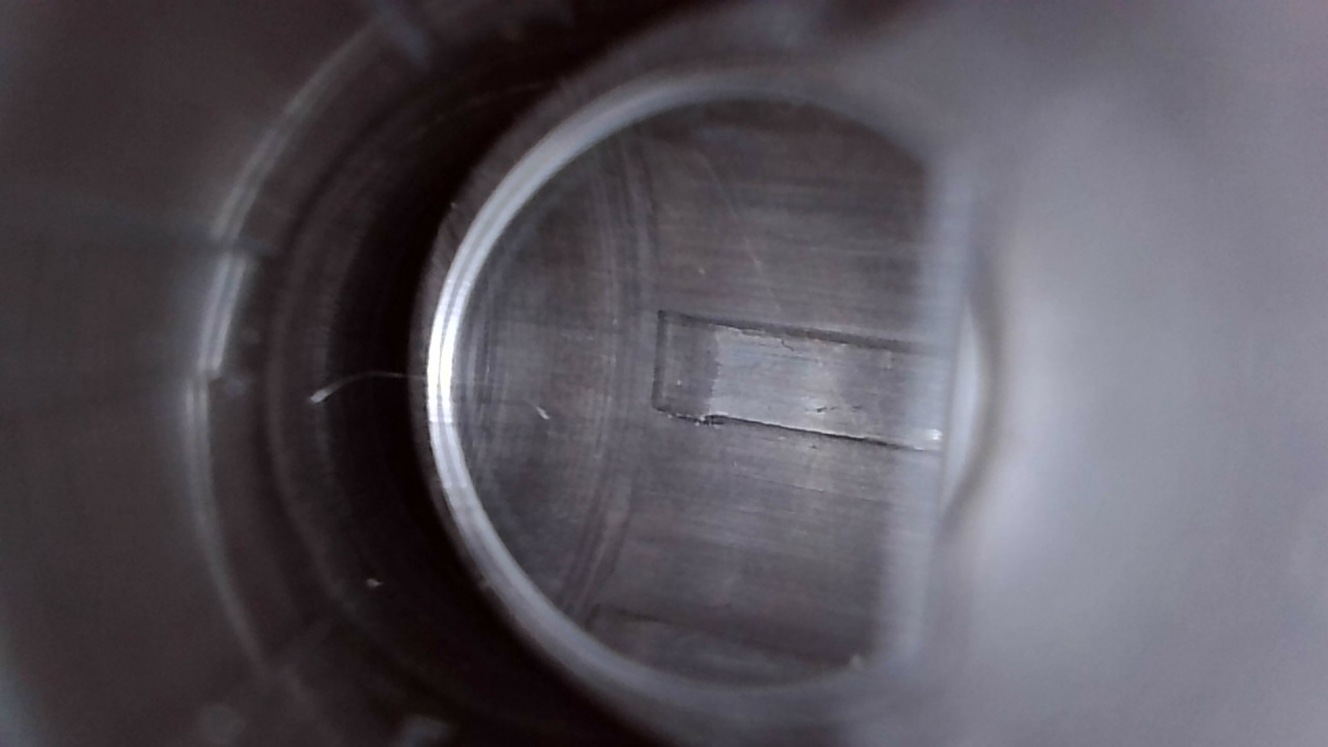

View attachment 8708536View attachment 8708537View attachment 8708538

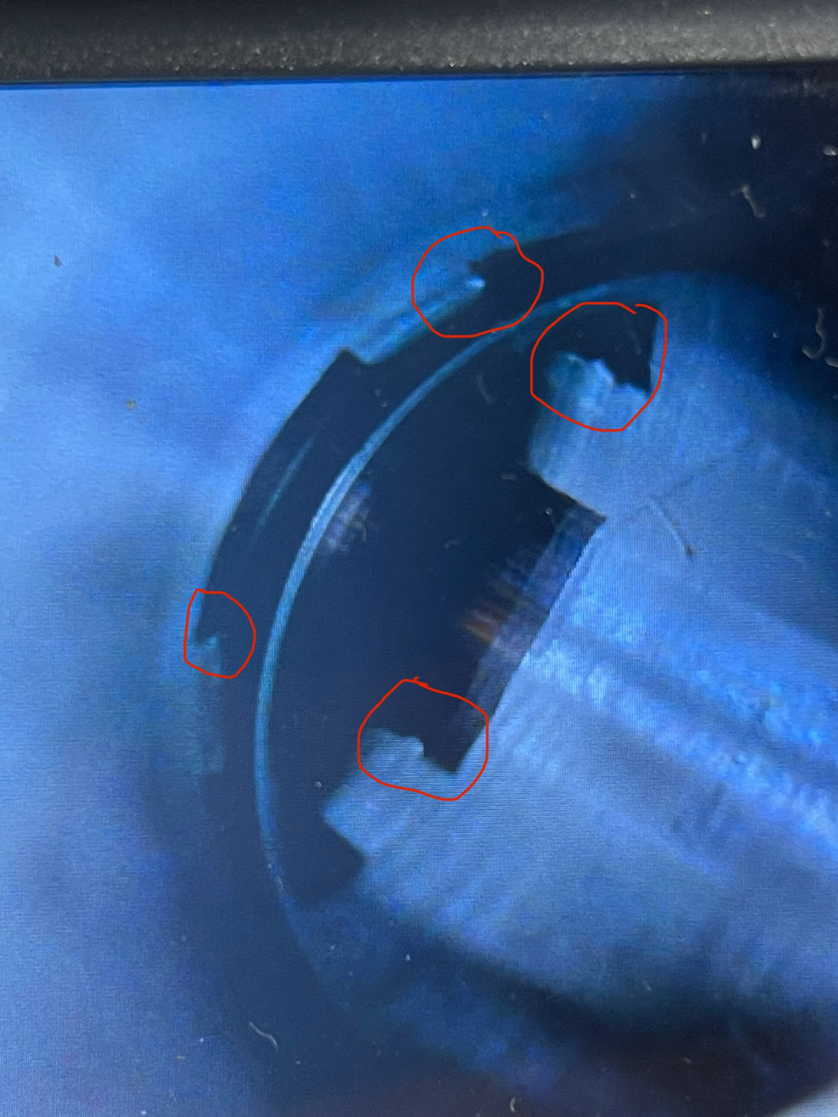

Thanks for the pictures.
I've looked at a number of chambers and have never seen one like this.
I'm going to keep the photos as examples of how bad a chamber can be.
If anyone has a picture of a .22LR chamber worse than that please share.
One thing to look for in a chamber is if all the leades are the same length, angle, and have the same shape. You should be able to rotate the barrel in the lathe see they are all identical. Any variation is not good.
As already mentioned, the reamer that made this cut may have been dull or broken. The other possibility is the barrel steel could be flawed in this area and the steel just broke this way. Whatever the cause one would hope they would have looked at it before they shipped it.

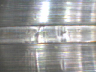

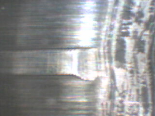

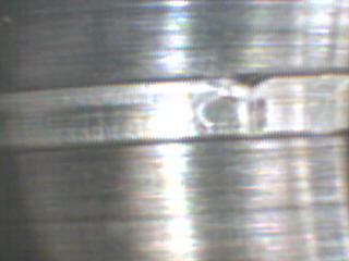

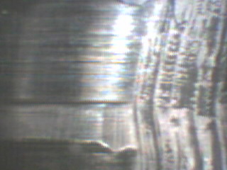

That's not bad, here's some pics from a Clark Custom S&W 41 barrel I got from them a few years ago. It also had damage further down the barrel to the rifling where they probably used some sort of clamp on the interior of the barrel to crown it.
It's an interesting story, I sent Clark the pictures, they were concerned had me send it back for testing. They tested it said it met their standards (I believe 1.75" at 50 yds). They returned it with a test target that frankly is almost too amazing to believe, multiple ragged hole 10 shot groups at 50yds that were all under 1/2". Not only that but they claimed their technicians have no idea what possibly could have caused the damage seen......when other barrel folks chimed in it was pretty clear that an extremely dull reamer would do this.
At the end of the day I mostly shoot offhand so it still shoots better than I ever will. That said even with an optic and off a solid handgun rest I've never even had it come remotely close to groups that lead me to believe it could hold 10 shot 1/2" groups at 50 yards with Eley Match. It groups more like what the pictures of the chamber/rifling make me think it would :)
Damage in the last 1" of the barrel

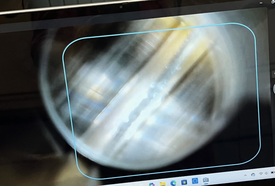

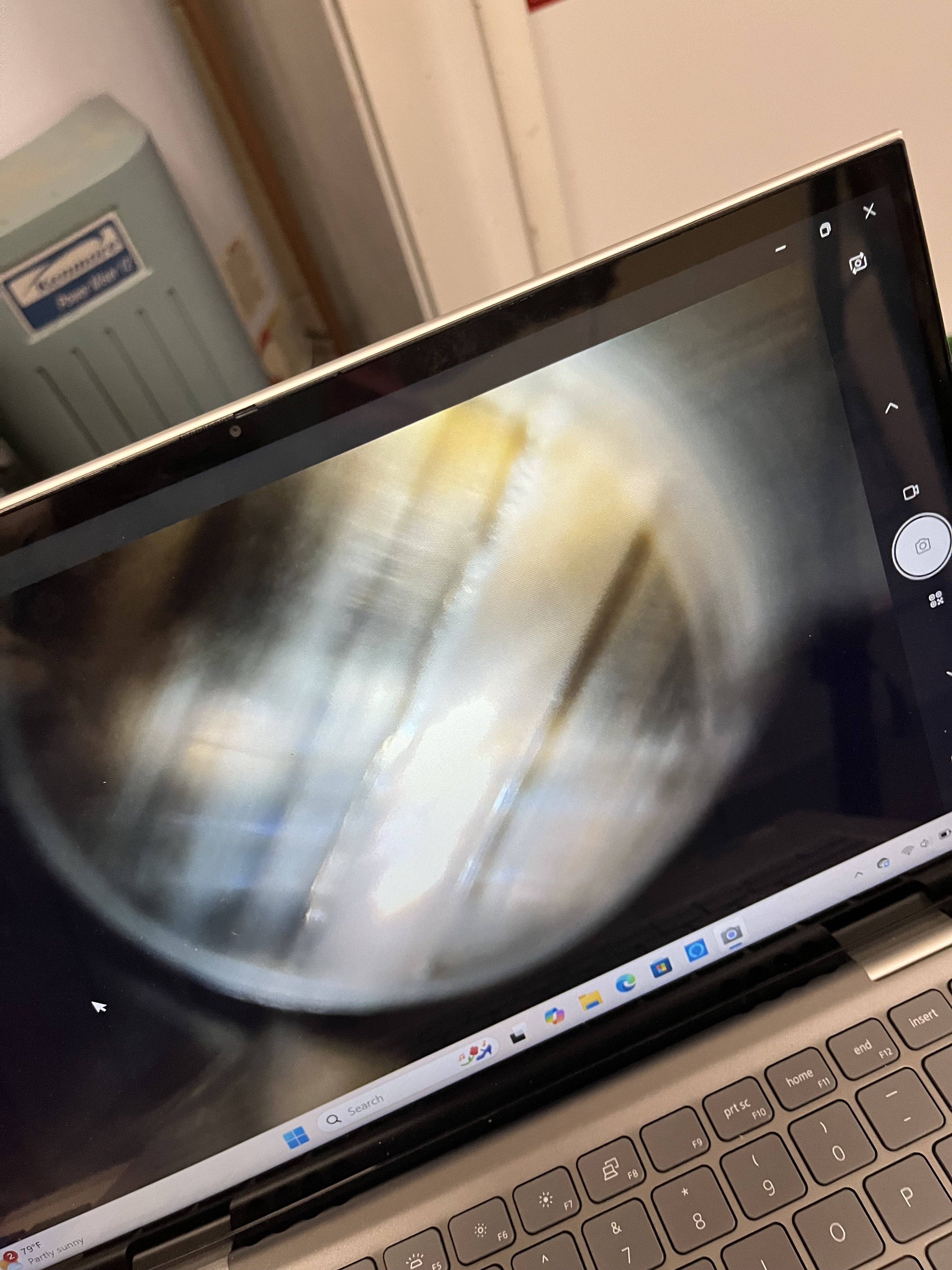

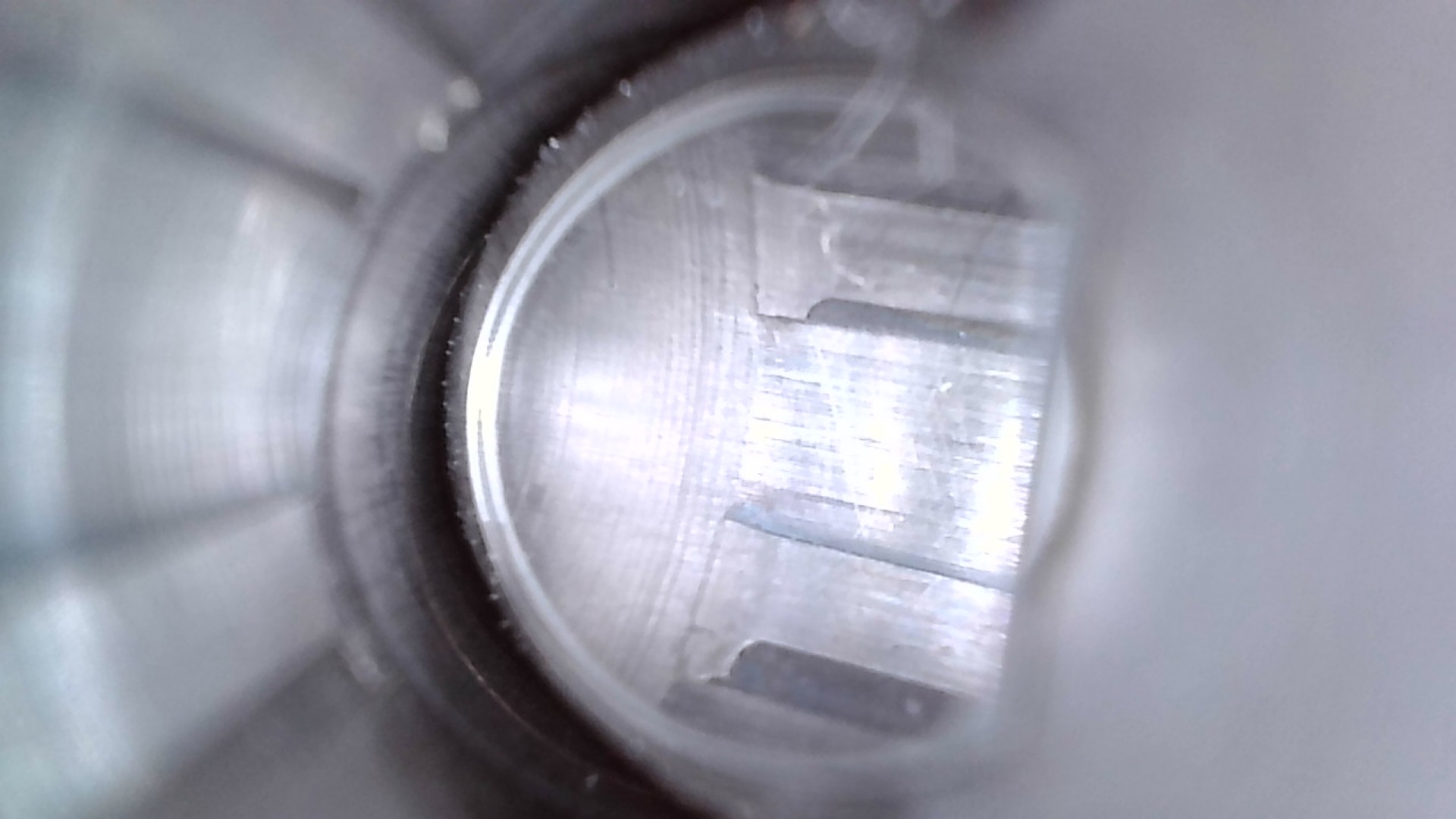

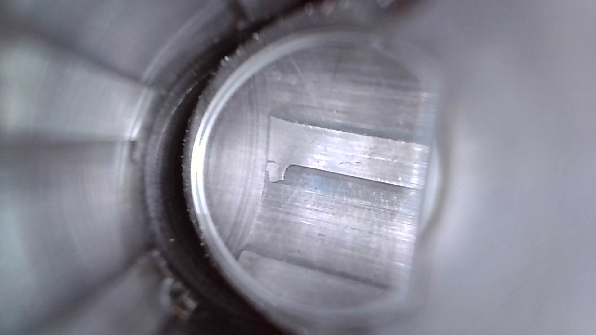

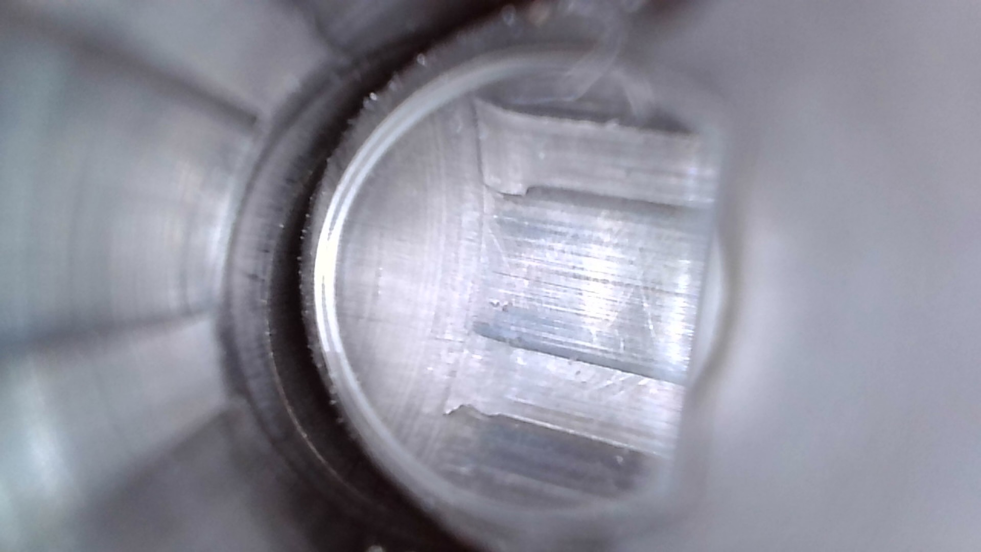

My B14R heavy is the same. Obviously a really dull reamer or something. I’ll be contacting Bergara about it. Definitely not a barrel I’ll be wasting testing ammo on. Especially when my goal is long range shooting. Mines also has lots of chatter marks for about an inch in front of that area
I’ll get some pics of mine tomorrow. It’s not just a minor smear either. There’s space between that smear mark and the barrel. Essentially it will cut pieces of the bullet off until it shoots out or pounds down from pressure
Disappointing for sure

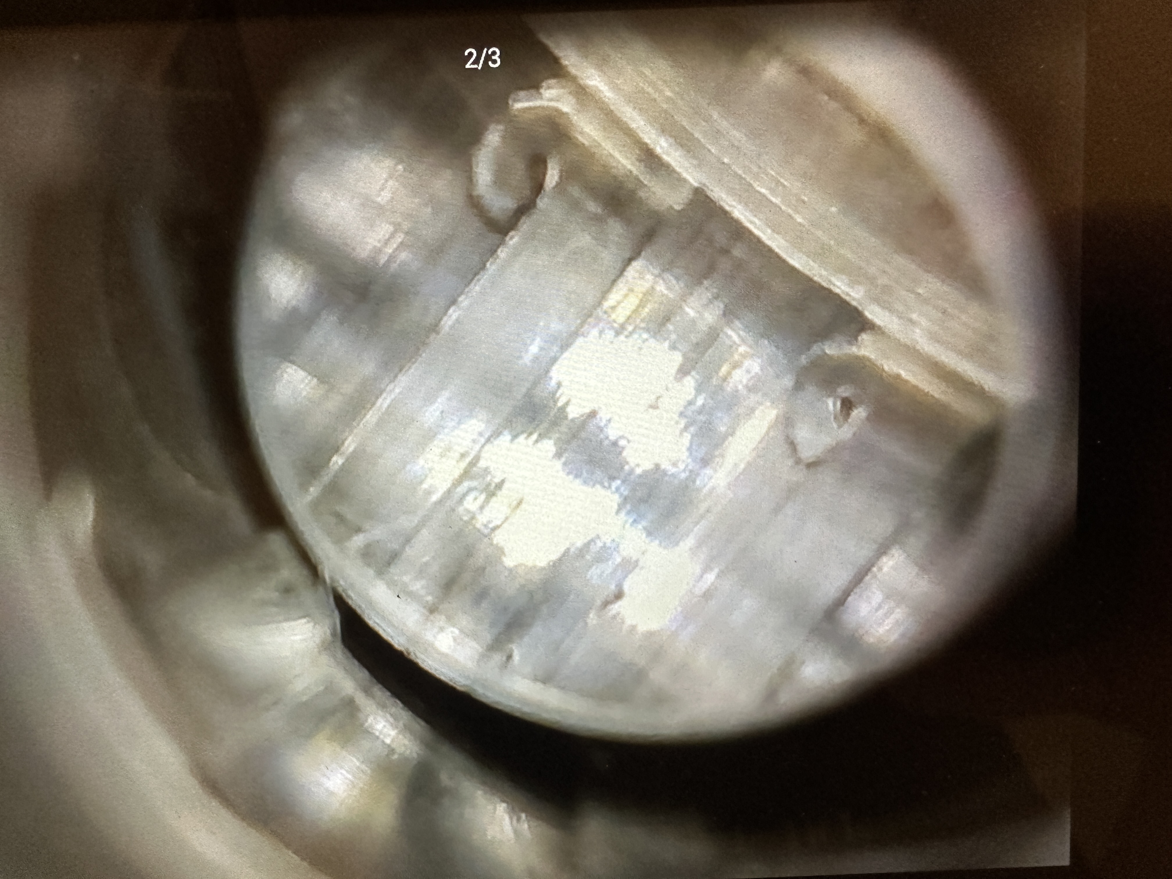

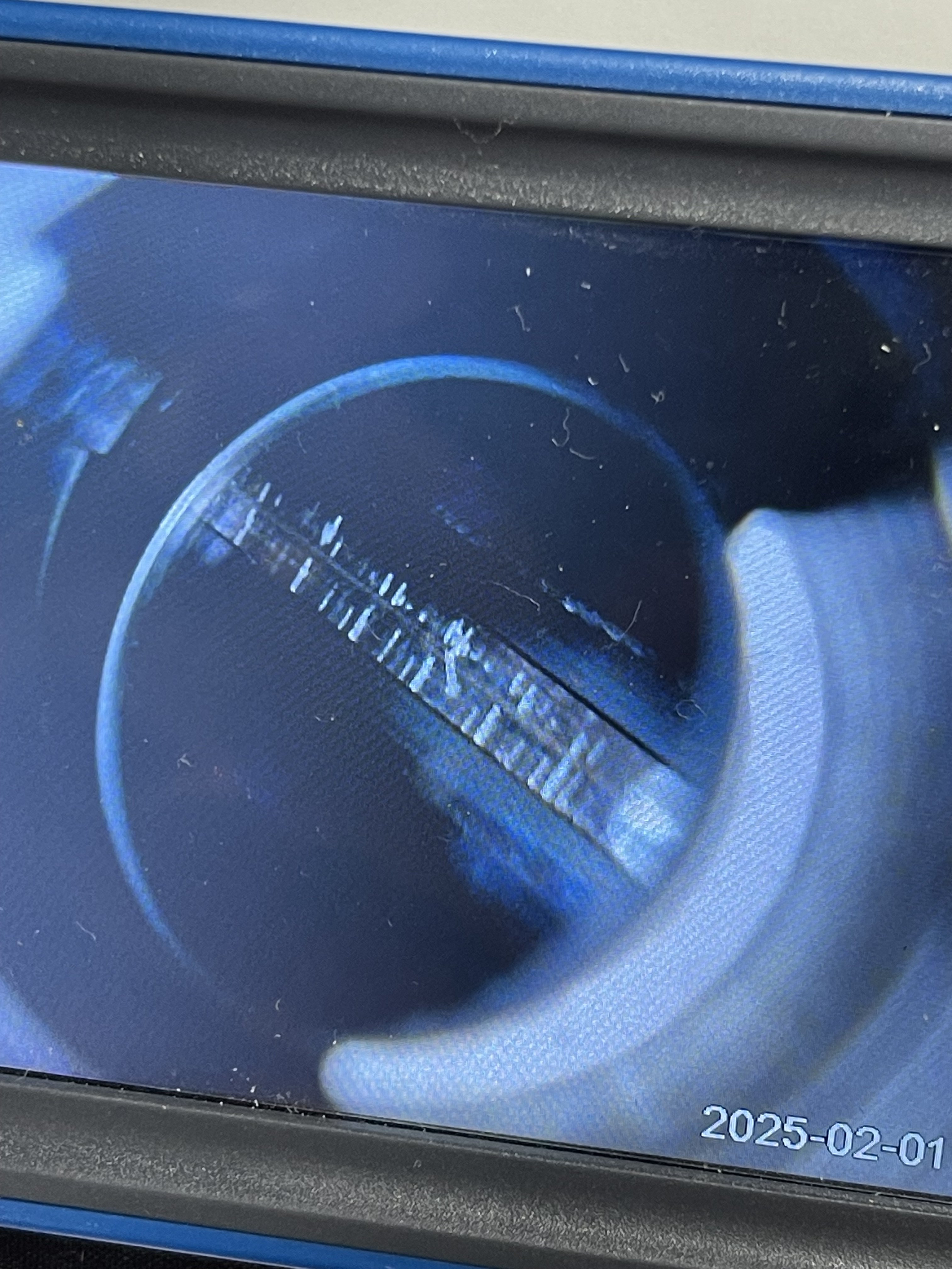

Here’s a couple pics from mine. Unfired/brand new
Chatter marks
In these pics the bore scope shows both the side view as well as the camera view in front of it. So you can see the swipe marks and what the look like from the bullets point of view.

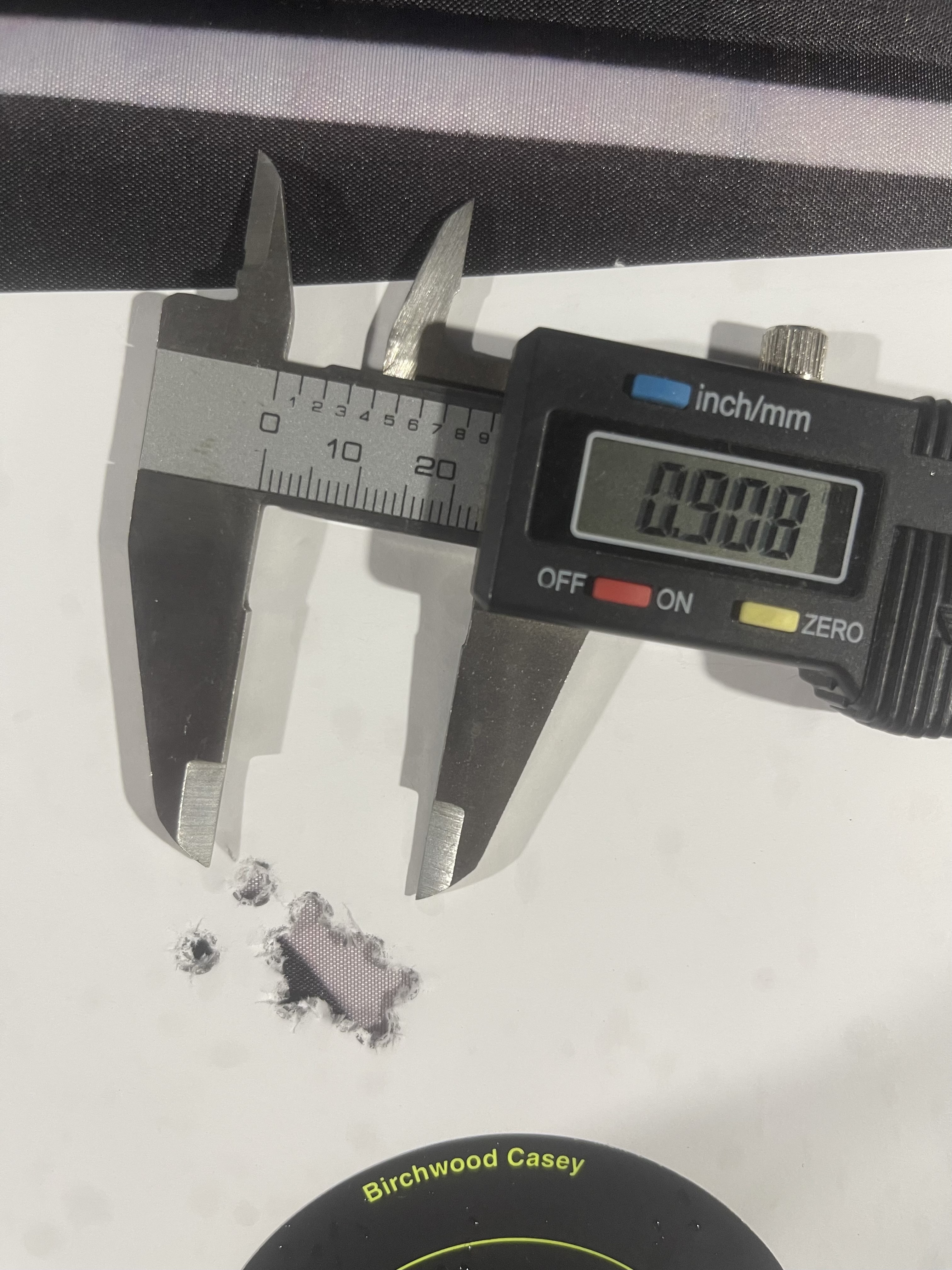

You’re also talking about guns designed for “match” quality. Nothing that takes a gouge out of the bullet instantly would indicate match quality.

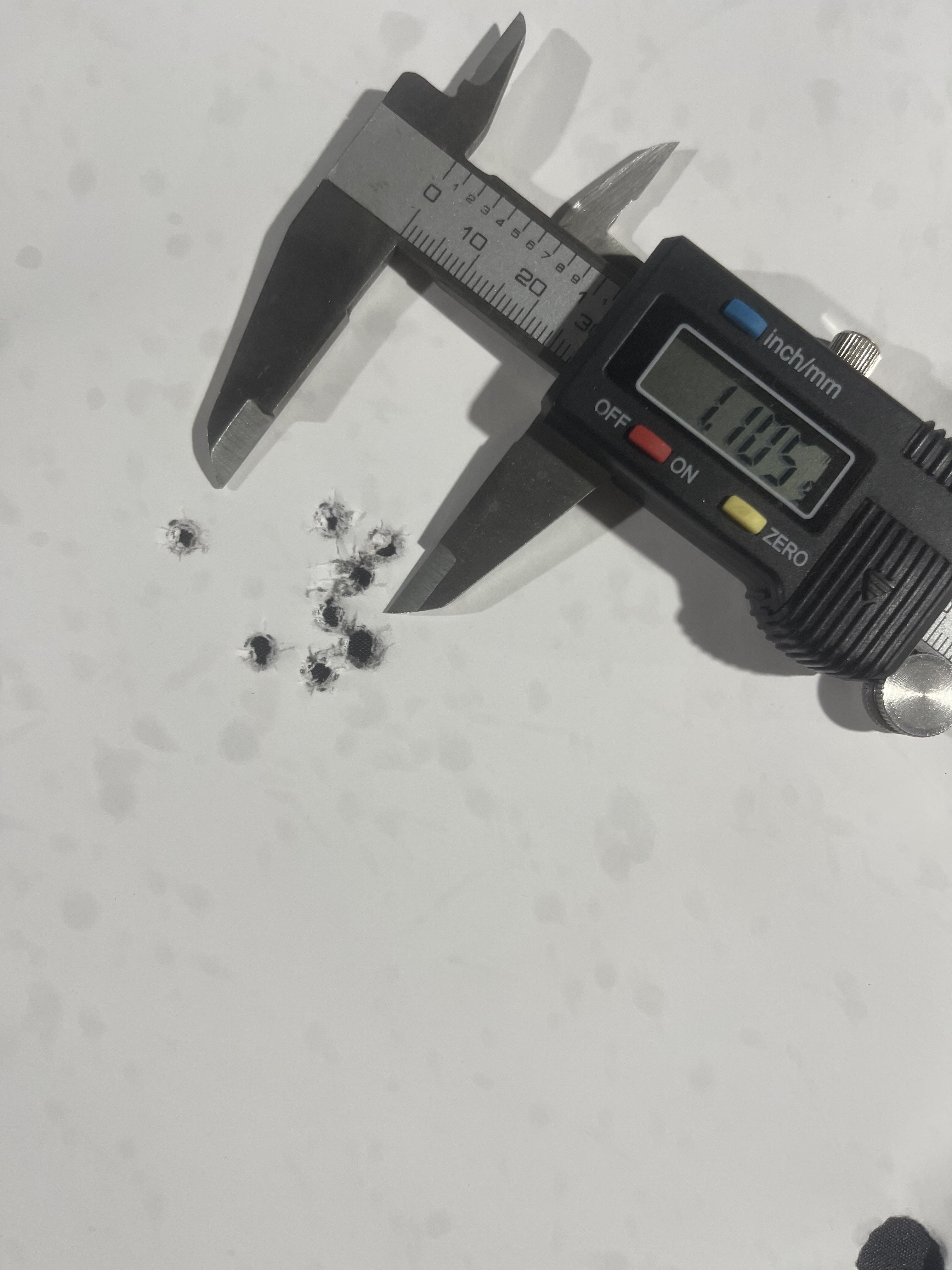

I got some bolt shims for mine and it gave me a flyer first shot every group with all ammo. I bought the shims for trying eley since lapua is hard to come by. Im around 800-1000 rounds down the tube now and was giving it a good carbon ring scrub hoping to fix the first shot flyers when i found the chamber job looking like this
