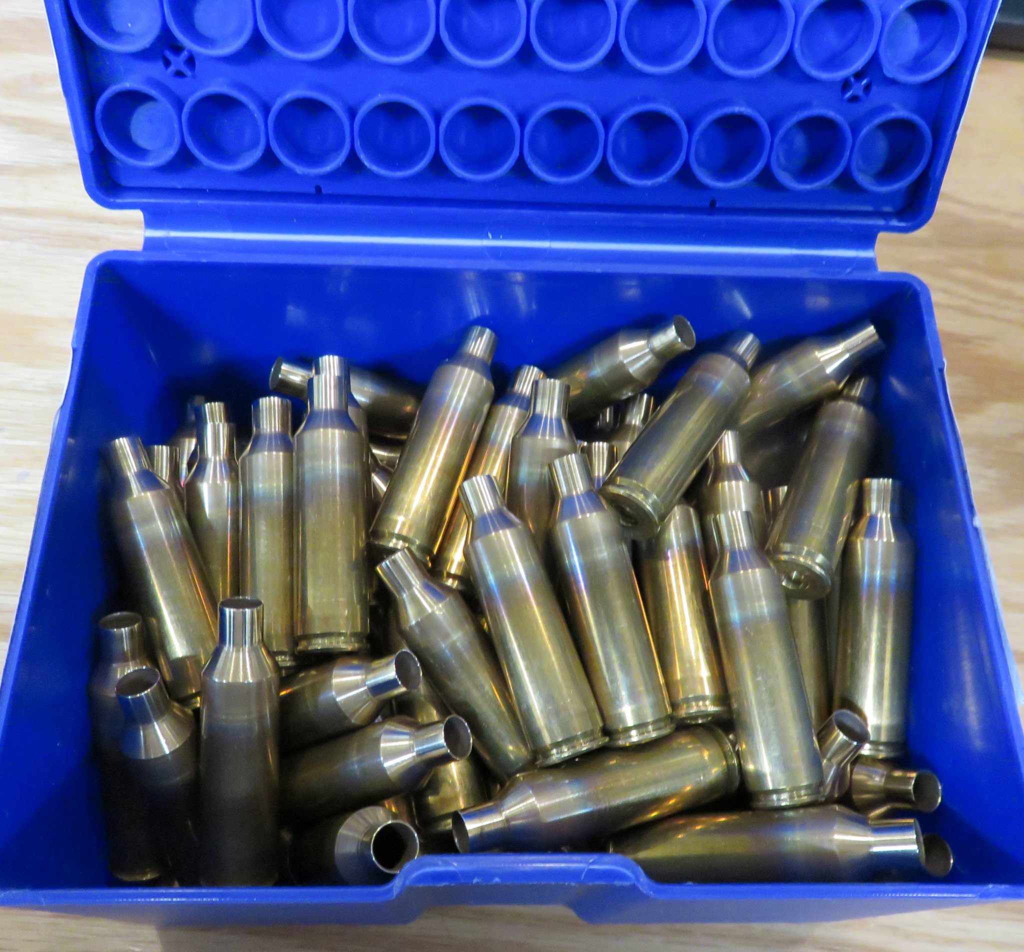

Agree, about not cleaning the inside of the necks. After annealing and cleaning the outside of the necks with steel wool, I like to tumble with white rice (medium grain) after I've sized them having used Imperial Sizing Die Wax. The rice absorbs the wax lube and apparently leaves a very thin coating on the inside of the neck, which makes for nice and consistent seating and no bullet weld; at least, no detectable weld in a 6 month period that I've experienced. The outside of the cases are cleaned nicely, though not what one can get with wet tumbling, but that's not my goal anyway. Here's what my cases look like after 5 firings using this method:
You clearly have a lot of reloading experience, and your comments are all valid. My goal is instead of giving up (and living with all these problems), i am more interested in how to resolve them. So very open to fresh ideas.

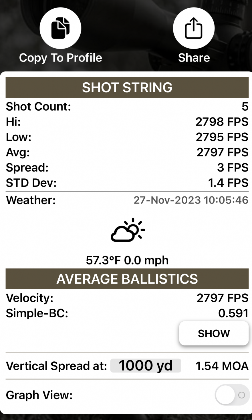

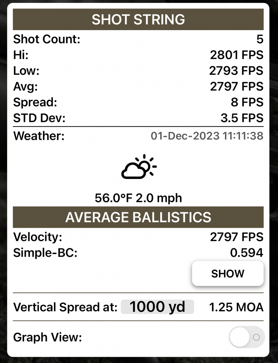

Here is the velocity report
Groups are in different day with very close temperatures
%53 RH
%42 RH

I noticed with %10 different in RH I am still getting consistent results with my load at 41.3grs and the average velocity changes only about 2fps.

41.3grs 2797fps SD:1.4

41.3grs 2797fps SD:3.5

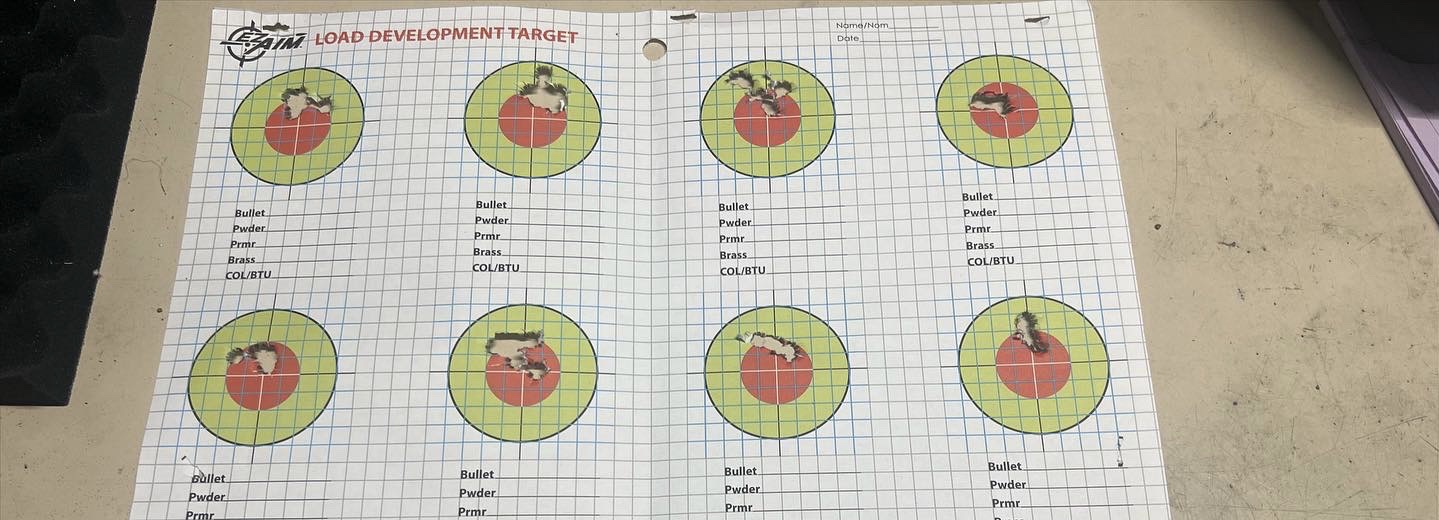

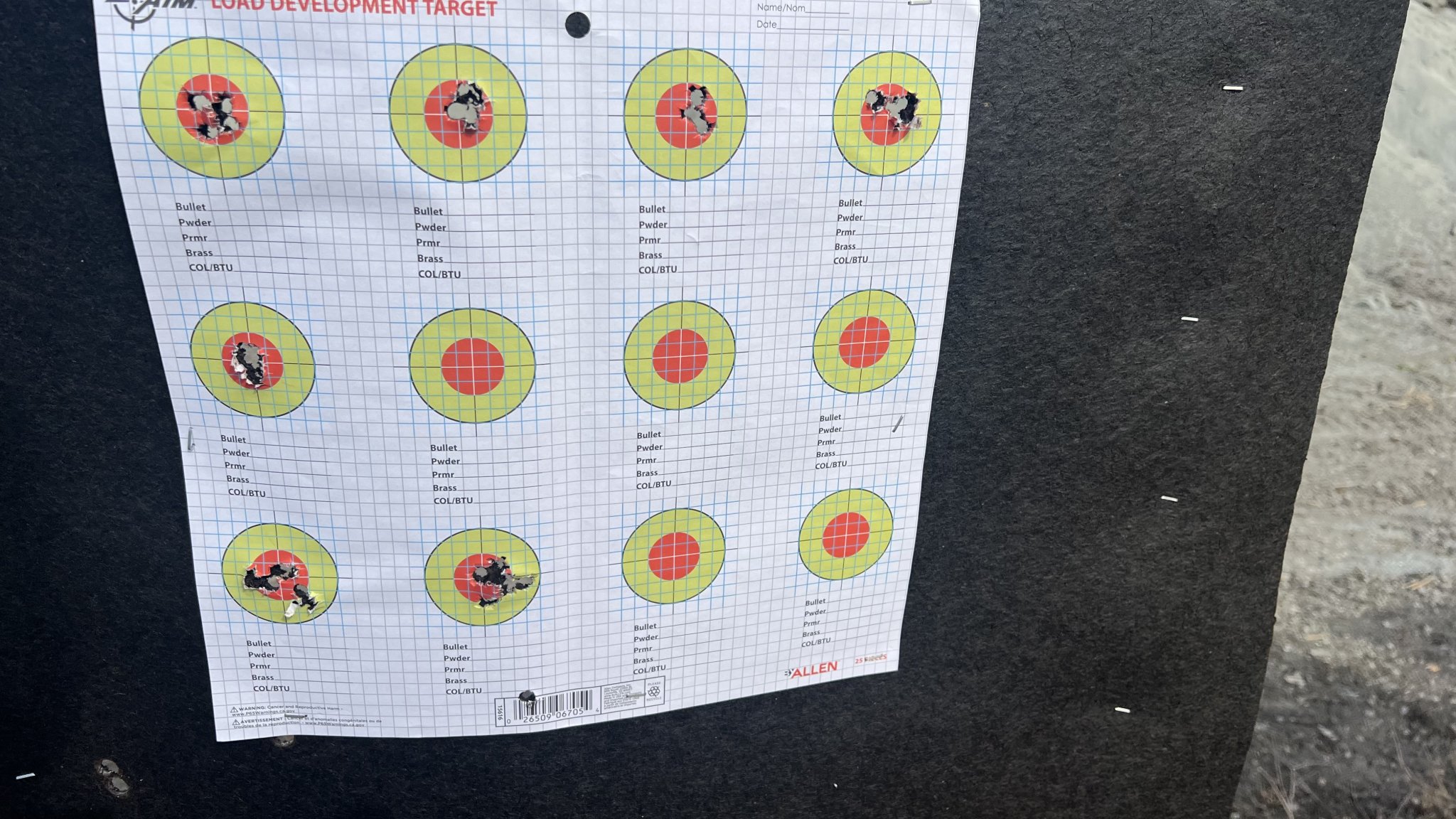

I literally had the same point of impact in both tests
Group size pretty close
%53 RH target
From left to right 41.2 to 41.6
%42 target
From left to right
41.2 to 41.5
41.6 to 41.9
