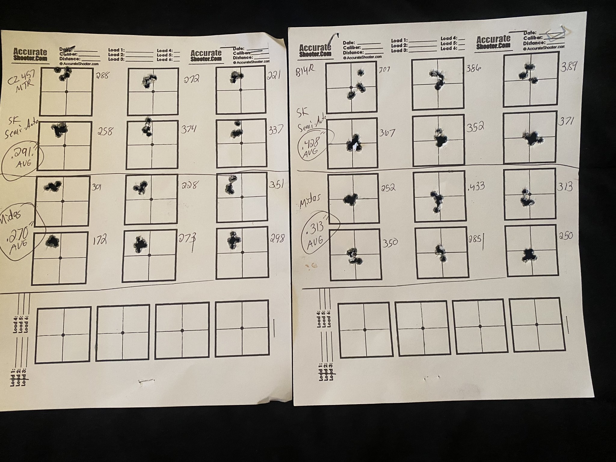

One good group out of 20! Why would you want to buy more of it? For 50 yd groups it doesn't look that good to me. It has vertical & horizonal spread and flyers. Thats why I don't waste my money and time on crap ammo. What is it good for? You can't tune with it. You can't practice shooting techniques with it and you surely don't want to use it in competition due to its lack of consistency. You never know if it's you the gun or the ammo! It does work for steel challenge where sub moa accuracy is not necessary .and for making beer cans jump around.
It shoots better in two of my CZ’s than it does in the B14R. The original post was just to illustrate how deceiving one group can be. I have won matches (in ARA Factory class) with high aggs this year using Center X that averaged in the low 3’s while shooting groups. I did this just playing around. Both targets were shot going as fast as I could go (less than Five minutes) without shooting any sighters. I was just holding according to what the flags were saying and not confirming with sighters. I probably could have shot a perfect card with the B14R too, but I learned quickly on the first row that I was holding too far off for wind.
The Midas on the last pic was an untested lot I recently bought for a good deal the same day I bought the B14. Notice how closely it shot with the SK Semi-Auto through the CZ. This isn’t even my best shooting CZ I was just using it for comparison with the new B14R since they are set up similarly.
Long story short, although I now have a couple good cases of CenterX there might come a time next season that I’ll be forced to shoot the SK Semi Auto in matches what with the way Ammo availability is getting.

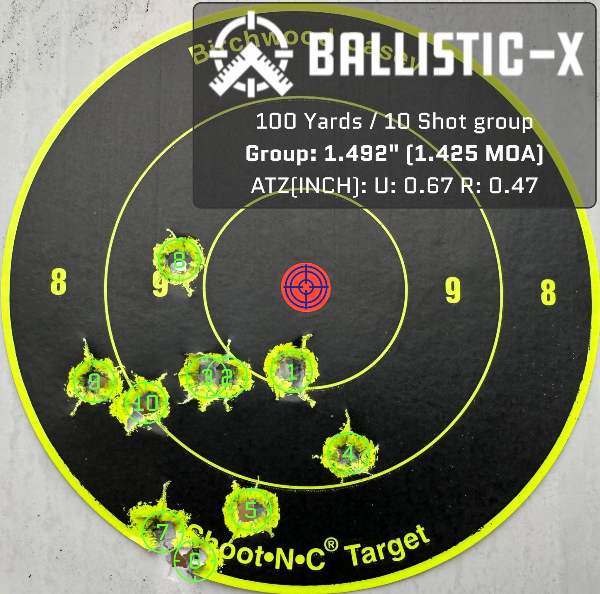

10-shot group from today with my Ranger 22, Mask HD, and CCI SV. Not my best, but it’s not bad, considering the fact I’m using bulk ammo.

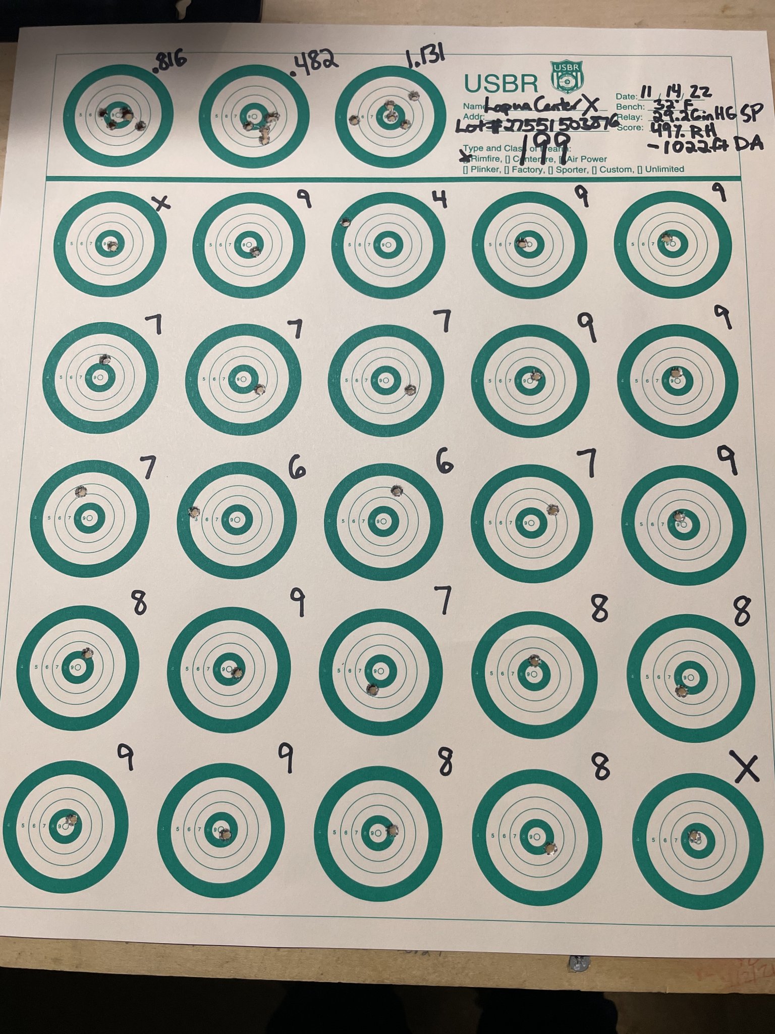

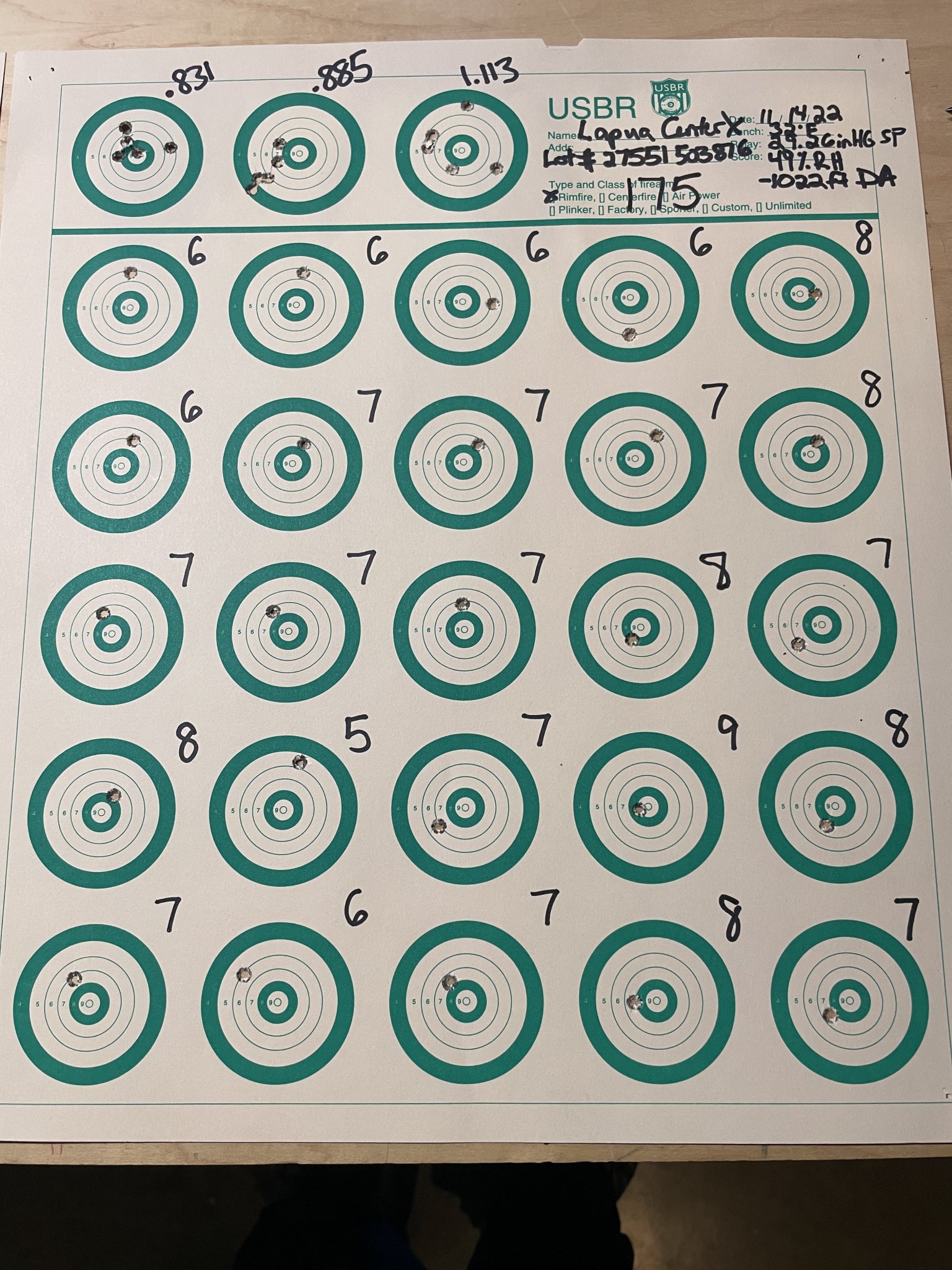

For comparison here are (2) USBR Targets with Lapua Center X Lot # 27551 503876
Shot @ 50 Yards - Bipod and Rear Bag on Bench
Chrono Data:

Actual Shooting Conditions Today:
32*F / 29.26 inHg SP / 49% RH / -1022 FT DA
Target #1 and Target #2
(3) 5 Shot Groups on Sighters then for Score
