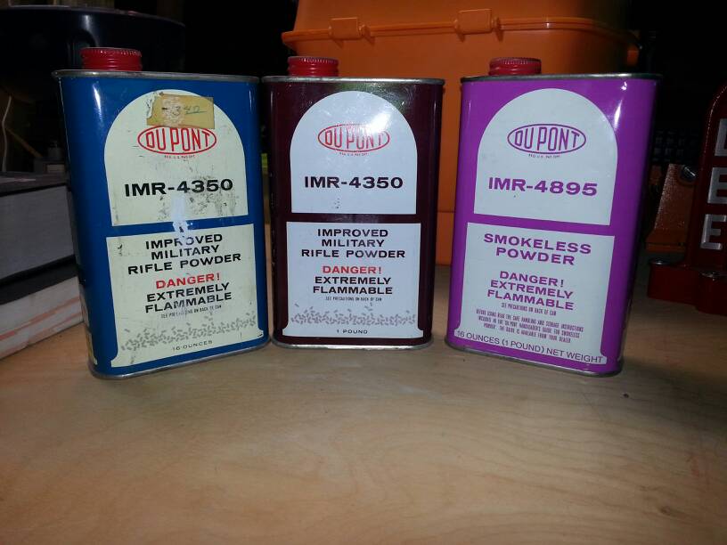

My buddy bought a house and in the uploadfromtaptalk1407342577900.jpg workshop we found some old IMR powder. I can't find a date on it but it's in a tin can. I took some pictures, hopefully someone can tell me if it's still bueno to use because there are about twenty ponds worth of powder and all of it for loads I use. Thanks
Double based powder has almost an unlimited shelf life dependent on how it is/was stored.
I have used a LOT of out of date powder (yours probably dates to the 70's/80's).
Just work your load up normally. I would not start with your pet load, just in case.
Was it kept in a controlled environment? Shelf life of most powders can be many years if not subjected to humidity and high heat. Smell it. If it has an acidic odor don't use it. Otherwise try it in reduced loads to test the consistency.
I've never shot any quite that old, but have used 20 year old powder with no issues. As to the ultimate shelf life, who knows. I guess we'll find out when the hoarders that bought 10 lifetimes worth of supply pass it on to their great grandchildren.
Shake it then remove the lid. If you a red dust coming out use to fertilize your lawn.
This^^^^^^^^^^^^^^^^^^^^ Open the cans and pour some out. If there's any red dust, toss it out. I've had a couple of the old cans (30+years old) go bad. I'm still using some Hodgdon Paper can powder from the late 60's that is in perfect shape. Just depends on how the powder was stored over the years. Powder can last many decades if stored well.
There's lots of factors affecting how long a powder will last, beginning with the particular powder in question. In some cases, apparently it's next to forever.

I bought a bunch of metal can IMR powder that had been stored in a semi trailer parked on somebody's back 40 for ~20 years; getting baked in the summer and frozen in the winter.
It's good to go.

I still have quiet a few of the metal DuPont IMR cans. A couple dating back to the late 1960s. But I bought some Hodgden paper box H110 powder that went bad a couple of years after I got it. It went on the yard.
As long as it's kept out of direct sun light and cool and dry, it will last pretty much for ever. I have inherited some old powders that still work fine. I'm loading a keg of 700x for 12ga trap shooting from the 70's right now and it's works just great.
