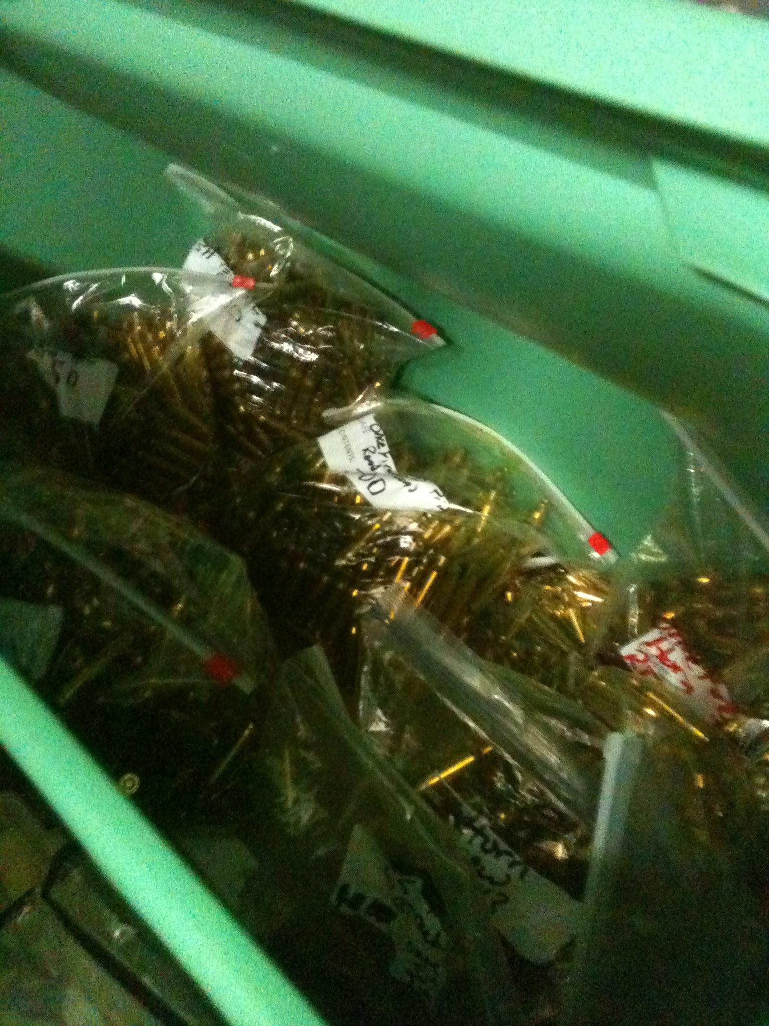

Exactly what I have done for years. I do all brass prep and prime and then bag them so when I need to load I just put them in blocks and throw powder and seat bullets. Makes life a lot easier. Below is my tote of primed and prepped brass in multiple calibers. Labeled with number in the bag, brass maker, number of firings and caliber.
