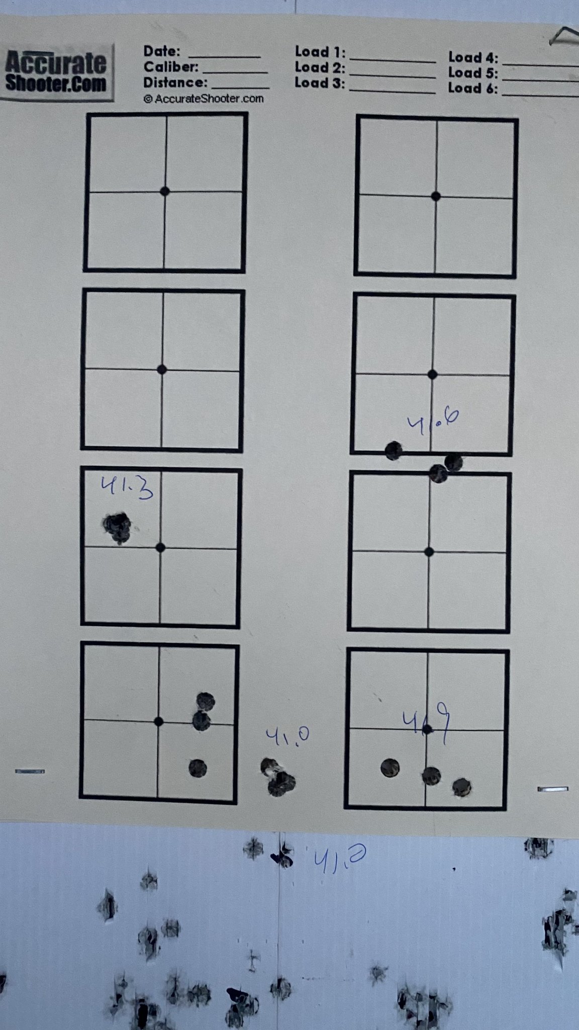

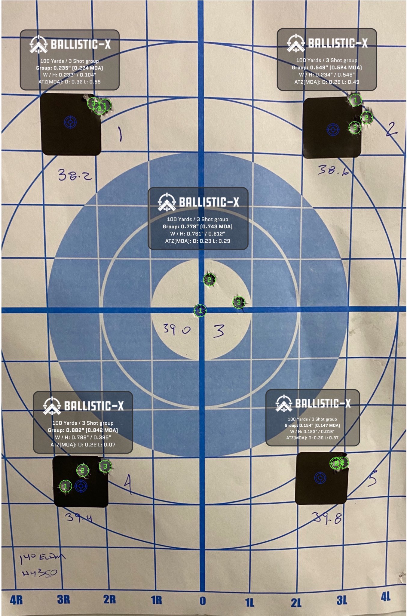

Just to give you a little perspective.
I've never used any of the RL powders since I've never found any around here.
The first target was my original load development with the factory barrel on my Savage 12FV.
This target was shot on New Years Eve day 2020 Outdoor temperature was -5F
The second target was shot less than 3 weeks ago doing load development on my new IBI barrel. Temperature was in the low 30’s
For the 41.0gr H4350 MV was 2727, ES was 6.15 and SD was 3.11.
For the 41.3gr only 2 rounds recorded.
MV was 2745, ES was 3.96, and SD was 2.80

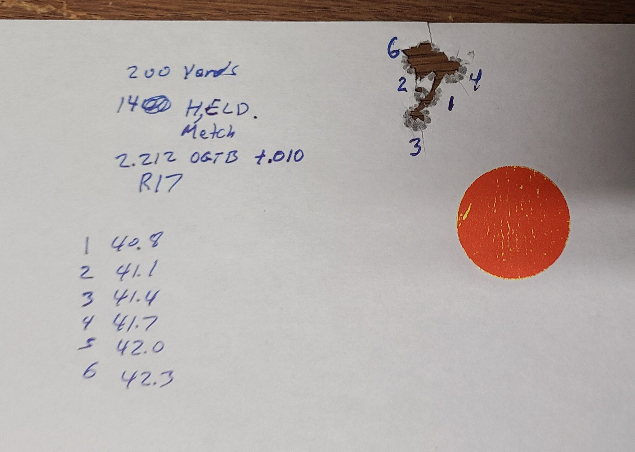

Little test I did years ago with a B14 HMR in 6.5 creed at 200 yards.
Dot is 1 inch, group is about 1/2 inch. It seems the charge variation did not affect the group as much
as you would think.
You need to confirm the neck bushing sizes, I use a .288 die for Lapua brass but for Hornady I use a .286
bushing. Are you using the expander on the die or a mandrel to expand the neck.
Your ES are high and most likely a case prep issue.
as you would think.
