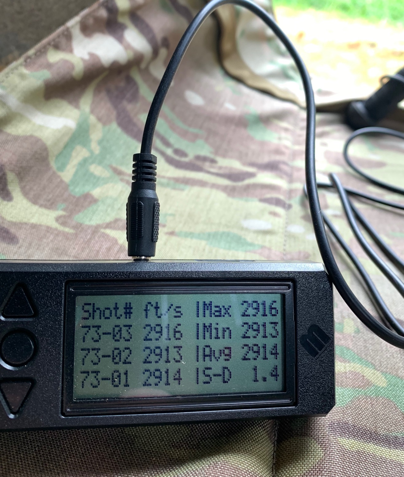

I shot 3 charges in PA at .050 jump 43.6, 43.9, & 44.2 and picked 44.2. Had the speed I was looking for with no pressure signs and shot a good 5 round group @100 with tight vertical.
I don't have pics of the first 2 charges just saved the one I picked 44.2

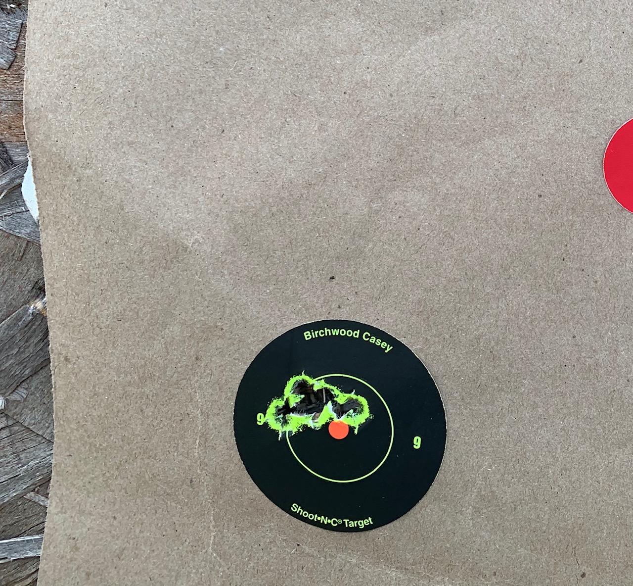

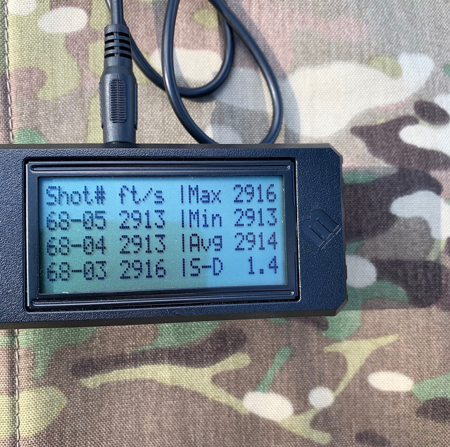

2 weeks later in MD same 44.2 charge, trying jumps CBTO 2.200 - 2.241
I got lucky on the first quick & dirty charge test. 2.200 & 2.205 CBTO shot the best @200y
I picked 2.205 as it seemed a little more in the middle of a forgiving zone. 2.886/2.210 shot a slightly better group &a 1 SD, but poi shifted and group opened @ 2.215
2.205/2.881 @200y with 44.2

Get to the match on Friday & head over to the 100y berm, attach magneto expecting 2914ish with low SD.
Nope WTF, now I've got 2965 - 2990 & SD's are shit. Group is also shit @ 1 -1/2" Well fuck me!
Looking for pressure signs as I put these in the case & a fucking light bulb goes off. Fucking dumb ass, that prepped brass had cci #41's in it.
There it was, a fucking inadvertent primer change screwed my load. I know the 41's are hot, but damn +50 - 70fps is surprising.
