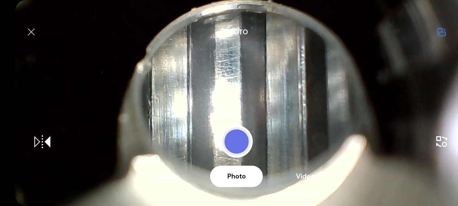

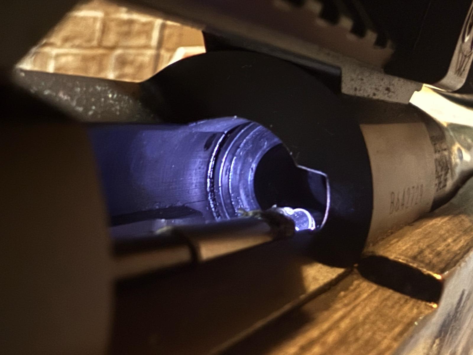

    I keep getting chunks of carbon making their way into the chamber and then they fall to the open area before the chamber. I first noticed this when I couldn't get the bolt closed on a live round. It's almost like the round was too big or long. After a minor inspection, I noticed the bolt face had black rocks.
    My rod guide goes right up to the neck. So when the patch comes out of the guide, it can't clean the chamber. I have slid the guide back to allow the patch to come out before and open up. I spin around a bit and then drive it forward all the way. But I still have a million little carbon rocks and brass shavings. These are causing issues with not allowing me to close the bolt properly. My fireformed cases are also coming put with deformities due to carbon chunks getting jammed between the case and chamber wall.
    Anyone else experience this? It's getting frustrating.

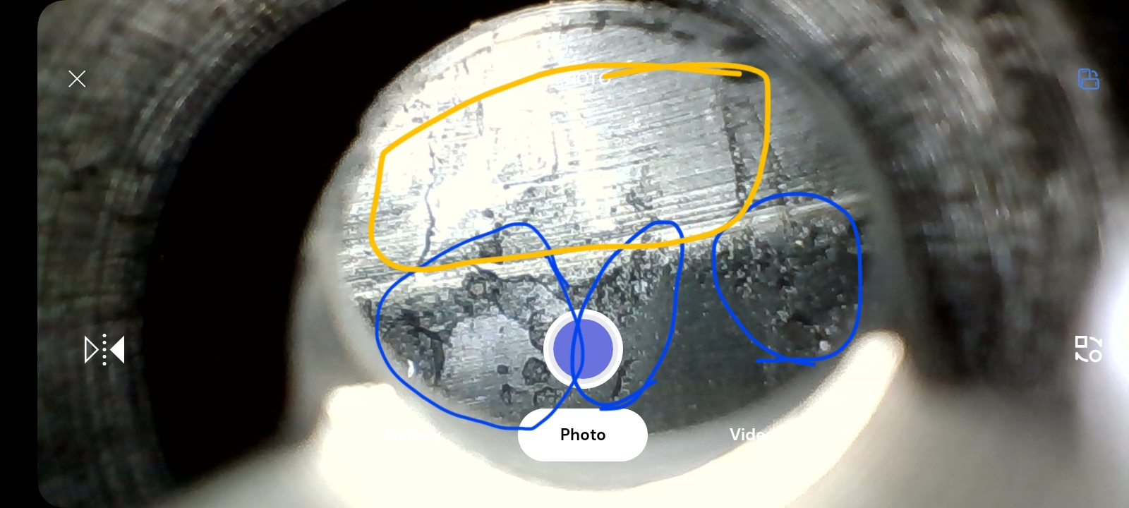

    Also, I found these other things while I was in there. If anyone cares to know and tell me what it is I'm looking at, I'd appreciate it.

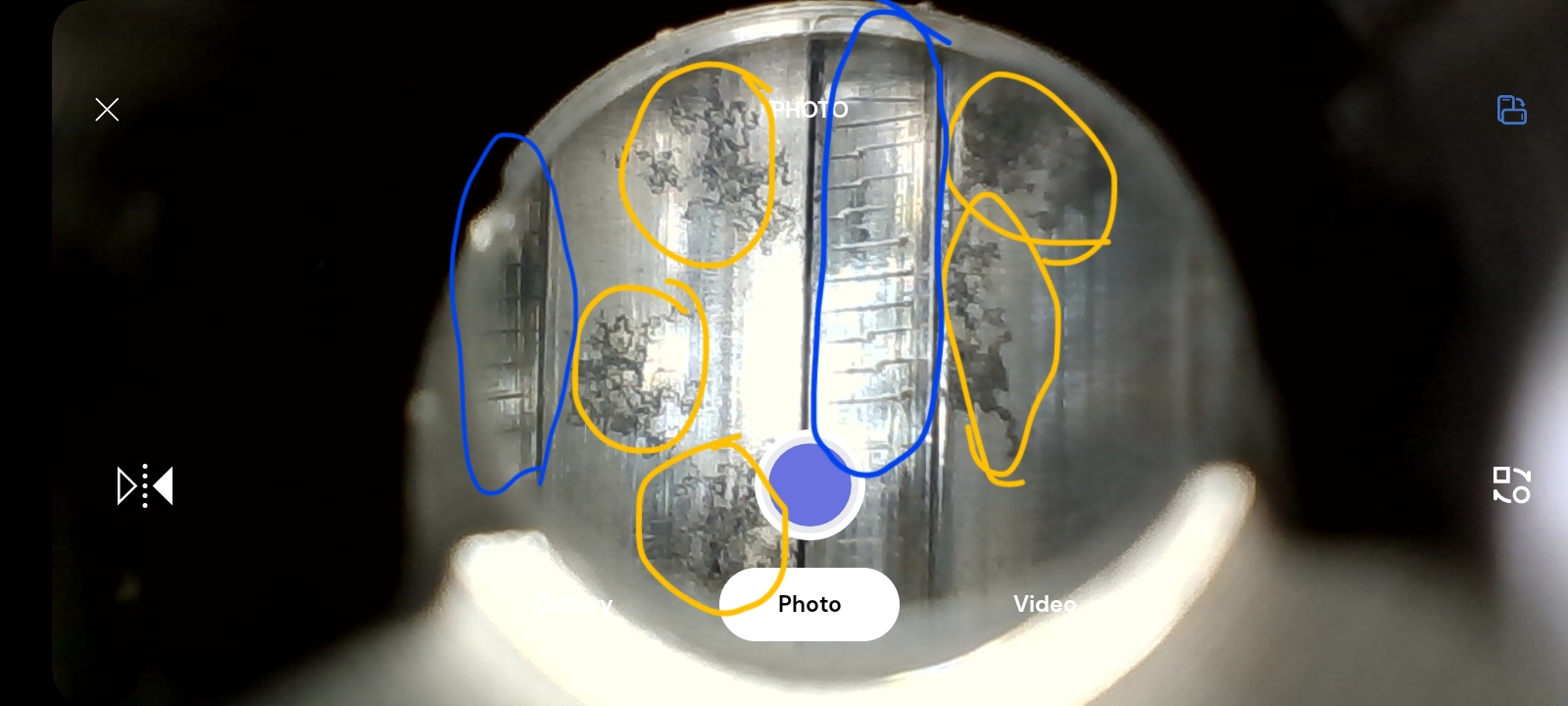

    The 2nd picture in this group of 3 pictures is black fouling but deep down in the barrel. Maybe about halfway in the barrel that starts and goes out to the muzzle. The section before it has shiny rifling so I find this odd.
    With how many carbon chunks I was getting in my chamber and bolt face, I thought I was going to have a major carbon ring but it didn't appear that way.
    Thanks for any input.

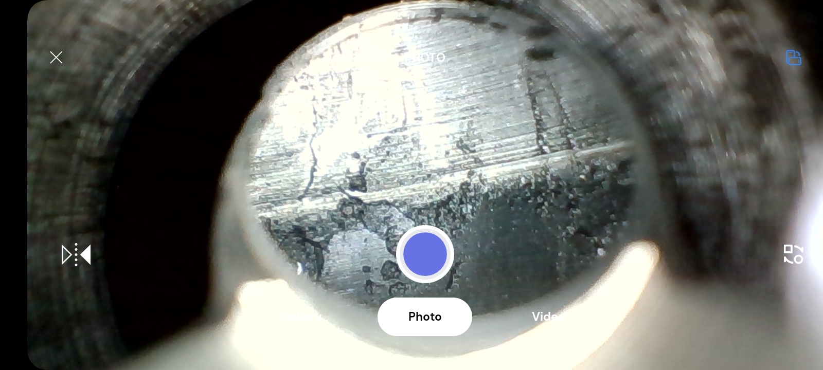

    Can you take a couple more photos of the area of your first photo, or maybe a short video leading the borescope into that area? Because that first black looks like the mother of all carbon rings at the top of your neck.
    When you say the area of the first photo, you mean the first photo in the group of the 3 right?
    If so, I should be able to get some more pics, maybe even vid. I'm not sure I can upload a video and it show the full quality, never done it before but I can try.

    Yeah this one. It looks like a huge amount of carbon buildup in the neck of your chamber.
    You can try to remove it chemically with the usual carbon removers, but It looks too built up for that.
    I don't usually recommend the use of CLR, but you may have to remove the barrel and get in there with a good CLR scrub. Just make sure not to leave it in there for longer than absolutely necessary and flush it all out with thinners/acetone afterward.

    I see a lot of corrosion (yellow). How often do you clean and oil the barrel? The blue areas look like machine marks, but it is strange that they are still so prominent. Did you perhaps put a brush on a drill and use it with Losso or JB or Butch to clean the chamber/throat area?
    Below the areas circled in blue looks like corrosion pitting. Or the carbon buildup is so thick that the pitting may be chunks breaking out. I think if that was the case you would have major pressure signs. Yellow area looks like machine marks. Shoulder area looks very shiny compared to the neck area. Did someone perhaps touch-up the chamber with a reamer?
    Below, the horizontal scratches in the groove is concerning. It could be leftover machine marks, but it looks as if a brush was spun in the bore. The black looks like carbon in the corner of the grooves. If this photo is after cleaning, it suggests that your cleaning regime need some adjustment.
    Abrasives are another option.
    Not sure I was able to get that exaxt spot again but I tried. If anyone has tips on how to post video, I'm all ears. I tried doing it like I do pictures but apparently file is too large.
    A few more pieces of info I left out.
    This is a factory barrel, has not had any reamer or anything through it other than what was done from factory.
    I have not used jb paste.
    I have not used a drill in it.
    It probably has less than 400 rounds.
    It is a 6.5 grendel and I've shot S&B factory ammo as well as hornady.
    I believe the S&B is probably the one with the dirtier burning powder.
    I mostly shoot it suppressed.
    I have not gotten excessive pressure signs that led me to believe the cause was a carbon ring as I did previously with a different barrel.
    Most pressure signs I ever get here are with factory ammo showing primers flattened a bit, which I believe could just be the way this cheap ammo is loaded.

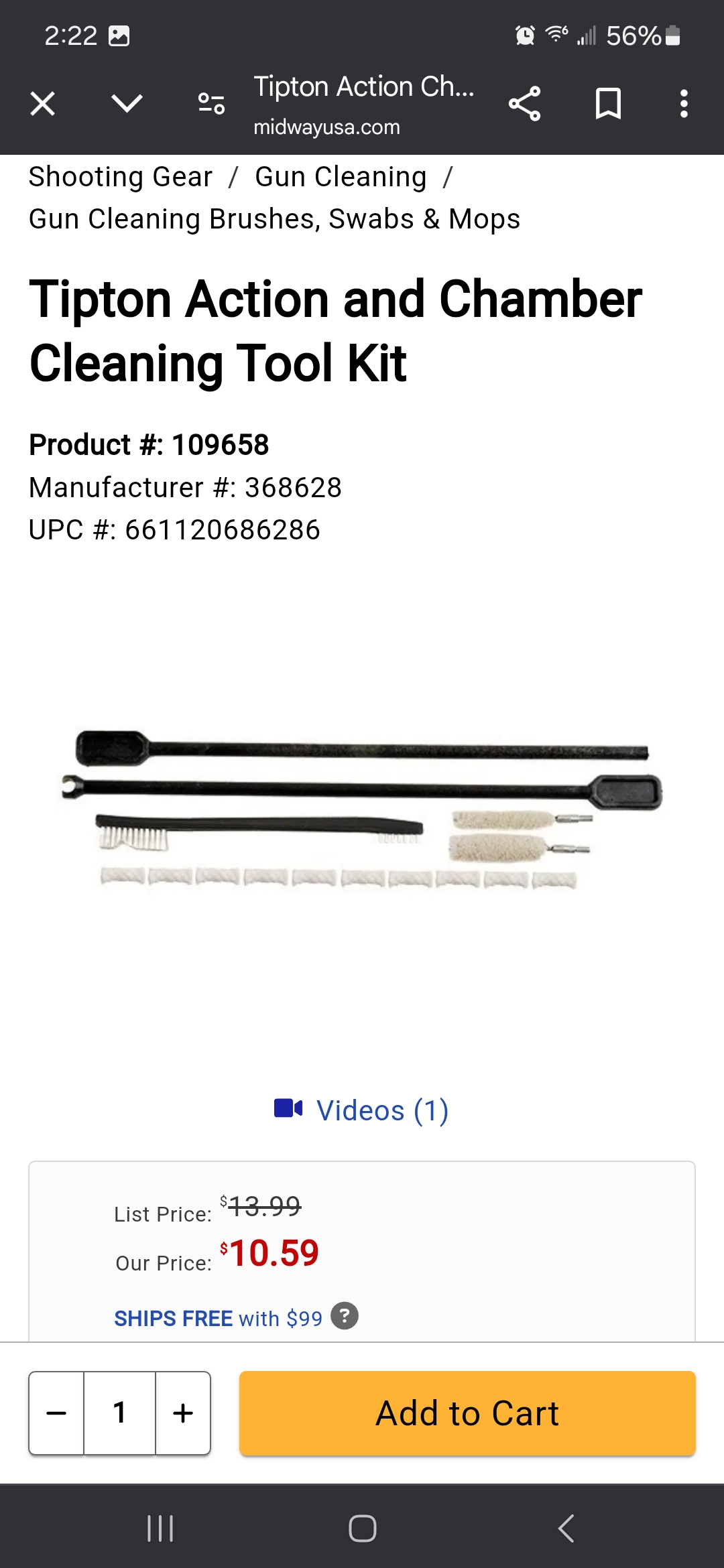

    The swabs at the bottom of the picture go into the "C" clamp on the back rod.
    Cleans the raceways, then goes in like your bolt lugs and you spin it.
    There a lots of "action / chamber" cleaning products.
    For a bolt gun this is the system I use.
    That’s the answer right there. Been using that one and similar for decades and works great at getting the lug area of the action.

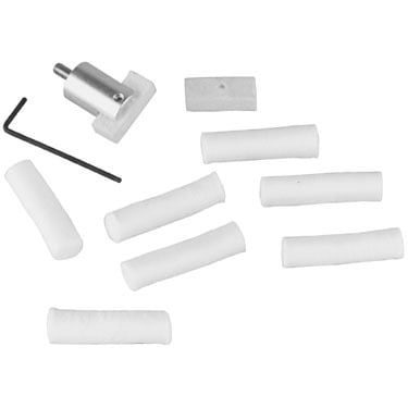

    The Dewey kit for the AR chamber just has an aluminum piece with a hole in it for the little swab to go into. I wonder why they made the other style when they already have something else that is easier to use? I always just used Q-tips and bent them as needed to get into the lug area until a friend gifted me the Dewey kit to use. I still do the q-tip thing unless they are really dirty. I have used it for AR and bolt actions with the same result.

    You guys rock! I'm gonna order one of those kits. You always hear about cleaning your barrel but never about your chamber specifically or the area where the bolt rests between the raceway and chamber.

    I'm not sure the pror link worked. So here's this new one for those wondering what it would look like in there if I took a vid.
    Thanks, that clears it up a bit. It looks like the area in that first photo is at the case body/shoulder junction, not up in the neck like I first thought.

    Have you/can you pull the barrel? I think a thourough carbon cleaning (including the chamber as it too looks very black in your photos) might be the best way to reset everything. Then stop shooting S&B and monitor carbon buildup closely with some better ammo.
    As you are shooting supressed your can is likely chock full of shit as well, that will definitely need cleaning out.
