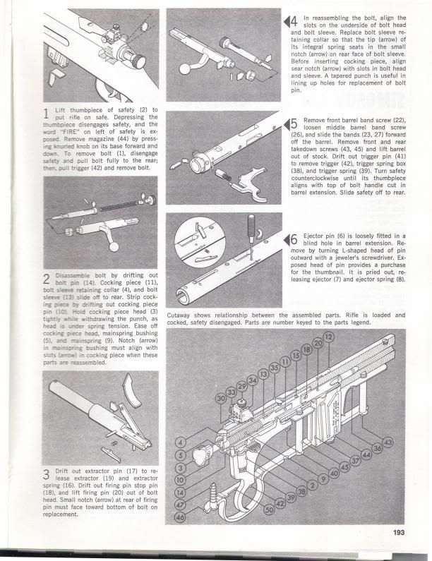

Cleaning up this good old gun, and the bolt is still stiff after hosing it in Ed's Red. Ejector and double firing pin came out easy enough. Figured one of you guys must have done this before, and had some words of wisdom before I start hammering out pins that I shouldn't..

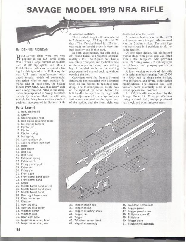

Re: how to disassemble Savage Model 19 NRA bolt
Aha!
and:
