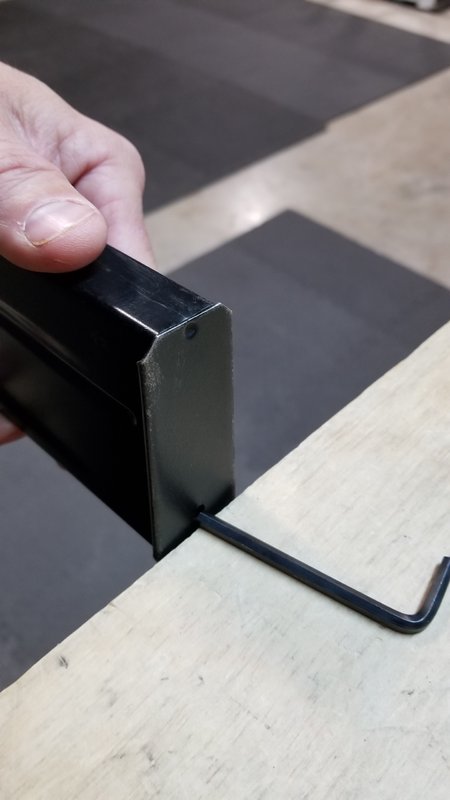

I put a hex wrench in the hole on the bottom, press it against the edge of a table and press down. It needs to get over the indentation, so it might take a little muscle.
