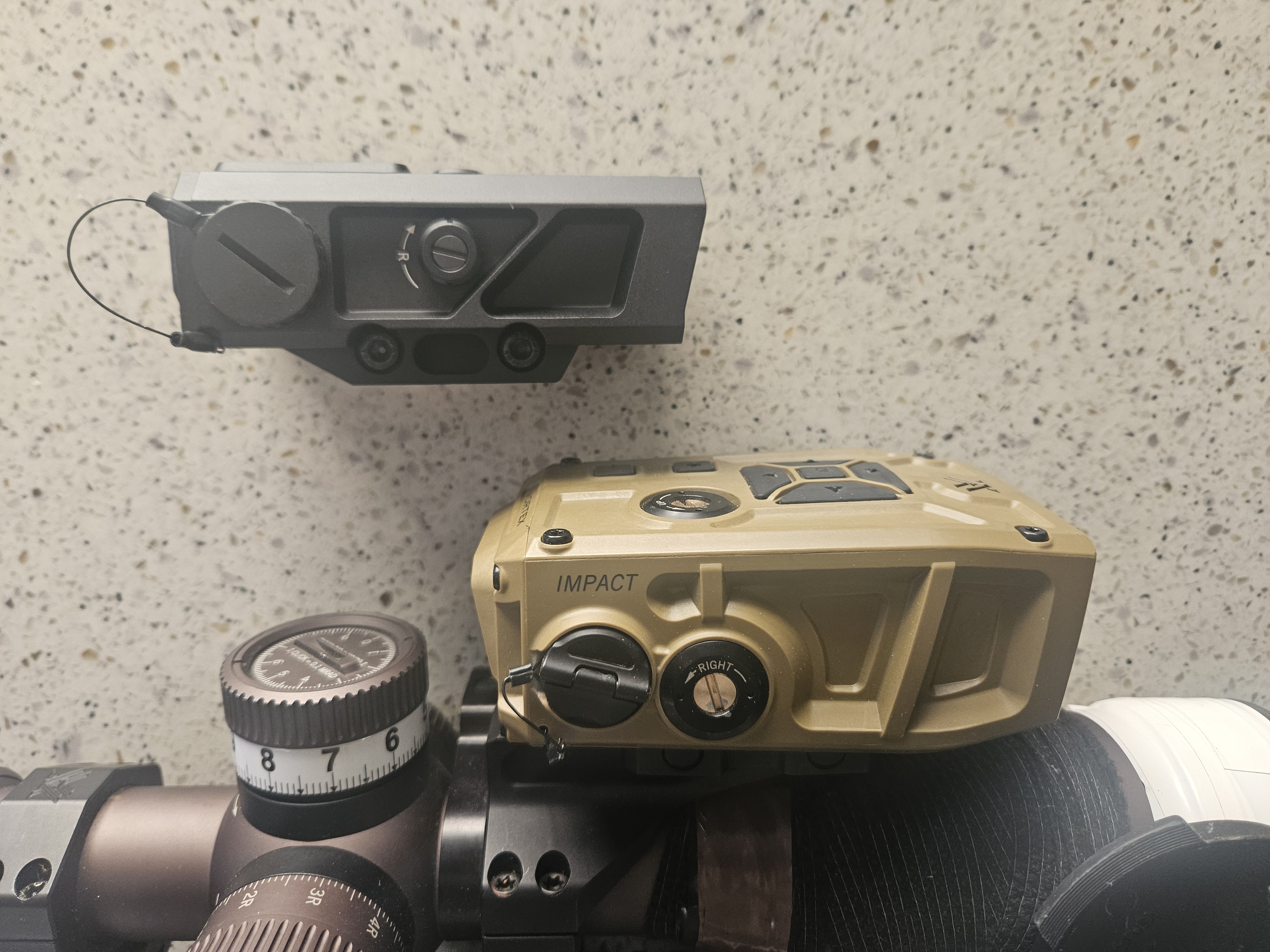

So I haven't had the chance to really use it but just setting it up a few things stood out to me.
The screen quality is waaaaay better than the Impact. That said it is a bit cluttered and I wish there was the option to turn off flight time and velocity and get a larger firing solution displayed but it's still much easier to read than the Gameboy one.
I like that it does not need active Bluetooth syncing to use the weather data and other information given by the app. You set it and it stays that way, no compass or other sensors changing things.
That said I really wish it had the option to turn off crosswind jump. I always leave my wind set at 10mph/3:00 and use fractions of that for my hold. If crosswind/aerodynamic jump is added to the elevation the firing may be off considerably more than if no vertical correction is factored in at all depending on wind direction. I'm not going to be constantly updating my wind direction with the app every time my rifle or the wind shifts, I got this for quick firing solutions, so it would be nice to toggle it off if desired.
The 3/10/15 minute shutoff times are great for hunting or NRL stages. The small remote is nice, gives more placement options. I like that it is corded compared to the Impact Bluetooth unit which needs a battery and has to be turned on and reconnected every minute or so or before it will work.
Not being an engineer I don't know why the connector plug is so complicated when all it has to do is send one type of signal. The manual warns the remote plug is fragile and a 90° connector would also be a big improvement to give more clearance for elevation and parallax knobs and to protect the cable and plug. I understand they're working on that.
The buttons are a huge improvement over the Impact where the most important button was the smallest and hardest to press. The power button on this is even slightly elevated so it's easy to find by feel. That said I wish it powered on with a quick press instead of press and hold.
The manual says to avoid lasing very reflective targets or close targets to avoid damage. I am not sure if this is because this unit is especially susceptible to damage or if all LRFs are and they just had the presence of mind to warn the customer. I often lase stuff across the room when adjusting displays and what not. I hope I don't wreck it.

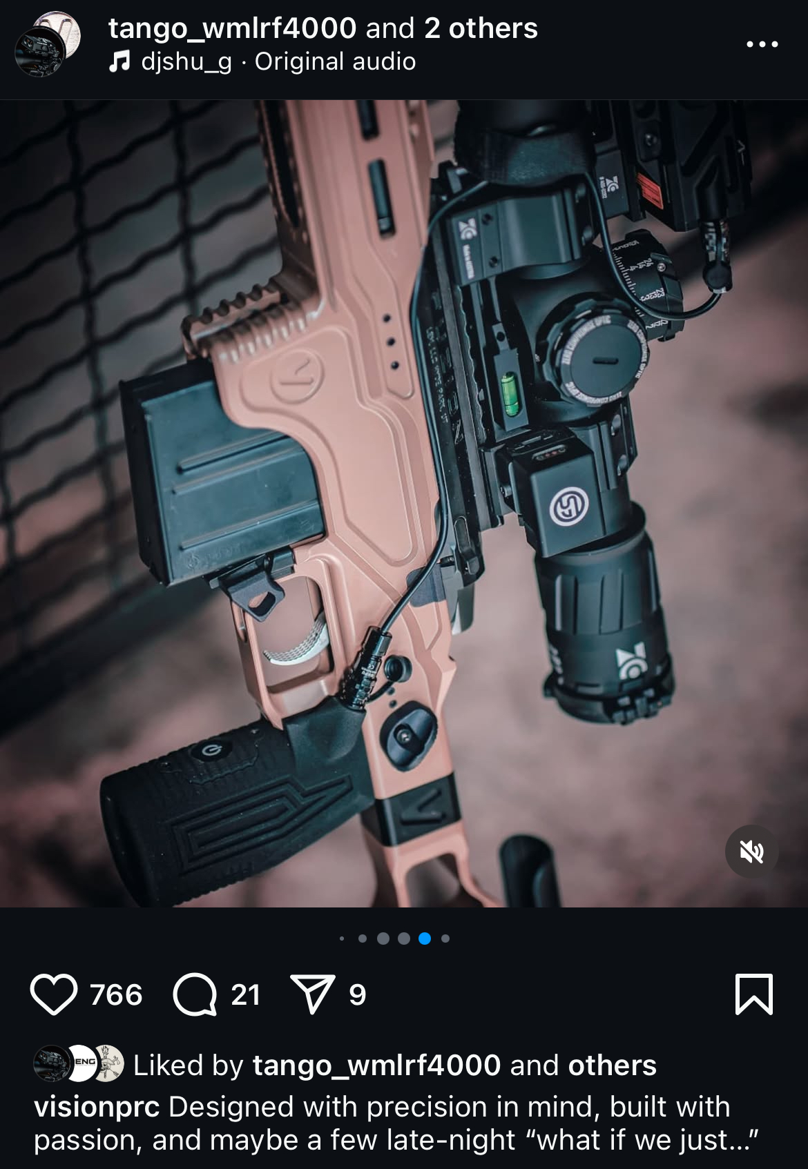

Ranging laser is visible under nods, and the unit returns a range being this close to the PVS26 (badger low diving board).
I don’t think it’s his…I saw this on Instagram too.

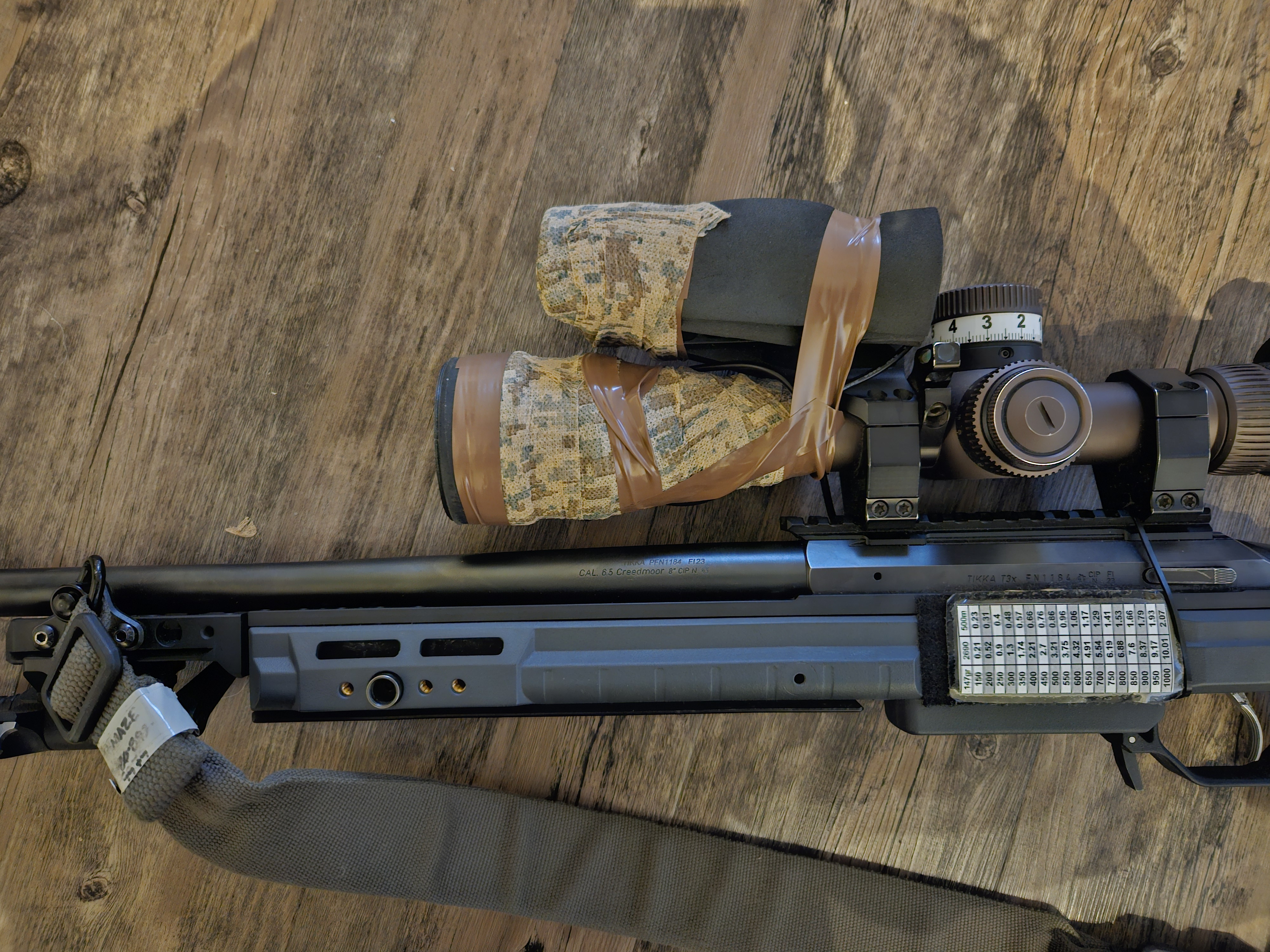

Oh I see. I'm actually more interested in solutions for protecting the plug that connects the remote to the unit for when I carry my rifle slung and thought he might have a line on plugs, switches, and cables.
I have this low tech solution that's not the sharpest looking:
You know what they say; if it’s stupid but it works, it ain’t stupid!

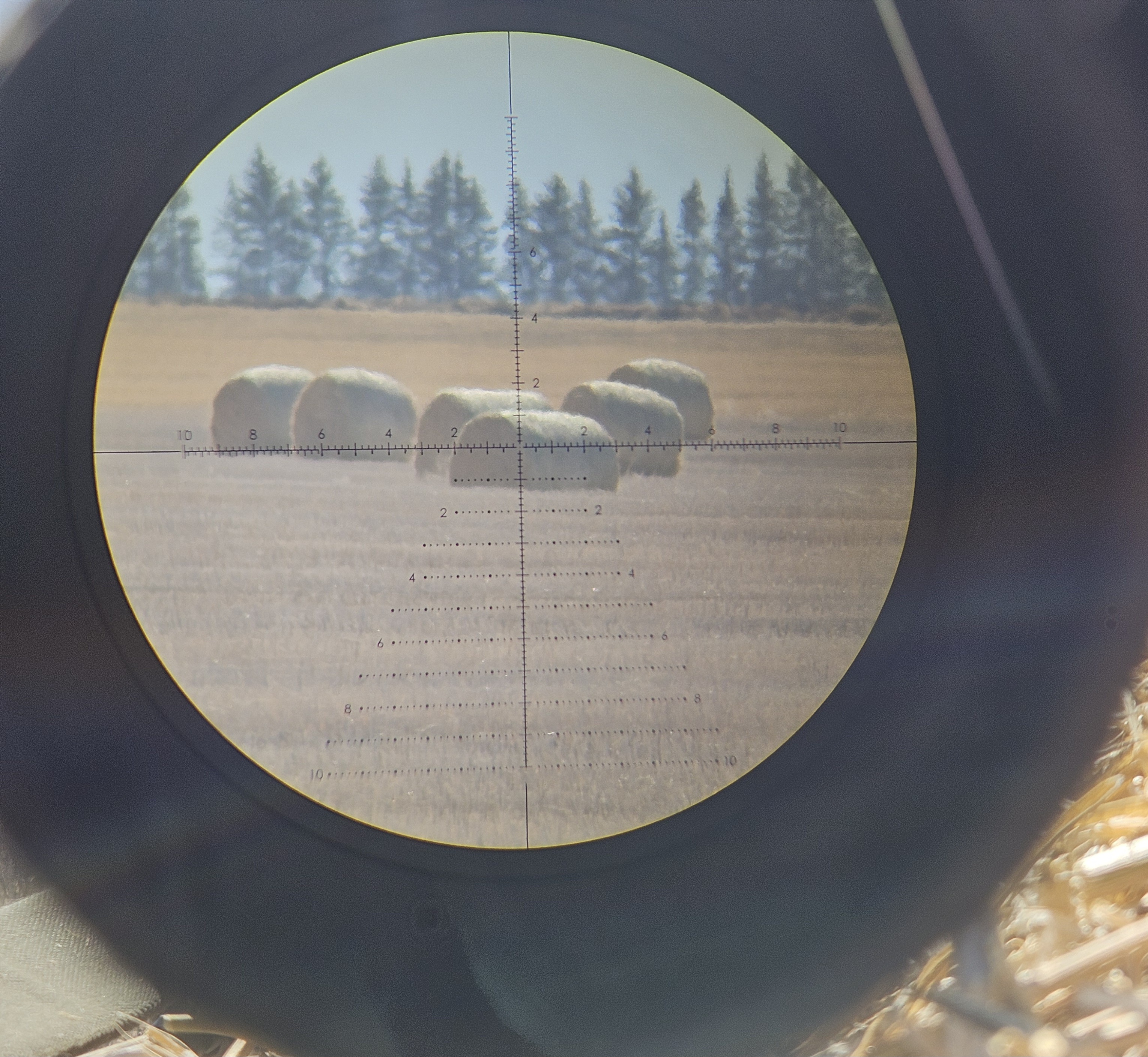

I checked visible laser zero on this abandoned house. Then I backed up and lased around the edge of the window frame to see exactly where the actual rangefinding laser hits. The visible and RF lasers are much better collimated than on the Impact but not quite perfect.
I had to look up the definition of "collimated" to make sure I was using it correctly.
Reactions: Bluedog82
I'm sure everyone has their own way of testing things but after I checked the window frame I found several equally reflective and staggered laser targets, round bales.
By lasing edges and tops I can see exactly where the beam is getting a return from. Although things seemed bang on at 100 meters (0.7 mil/2.75" high) past 400 meters I had to hold 0.4 to 0.5 under instead of the expected 0.1 to 0.2 and so I adjusted it further so it's around 0.2 high (need a 0.2 hold under) at 400m. Also had to slightly adjust windage.
The idea with the bales is I figure (and I am no scientist) if you're checking on a steel target with sagebrush or something way behind it a slight edge hit on the highly reflective steel is going to give you a return on that even if most of the beam went past it.
Again I'm sure everyone has their own way of checking things but this has worked for me.

I use skylined targets too but my theory, and I could be way off, is if you have blue sky giving no return an edge hit on the power pole will give a return even if the beam isn't centered on the target.
If I lase exactly between two overlapping bales and I get the far left one I can figure my beam is hitting left. That said a person could probably hold off left and right on a skylined target until they figured it out.
I don't own any NODs so I have to use poor people techniques.

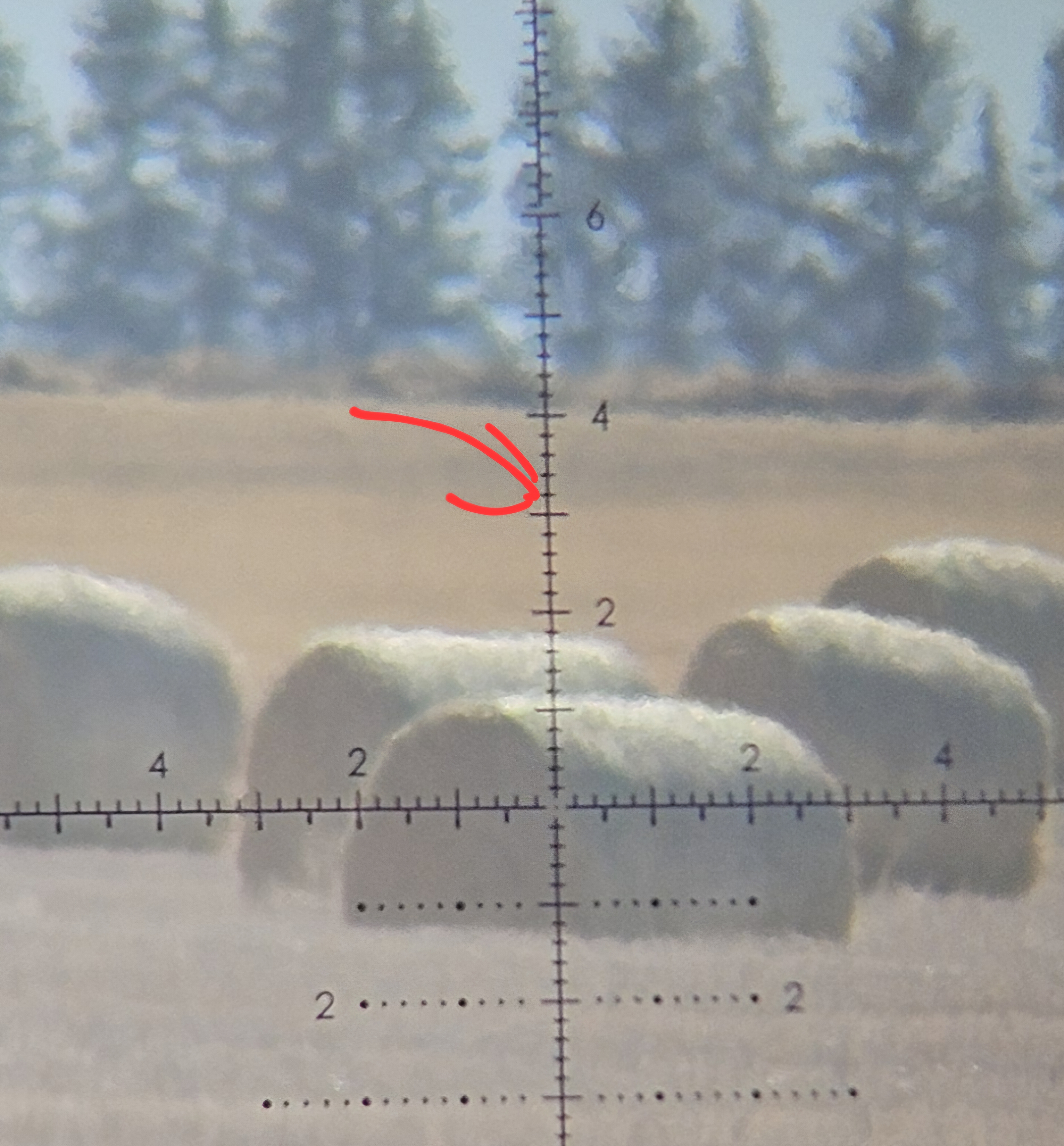

Yes you can, you just need to hold under.
If say you have it perfectly collimated to be 2.5" above your reticle center without dialing you hold under 2.5" at any distance. If you now dial something like 3.1 mil your laser will now hit 2.5" plus 3.1 mil above your crosshair at any distance.
It would look like this with 3.1 dialled *plus* whatever your height over optic is:
Your holdover for the laser is whatever you set your elevation turret at so you don't have to remember or anything.
Instead of having the laser and crosshair perfectly collimated you can also have them meet at a given distance, usually your max distance you're using it. It could be 2.5" at 0 meters, 2" at 100, 1" at 300, and dead on at 500 meters. The idea being at 100 meters you're point blank and don't need the laser and at your maximum distance you plan to lase you can hold dead on.
