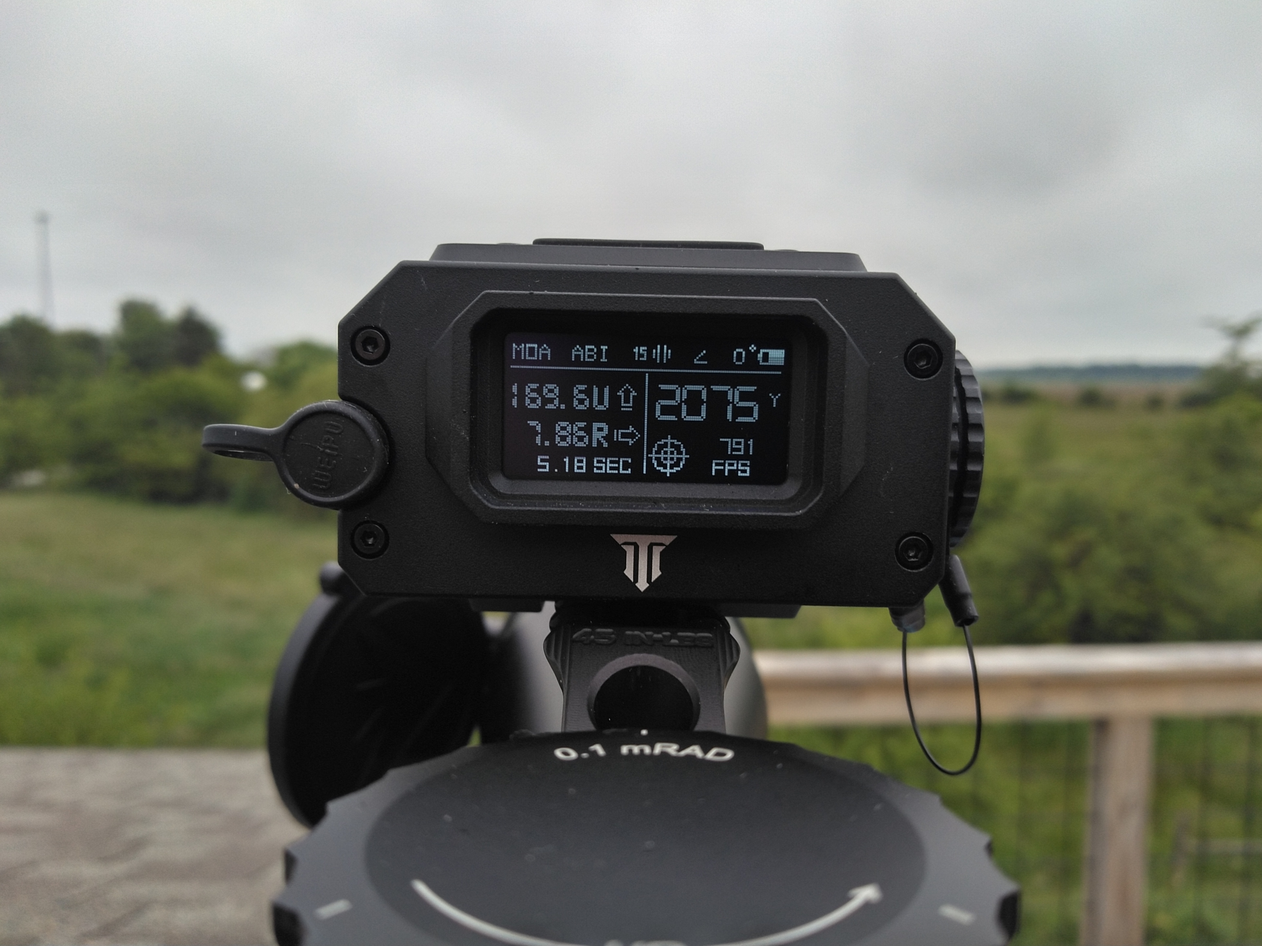

Ranged from under 100yd out to over a mile. Consistently reads 4-6yds long, my Leica and Vortex Fury are within a yard of each other along with a 4000HD and others.
Ranged well at 1086, 1390, and 1814. Always a quick return every time. The 2075 was a pine tree and hard to get a hit but I did more than once.
Ranged well at 1086, 1390, and 1814. Always a quick return every time. The 2075 was a pine tree and hard to get a hit but I did more than once. View attachment 8697207

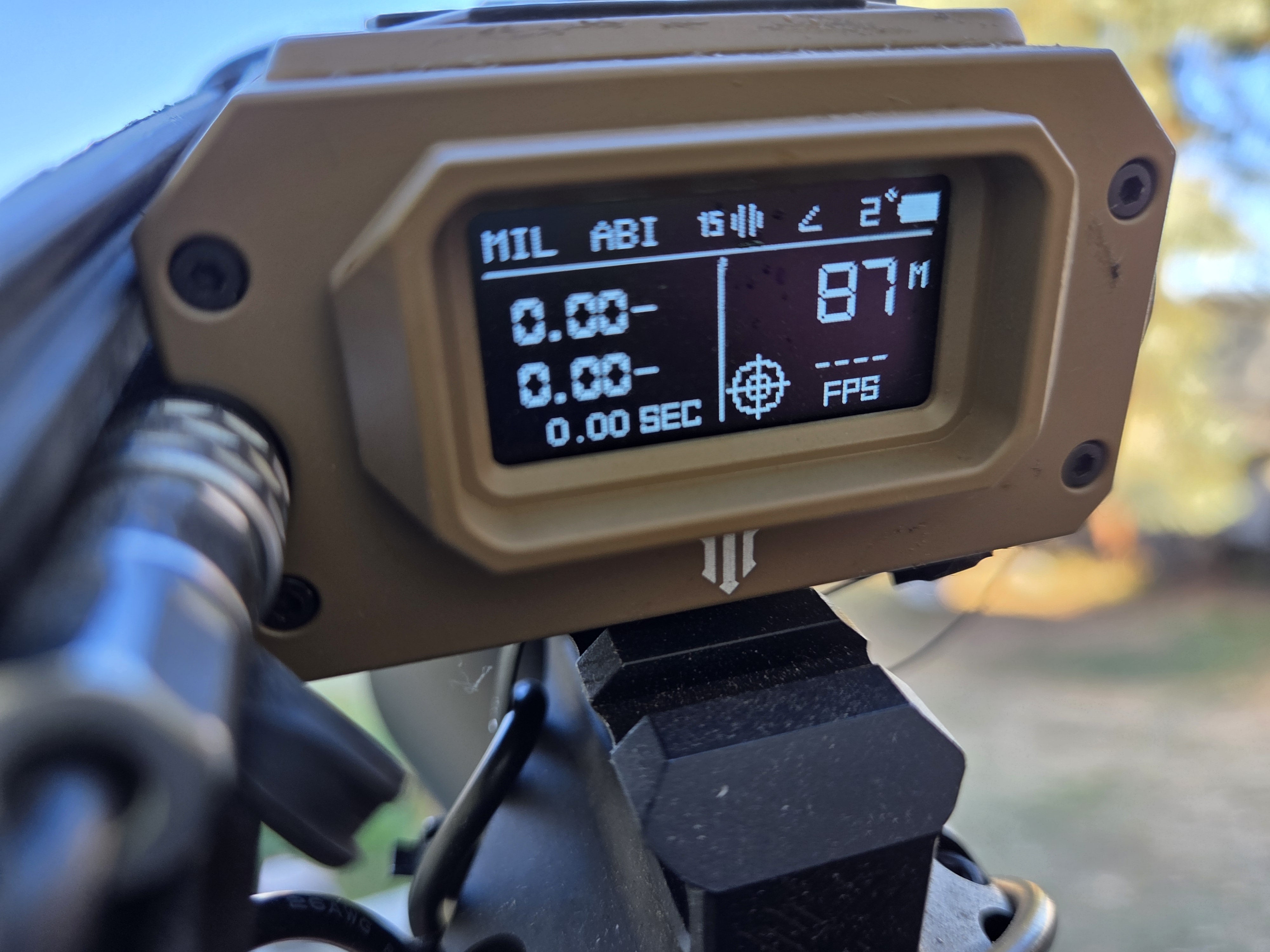

Is there a way to make the elevation bigger ?
Some of us are blind. Ideal it would show yardage and elevation.
Whole lot of unnecessary stuff on that screen
