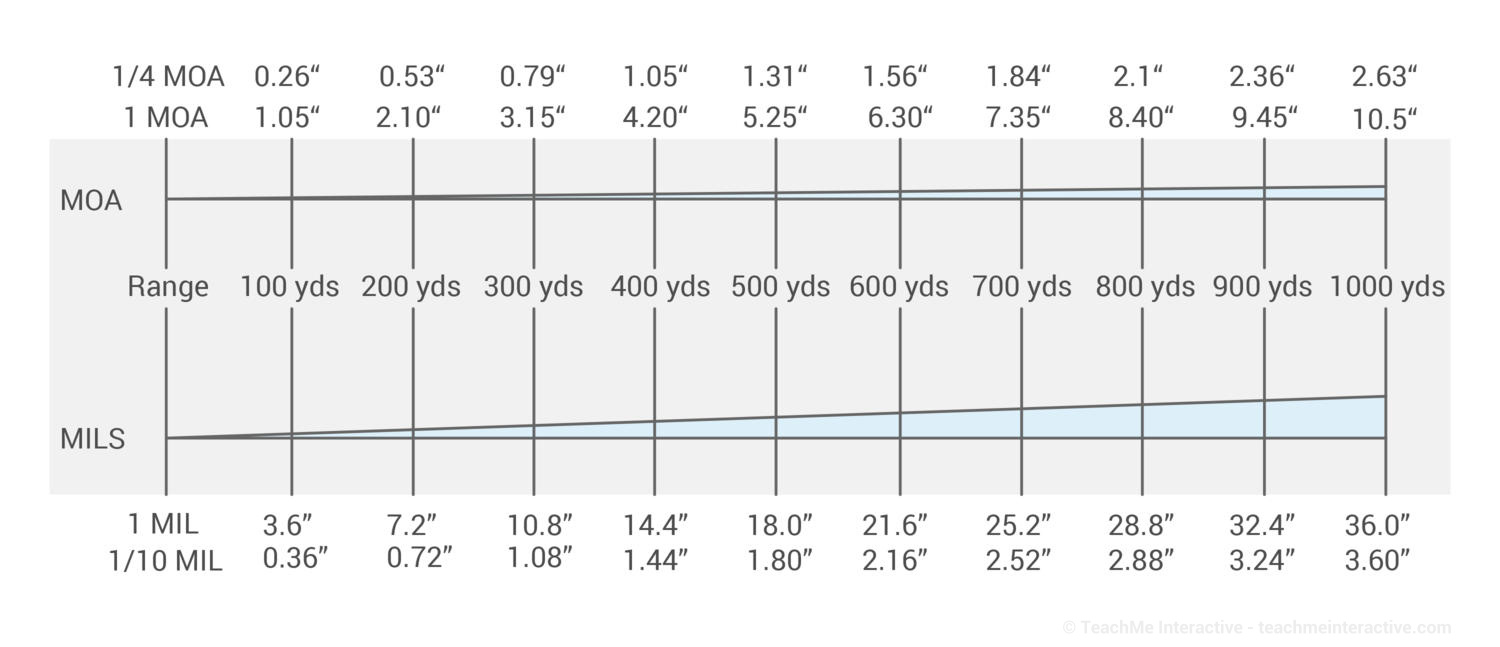

Memorizing your dope is no different for one measurement than the other. If anything should be easier with mils because of smaller numbers.
I find it easier to think in .2 mil incriments because thats what most of my scopes lines are at. and then attach .75" to each .2mil for every 100yds.
.75" at 100
1.5" at 200
3" at 400
6" at 800
7.5" at 1000
ACTUAL SCALE
Reactions: lash

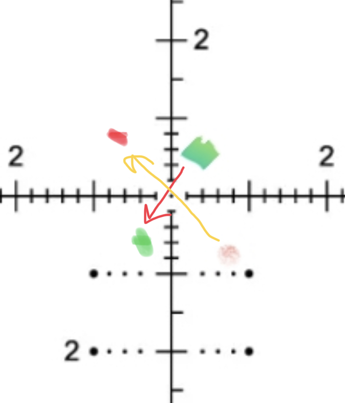

Here's an image of a reticle with two different impact points. (Sorry the color blotches are big, this was done on my phone)
Let's get the consensus on what correction the shooter needs for center impact.
Green first.
Red second.
My recommendation to you?
Green first.
Red second.
You sure about red dot for a second round impact?
But yeah no need to convert from mils to inches then back to mils.

MOA: Measuring with a ruler/yardstick.
MIL: Measuring with calipers.
I'd just say it a finer measurement to use MIL, hence you could say you are able to adjust your hits in 1/10" per click increments compared to 1/4"per click increments.
No, that is down right incorrect. MOA is a finer adjustment.
it's 1/10 Mil vs 1/4 MOA not inches.
@ 100yards .1 Mil is roughly .36" and 1/4 Moa is roughly .25"
it's not really a big enough difference to care about
