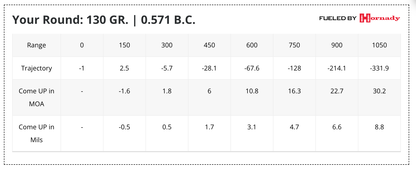

How to transition from thinking in MOA to thinking in MILLs
Help me understand: Cause this seems to tell me to make more adjustments using MOA as compared to MIL depending on the range to target of course.

Okay...I think I was adding into my thoughts of what one does physically to the scope. I wasn't solely thinking of the physical measurement differences between MOA/MIL. Say I'm using the 600yd data above: Changes UP are 10.8 MOA or 3.1MIL.
It sure seems like for some scopes I'd need to turn the cap at least one full turn plus some using MOA as compared to a 1/4 turn on a MIL cap. Maybe I'd not reading the cap indicators correctly.
Anyway...thanks for the info.
This is a fairly elementary concept/math
Yes you will have to put more clicks in with an moa scope because the adjustment is smaller,
10.8moa is 43 clicks.
3.1 mil is 31 clicks.
Imagine you are stacking up blocks to get your desired elevation. at 600 yards 1/4 moa is a 1.5" block
and 1/10 mil is a 2.16" block so you will need fewer of the larger block to equal the same height.
The scopes are graduated using different units and different fractions of those units. Also an moa scope is about 25moa per revolution and mils are about 10 mils per revolution.

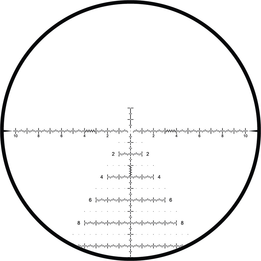

Well, I looked at my reticle that had hash marks at .25 mil increments. I moved my aim point two small hash marks to right (which moved my angle to the left) and hit target.

Yea...I got an idea about the math side of this. I'm just confusing the changes/positioning of the dial to hit the target or whatever. Not to mention each scope can have a different method to get "dialed" to the adjustment you want. In one scope's dial to get to 10MOA it's a FULL rotation, as compared to another dial that needs 1/4 rotational turn to get to 3MIL.

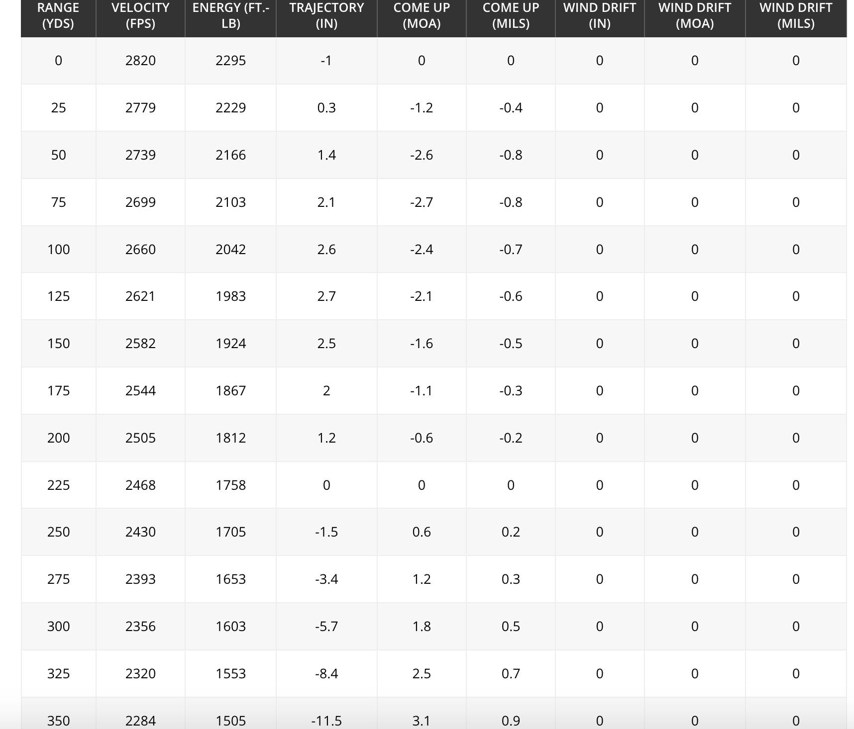

I use those "calculators" only as a tool, not the gospel. For my question/learning I was showing that as the example of "less" dial turns on the scope. I tend to let the paper and my own shortcomings to tell me what needs work.
