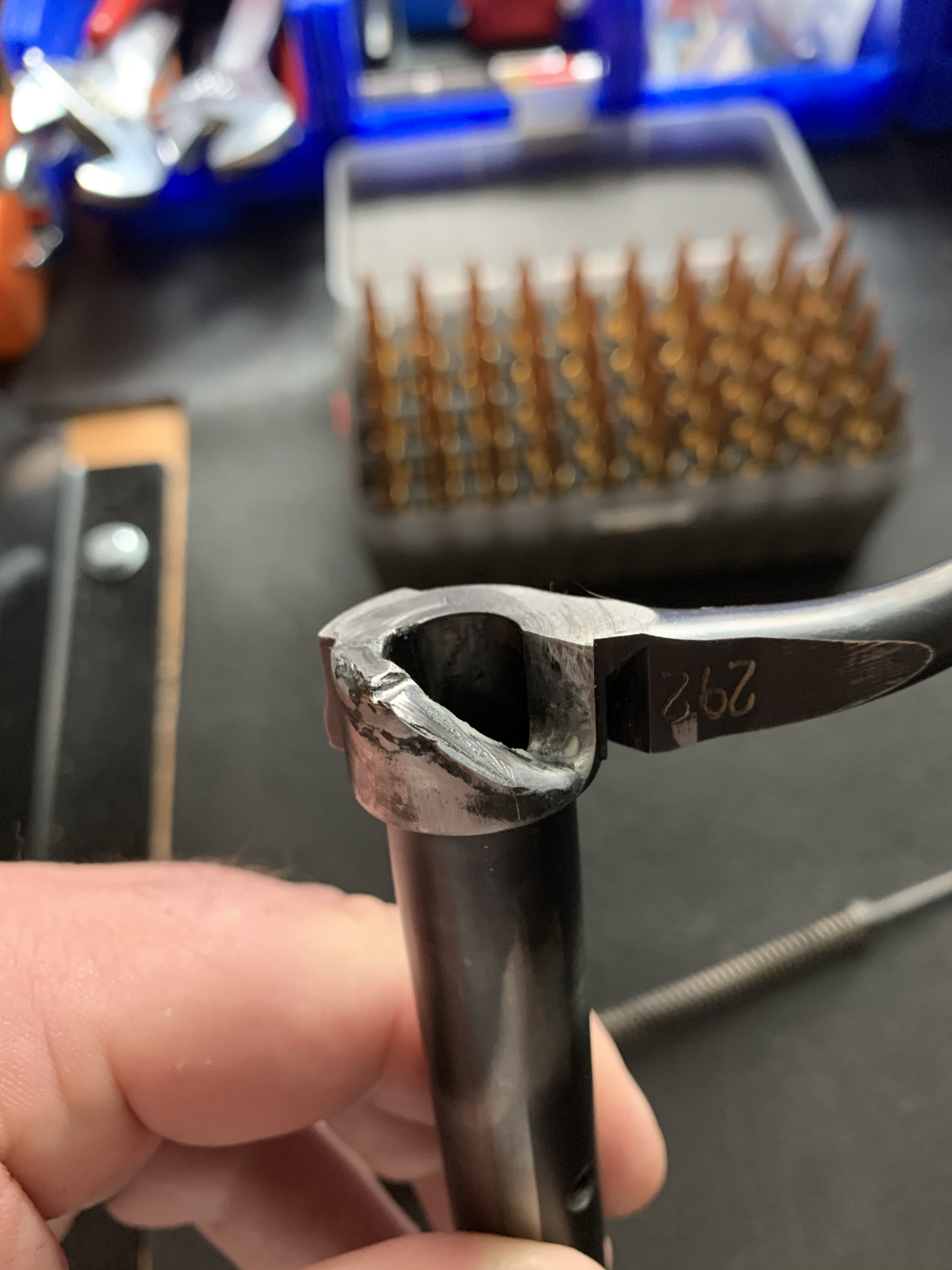

I did perform an experiment though on a spare bolt I picked up off of eBay where I tested the limits of how good one can get the Howa's bolt-lift feel just by reshaping the cocking ramp: I got it so damn good and light, it easily rivaled any custom action out there... I just got too greedy and eventually ruined it (striker would fall off the cocked-notch).
They can really be made nice if one wants to put in the time and energy, just don't get too greedy and remove too much material anywhere troublesome, and be careful wading into those waters, gets deep fast.

Here's a pic. Looks like shit, not sure how much it'll help.
After I had gone too far I had a buddy of mine weld it up... I asked him to add too much material, I was hoping to have a lot to work with so I could "whittle" it back down to where I wanted, but he didn't get what I was talking about (or isn't very good at welding) and it didn't really work out...

^^^ What’s surprising is: as ugly as it is, still works 100% and feels as good or better than an Impact 737...
Looks suspect as fuck tho, so I’m still using a 100% stock/unadulterated bolt.
The experiment was indeed a success though as far as finding out what I wanted to know: someone with real skills could make a Howa action feel amazing just by reshaping the cocking ramp.

From doing it a couple times (getting it awesome, then ruining it, then making it work again, albeit much uglier and too suspect to really use), seems like a little bit of material added to the bottom of the ramp would be the most helpful... if you know a good welder that's what I'd do first. I don't think the cocking piece needs to be touched really.
I was really hoping my buddy was going to tig enough extra steel on there to where I could reshape the whole ramp from scratch, but he didn't get what I was talking about and the steel he added was messy and not really enough to do what I was aiming for...
The Howa's ramp is kind of steep, the cocking-piece doesn't really engage the ramp until about 1/3 to 1/2 way up, and then it starts to cock. By removing material from the top half and shaping the ramp into a shallower arc, it starts to get really good, but if it had more material at the bottom of the ramp so it would start cocking sooner, then the top half of the ramp would only have to be relaxed slightly and the notch is already in the right place. The cocking-ramp angle is just a bit steeper than it needs to be and the cocking could start earlier, that's it.

On one Howa experiment, I took nearly 1/8 inch off the cocking piece. With the firing pin further forward, it does engage the ramp sooner. I also cut the slope of the cocking piece like you did, increasing the length of the ramp. Before I did that ramp work, I cut the notch deeper to match what I took off the cocking piece and shortened the flat part before the notch. To make the lift out of the notch less, I cut that flat part at a tiny little angle so that if it slipped out of the notch, it was still actually uphill to get to the ramp.
A buddy has that rifle right now, otherwise I would get pictures. If I remember next time I will get them. He has had no problem with ignition fireforming 6 bra with small primers. That was my biggest concern, but like you I think there is plenty extra force built into the Howa firing pin assembly.
I will add that side by side, a new unadulterated Howa and the new experimental Howa, the experiment was nicer. But, the new Howa was nice too. It is breaking in and only getting better.
