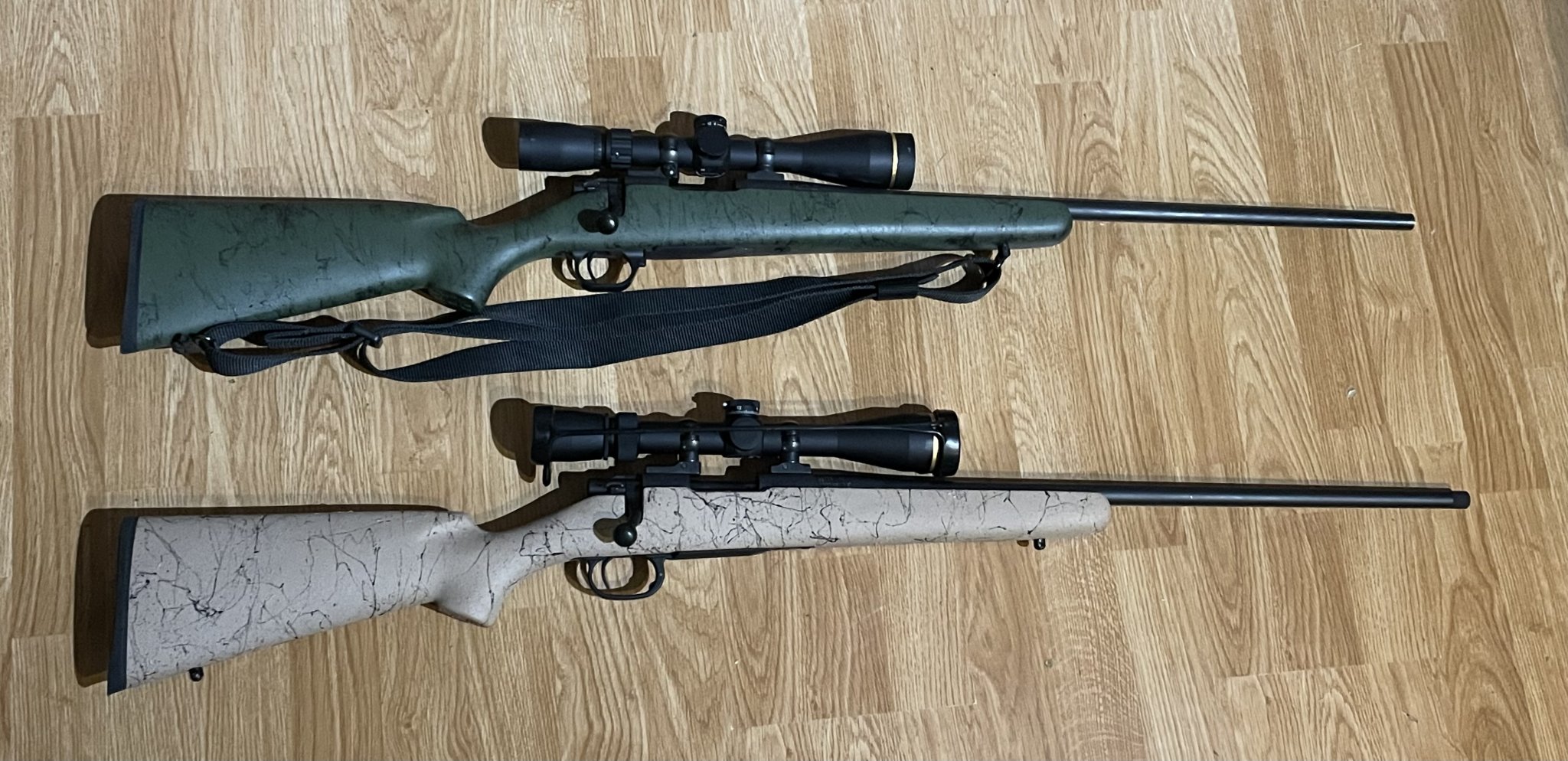

I’ve done two and would rather get the barreled action and put a stock of choice on rather than adding another OEM stock to the collection. Both of mine have Pendleton Custom Stocks, Jefferson State Outdoors and Oregunsmithing bottom metal and Leupold two piece bases. With optic, the6.5 Grendel weighed in at 6 lbs -2.9 oz. Granted, the both have sporter barrels, but that works for what they were built for.

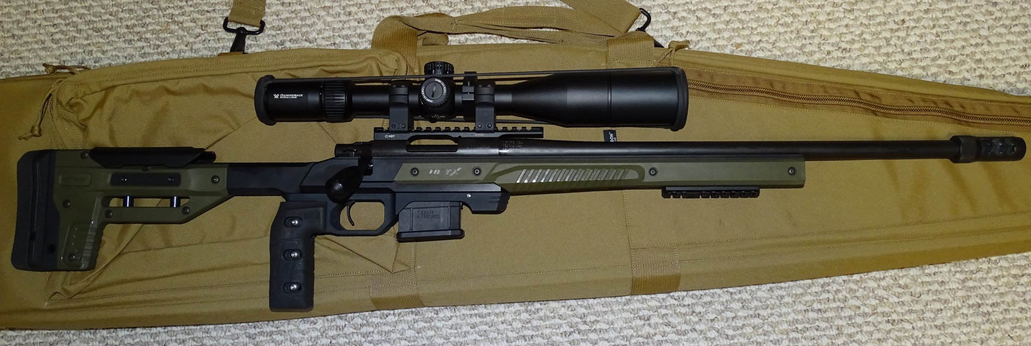

Every time I go on Brownell's to see if they have the 6mm ARC actions, they are always out of stock. I would like to build one on an Oryx chassis like I did with my 6.5 Grendel.
I wonder if MDT is going to mod the Oryx to take there 10 Round magazine?

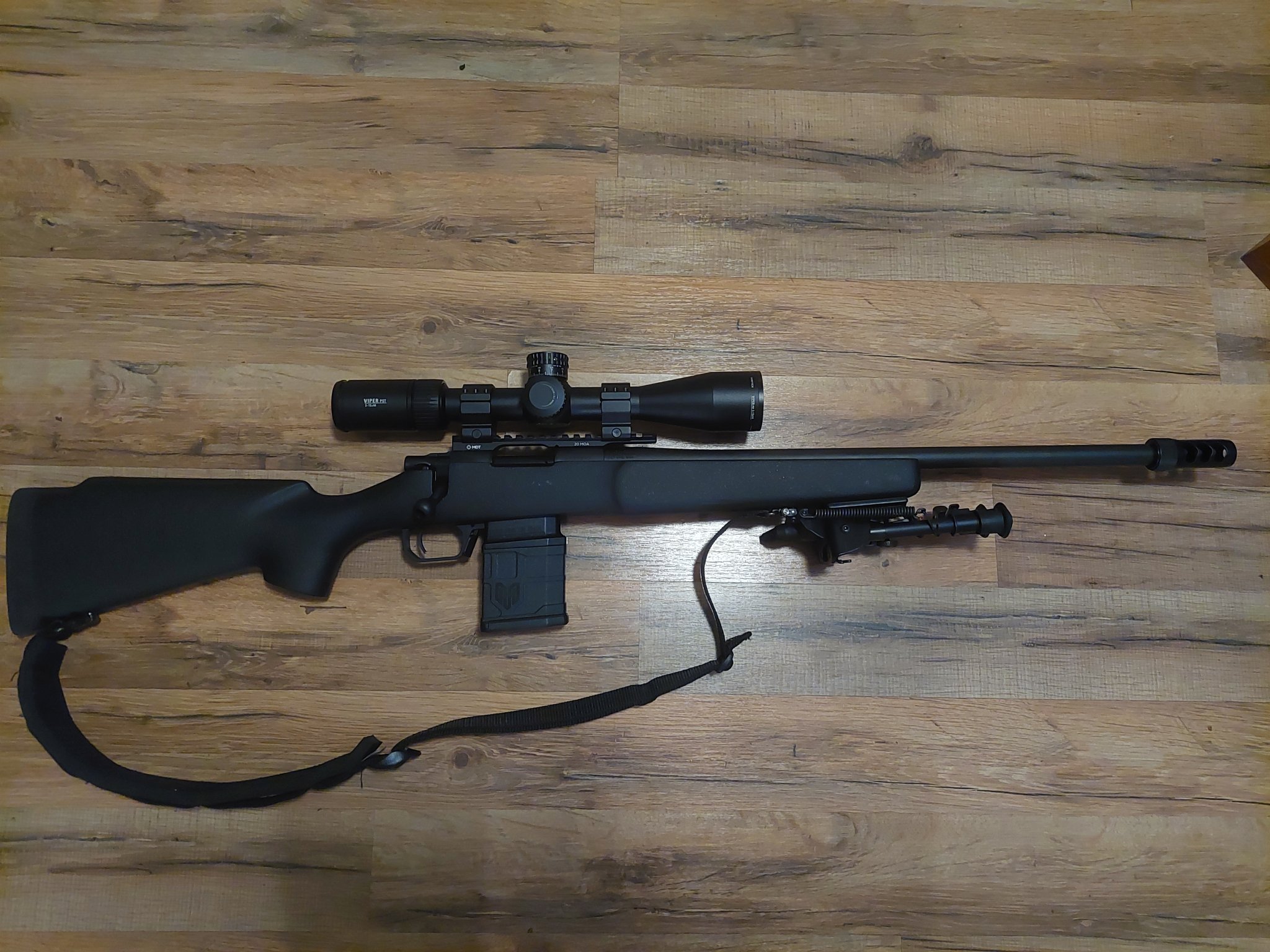

Finally got mine together- going to shoot it Sunday and see how it does. I need to cut about 1" off the stock for my wife and it needs some spray paint. It's pretty nice though.View attachment 8280239
What stock is that if you don't mind me asking ? I am still using the factory stock although I did add a D.I.P. bottom metal and relocated the mag release . Mine is a 223 20 inch .
What bottom metal and mags are you running here?
Jefferson Outdoors
6.5 Grendel mags
CZ 527 magazines with steel followers. Probably one of the nicest mags I've ever used, and still available for a reasonable price. I bought four of them myself just in case though.
Also the smoothest feeding system I've tried to date. It is almost an inline feed angle. Better than a BDL setup and better than OEM. I'm sold. It fixes the Achilles heel of this rifle IMO, which is why I went a bit overboard with the overhaul.
