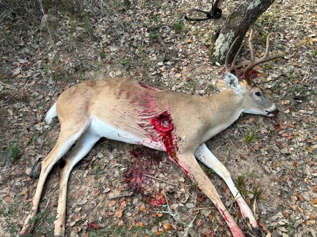

This little deer expired very rapidly. MASSIVE loss of blood. It looked like a faucet on high. Not only that, she couldn't breathe very good at all and her heart couldn't pump. If you were guessing, that is an exit wound. The other side has a little .284" hole.

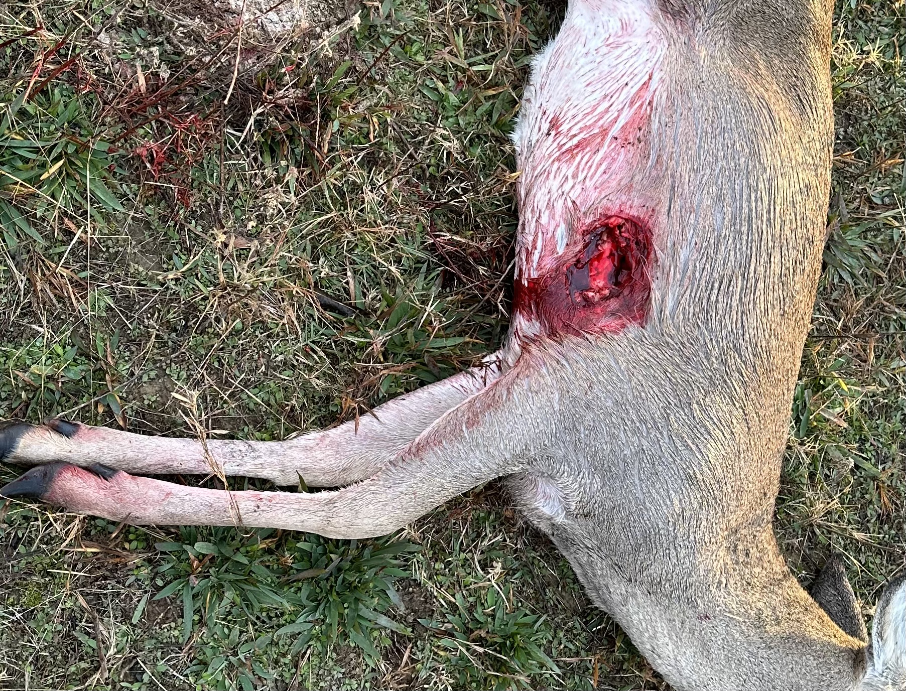

One last thing...the picture of the little deer.
That was a 140 gr bullet hitting that deer at about 175 yards, about 2900 fps on impact, about 2600 foot pounds of energy at the target. Well placed shot :cool: using a purpose designed bullet. 280 Ackley 140 VLD hunting bullet leaving at 3250. High speed low drag...
I did a head shot last year, first time in many years, instant down but that wound was so terrifying that I just don't want to see it again. Plus, now I have my wife going out with me because I own some property and have a heated shooting shack rigged up. I definitely don't want her to see that and be disgusted and not come out with me. And, it does go against the philosophy developed over 50 years of shooting meat critters. I still go for head shots on varmint and vermin and I will take one on a coyote if it happens to be still for long enough.

I leave you with a couple of photos from my deer harvest from this year.
Entrance wound circled in yellow.
Exit wound highlighted in red…
