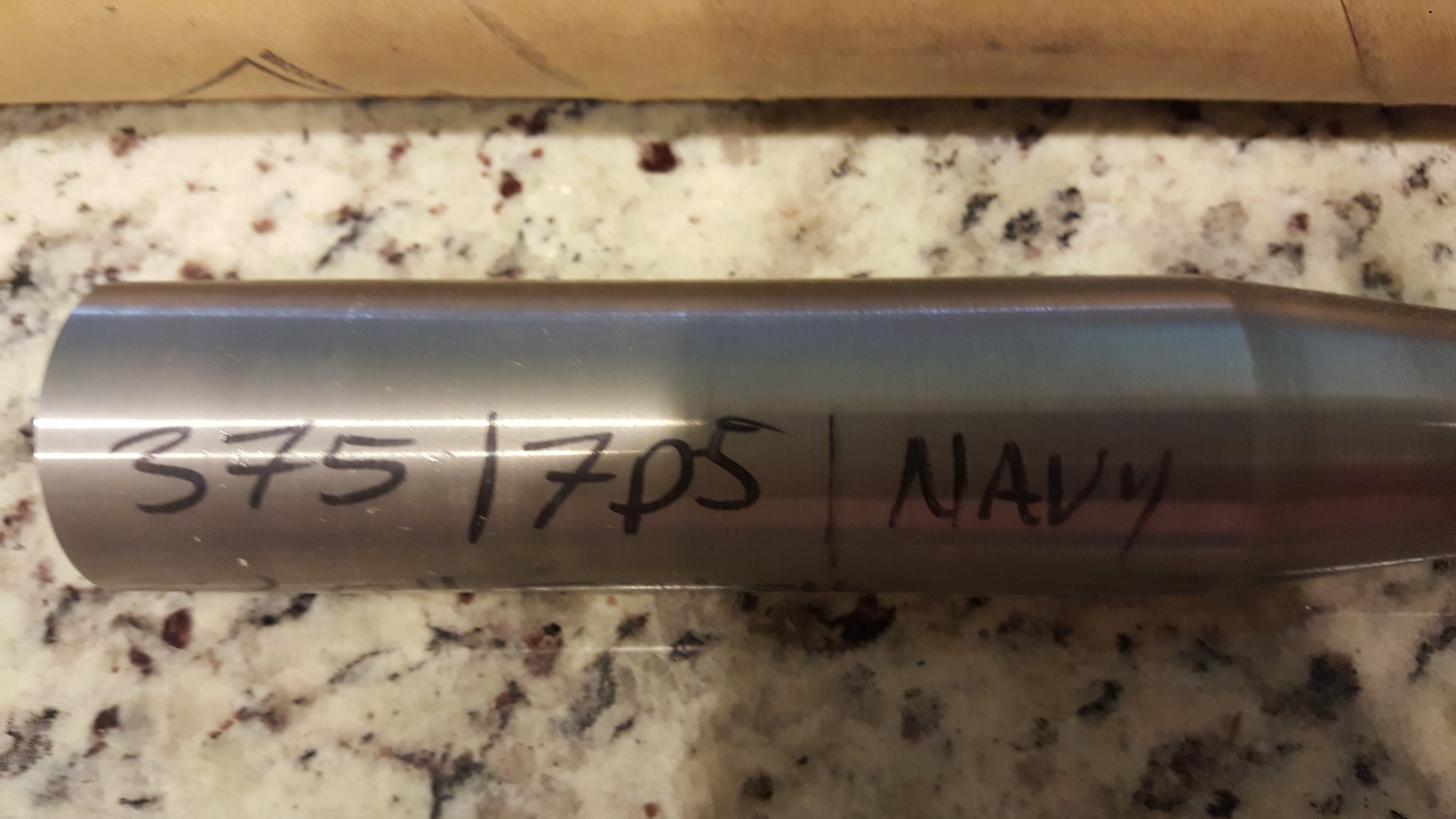

New test barrel has arrived to test the 344gr MkII projectiles from the revived version of the Mach V since barrels are consumable goods ?.
Sincerely,
Theis
