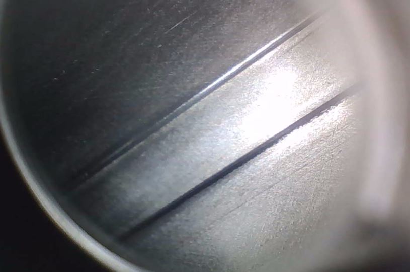

I borescoped an unused cut rifled barrel: help me learn about what I'm looking at.
I don't know what caused those marks but I know what I would do with it.
I would contact the person I bought it from and ask for a quality barrel or a refund. If they wouldn't provide either, I would have someone cut the end of it off and re-crown it.
Then I would tell everyone who I bought it from.
There is no way to really tell without getting hands on , cleaning the tube and using good equipment to look at it. Cameras can make things look weird and cheap cameras are even worse.
All machine work looks like ass from the right angle or under the right magnification. Even gauge blocks look like /\/\/\/\/\/\/\ under magnification. That is physics and chemistry.
Tool marks are just a nature of the process. Would we like to see less? Sure. You can do everything right using the best equipment, tooling and process and still get a chip under a cutter that will drag. Should the gunsmith eat the cost of the barrel? LOL.
People have no idea what the insides of their tools look like. If everyone took a borescope or optical comparator to their parts no one would shoot becuase they would be too busy bitching on the internet.
There are soo many variables that go into a how a tube shoots that trying to say because this one may look shity, it won't perform is a non starter.
Shoot it. Do people not understand what the word "Lapping" Means? Its possible those marks will get knocked down or smoothed out with rounds down the tube like MOST of the marks you don't see that are still there.
Like has been said, there are plenty of tubes that look pristine but shoot like dogshit and plenty of tubes that look like dogshit that are absolute lasers.

Youre wrong, the land tops should not have “railroad tracks” (as Frank called it) across them. The OP can do whatever he wants, but this isnt some gee golly shit happens thing. Done right, this doesn't happen. Its a mistake that was missed and made it out of the shop.

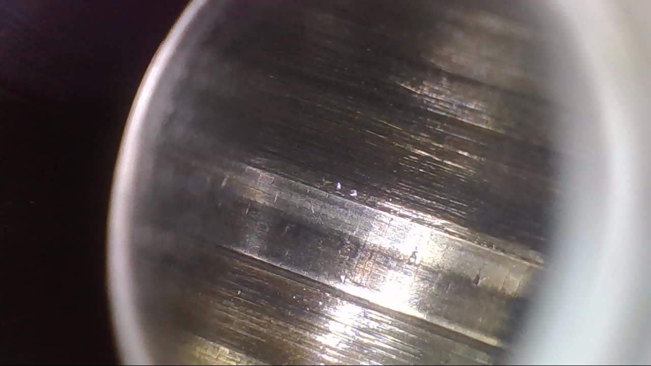

I've looked at a shitload of barrels over the past 35 years, and I can tell you that images are not the end all. Some of the most miserable looking tubes are hummers and there is no discernable reason why. Oclusions, pits, supher voids, ---- all kinds of weird shit would make you think this is junk. Maybe, but not for sure.
Why do you think the top BR shooters buy and chamber 10,or 12 barrels prior to the season and sell all but 3.,, Because those 3 show up on targets what is a good one
There is no hard and fast quantifying visual inspection of a barrel that says "this is a good one".

Alan, nobody is claiming it wont shoot. The OP has said he’s going to shoot it, which is great. He wanted to know what he was seeing. So whats he seeing? There are more than a few in this thread that do this kind of work, including me. Thats not supposed to look like that in my experience. Do yours look like that?

If my $350 barrel comes to me looking like that it’s going back. I do not care how it shoots. If it’s 1/2 MOA, it should be 1/4. 1/4 MOA it should be in the ones. How it shoots is irrelevant when someone clearly made a mistake.
That pitting / blemish in the barrel I don’t care about, but that Allen wrench they used for a pilot was the wrong size.

So are you saying this is abnormal and not acceptable work from the smith or are you saying this is typical and not a problem?
The marks on tops of the lands at the muzzle end....if done during the gunsmithing/crowning the barrel shouldn’t be there. Something really minor and barely visible shouldn’t cause any issues but if it’s really rough/pronounced could cause fouling issues and could lead to accuracy issues. Also take a close look at the crown’s edge. Any burrs there could cause problems as well. Take a Q-tip and run it around the edge. If it’s pulling fibers off most likely a burr. If there is a burr and the first bullet down the bore breaks the burr off it could leave you with a rough edge and again cause accuracy issues.

I would shoot it and see what it does. If it shoots great (put at least 30 to 40 rounds on it) and holds accuracy then don’t sweat it. If it doesn’t shoot then for sure you have a problem.
I’ll also say....I’ve seen pretty crappy looking barrels/factory and what not shoot great. I tell guys at times....if the gun is shooting great...regardless of how many rounds are on it and it’s holding accuracy...don’t look down the bore!!!
Sometimes you think you see something (not everyone knows what they are looking at) and as soon as you have a bad shot things start getting blamed that might not be the issue.

Alan, that’s not what I asked. I know that you know how those marks could happen. When a blank arrives to you from a premium maker, and you finish it, are marks like that going to be visible? Were talking about a premium blank, and a smith capable of finishing it, winchester has no place in this conversation imo. Again, the OP is gonna shoot the barrel. We’re talking about the work now. Tell us about the work please.
Reactions: TheOfficeT-Rex
I'm LOL at this fucking thread
The blind leading the blind with one exception and that exception's name is Green.
Many of us that do this work have chimed in and said that it shouldn't look like that, and now Frank has confirmed it. You work in a tech field. The operation for crowning a barrel any number of different ways DOES NOT produce this when done properly, why is this acceptable to you? Serious question.
Fwiw, I dont think this is a Bartlein, as they’re much cleaner in finish than the OP’s barrel. I could be wrong though due to the OP’s shitty camera.

You take OP's barrel to shoot with as you have so much trust in it?
And also, yeah LL has said many times that you should not borescope, but he particularly means about starting to worry about firecracking, copper and carbon deposits, straches from sand powder, the small rock that got into the chamber and made a hole in it.. All the normal things in the barrel that stand out to folks looking in.
How about I put my drill in to your barrel and spin it a couple times? Would you have a problem with it? Because that is literally what has happened.
I own a scope and my barrel throat looks a bit nasty and it is missing a small chunk of crown. Yet it delivers. But you'd have to be some special kind to determine that even because damaged barrels can deliver, damage is a non issue.
We really need someone to do a barrel torture test, where all kind of crap is done to inside of it and see how the performance changes. A minor problem is that the performance might just become more erratic. But at some point it must be observable.

Oh, come on. That's not what this is about.
Is the bore pristine? No.
Does it affect the shooting? Possibly.
Is it enough to matter? Only OP can tell.
The barrel maker is not at fault. Presumably.
The smith is. Probably.
The main question: Does it shoot?
(And is OP good enough to notice?)
On metal, you can see things you cannot feel and that is bl**day annoying (which anyone who has tried to polish metal to a mirror finnish can attest to). As I said before, a digital camera will make flaws really stand out.
I'll await OP's target pics before judgment...

Let's make a sharpened example and assume you make barrels and the number 1 in the benchrest world orders one from you.
Do you let things like that slip, as you assume it won't affect accuracy?
If you did, you could finish all of your barrels like that. Competitors will start mimicking you and soon nobody wants to buy a "Legacy" barrel without the "Cerebral fingerprint".
We can ask, what actually makes the difference between a custom and factory barrel.
Accuracy, for sure. But what about mechanically? Where does that extra cost you pay for goes to?
If the barrel delivers, why is the damage an issue?
I'm struggling to understand the logic reasoning beyond "because I don't like how it looks"
What's the magnification we're looking this through? What is the size (length/height/depth) of these apparent defects?
How does it do what it was intended to do?
You know, questions a reasonable machinist or engineer would ask
My premise is that the barrel might shoot well. But the more errors there are in it, the less performance it likely has.
Barrel perfection correlates with accuracy.
You do not get a shooting barrel by mangling metal tubes (although Glock does?).
If you cannot take that barrel you deem OK to run the 5g competition by looking at it, well then you must think there is something wrong with it? Or another thought excercise, would you pick a pristine barrel rather?
I said what I would do if it were mine. Not what I would tell you to do if it were yours.
