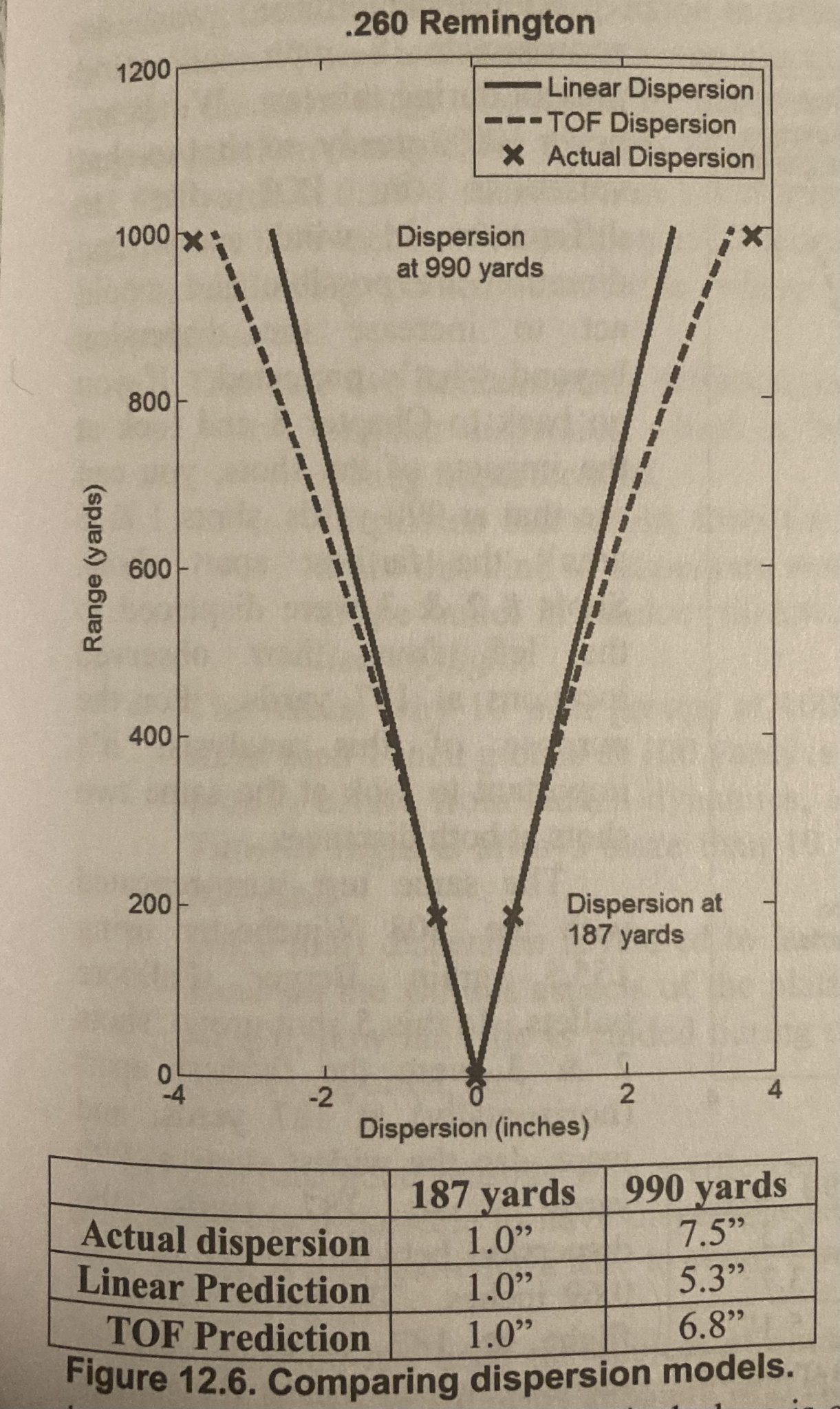

A 1 moa rifle won’t consistently shoot 1 moa at 1,000 yards. There to many outside factors.

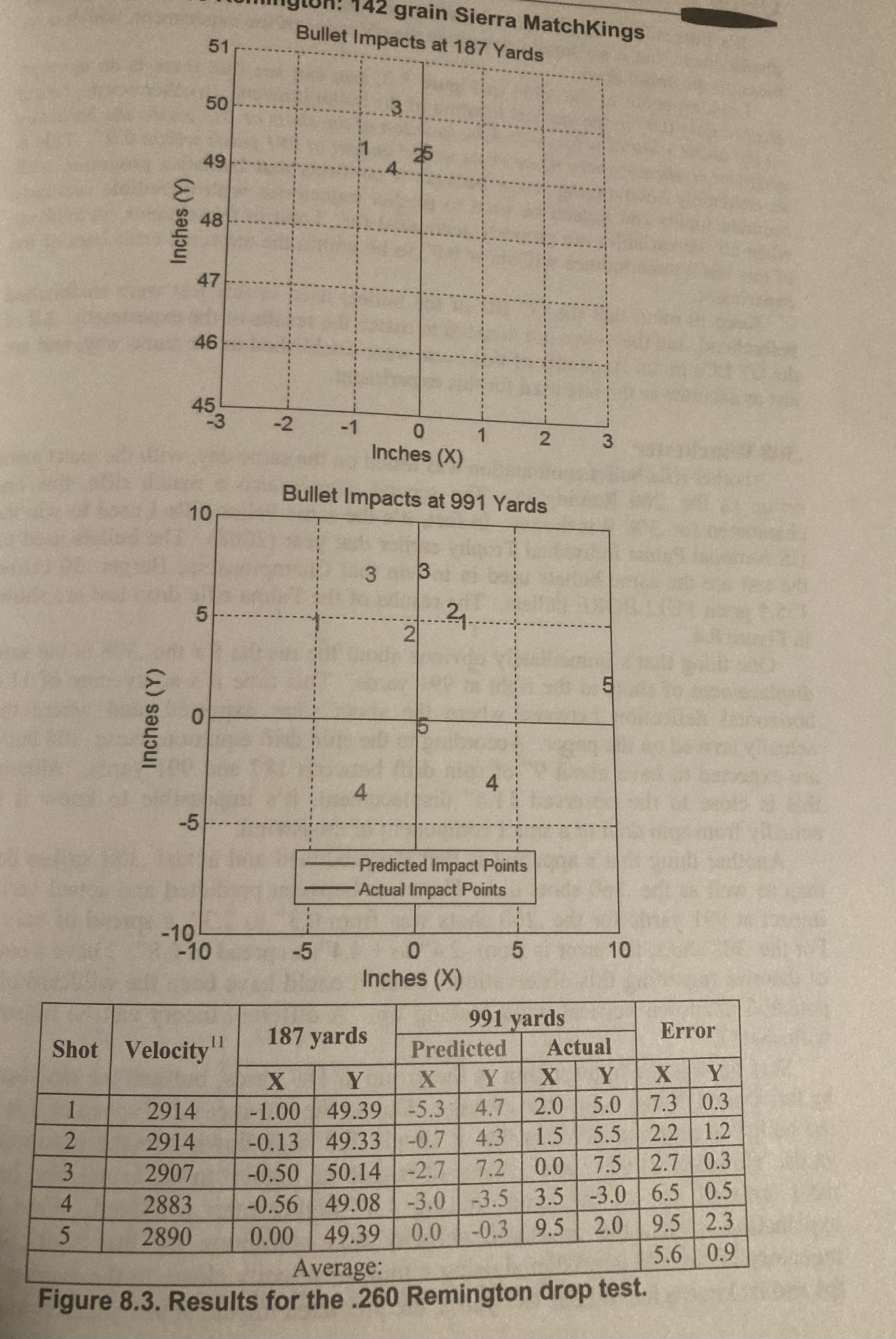

But that is precisely the point...we are (at least I am) talking about the rifle system's precision and not the plethora of other factors like shooter intimidation at 1k, wind, instability with velocity drop, mirage and optics limitations, etc, etc, etc. At least I'm not talking about the practical challenges of shooting at 1k vs 100.
Take the rifle...$500 or $5,000 rifle...and mount it on a metric ton of concrete (where's Army Jerry when you need him! haha) with structural I-beams, with EXACTLY identical ammunition, with every shot in a pure clean barrel, shot in a pure vacuum, etc, and if if its circular error probability (or any other way you wish to define it) is a MOA at 100 then its circular error probability is a MOA at 1k. Right?
Isolating the rifle is what I understood the OP was asking about. And yes, its not terribly germane to practical shooting, it is a kind of silly thought exercise, but it is winter and I'm bored (haha).

Everyone who says 1 MOA at 100 is not 1 MOA at 1000, who is shooting the rifle ?? The shooter is the weak link not the rifle, I would bet very few here could shoot 1 MOA at 1000 regardless of what rifle they shoot with, most here are shooting with a bipod and a rear squeeze bag, LOL. F class competitors shoot bigger than 1 MOA, if they always shot under 1 MOA they would never be out of the 10 ring, look at their setups. Of course the rifle is capable but not the shooter and that is the point.
Reactions: FuhQ and BurtG
How exactly do you think people , even terrible shots like myself , shoot groups way under an inch all the time ?
If you can hold 1/2 moa (or way less cause the rifle accounts for some of that ). How do you figure that translates to holding 1.5 moa at 1000?
Benchrest experts shooting crazy small groups. But guess what. The 3/4” group at 300 doesn’t translate to 2.5” at 1000

A 1MOA laser at 100 is 1MOA at 1000. We're not shooting lasers.
A 1MOA group at 100 isn't even a 1MOA group at 200.
