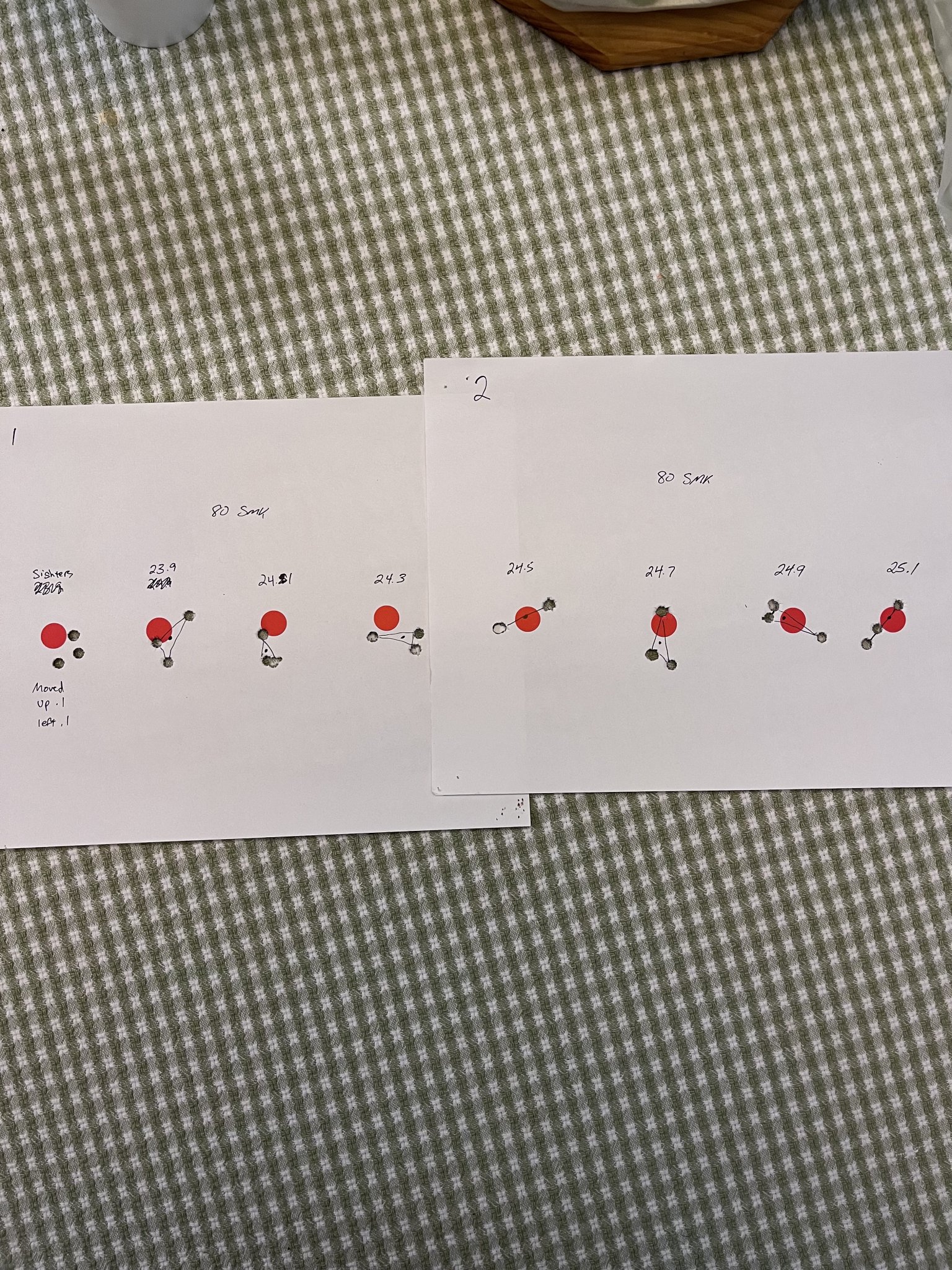

I need help. New 223 barrel

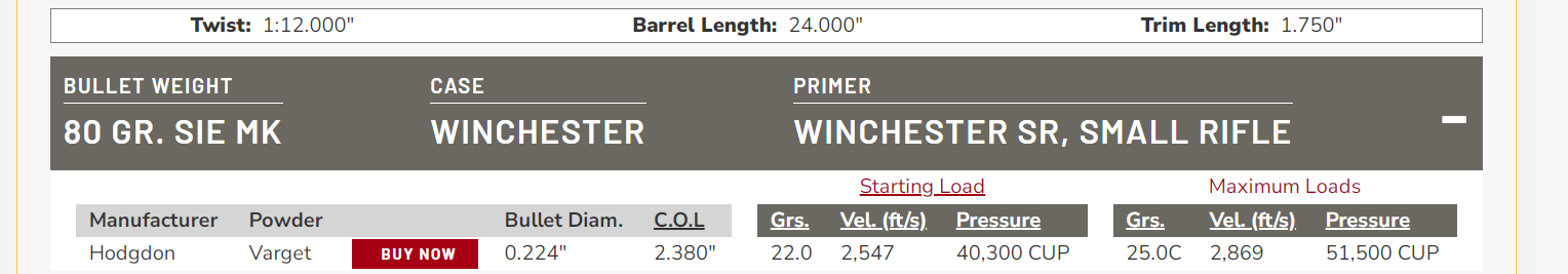

Got my barrel back a few weeks ago. They re cut the crown and said everything else looked good. Finally got it back out today and shot an OCW with 80SMK cause I ran out of 85.5s. I’m thinking I should have loaded a 25.3 and that 25.1 might be the OCW? What are your guys thoughts?
That looks much better than the groups you posted earlier.
Personally, I think that OCW and node stuff is nonsense, I'd just pick a middle of the road speed/charge, maybe/maybe-not play with finding a jump the bullet likes, and be done with it.
Surprisingly (or maybe not so surprisingly) I've found that if I put the same amount of powder into each case (down to the kernel) and prep/load each case the exact same as I possibly can... I always end up with good ES/SD numbers, can print small groups, and always seem to end up "in a node" lol. They way I see it, even if you end up with a "bad load", if you can make that same "bad load" over and over again... you'll be fine.
Nowadays, when it comes to shooting small groups, I think how I slept the night before or what I had for breakfast probably matters more than what charge weight I end up going with.
If anything, these days I actually consider my net MV versus what my eyes/brain can see downrange more so than anything else... ~2750-2850fps I can usually tell where I impacted on a plate at as close as 300yrds (whether low-left or high-right, etc), much faster than that and I can't really tell where I'm hitting until out to ~500-600yrds... YMMV.
I certainly wouldnt assume you should load higher over max because it didnt shoot reasonably at safe pressures.
Its never the answer and is usually the opposite of the solution.
