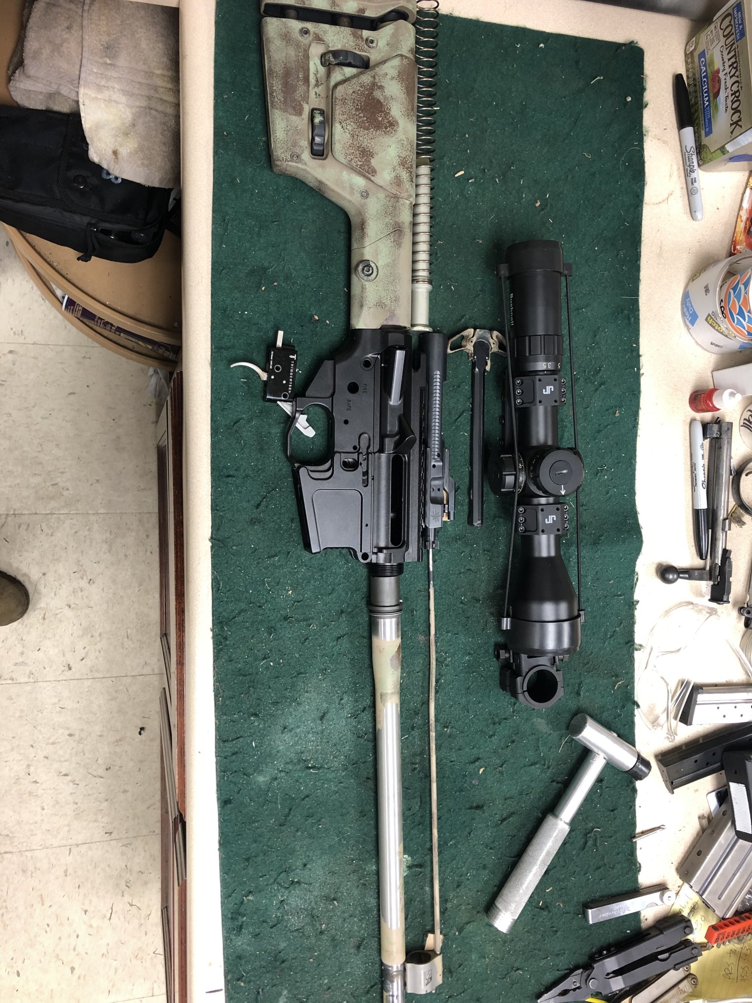

I went with the 20" Stainless Ballistic Advantage Barrel. Sitting inside a Aero Builder Frame. I even went as far as truing the upper and bed the barrel. Overall my hopes were high but my results were sub par. I was getting 1" groups at 100yd. I just thought with the extra work on the upper receiver id have better results. Id recommending going a different route then BA.

Did you try it with the muzzle brake off the rifle Full?
I did. My initial test was with a A2 flash hider. I tried so many different loads too. Bullets were from 77 Berger OTM, 77 SMK, 78 ELDM. Powders were 8208XBR, H335, CFE223, RL16, RAMTAC. And brass was all Lapua. My best load if i remember was 77SMK, 8298XBR, GM205M, in a Lapua case. Overall Id say BA is for the budget minded and not match quality.
Look into bedding and or shimming the barrel to the receiver, I did both on a 6.5CM that helped. triggershims.com

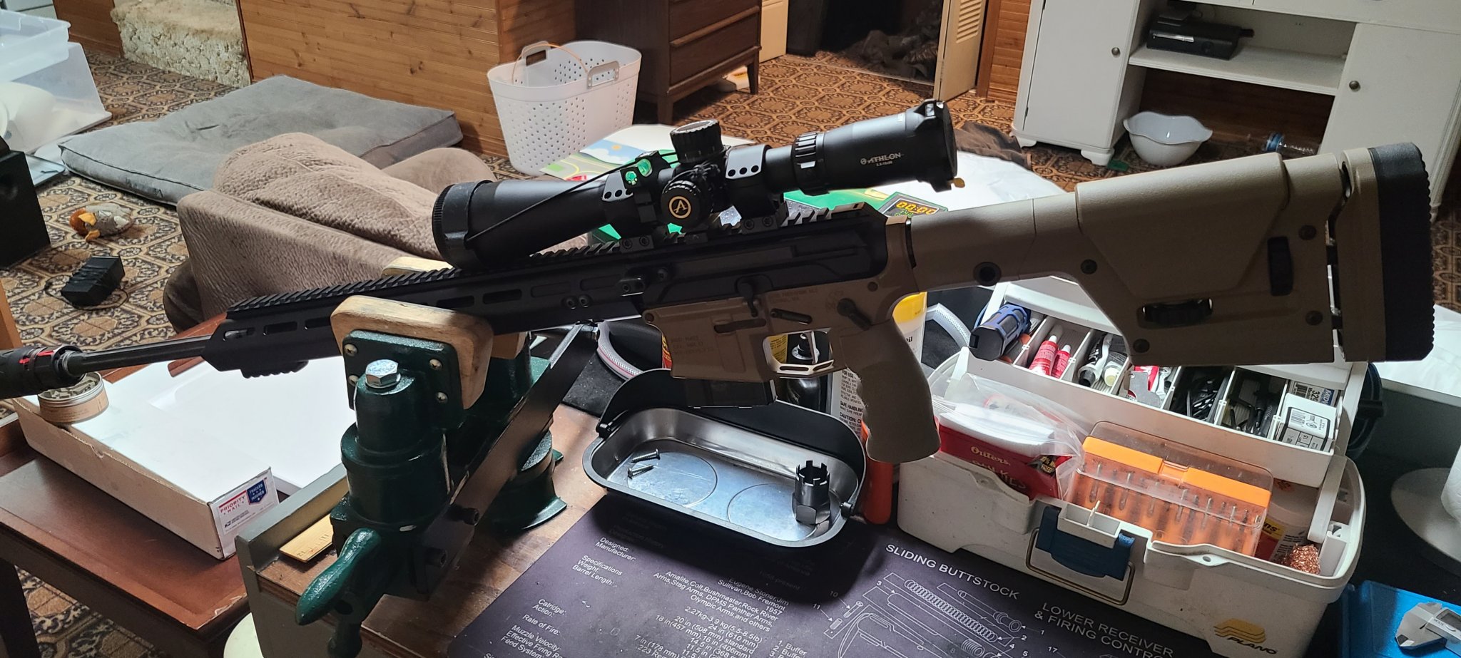

This is my current build. Should be complete tomorrow.
Aero ambi lower and no forward assist upper
Giessele SSA-E, MK-18 rail, charge handle, and buffer system
BHW 18’ Rifle SPR
XLR stock
Picture of the mock-up with SWFA donor scope before assembly.

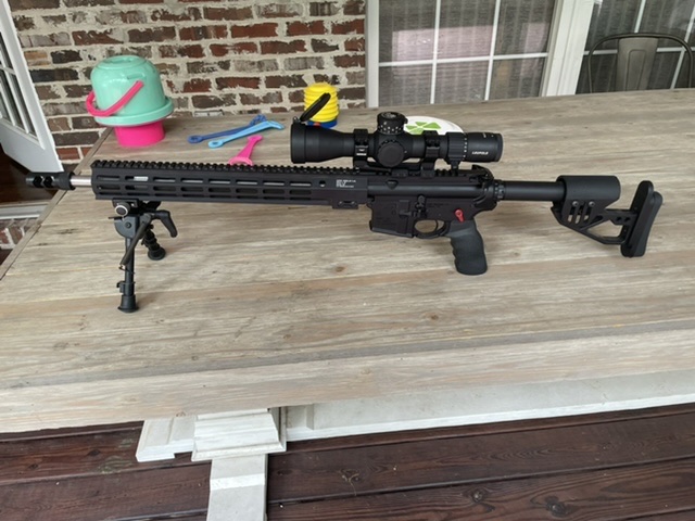

Two years later and several changes:
  • Swapped SSA-E for TT Adaptive
  • Ergo precision grip
  • A419 two port and TBAC Dominus
  • Mk5 3-18

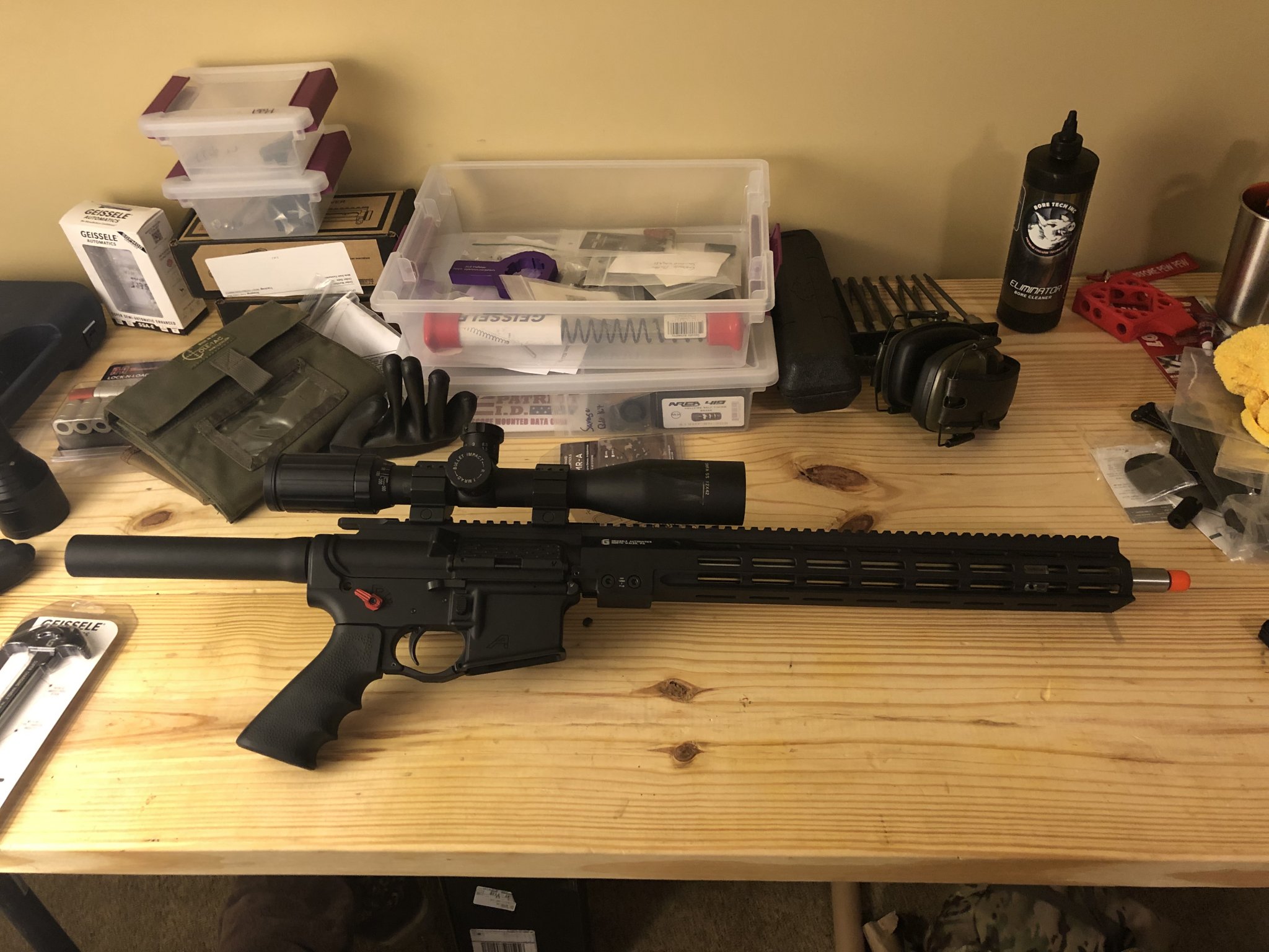

This is my small frame in what I think is it's final form.
Aero lower
TT
JP SCS
PRS gen 3
Spartan side charge upper
JP low mass BCG and enhanced bolt
Gibbz 15" rail
AR performance 6mm predator barrel
Sup arms AGB
Dead air keymo brake and nomad
Burris signature rings and an athlon
