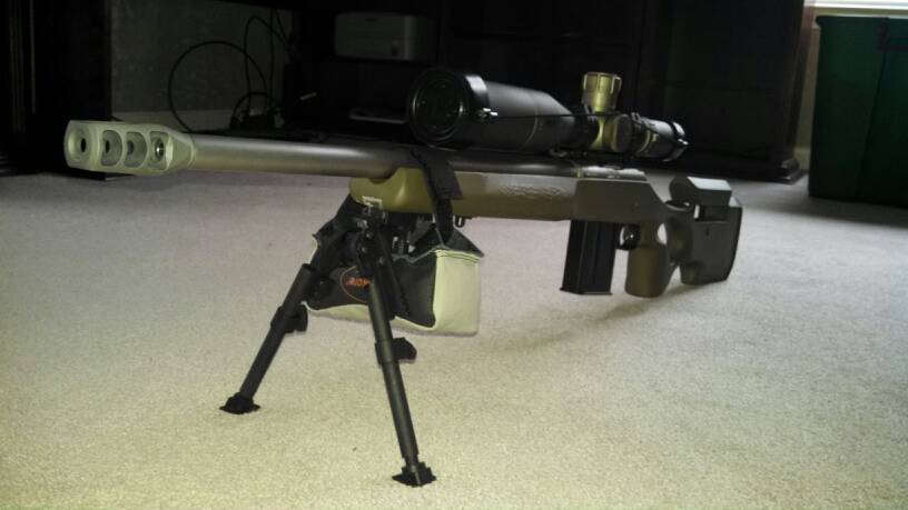

34mm lows on holding an xrs on a nightforce 20moa rail, this is on a stock 308 5r barrel/contour. Works very well for me. I've only put 160 rounds down range with this setup but I'm liking it.
Sent from my DROID RAZR HD using Tapatalk 2

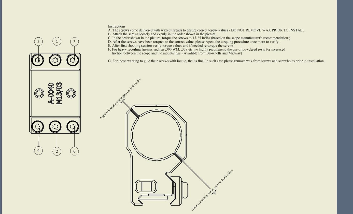

Sorry to hear that you had issues.
I made new small instruction here, and I have a slight feeling that not everybody are following the instructions.
We are using hard coat anodizing on mount and Stainless steel screws that are blackoxided, they stick fairly hard togehter if degreased, the friction is simply just a lot. All our screws are waxed prior to assembly and should stick waxed if not the customer wants to loctite the screws.
In such case must of course the screws and the threaded holes get degreased.
Torque is a pretty blunt measurement.
Blunt because it's highly dependent on friction, and the friction is dependent on Surface, grease, material etc.
So degreasing screws prior to mounting is a way of ensuring that not sufficient force will keep the rings around the scope.
In mostly cases are not rosin a must, but when it comes to Heavy calibers and Heavy scopes we do recomend it.
The rosin sits as a small protective shim betwen the scope and the rings and will help Rising the friction considerably to avoid slipping scopes.
Most likely is it not needed, but when comparing the price of the rosin to the price of the scope, It's hard to justify not using the rosin.

I would have liked to have seen a lever setup like I have on my LaRue setups but already had the 20moa Nightforce rail so I just bought the rings and was done with it. I would have probably bought then though if they had a lever setup, they seem to keep zero better when swapping optics between different guns in my experience. I did pull the scope out or the rings after the first 50 rounds to see if there was any markings on the scope and there were absolutely zero markings/lines etc and it never moved from the mounting position. I try to keep the front ring as close to the bell as possible but ended up having to slide this setup forward about 1/4" to get everything right so I was comfortable behind the setup.
