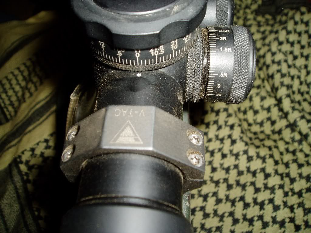

I've noticed recently that folks have been struggling with the issue of being able to see the zero line on their turrets with different mounting setups.
Everyone does know that you can paint or mark a dot anywhere you can see the numbers and use it to zero to right?
Personally I take a small drill bit in my cordless, lightly centerpunch where I want a dot so the bit doesn't walk, and run the drill in reverse to put a neat little dot through the scope tube's anodizing.
This works well on windage turrets too (mark about 10:00 on the turret if looking at it straight on from the side), so you don't have to lean your eyeball around the scope to see the mark, or on elevation knobs when mounted in vertically split rings (like Warne or LaRue).
I did it to my USO PSR prototype because it's lock rings cover up the line on my elevation (wow-you'd think a safe queen that was only built to take "look at me pictures" for the internet would stay cleaner huh?):

I tried to have it done locally on the 35mm scope above, but it's hard to do after the scope's built (Local laser shop couldn't get the scope close enough to the laser head on their machine with the turret installed. That's when I came home and broke out the drill......

If you lightly centerpunch and run the drill bit in revers it just makes a nice little dot that is pretty much only though the anodizing-doesn't take much.

I just posted this to show folks that you can index any scope you want any way you want. Same thing can be done with a scribe, a sharpie, fingernail polish etc.
