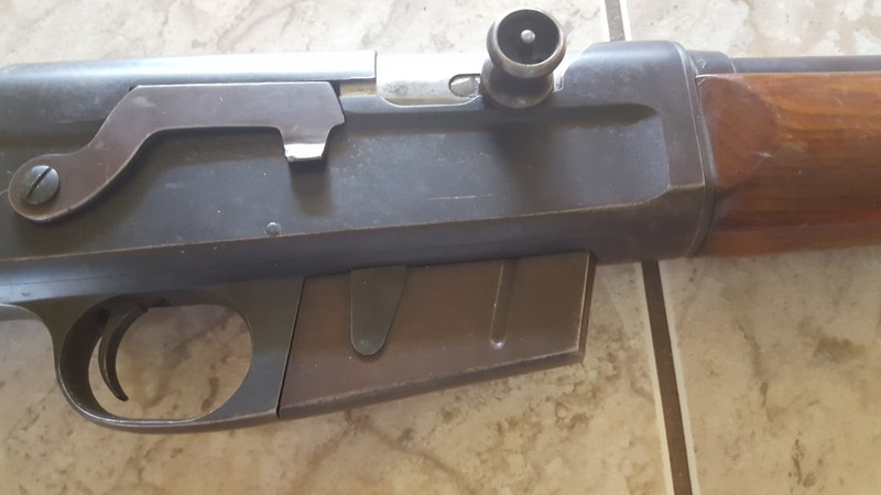

Spring came in yesterday. I put her on the operating table about 15 minutes ago. Operation was a success. I love working on old auto-loaders. Magnificent little puzzles.

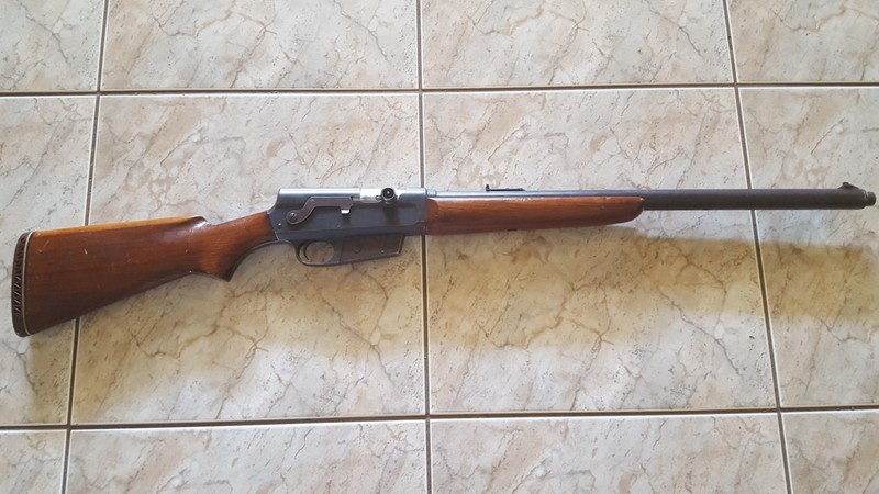

Bitch is back in action. Born in 1937, entered our family in the 50s, has killed dozens upon dozens of deer, hogs, and whatever else could be eaten throughout the generations, and continues to do so.

Here she is, ready for work.

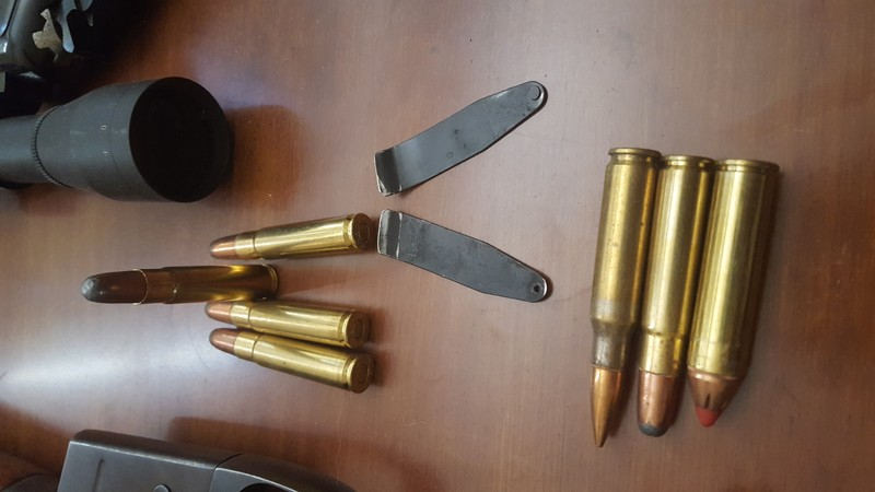

Top spring is a normal one, bottom spring is the problem child, the weld holding that stud in failed. These springs retain the cartridges in the magazine, and if they're free to move around they'll also get in the way of the bolt's travel.
Also lined up .308WIN, .35REM, and .460S&W for comparison.

Absolutely. Beautiful rifle. Thank you for sharing. I am unfamiliar with the .35 REM or the Remington model 81. Glad the surgery was a success.
They're pretty cool little rifles. Long recoil operation, so the barrel is housed in a shroud that holds a buffer and a recoil spring inside. The whole barrel recoils with the bolt. Extraction happens as the barrel is being pushed back into position by the springs, once the barrel is back in position a little foot is kicked that releases the bolt which chambers the next round.
Felt recoil is cool as hell. You can feel most of the steps.
I also have a Remington model 11 in 16 gauge and a Remington model 1148 in 12 gauge which operate in a very similar manner.
