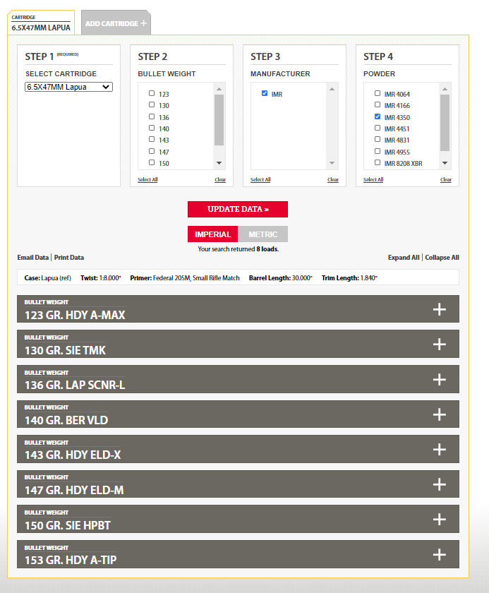

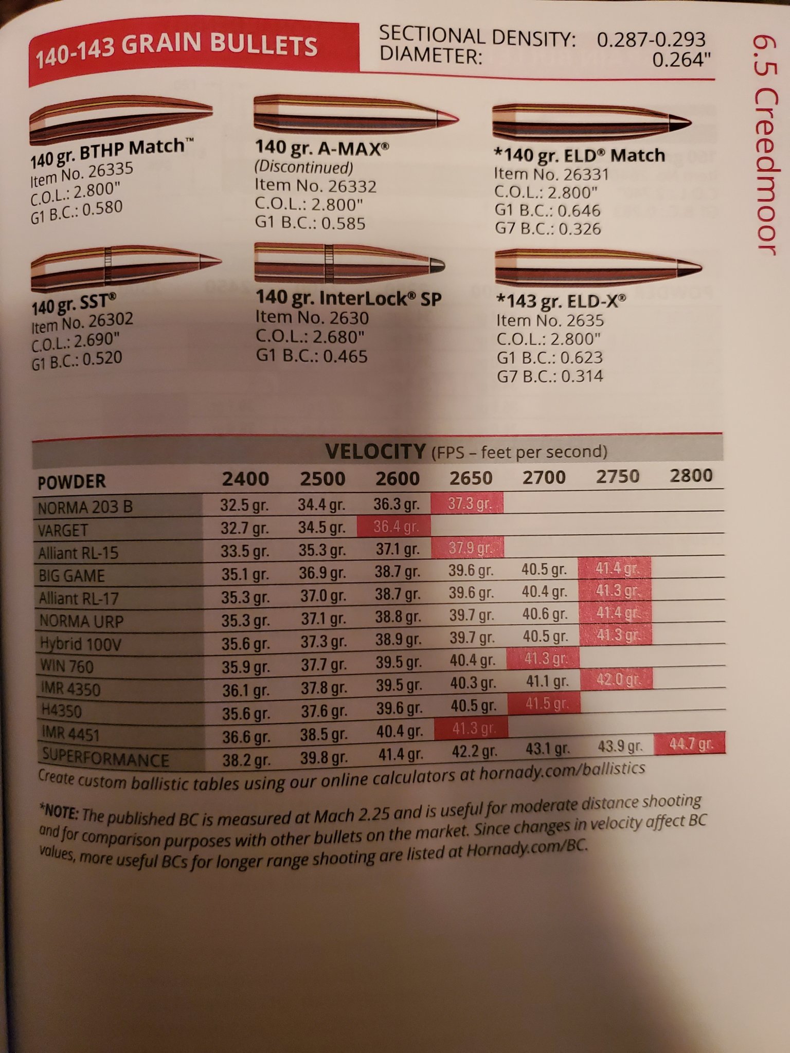

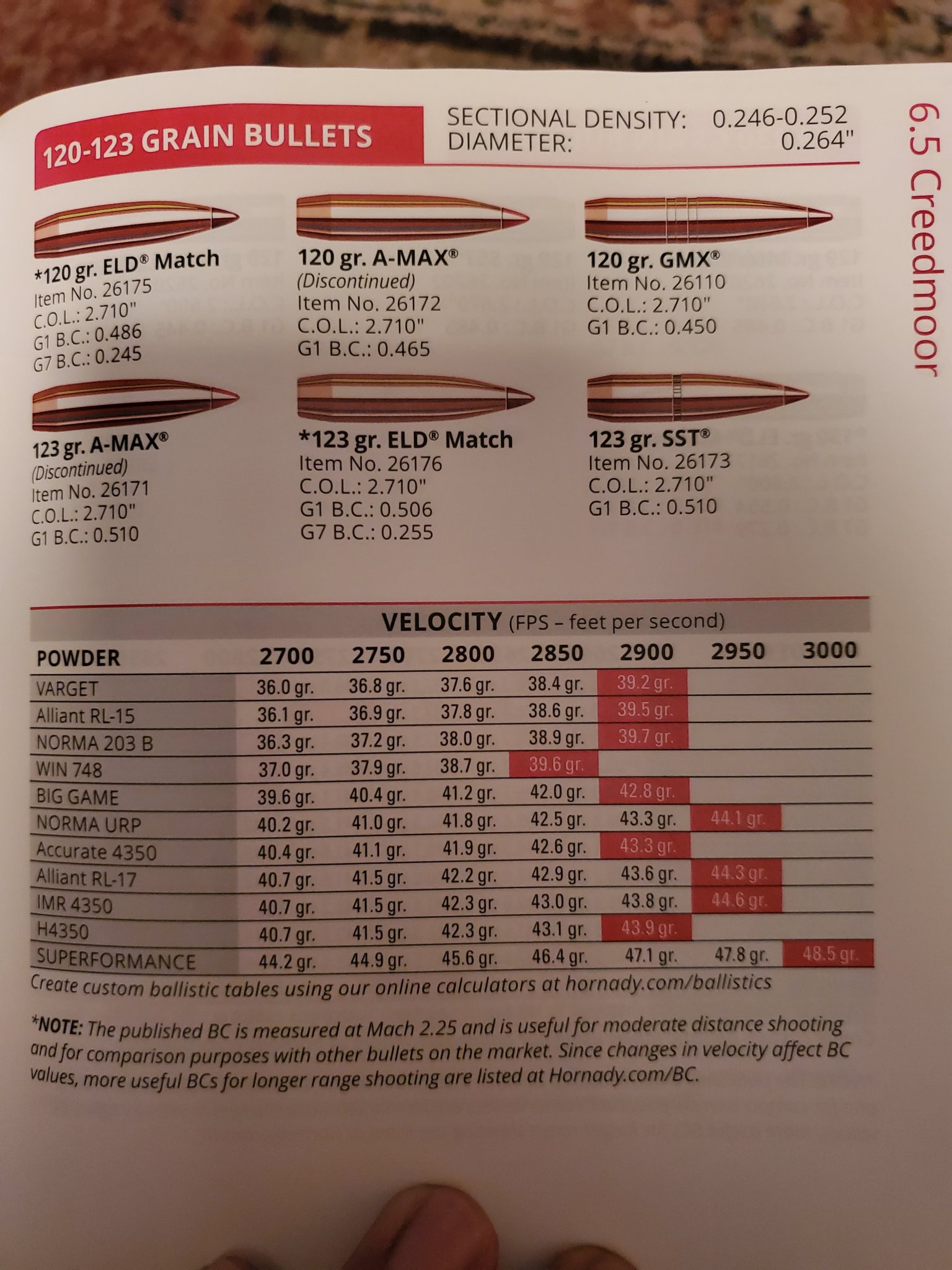

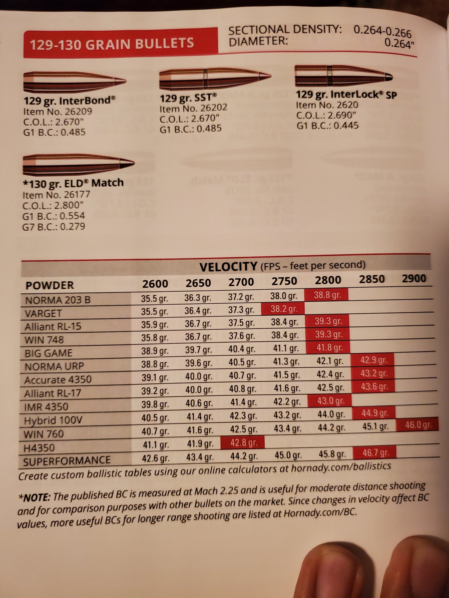

    ^^^ that is the exact data I am using. Trying it out in my 6.5 CM loads. Working on the start of load development for it now. Have some rounds loaded up ranging from 40.2g to 42g. Using Hornady 140 ELD. Will post up my velocities in the near future. Probably will be about a week before I can get out and get that done.
    As for using it in .223 I considered that exact thing along with loading it for my .224 Valkyrie bolt action I am working on. I couldn’t find any info on .223 other than what has already been mentioned about it being too slow burning. In the Valkyrie I found a few that had tried but with poor results. Going to try CFE223 and IMR8208 XBR instead which both of those have load data for both the .223 and .224.
